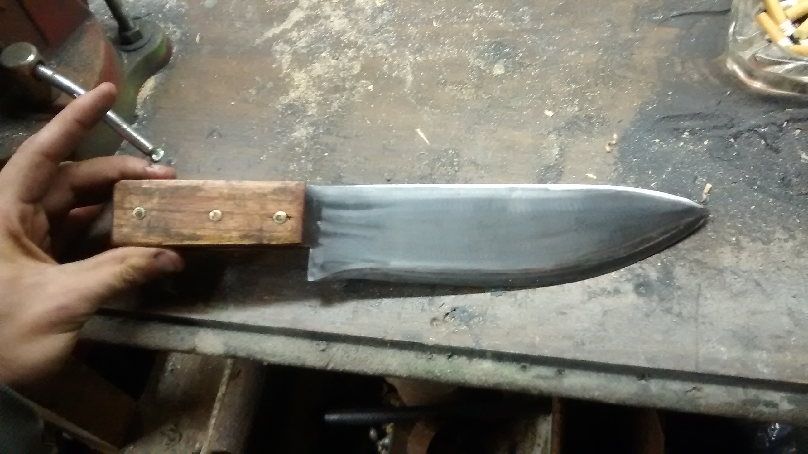

  2. Will W. posted a topic in Knife Making
    Just finished this one a few hours ago. I'm pretty happy with how it turned out. Im unsure of the exact alloy but it is tool steel. The handle is just some oak i had kicking around the shop. 10 inches overall. Any thoughts? Critiques? Advice? How can I make the next one better? Anything is helpful in my book. Sorry for the bad image.

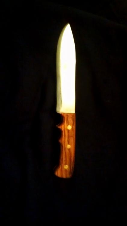

  9. Let me begin by saying that I am no pro. I hope one day I can be as good as some of the smiths on this site. I also apologize for low picture quality. Anyways, I just finished up this knife last night. It's far from perfect, but I am satisfied with it. The heat treat went very well, it fits my hand nicely, its sharper than sharp and it holds an edge well. But I am not a very good wood worker. The scales are rudimentary at best. The edges all the way around the scale are rounded, but the surface is flat. It feels a little too "square-ish." Any tips for a newbie? How do some of you guys make the scales so beautiful?! I know, practice, practice, practice, but anything besides that? I don't have a belt sander, which would help immensely! I made these with a wood rasp, a surform, and sandpaper. Another question I have is regarding the pins. I hand peened them, as that's the only way I know how. When all was said and done the pins stuck up above the scale just barely, but enough that I can feel it. I filed them as flush as I could without marking up the scale, but it's still not where I want to see it. I can post more pics if need be. Any advice would be very helpful. Constructive criticism is always welcome. Thanks in advance. Will
