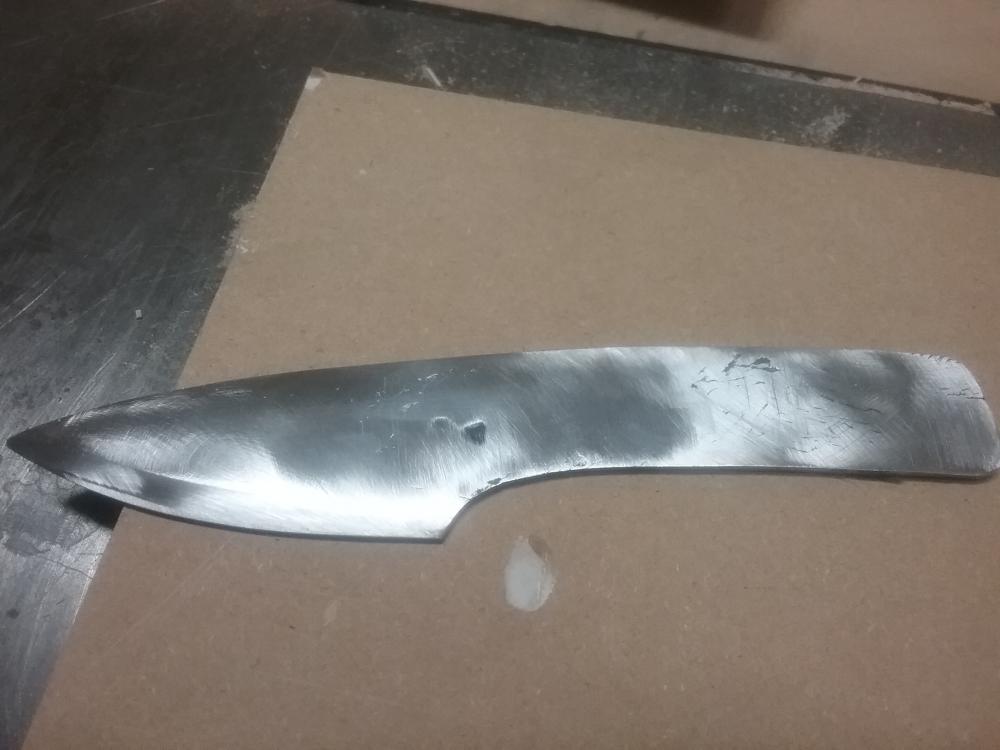

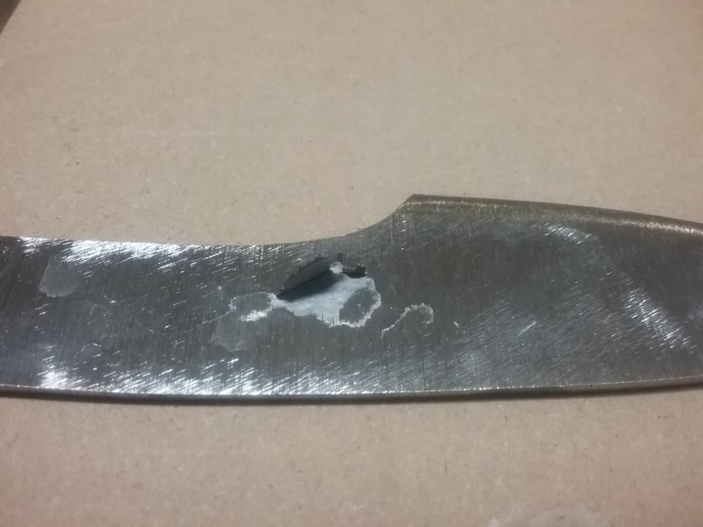

Jonah k Posted April 4, 2018 Share Posted April 4, 2018 Last weekend I had my first go at pattern welded steel but it diddnt turn out. When I first welded the billit I was quite optimistic but it kind of went downhill after that. One side turned out perfect but the other side had quite a few cold shuts in it. I ground it with 36 grit and then stuck it in some muriatic acid to see if the San mai was center which seemed to turn out. But after that I tried to grind out the cold shuts but ended up grinding right through the cable layer and exposing a delamination in the middle of the blade. The first pic shows the good side and the faint pattern,you can see the darker San mai at the edge. The others are the bad side and later the delamination. Core is a Nicholson file. Oh well better luck next time I guess. Quote Link to comment Share on other sites More sharing options...

Jonah k Posted April 8, 2018 Author Share Posted April 8, 2018 I'm doing this same is thing right now cable San mai with a Nicholson file center. What do you guys figure I should do for tempering cycles it will be in a toaster oven. It's been a while since I made a knife and I think I assumed the file was 1095 but I can't remember what I did for time and heat. Any Imput would be appreciated. Quote Link to comment Share on other sites More sharing options...
Will W. Posted April 8, 2018 Share Posted April 8, 2018 Depends on its exact alloys and intended use. I temper my chef knives at a far lower temperature than my bowies, for example. 2 cycles of 400°F for ~30 minutes each will produce a nice medium hardness/medium toughness blade, its what i do for EDC, hunting, and camp knives, but again, depends on the alloy. Dont know if you have one or not but get a laser thermometer so you can read the temperature of your steel while its in the oven, toaster ovens are not exactly known for consistent and precise temperatures. Quote Link to comment Share on other sites More sharing options...

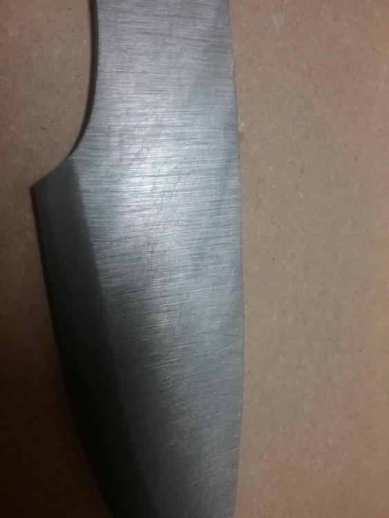

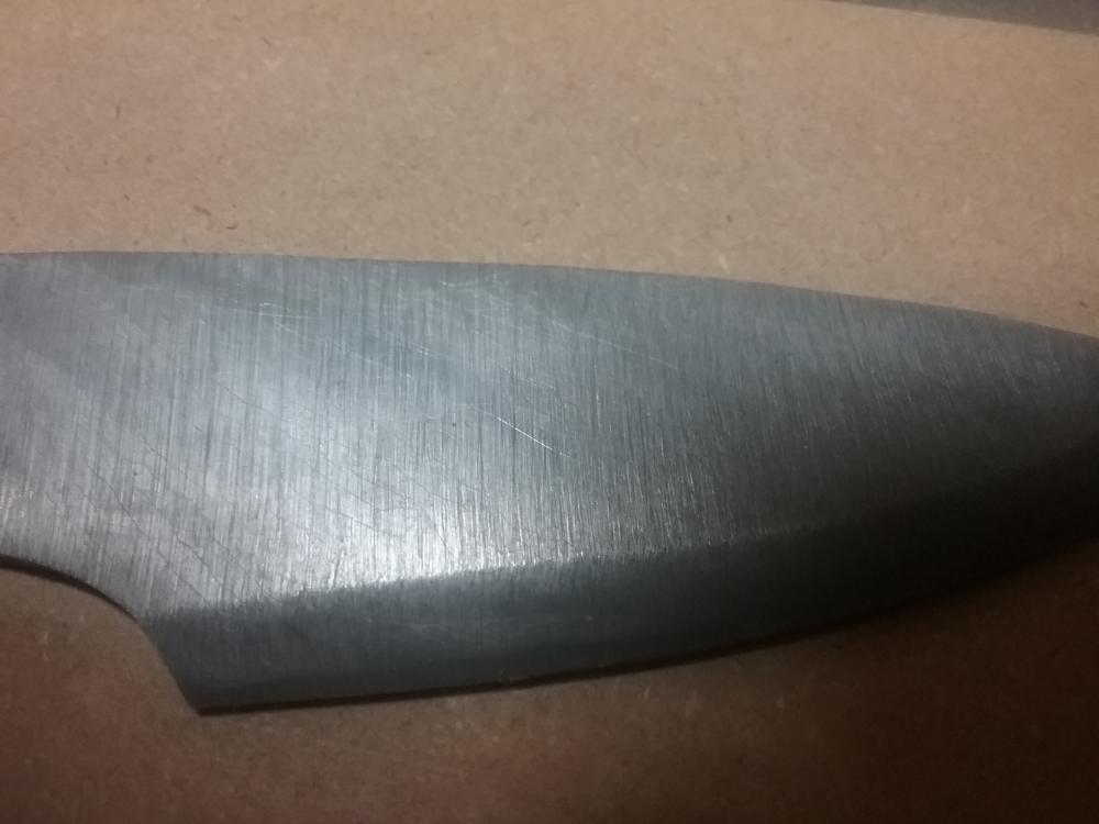

Jonah k Posted April 9, 2018 Author Share Posted April 9, 2018 Well I gave this another try this weekend.I used some of the suggestions above which helped, thanks. The blade turned out with no weld flaws this time and I changed the profile a bit but I had a few problems with hardening. I assumed the file was 1095 and I have no idea what the cable was but I heated a little past non magnetic and quenched in warm canola oil. The core-file hardened I think but the cable Damascus didn't really harden and it seems I have kind of a soft ish spot in the San mai edge.Maybe the cable is weather hardening w1 maybe. I tempered in the oven twice at 450f and I straightened it a bit between cycles and during the last one. The pattern looks good and the San mai looks centered. So anyways I am gonna sharpen it and clean it up and see how the edge holds up, it's just roughed in right now.follows is a bunch of pics of the process. Last one shows pattern and the San mai is hard to see in the pic also I just dipped it in the acid long enough to see how the pattern turned out.anyways here they are. Pics are backwards Quote Link to comment Share on other sites More sharing options...
