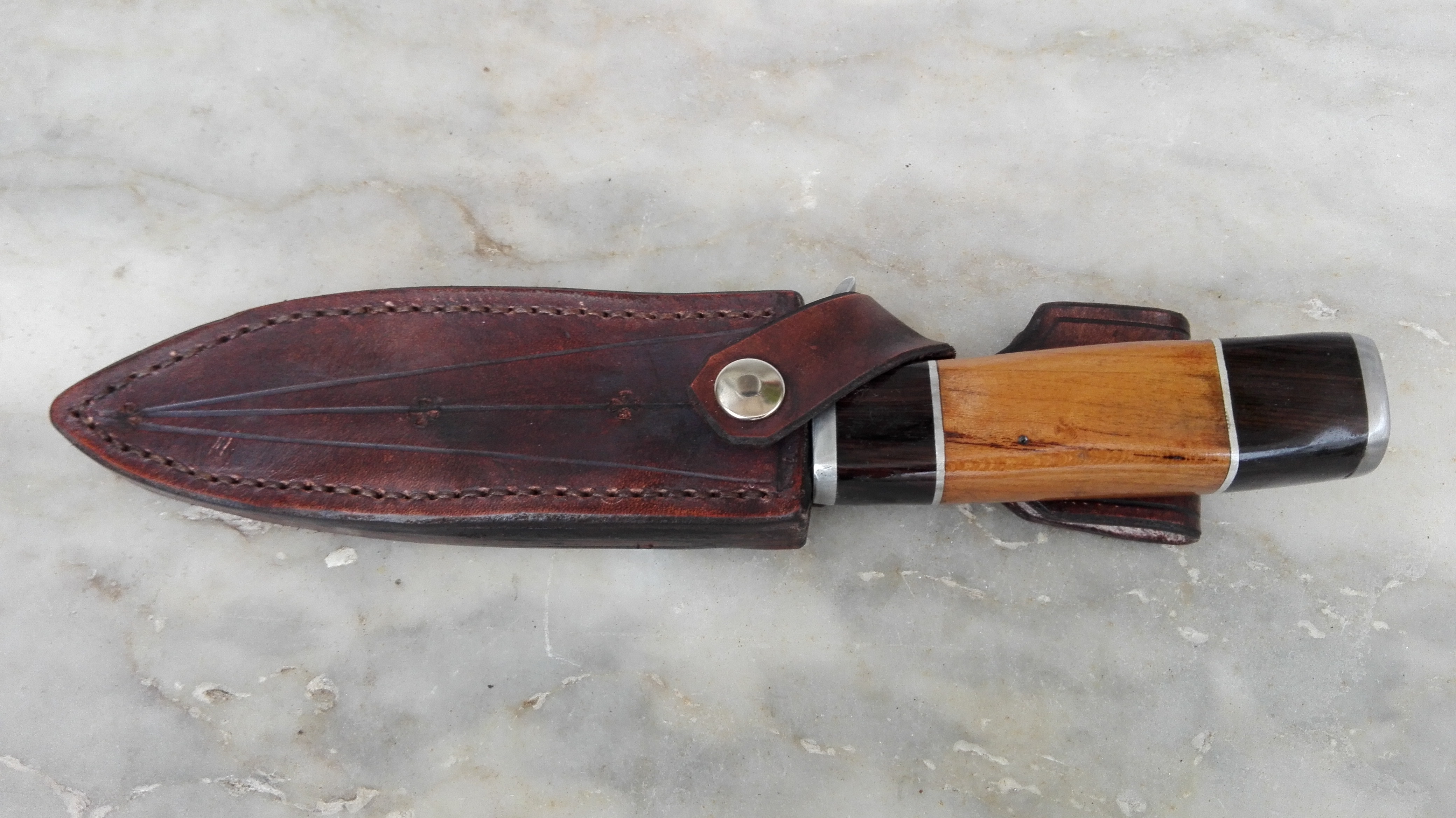

In celebration of my 30th anniversary , here's a small hunting knife of my signature style.
Blade of spring steel, diferential hardendend, lenght 14 cm, width at base 5.5 mm. Alluminium guard
Handle made of palo santo and cherry tree with alluminium spacers and steel butt cap screwed and pinned tang.
Sheath made from 5mm thick leather.
I've etched the blade with lemon vinagar to give a darker look, it's not a blade with great edge holding like my other ones from file steel but one of the sharpest and strongest knives I've made yet.
Still trying to figure out the right finish for the palo santo wood, the varnishes I use take days to completely dry.
Cheers
Nice! I really like the handle, the fit and finish on it looks great, and the sheath fits it very well. I personally would have put a ricasso on the blade, but with that big guard on it, its not necessary.
Great work.
Nice job D.IVO.
I like the handle and guard a lot. I also really like the blade shape/design too. It seems very well balanced and sturdy!
Appropriate if they will hammer on it to disjoint a deer/elk/bison/? ; of course then the handle is off for working in wet slippery situations.
