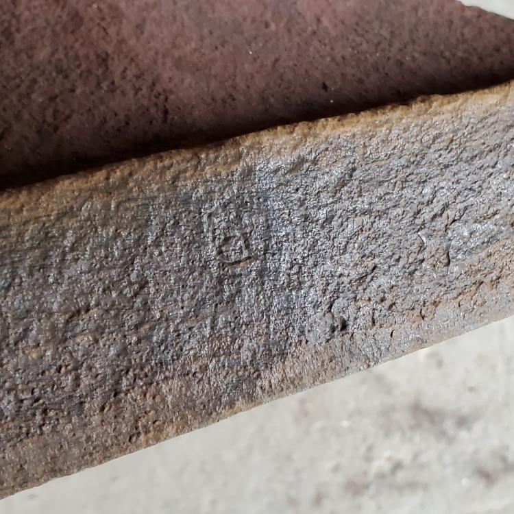

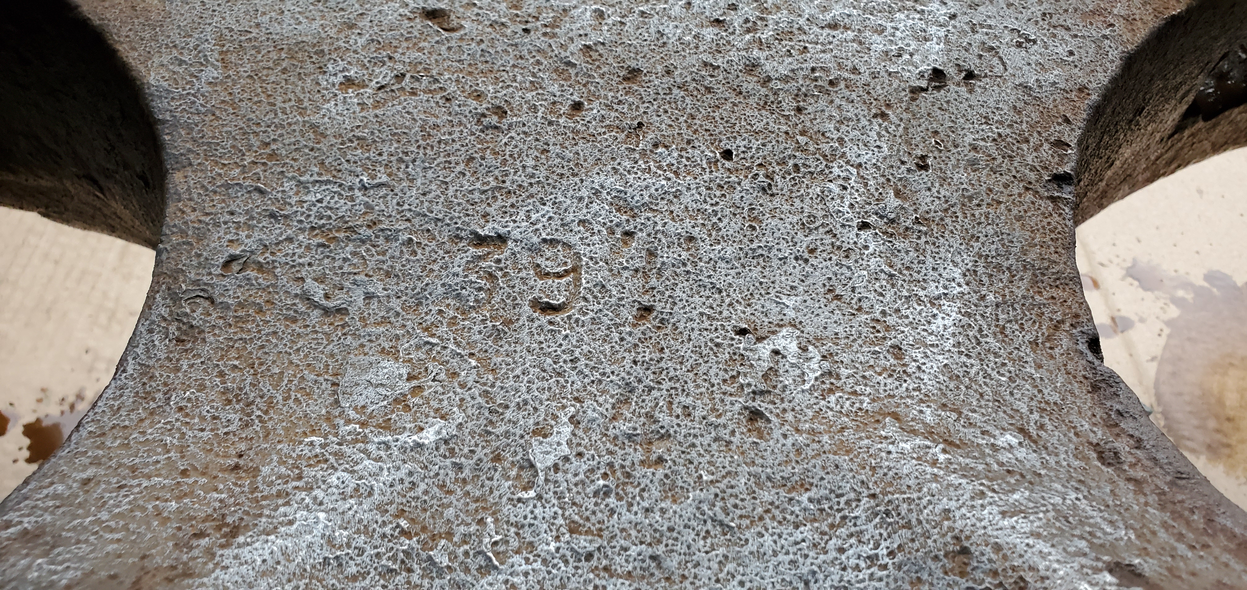

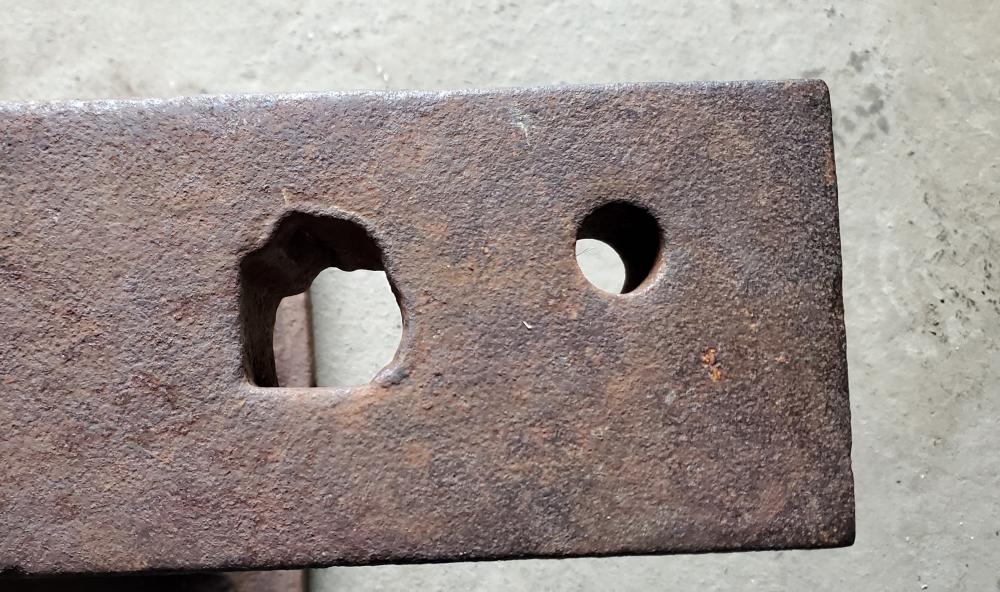

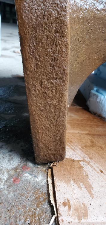

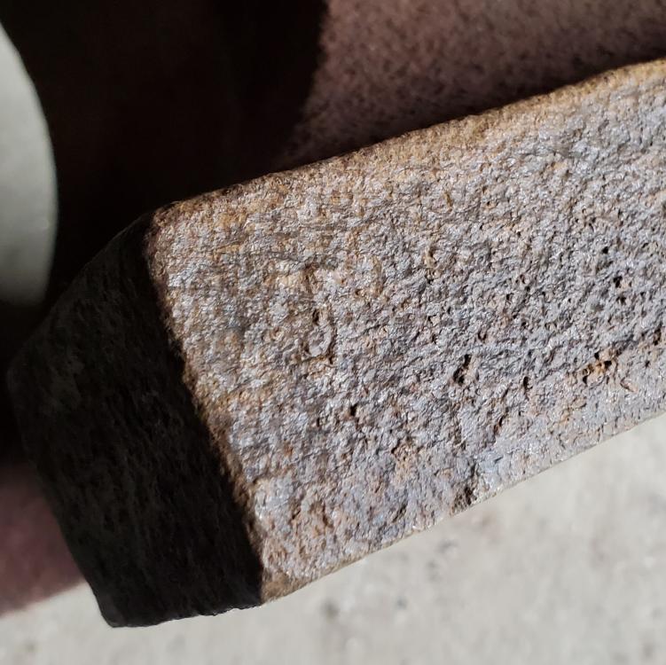

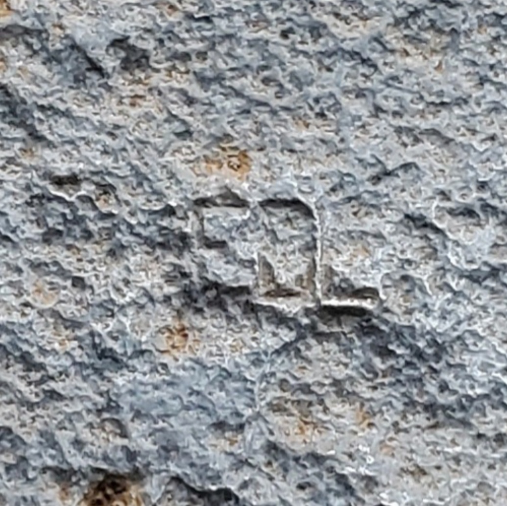

grisaille Posted November 1, 2020 Share Posted November 1, 2020 Hello everyone. This anvil came to me and I am interested in identifying the maker, if possible. It measures: Length: 36" Base: 15 1/2" x 13 1/2" Height: 16" Face: 5 3/8" x 22 1/2" Weight: unknown so far, but a sight heavier than 250 lbs, as I could just lift my old 250 lb. Hay Budden. I would believe it if the stamped 349 indicates it's weight when made. Obvious damage to hardy hole. Rings like mad. I will be using it but am curious about what sort it is. There are some markings in the photographs that I will not attempt to interpret beyond the 349 that I see on one side just above where the cove dissipates into the side. Lots of rusting had obliterated much of the stamping. Thanks for any insight. ~grisaille Quote Link to comment Share on other sites More sharing options...
BIGGUNDOCTOR Posted November 1, 2020 Share Posted November 1, 2020 Definitely looks cast to me, Swedish? Soderfors, Kolswa,etc... Quote Link to comment Share on other sites More sharing options...
grisaille Posted November 2, 2020 Share Posted November 2, 2020 Yes. Cast. It may well be a Soderfors. I can make out only three letters on one side and they are EDE, in succession, in the same font used in the stamped versions of the word SWEDEN on other Soderfors anvils. Thanks! ~grisaille Quote Link to comment Share on other sites More sharing options...
Chelonian Posted November 2, 2020 Share Posted November 2, 2020 My guess would be Soderfors. Quote Link to comment Share on other sites More sharing options...
Frosty Posted November 2, 2020 Share Posted November 2, 2020 I think Soderfors is likely. Frosty The Lucky. Quote Link to comment Share on other sites More sharing options...

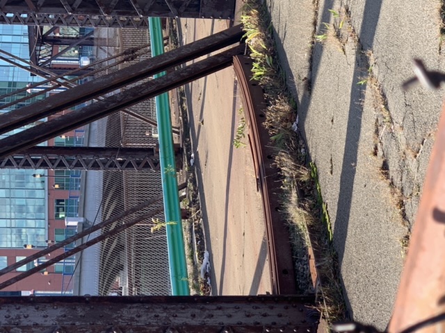

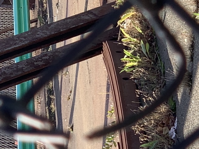

elmoleaf Posted November 3, 2020 Share Posted November 3, 2020 It didn’t follow me home...was walking by Northern Ave bridge in Boston and spotted what look like enormous leaf springs and some plates. You folks got me in habit of looking for cast-off steel everywhere! Amazing amounts of rivets etc in this bridge...all destined for the scrap heap when it gets demolished in a few years. Quote Link to comment Share on other sites More sharing options...
