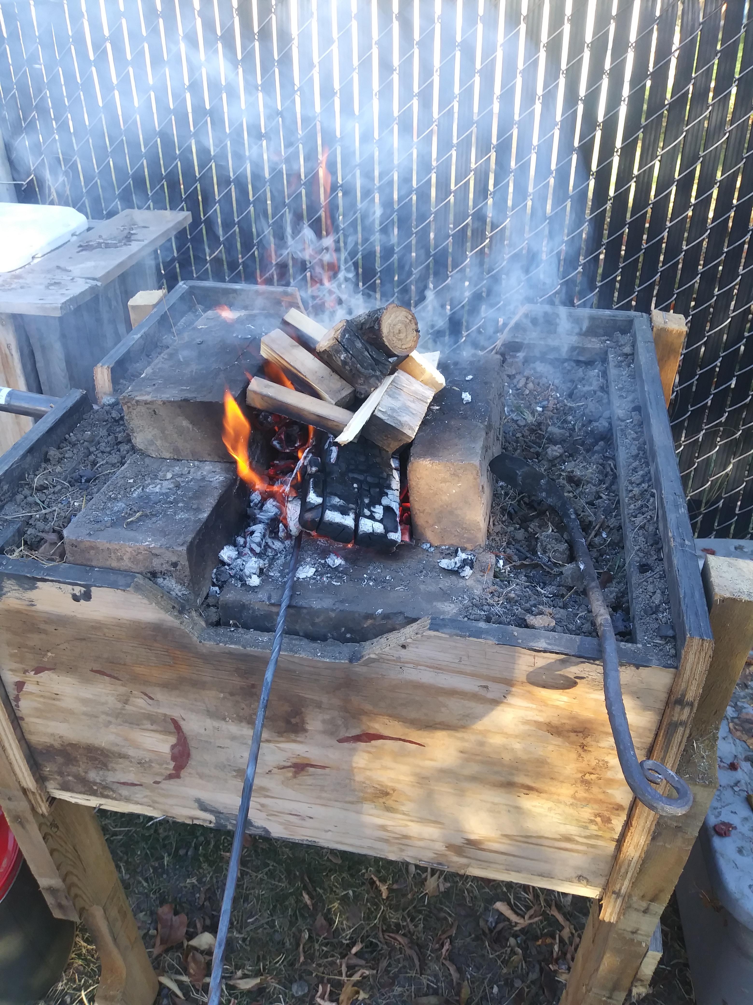

  3. Got to fire up the forge and work for a bit today. Making charcoal on top of my charcoal worked well today.

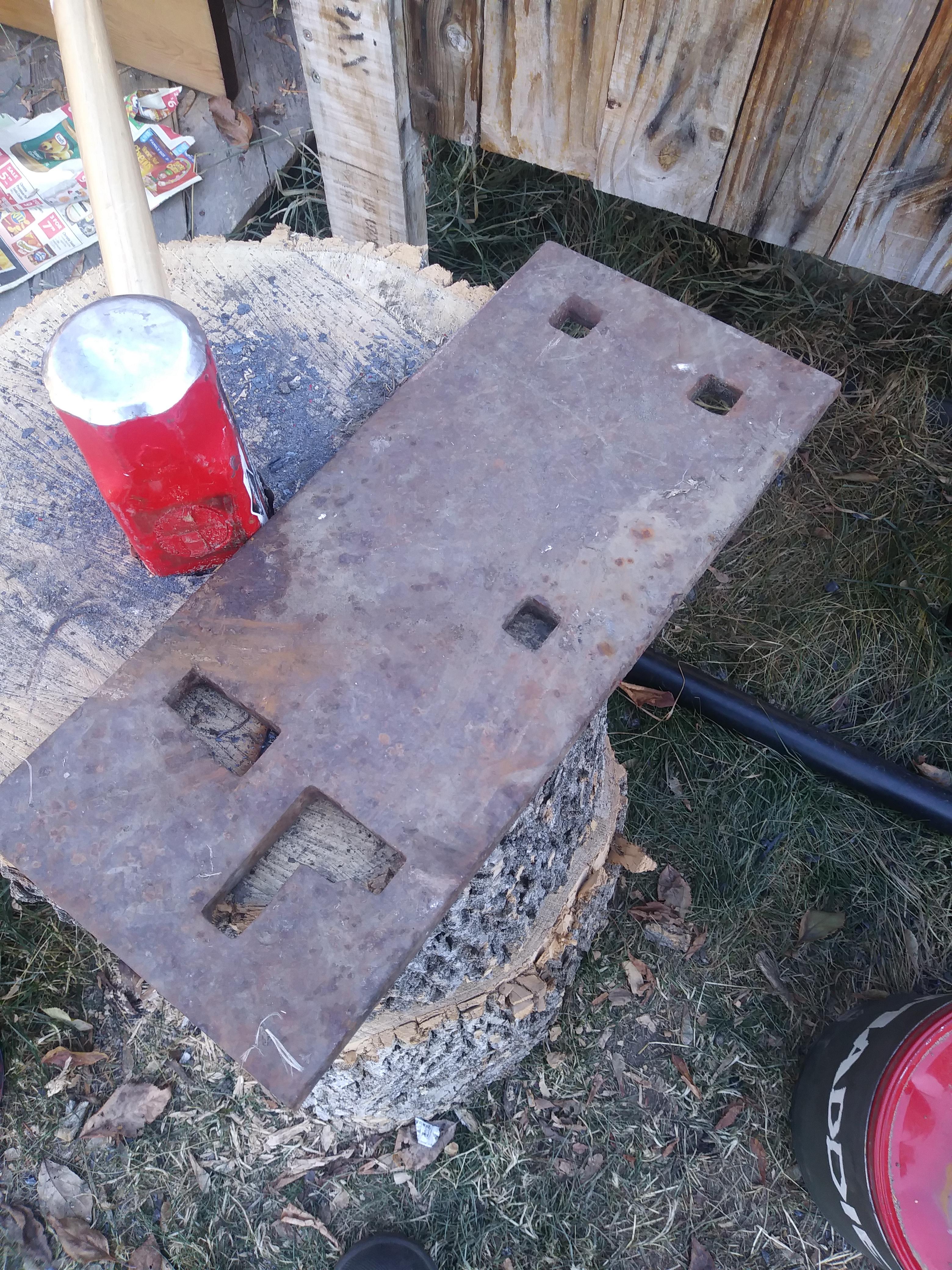

  5. This followed me home. Will be lag bolting it to the stump for some extra whacking area and hardy tools
  6. She might give it back this way....Depends on her mood I guess...one more reason to cut that handle off.
  7. Until my wife's feet touches it.....

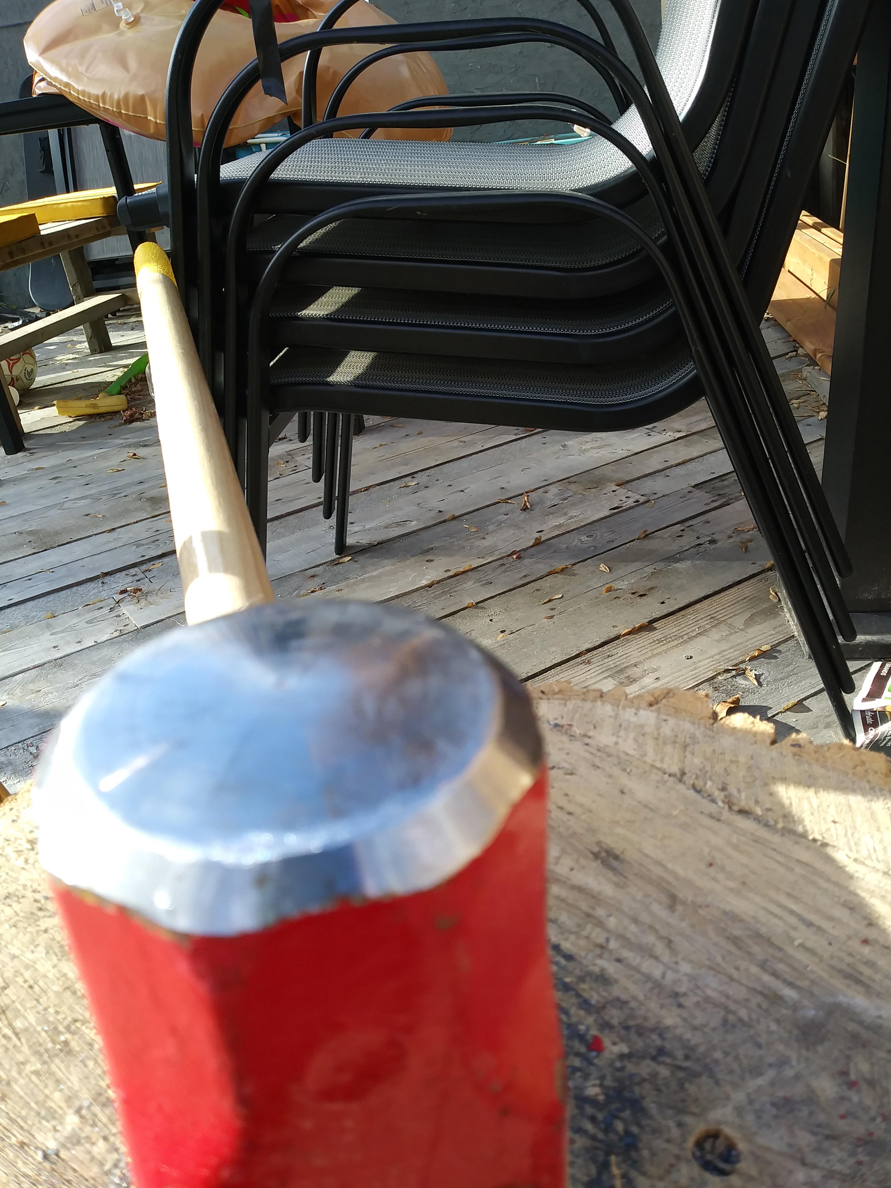

  11. Thanks for the input! I'll see how it works out here in the near future.
  12. After hitting a bit more, I'm thinking it looks better....certainly feels better, no real distinct edge as compared to before.
  13. I hit it up with a file a bit today. What's your opinions on what's been done, or still needs to be done.
  14. I went and picked up some hot rolled steel bars today of various sizes for the next projects. The rebar piece was just something laying around to muck about with. Next projects will likely be a hot dog stick. I saw a YouTube video by the "Essential Craftsman" where he made one and it's piqued my interest.
