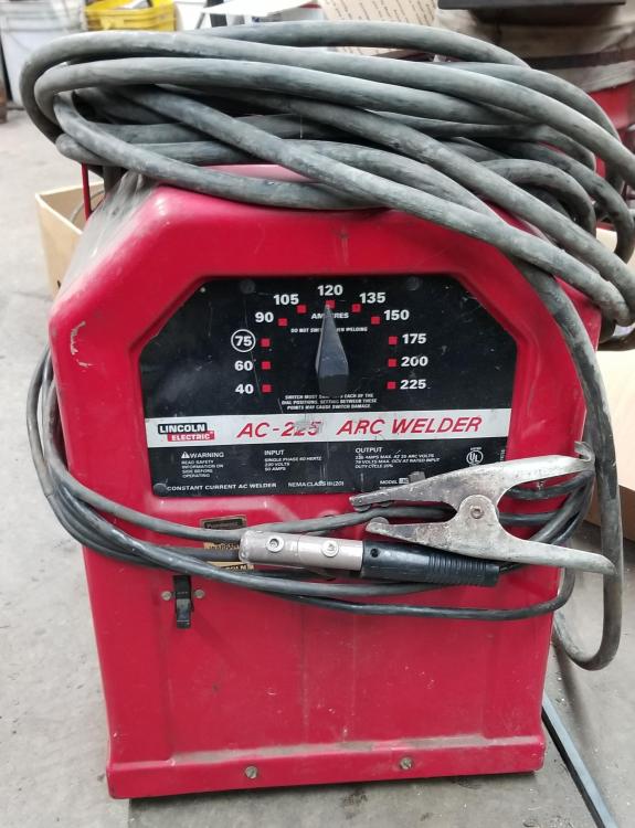

Daswulf Posted September 26, 2019 Share Posted September 26, 2019 For sure CGL! Hope you get to. An old lincoln tombstone stick welder followed me home today. Lucked out as a mechanic I used to work with had just posted it on fb. Seemed fair enough since the longer cord on it is at least probably worth the $50.usd asking price. He said it works and he seemed trustworthy enough when he worked at our shop. Funny enough, I've never used a stick welder. Figured it would be a good addition to the welders and as soon as I get some rods and time I'll give it a try. Good backup welder to have anyway I'd think. Quote Link to comment Share on other sites More sharing options...
JHCC Posted September 26, 2019 Share Posted September 26, 2019 Same kind as Fowllife used to weld up the frame of The Pressciouss. Quote Link to comment Share on other sites More sharing options...
BIGGUNDOCTOR Posted September 26, 2019 Share Posted September 26, 2019 Don Shears, that tamping bit would make a nice post anvil, bell stake. CGL- nice score on the horseshoes. And yes, definitely go visit him again when you have more time. Sounds like a N.O.G. to me (neat old guy) Das-that is an AC only welder, so make sure you use the appropriate rods as not all run well on AC. But that is a good deal you got. Thomas- sounds like a good gig for you. Congratulations. Quote Link to comment Share on other sites More sharing options...
Glenn II Posted September 26, 2019 Share Posted September 26, 2019 That's a nice little welder, Das. I was going to make some recommendations about its use, and figured I better fact check, since I've been out of welding school a good number of years. Glad I did. Better to keep my mouth shut and let you all THINK I'm an idiot, than to open my mouth and prove you right! Quote Link to comment Share on other sites More sharing options...
Daswulf Posted September 26, 2019 Share Posted September 26, 2019 Glad it sounds like a good machine for the money. Biggun, I'll have to do a lil homework on that. Thanks for the heads up. Glenn, you know more than me. never struck an arc with a stick welder. I'll study a bit before jumping in it. How hard can it be. I'm a mig guy. I just couldn't pass up broadening my equipment and knowledge along with it. If I dig it maybe I'll get a broader capability machine and pass this deal off to the next person starting out. Quote Link to comment Share on other sites More sharing options...
Irondragon Forge ClayWorks Posted September 26, 2019 Share Posted September 26, 2019 I think once you strike and arc and learn how to keep it stable, you will wonder how you have gotten along without it. I have a Tombstone just like it, only probably 20 years older and still use it to weld heavier metal. They are like the Energizer Bunny, just keep going and going. I still love the MIG welder though. Quote Link to comment Share on other sites More sharing options...
Daswulf Posted September 26, 2019 Share Posted September 26, 2019 Wouldn't doubt it one bit Irondragon. I will say the hobart ironman 230 had certainly been a missing component for the heavy gauge needs, but this will be added flexability with all the different rods they make. (Atleast the ones usable for the ac only machine.) I'm excited to try it out. Quote Link to comment Share on other sites More sharing options...
tdriack Posted September 26, 2019 Share Posted September 26, 2019 50$ for the welder is a great deal if it is operational. - Nice! I'd probably pop the cover off and just make sure all the lugs are tight inside for good measure. Grab some 1/8" 7018AC rods and give it a go to see if it works well. Quote Link to comment Share on other sites More sharing options...
Glenn Posted September 26, 2019 Author Share Posted September 26, 2019 Open it up and vacuum out any wasp nest, mouse nests, and spider webs. Disconnect the electrical leads, clean them, and then put them back tight. Think of it as maintenance. Quote Link to comment Share on other sites More sharing options...
Chris C Posted September 26, 2019 Share Posted September 26, 2019 Das, you luck dog! I've been searching as hard for one of those as I have an anvil. Cheapest one I've found was $150 and looked as if it had been through a tornado! Some Day. Chris Quote Link to comment Share on other sites More sharing options...
Les L Posted September 26, 2019 Share Posted September 26, 2019 Das, that machine is about as bullet proof as can be, not the top of the line, but it will weld every time you flip the switch on. 3/32 & 1/8 6011 is a good all around rod for it along with the 7018 Tdriack recommended. Well worth the $50. Quote Link to comment Share on other sites More sharing options...

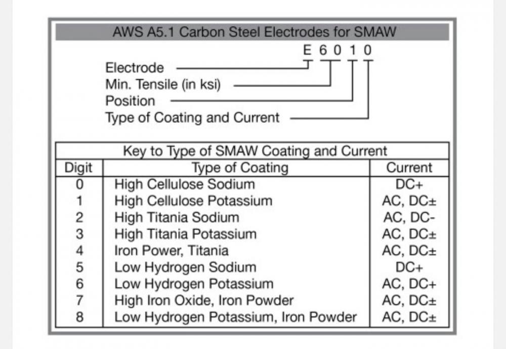

Glenn II Posted September 26, 2019 Share Posted September 26, 2019 Here is a list that explains what the numbers on the rods means. As a pipe welder, I use DC power supply with a E6010 root weld, followed up with E7018 hot pass and cover pass. So in the 7018 rod, for example, 70=70,000 lb/sq inch tensile strength, 1=good for all welding positions, 18= a Low Hydrogen Iron Powder Flux coating. This rod is good for AC or DC current. The key for Low Hydrogen rods is to keep the flux very dry (water contains hydrogen) preferably in a rod oven. 7018 lays a very nice weld, easy to control. If you type "AC vs DC Welding Productivity" into your search engine, it should bring up the article where I got this chart, a very informative read, and nice refresher for me, since I haven't used AC in about 15 years. Also a weld supply store should be helpful in directing you which rods to choose. Quote Link to comment Share on other sites More sharing options...
Reeltree Posted September 26, 2019 Share Posted September 26, 2019 A lot of rods are rated for both ac/or dc Quote Link to comment Share on other sites More sharing options...
Irondragon Forge ClayWorks Posted September 26, 2019 Share Posted September 26, 2019 7 hours ago, Glenn said: Think of it as maintenance. One thing I did with mine was to put several drops of 3 in 1 oil on the cooling fan shaft bronze bushings also. Quote Link to comment Share on other sites More sharing options...

Daswulf Posted September 26, 2019 Share Posted September 26, 2019 Thanks for all the good info! I'll be sure to open it up and give it a go over before I get started. Thanks for the rod info Glenn, Les, tdriack. Chris, it was luck. I wasn't looking for one but it popped up and I figured I shouldn't pass on the deal. Didn't even realize what these go for. Quote Link to comment Share on other sites More sharing options...
