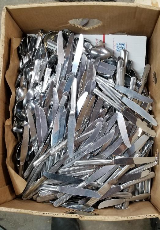

You get the word out and use the TPAAAT, sometimes stuff doesn't just follow you home but starts showing up at your doorstep. Big box of "stainless" silverware wound up in my shop. Many metal sculptural uses for this stuff. Time to get serious with some other projects I've had in mind for silverware. Birds, dragons, reptiles, insects, etc.
