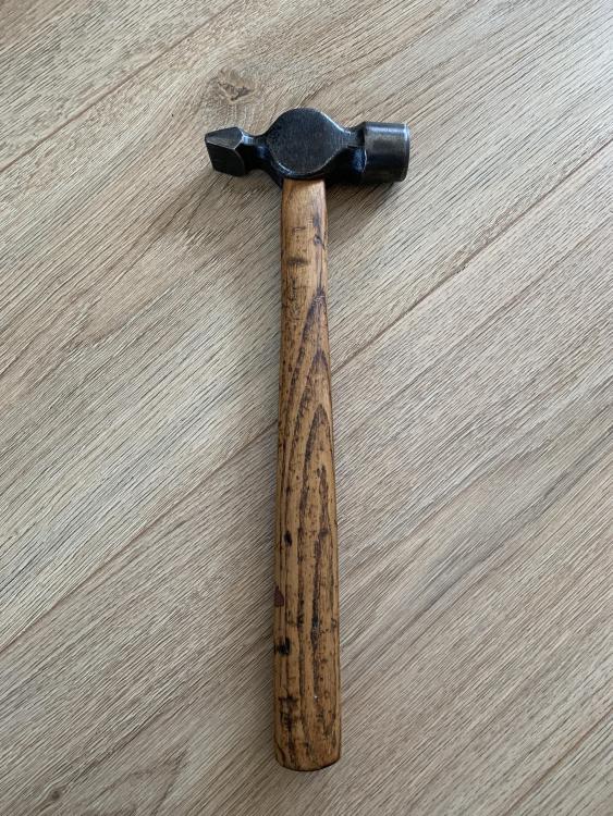

AlexDegens Posted May 22, 2022 Share Posted May 22, 2022 Hi, Found this beautifull 3/4 Lb hammer today. Does anyone have more information about this makers mark. I hope someone can tell me. Thanks! Alex Quote Link to comment Share on other sites More sharing options...
