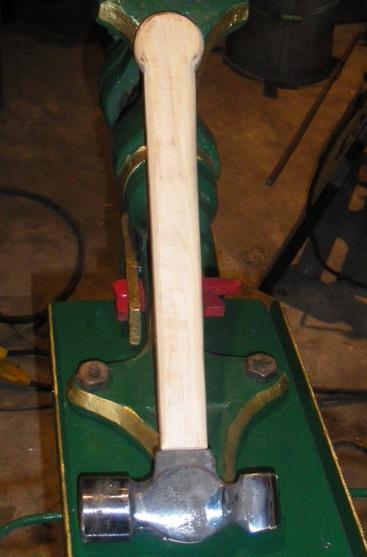

Frosty Posted May 22, 2022 Share Posted May 22, 2022 Nice hammer, sorry no idea about the trademark. I wonder if it's a factory cross pein or a blacksmith converted it. I changed a 32oz. ball pein into a straight pein some years ago and the resemblance is striking. Frosty The Lucky. Quote Link to comment Share on other sites More sharing options...

AlexDegens Posted May 24, 2022 Share Posted May 24, 2022 wicon Thanks for the list! I’m still looking for some sort of list with marks behind names. Maybe putting in some work to make one myself. Frosty Nice! Did you put a steel wedge in across the whole width of the handle? TWISTEDWILLOW I find them a lot. But mostly with a ball peen. I have one other straight peen hammer that i need to rehandle or put another wedge in. It is not completely straight on the handle either. So i really need to fix this. ThomasPowers Do you have pictures. I always love to see other tools. Quote Link to comment Share on other sites More sharing options...
Frosty Posted May 24, 2022 Share Posted May 24, 2022 Alex: Yes, I made the handle from 5/4" straight clear grain hickory cabinet lumber and wedging it the "normal" way with a wooden wedge and a steel wedge diagonally across it doesn't seem to hold so I forged a wedge with barbs and it's stayed tight. Please do NOT use the @ to tag people's names. It messes up the Iforge operating software making the moderators go through the posts and remove them manually. Just use the login or person's real name if you know it, the way I called you Alex at the beginning of this post. It'll help keep you off the moderator's radar which is to be desired. Frosty The Lucky. Quote Link to comment Share on other sites More sharing options...

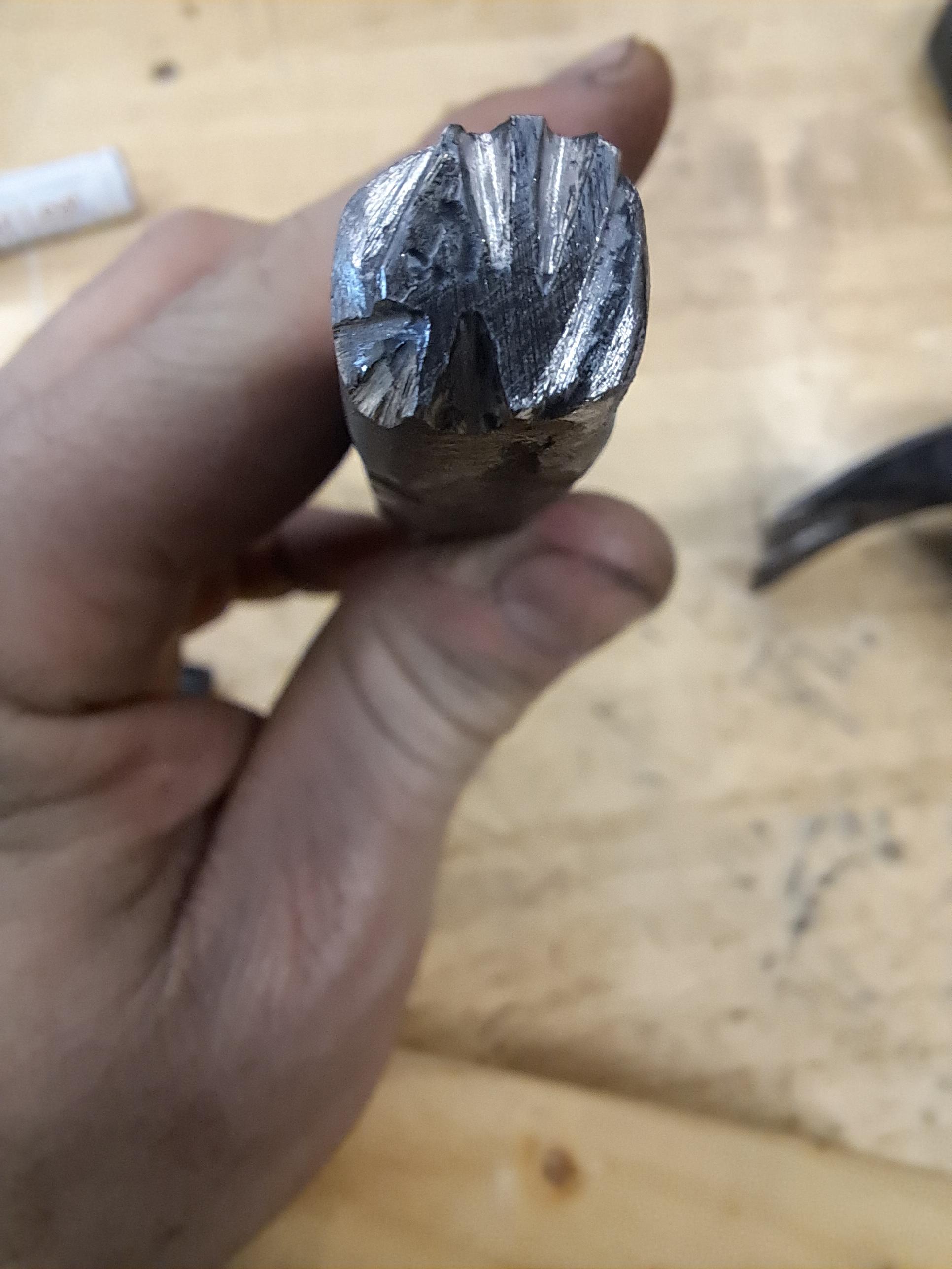

Wandering_R0gue Posted November 19, 2022 Share Posted November 19, 2022 What is people's opinion: does a Touchmark NEED to be made from a hardenable steel, or would mild work? Being used on hot metal, what has more longevity? Thanks! Quote Link to comment Share on other sites More sharing options...
Frosty Posted November 19, 2022 Share Posted November 19, 2022 A lot depends on how fine the detail of the touch mark is of course. But of course a hardened steel punch will last longer a S or H series steel punch probably a couple few generations. Frosty The Lucky. Quote Link to comment Share on other sites More sharing options...
Wandering_R0gue Posted November 19, 2022 Share Posted November 19, 2022 Thanks Frosty. So, either would work, but Hardenable will last longer. Kinda what I figured. Quote Link to comment Share on other sites More sharing options...

arkie Posted November 19, 2022 Share Posted November 19, 2022 I have two touchmarks, one small and one a bit larger, both made from coil spring. The coil spring works fine. Quote Link to comment Share on other sites More sharing options...
Wandering_R0gue Posted November 19, 2022 Share Posted November 19, 2022 The shiny stuff could be high chrome content, but could be plated with something for sure. I just finished mine, made from coil spring: Quote Link to comment Share on other sites More sharing options...
