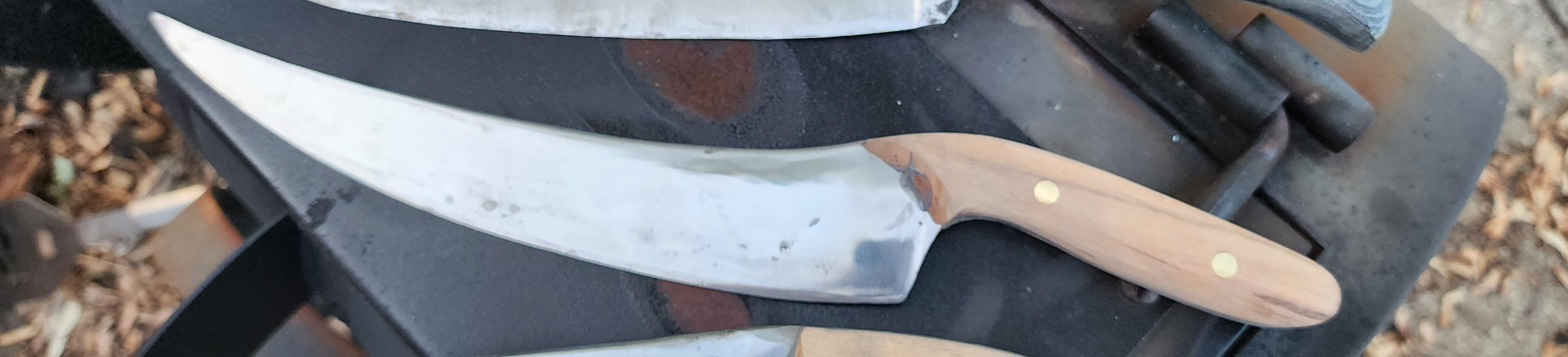

Some time ago my brother mentioned that he'd like to have a small, fixed-blade for handy daily use - opening bags and boxes in the flour-mill, cutting twine.... Lots of Scottish on our father's side and my brother loves heritage themes, so I decided to give him something along the lines of a Sgian Dhu - the little sleeve or stocking knife. Got it done yesterday just in time for his 25th b-day.
Steel was originally a discbine hay mower blade. Throws good sparks when ground. Coupons were made and an oil-quench/draw to straw program were settled on. The handle is cherry that we milled right here. 4 inch blade. 0108251838b-1.thumb.jpg.df737302360a79876b3d29a8df5af47f.jpgIt can't compete with the gorgeous blades I see on IFI but I'm happy with it.
Matt.0207251442a-1.thumb.jpg.79a683cfb18490cb67e46a3d39774d04.jpg0206251454-1.thumb.jpg.d0d9bb5af52e5fa0eacf993c0c83f3fe.jpg0207251448-1.thumb.jpg.e3b5fc82df13e62b041035aac4add1c5.jpg
It's a good size for an every day user. Did you make a sheath for it?

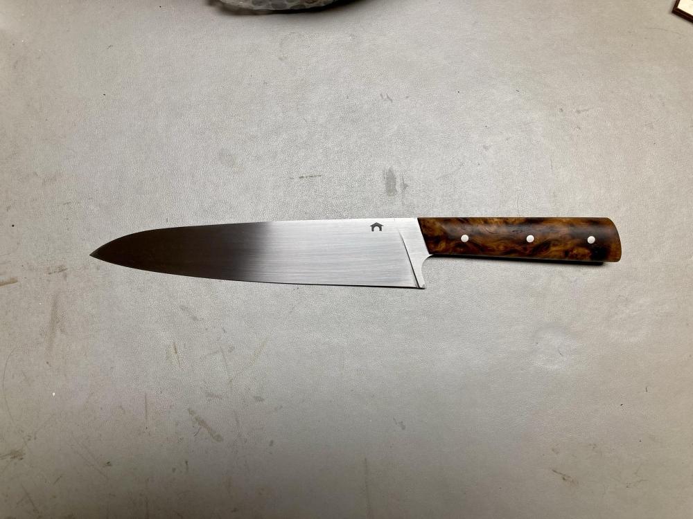

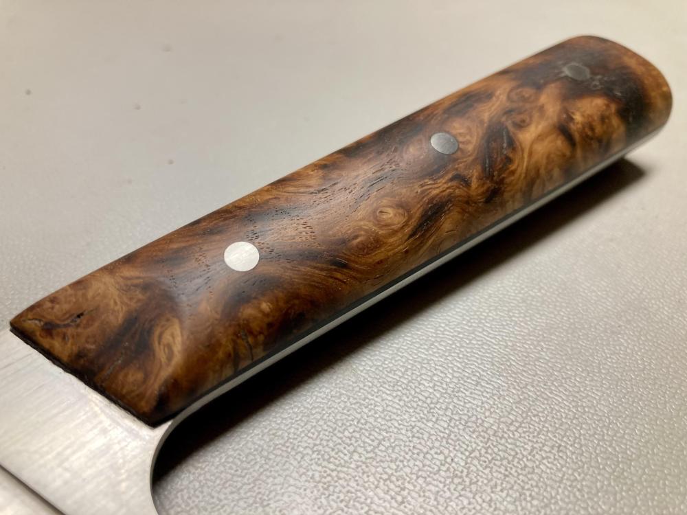

AEB-L stainless kitchen knife. Oak Burl handle, G10 liners, Titanium pins.
IMG_0517.thumb.jpeg.e5c7d952016b8cc0e3ebe21a36b663e8.jpegIMG_0518.thumb.jpeg.41956388f79e3dbd30a3f4bbd53dc98e.jpeg

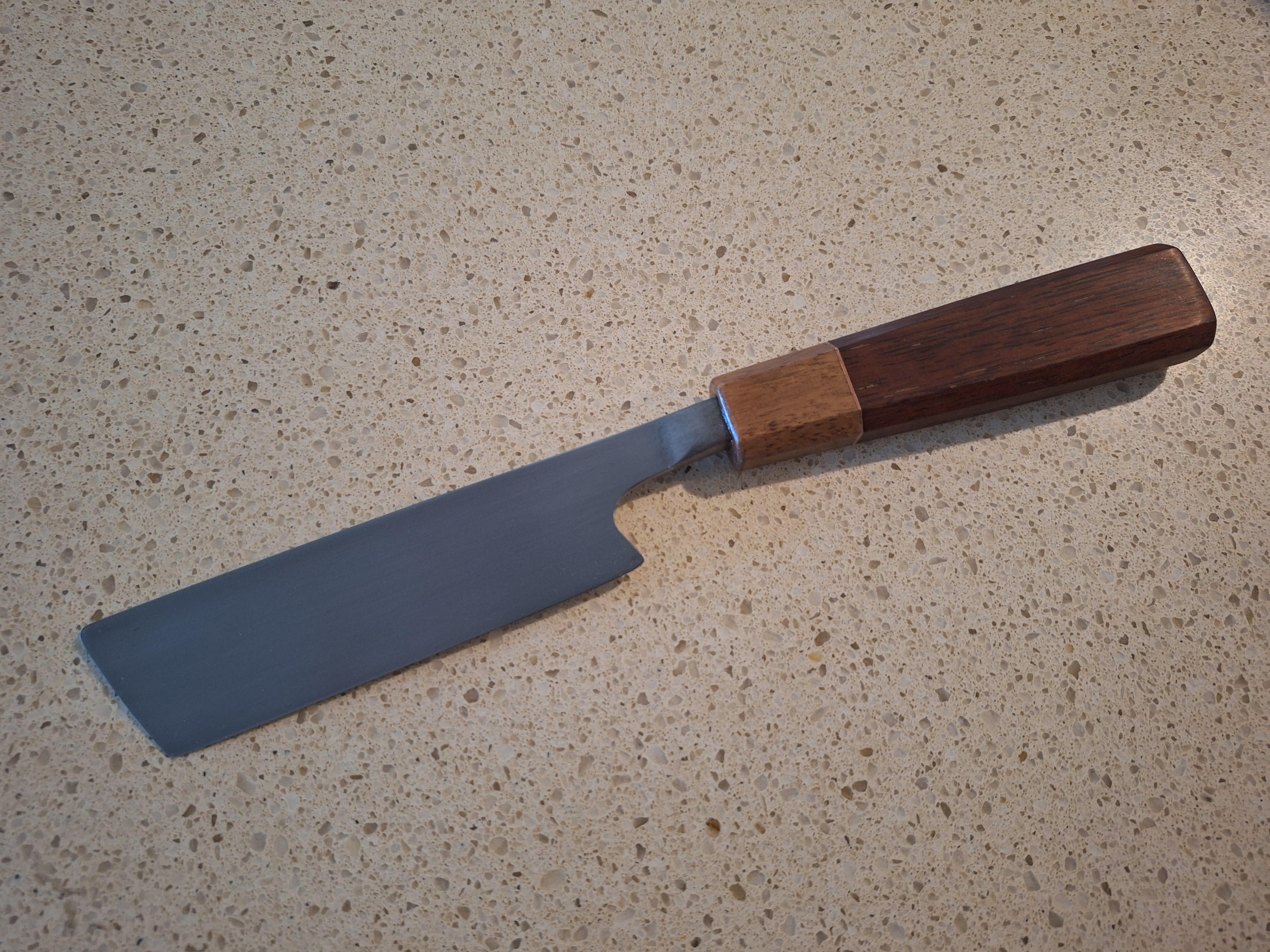

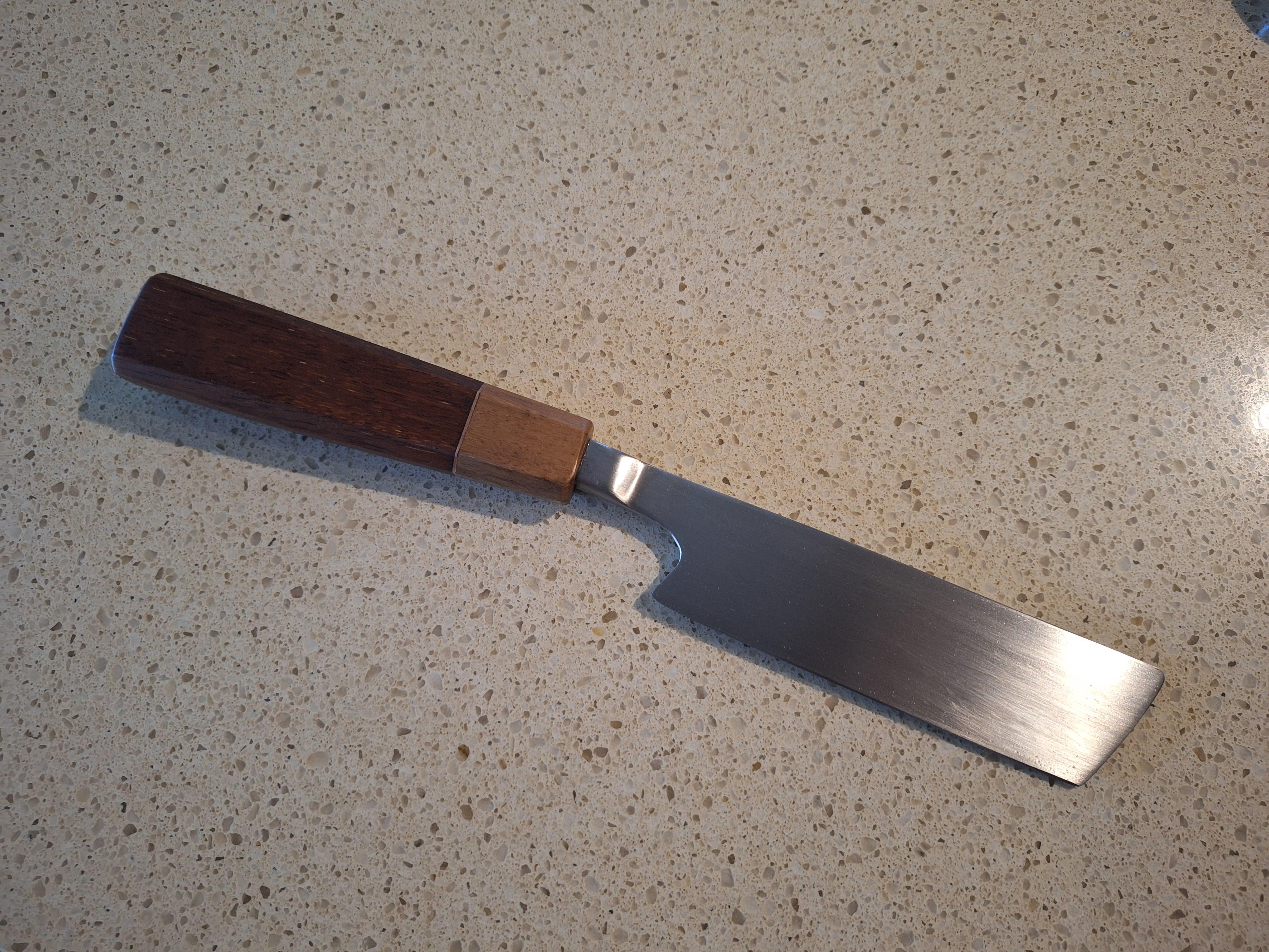

Finished this one for my Dad yesterday. An integral bolster Nakiri out of coil spring with a two-tone hardwood handle with a copper spacer. I think the handle timbers are Kwila and Spotted Gum.
Thanks for looking!
Cheers,
Jono.
Nicely done Jono. What are they used for?
A Nakiri is a Japanese vegetable knife. Single right-hand bevel to help with food release off of the blade for efficient slicing.
Thanks Jono, it's good to know what such a pretty knife is for. I have a couple single bevel veggie choppers myself but I don't do enough veggy chopping it makes a difference.
The single bevel cheese slicer is as unsuitable for it's stated purpose as a politician's promise. Good thing it was a gift I have an excuse.
