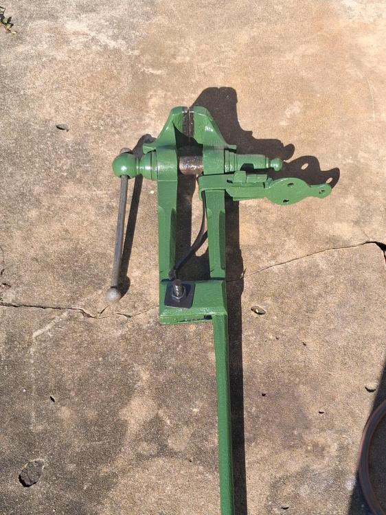

  1. Been really busy for last few months but finally found the time to finish the vice and assemble it. Went with 3in1 light oil for the screw and used some grease for the pivotots working a treat and the jaws line up almost perfectly, quite happy considering the age and that its dont have the original bolt. Overall im very happy with it, I just need to make a sturdy stand for it; the plate is at least 4 inches taller than my existing workbench, which isn't all that sturdy as is.

  3. You could go with 3in1 light oil, irs about $3 at bunnings, thats what i use. At the same i dont think it makes much of a difference, ive been working in a machining workshop the last two weeks and the main screws on their lathes are to so greasy and covered in swarf and filings, it has had no ill effect. I think it is a possibility, but in reality I don't think its that important. Your threads are pretty thin though and it doesn't hurt to get light oil, but I wouldn't worry too much
  4. Looks bloody amazing, beautiful fit/lining up of the jaws. Really.like the meatball on the handle, much better than modern cylinder ends. Do you plan on giving the jaws teeth with file?
  5. Looks incredible jono, like a proper vise. Also nice and shiny When you say swage pipe over the threads, do you mean hammer heated pipe over the threads to try and imprint the threads on the inside of the pipe? I don't think thats really possible because it would shrink once it cools anyway. The only way I could see getting the threads on the inside of a pipe is through tapping, and taps are mighty expensive. I would suggest making your own tap from the bolt by grinding away three grooves on the end and hardening it through a quench, effectivly creating cutting teeth like a standard tap, but i think the steel in bolts is just too soft unfortunately. Ive thought about doing that many times but never tried it. When you say the screwbox is keyed, do you mean has a lug or indents that corresponds to the immobile leg to prevent the screbox turning? If so you could always weld on two lugs onto the vise, touching the flat sides of your threenuts, this would stop them spinning. My vise isnt actually keyed, its stopped from spinning by friction and tension, its a tight fit on the sides so the screwbox can pivot vertically, but doesn't want to turn. Also I've noticed the hole in your leg is only wide enough for the bolt, usually the screwbox extends into this hole. Shouldn't make much of a difference though.
  6. Also I've an idea for a spring that will fit in your vise even without the usual clamp. Ive put in a photo of the end of my spring, its got a T end with the arms bent so they wrap around the leg, the other end is held by the clamp. In your case, you could make a spring just like this, only at the other end it bends back in a V shape to hold onto the other side, like in the drawing. The pointy end of the v could sit in the enclosed box area at the hinge with both ends of the v having flaps that wra around each leg. Where you have the hole for the screw, the jaws get wider and this would stop the spring from sliding upwards.
