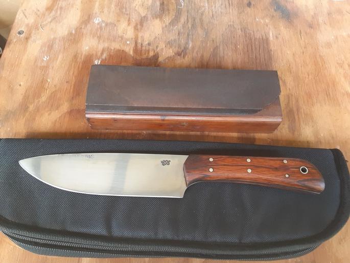

  1. Hi, What answer??? LOL! Hi, Thank you! The wood void is only on the surface and not all the way thru, so I used it. It is filled with hard wood putty, so should be fine and has a burl look to me. This knife was NOT clay treated to create an Hamon, but was edge quenched. I use WATCO Danish Oil Finish, and put a coat on a day for about 4 days and lightly rub with #0000 steel wool between coats. Thank you!

  3. Hi, A Buddy, I owe a big favor to... Asked me for a Kitchen Knife, so got on the Forge this week... This is made from a worn out File. I normalized the blade 3 times to shrink the grain and then quenched in warmed Transmission Oil. Edge quenched, and in finishing the blade etched it in PCB Etchant and then Stone Washed the Blade. You can see the Quench/ Hardening Line, if the light is right. Tempered in my little Oven with a PID at 400 degrees for 2 hours. With my Japanese Hardness Files, came out about 59-60 Rc, which is perfect for me. (opinions vary!) Handles are my Farm Cut, Alabama Red Oak, with a light brown leather dye stain, finished with WATCO Oil Finish. Pinned with Nickel Silver Pins... Still applying Oil Finish, and will for a few days... Will finish up with Johnson's Paste Wax. Already sharpened it and the edge came right up and will shave you, easily... Just thought to show what I have been enjoying with this nice cool weather now in Florida!

  5. Hi, Thanks, it's for a divorced friend, that has to cook his own meals now. These files are pretty good material to forge, as it is good steel and the right size to completely hand forge on the anvil.
