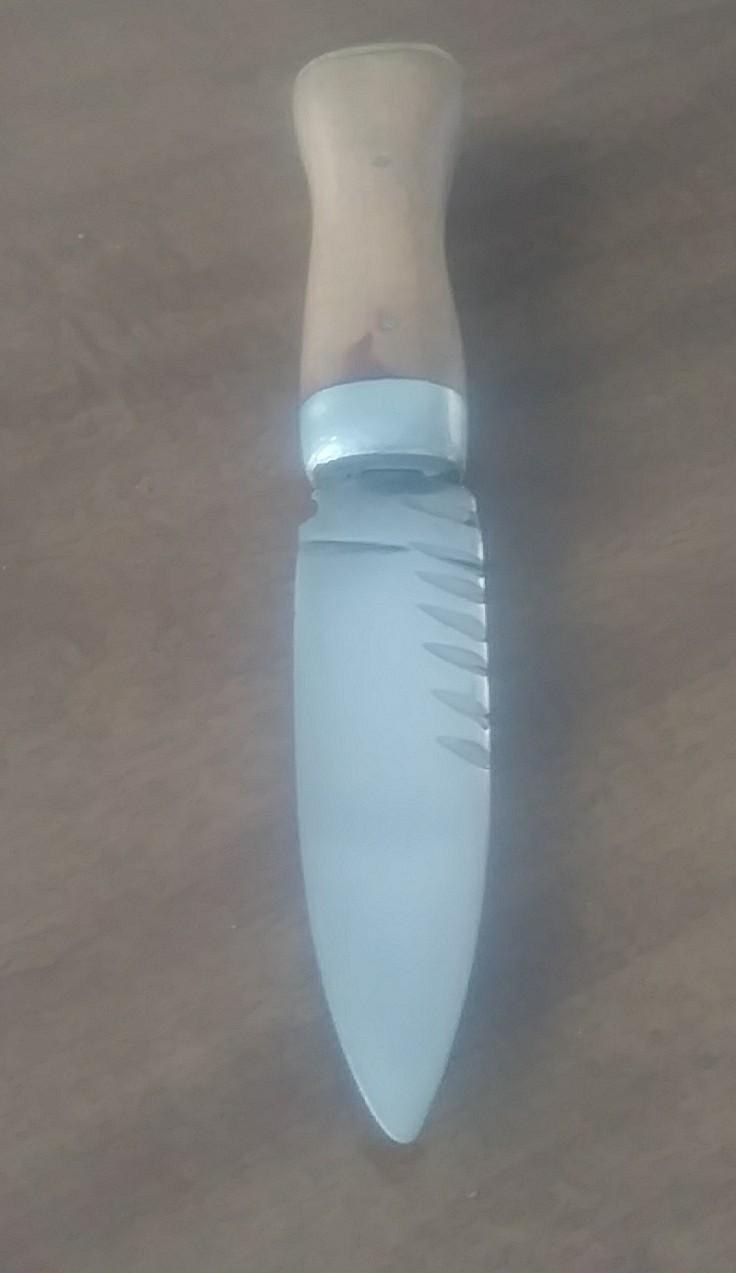

Some time ago my brother mentioned that he'd like to have a small, fixed-blade for handy daily use - opening bags and boxes in the flour-mill, cutting twine.... Lots of Scottish on our father's side and my brother loves heritage themes, so I decided to give him something along the lines of a Sgian Dhu - the little sleeve or stocking knife. Got it done yesterday just in time for his 25th b-day. Steel was originally a discbine hay mower blade. Throws good sparks when ground. Coupons were made and an oil-quench/draw to straw program were settled on. The handle is cherry that we milled right here. 4 inch blade. It can't compete with the gorgeous blades I see on IFI but I'm happy with it. Matt.

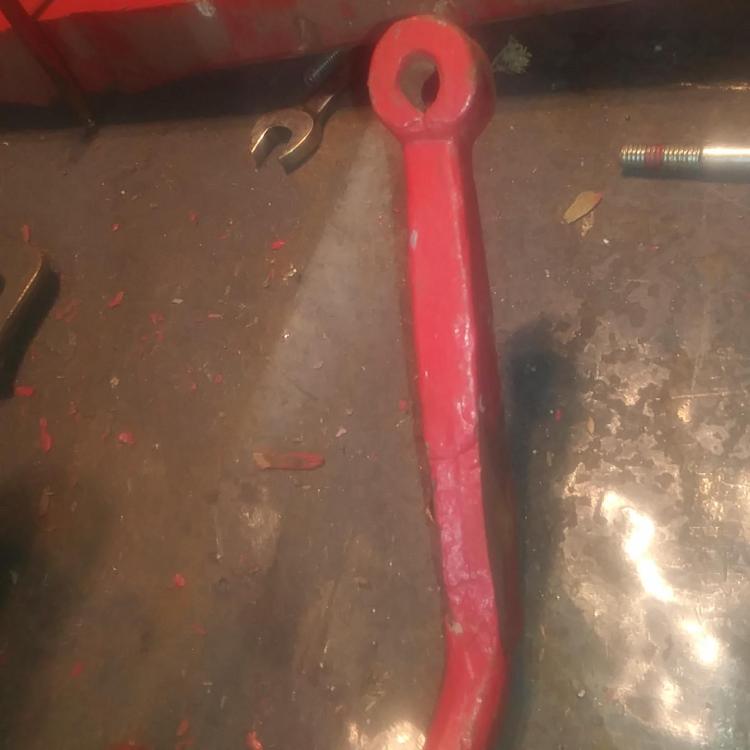

Antique Sleigh repair
I need to see if I can get any hard info on it but my smithing friend and I both guessed right around 1900 also - although it is only a guess. Here's the last piece: this is called a bird's mouth. It sits on the very front of the pole to help hold-back on a downhill. The chain and ring are something I came up with a couple of years ago for his other poles. They function somewhat like a tavern-puzzle: when the chestbar pushes on the chain, the ring locks in place completely; but at a standstill you can flip it off with one hand. Really glad I had the chance to get my hands on this old sleigh. - Matt.

Here you can see the original forge-weld on the brace-piece and pivot. The craftsmanship in the steam-bent oak also amazes me. There was more splitting on the cross-tree ends. Made up tapered collars so that the torque doesn't center on the split wood.
