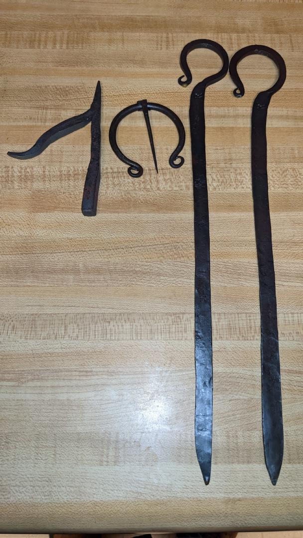

TommyVee Posted November 20, 2022 Share Posted November 20, 2022 Another weekend, another part of a Sunday afternoon available to play in the shop and try to learn something. Made two more skewers (finishing off a set for a Christmas present) and a penannular brooch (smaller than my last try, with a more uniformly tapered pin this time). Then I tried my first forge welds. First try was over-ambitious, trying to weld together four bits of wire from political signs, hoping to make a basket twist. This was an abject failure, partly because I didn't have them bound up tightly enough to stay together at heat, and never got them to stick to each other. So I gave up on that and tried a fagot weld in 3/8 square bar instead. My first try went very well and I was so pleased I folded the welded bit back onto the main body and tried a second one. That one didn't go so well and only welded for a little ways away from the fold. I decided to turn the practice welding piece into a practice fire poker and just drew out the welded parts into points. The first weld is there in the part that forms the long, straight part of the forked part of the poker, the second at the tip. I was pleased to find that my gas forge was able to be pushed hot enough to get the job done. It was clearly hot enough to do the weld of the bundle of wires if they had been straight enough and held tightly together enough. That may take a lot more practice. Quote Link to comment Share on other sites More sharing options...

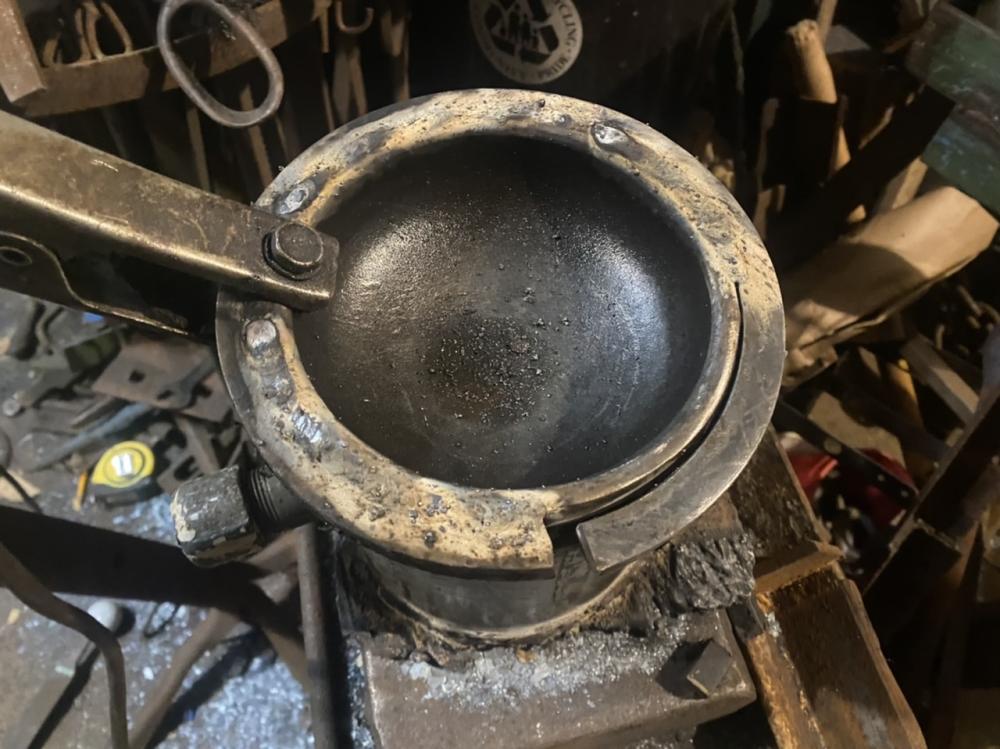

JHCC Posted November 21, 2022 Share Posted November 21, 2022 Improvements to the newest bowl form: welded on a rim made from 1/2” square bar, bent cold on the fly press. Quote Link to comment Share on other sites More sharing options...

Shainarue Posted November 21, 2022 Share Posted November 21, 2022 Nice work Tommy. I haven't braved the forge welding yet, but then I also haven't had a project that warranted it yet either. I like the improvement JHCC. Billy B, the back side of the door hanger could be curled and used to hang something on both sides. Quote Link to comment Share on other sites More sharing options...

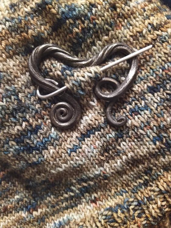

Shainarue Posted November 22, 2022 Share Posted November 22, 2022 Chimaera, best option I had in wood was a 2x4 and it was just too beefy for such a tiny piece. A small branch would have been nice. Tonight's brooch. I decided to go with the 1/8" round for the brooch and piano wire for the pin. Also tried a different pin attachment method and curled it around instead of just a single fold or loop. It's Ashley's favorite so far. On 11/19/2022 at 11:39 PM, Glenn said: Moving the forge closer to the door will save a couple of steps and make the move from the forge to the anvil quicker. Here's a video of forge to anvil from tonight. I could move the forge about 6 inches closer to the shed but that's it. received_1144149232884364.mp4 Quote Link to comment Share on other sites More sharing options...

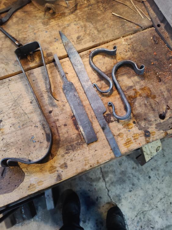

Chimaera Posted November 22, 2022 Share Posted November 22, 2022 Got my first hidden tang finished. The blade is snapped and welded, the guard is scrapped, and the handle is rough- but it’s a knife. Oh, I also had to use my tan epoxy which looks like trash. Got two old knives reforged into more pretty and practical shapes, and have two itty bitties started for next time- a squirrel tail and a hidden tang. Also got my new flatter back from a friend: just need to find a handle and dress the face. Quote Link to comment Share on other sites More sharing options...
Les L Posted November 22, 2022 Share Posted November 22, 2022 Chimaera, The knives look good. Quote Link to comment Share on other sites More sharing options...
Chimaera Posted November 22, 2022 Share Posted November 22, 2022 Thanks les. I feel really stupid, both of those top ones I’ll have to re heat treat- they picked up warps that I didn’t notice in my rush. I think they’ll be fine though once I get them straightened out. Quote Link to comment Share on other sites More sharing options...

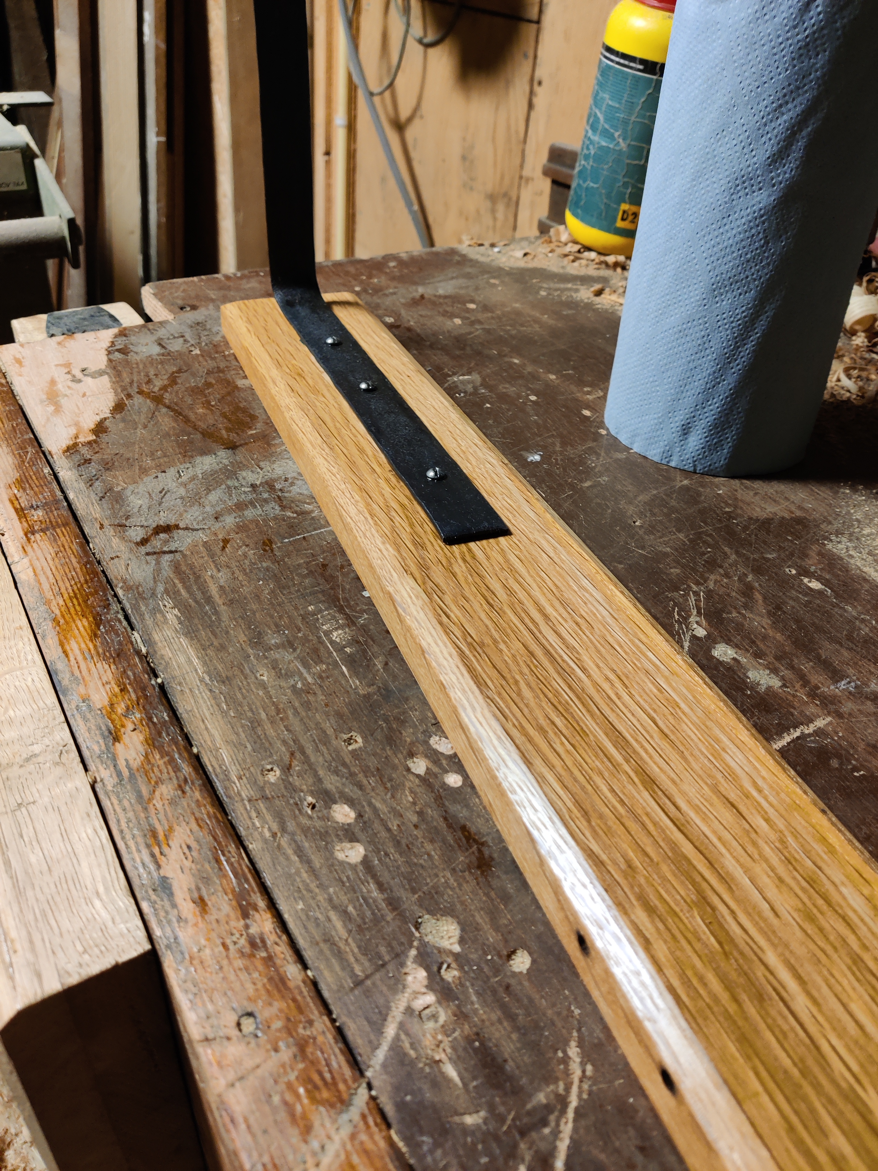

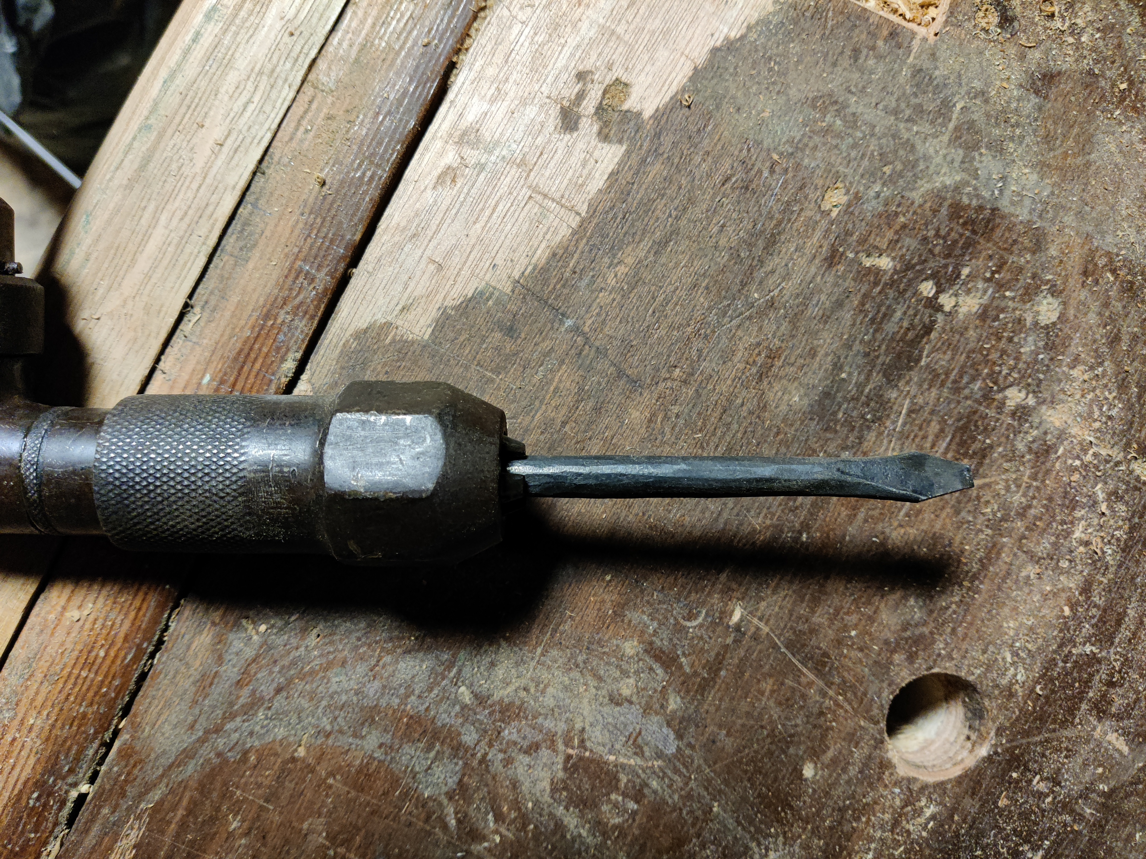

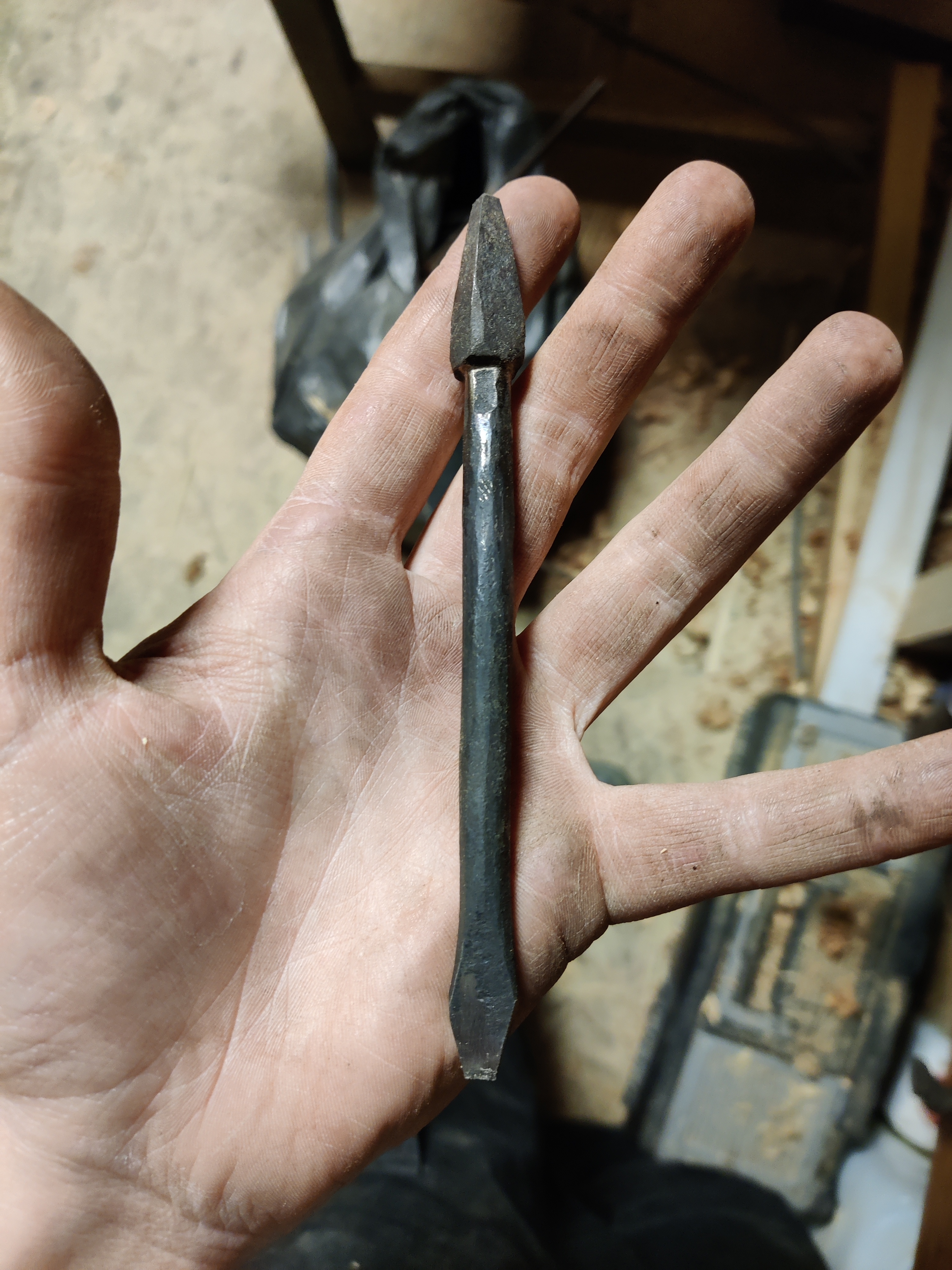

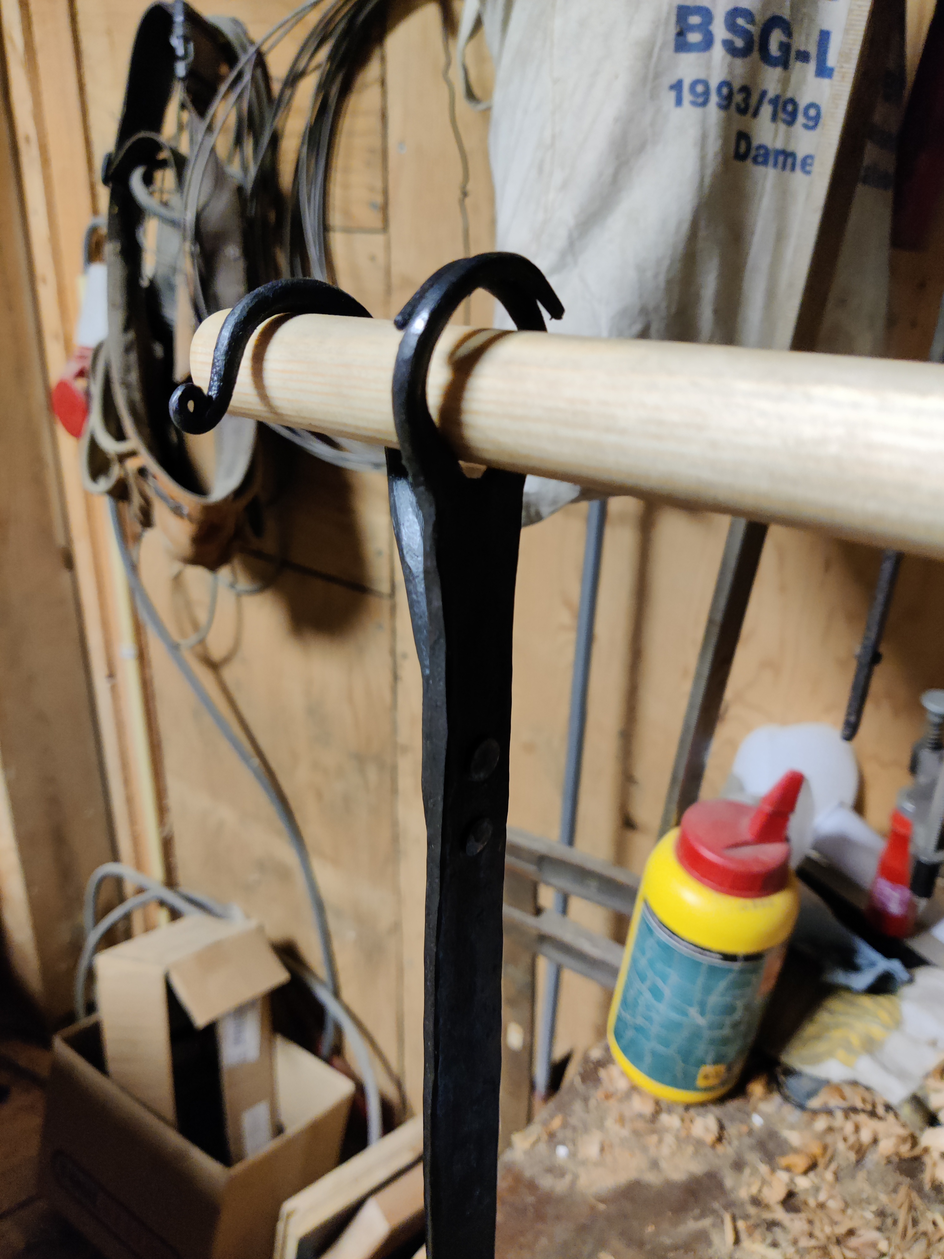

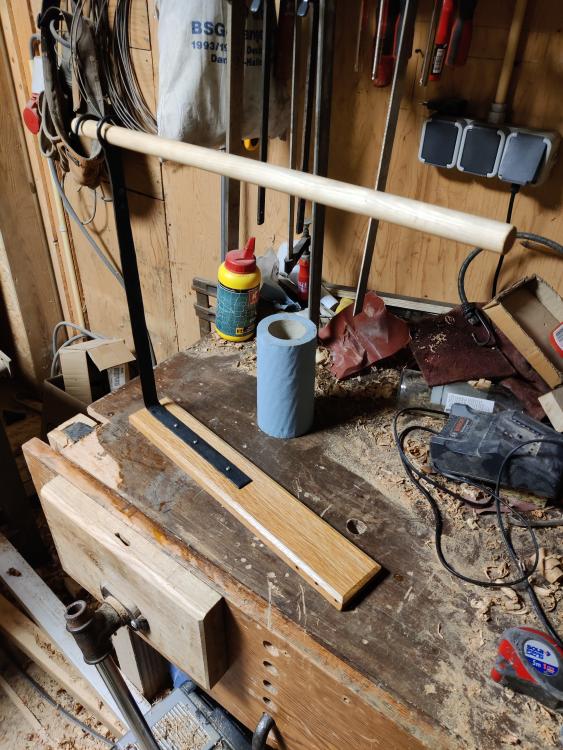

Jobtiel1 Posted November 22, 2022 Share Posted November 22, 2022 Finished a Christmas present for my girlfriend, it's a rack for her scout scarfs, she does a lot of national events where she gets a different scarf each time. The bottom is oak, round dowel is (probably) pine or fir. I also made a screwdriver bit for a bit brace, good practice on the shoulders for the transition from the square end to the round shank. ~Jobtiel Quote Link to comment Share on other sites More sharing options...
