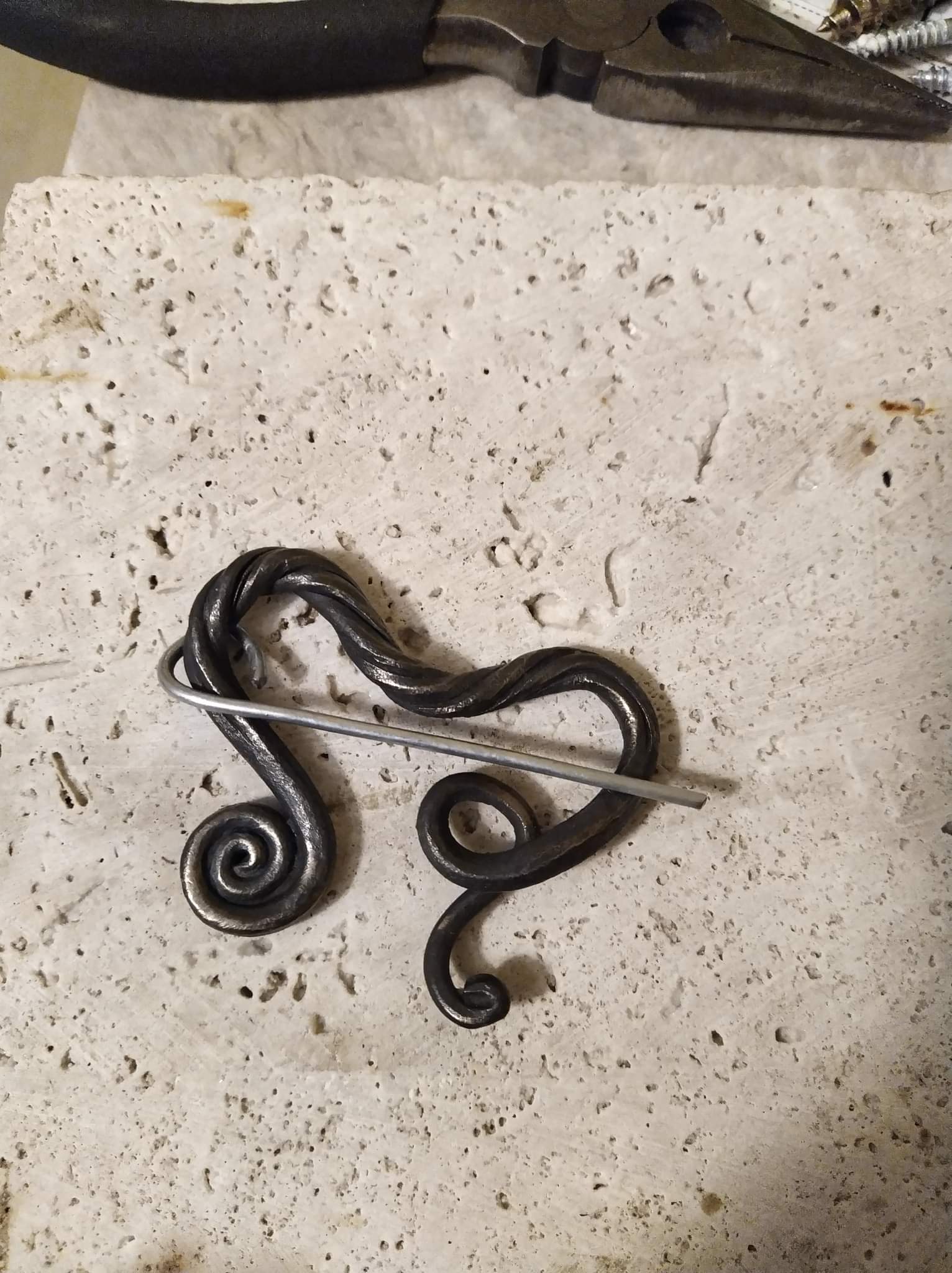

Shainarue Posted November 20, 2022 Share Posted November 20, 2022 The forge is literally just outside the door. It can't sit in the actual door opening because then too much smoke comes in. I'll take a video tomorrow showing my pivot. It's not even 2 steps. Today was mostly chisel work. Can't really get away from laying flat for that. Here's what I finished today. Chiseled the lines on all four sides, softened the edges and twisted. Then curled one side into a tight curl and shaped the heart. Once I was satisfied with the heart shape, I made a loose curl with the other end. I don't have a brass mallet yet nor do I have a wooden or rawhide mallet. But I did have a section of copper pipe so I clamped that in the vice and used pliers to pull the bends around the pipe. It was finicky but eventually got the job done. Then when I needed to straighten out the warped parts, I used that same copper pipe as a hammer while the piece was on a slab of wood. I couldn't get a forged pin to slide right so I made the pin using wire instead. Quote Link to comment Share on other sites More sharing options...
George N. M. Posted November 20, 2022 Share Posted November 20, 2022 Very cool and interesting esthetically but I think there could be a problem in actual use. You need a certain amount of space for the material to "pooch up" where the pin goes through it. This might work with a thin material like a silk scarf but I think there could be a problem with heavier fabric. I suggest that for the Mark 2 version you use a bit longer stock and make the curve that is nearest the middle of the pin in the photo further away from the pin to allow for more fabric in the middle of the brooch. Also, something I do with penannulars, particularly smaller ones, is use piano wire, which is high C steel, for the pin because it allows the pin to be of a smaller diameter which minimizes damage to the fabric. Heavier pin stock can leave ugly holes in finer woven fabric. I have found piano wire at model railroad stores and some hardware stores. It comes in straight lengths, not as a coil or roll. It has to be worked hot. "By hammer and hand all arts do stand." Quote Link to comment Share on other sites More sharing options...
Glenn Posted November 20, 2022 Share Posted November 20, 2022 1 hour ago, Shainarue said: Today was mostly chisel work. Can't really get away from laying flat for that. Nothing wrong with laying a piece of hot metal with a hardie post to keep it steady) on the top of the anvil and working on the hot metal. A 2x4 or piece of firewood can be used as a wooden mallet and can impact the metal both horizontally or vertically. Quote Link to comment Share on other sites More sharing options...
