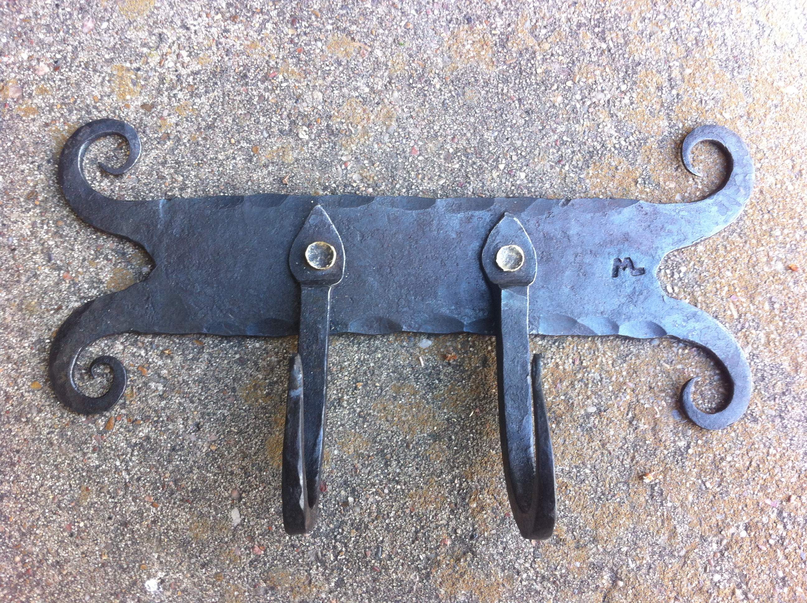

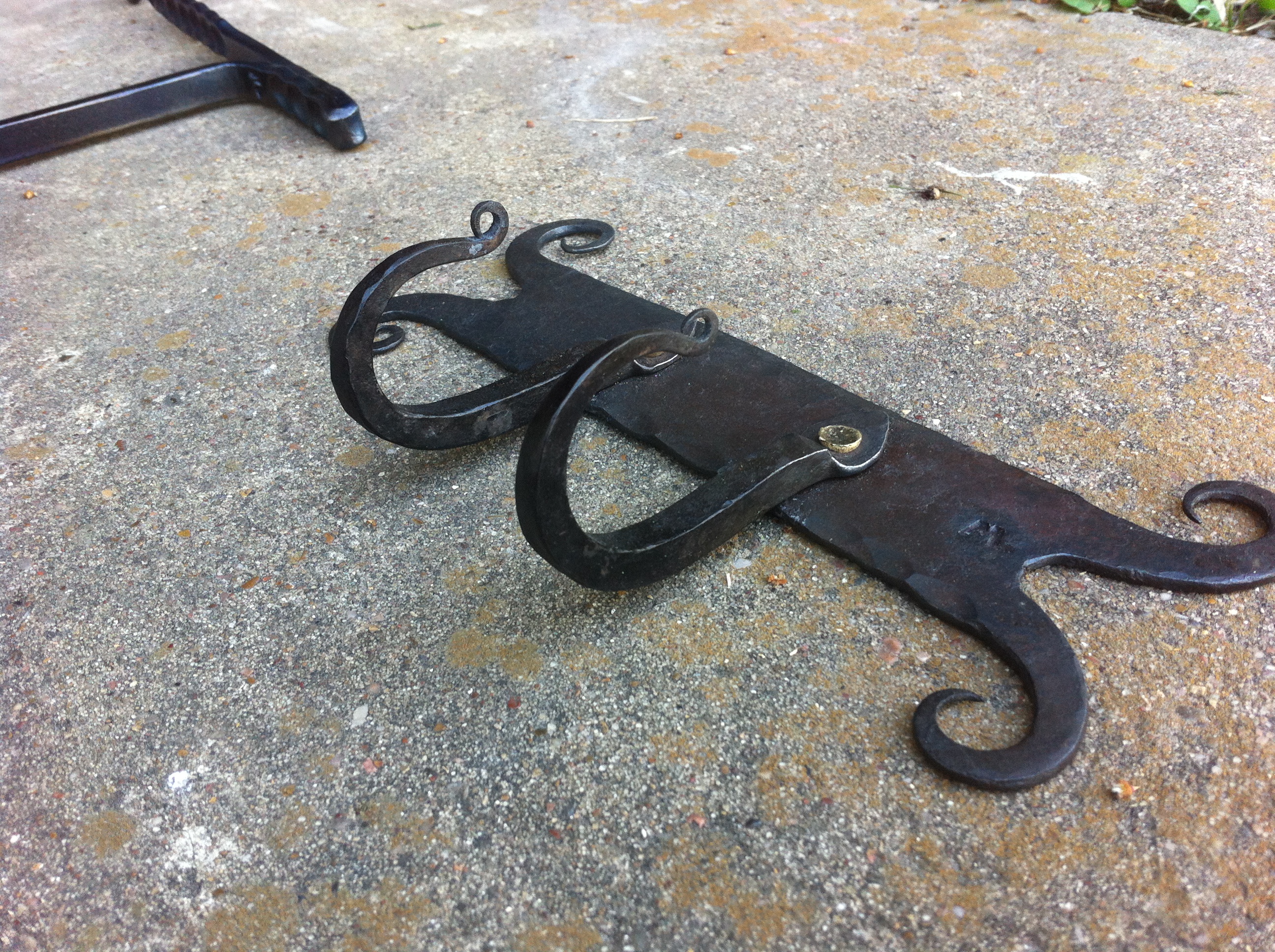

Mark Ling Posted February 12, 2017 Author Share Posted February 12, 2017 Need to get some stuff made for up coming fairs. Today I Had some fun with a ball fuller (AKA a small normalized ball pein hammer flipped over) and made a plant hanger. Also made a small coat rack with brass rivets. I punched the holes, and so I had to make a small diameter (3/16") punch. Made a large S-hook. Towards the end of the day my dad and I mounted a post drill in my shop. Took us a year literally! I got the drill last year at the Steep Hollow forge get together which is this up coming weekend! Funny how things happen like that. Littleblacksmith Quote Link to comment Share on other sites More sharing options...
Gergely Posted February 12, 2017 Share Posted February 12, 2017 Wow, LittleB nice work! Consider the plant hanger idea stolen Only I will use my bearing ball fuller under the PH. - It's a very versatile tool. I've decided to pass on today's fair instead. I have to be too fit and ready Monday for two bigger commission works and for negotiations about the biggest possible commission I ever had. There is another fair next Saturday, so I can finish my stuff till then. So no shop time just family time today Gergely Quote Link to comment Share on other sites More sharing options...
ausfire Posted February 12, 2017 Share Posted February 12, 2017 LB you do some really clever stuff! Nice dimpling on the hanger. I use a similar tool for the lifting tab on the bottle openers. It may find other uses now. Quote Link to comment Share on other sites More sharing options...

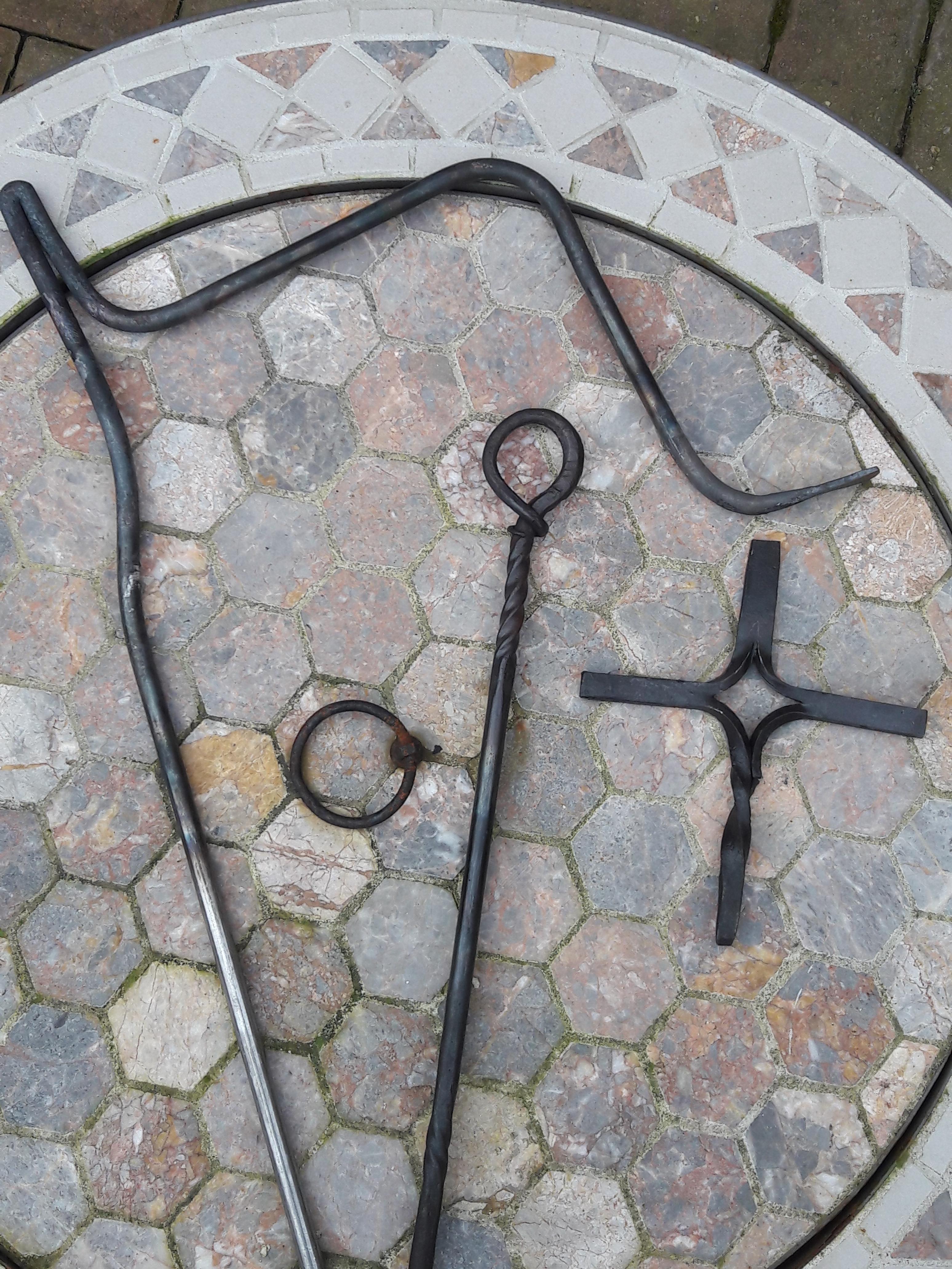

Zeroclick Posted February 19, 2017 Share Posted February 19, 2017 I corrected the eye on my toasting fork, made a hold down tool which should make things easier and also had a go at my first split cross. Quote Link to comment Share on other sites More sharing options...
Ridgewayforge Posted February 19, 2017 Share Posted February 19, 2017 Zeroclick, I am very intrigued by your holddown, could you explain how yours in used and how it was formed? Thanks! Quote Link to comment Share on other sites More sharing options...
Zeroclick Posted February 19, 2017 Share Posted February 19, 2017 No problem it is based on one that David Stephenson had he let me take an outline. It is made out of 3/8 mild round. For the tip I used the bottom fuller I had to spread the material out and give a good holding point. I then worked from that point back by heating up short areas and bending over the horn. For the section that goes from horizontal to vertical I started off with a loop and then tightened it up on the face. As David said to me the most important part is the recurve on the vertical that allows it to lock into the pritchel hole. I used it for doing the split cross and was really effective. Quote Link to comment Share on other sites More sharing options...

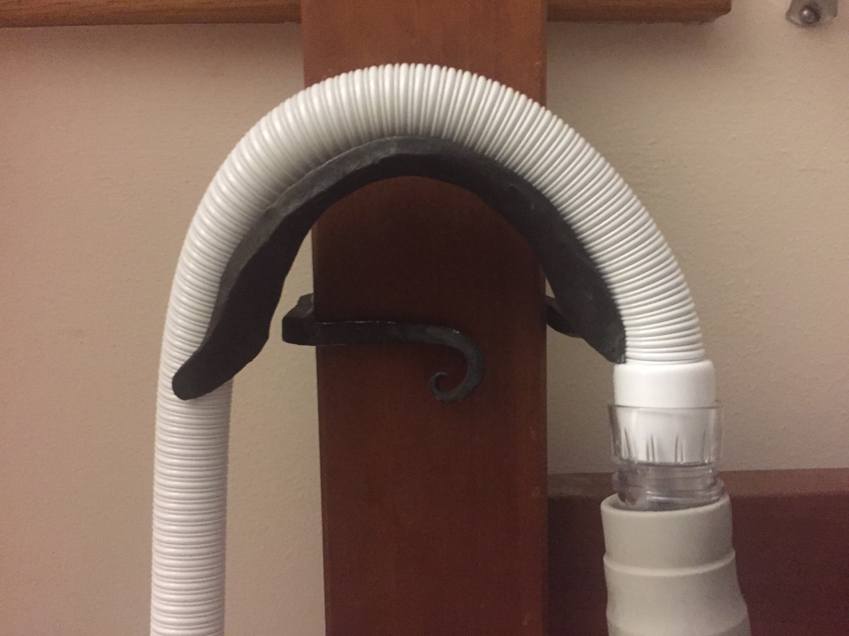

JHCC Posted February 20, 2017 Share Posted February 20, 2017 A somewhat unusual item: a hook that wraps around the corner post of my bed to hold the hose from my CPAP machine when not in use. (I built the bed as a wedding present for my wife, by the way.) Quote Link to comment Share on other sites More sharing options...
