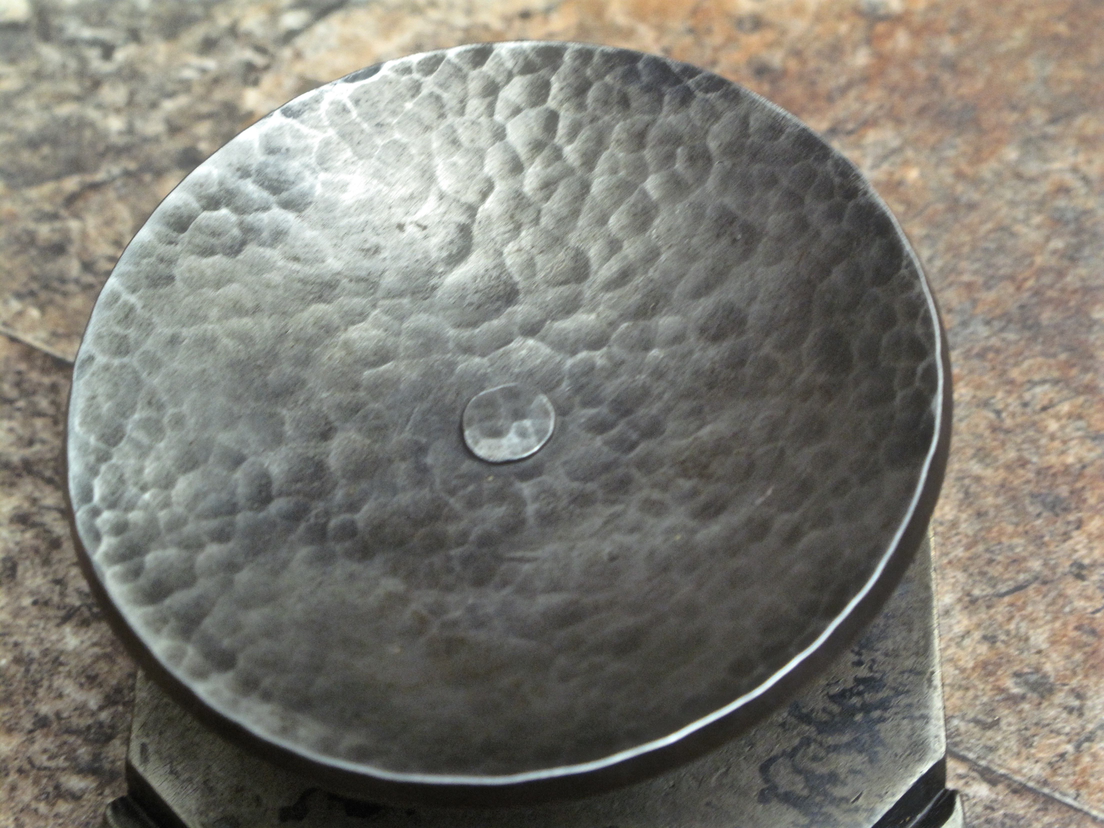

Finished her and have her twin still to be put together.  A single rivet ties everything tight.IMG_5022.jpgIMG_5024.jpg

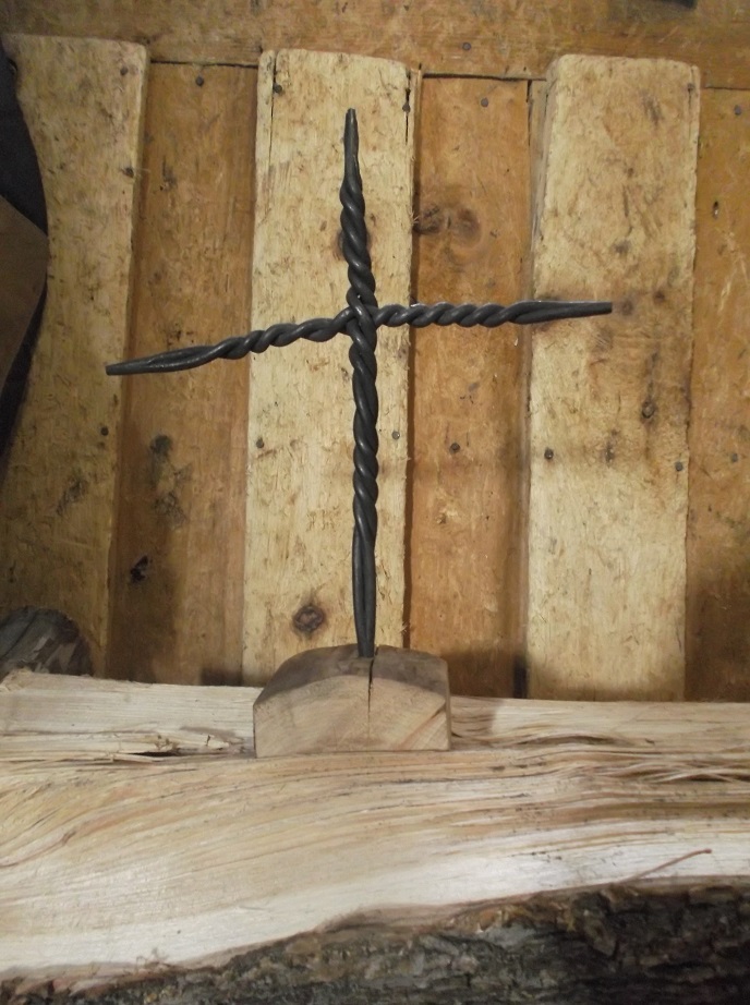

I worked my design a little bit and made my previous candlestick into a snuffer while I made a larger one to go with it. I also made a forge-welded cross, twisting it was a huge pain though probably because I cheaped out and only used two rods for the bar

Wow! You're not called Iron Poet for nothing. Those are some excellent flower candle holders/snuffers. I really like how you improvised on a theme.

The key to creativity is laziness. I realized that the small flowers I made didn't fit the candles I bought so I turned them into snuffers since it was less work than enlarging the cups. But it's all just practice, I plan on making more elaborate flowers after I get comfortable with forge-welding sheet metal.
Somehow, that adds to the beauty of the creation. Well done, and I look forward to seeing more flowers. Candle Holders I could never quite get the hang of, but I only barely delved into them before I had to pack up the shop.

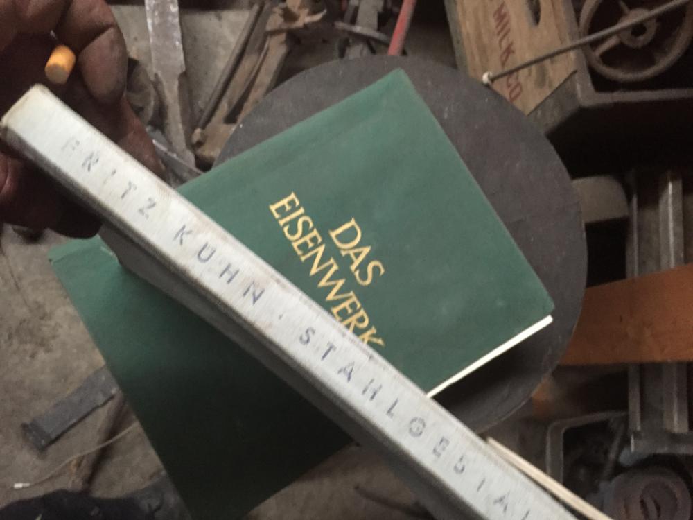

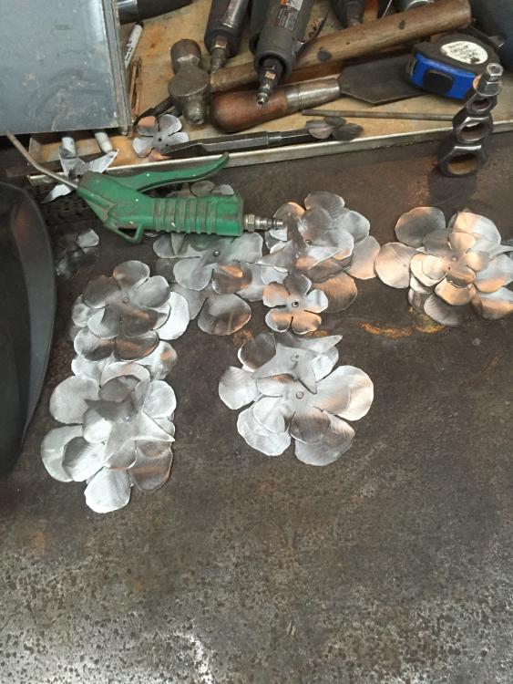

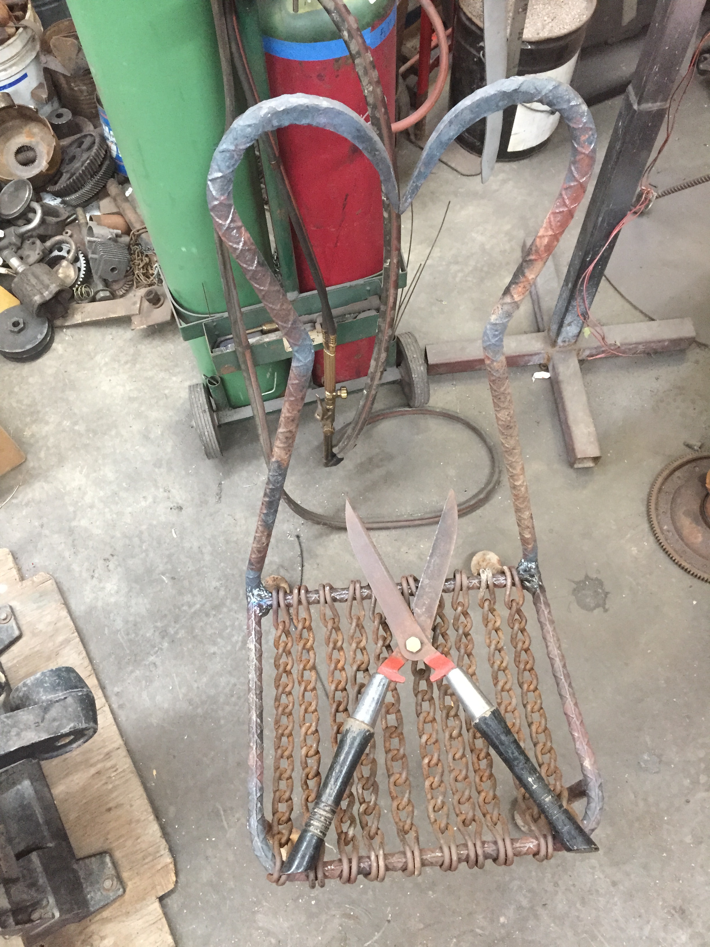

working on 6 roses, a chair, and other fun stuff., A cool book I found a while ago that was in a flood too.

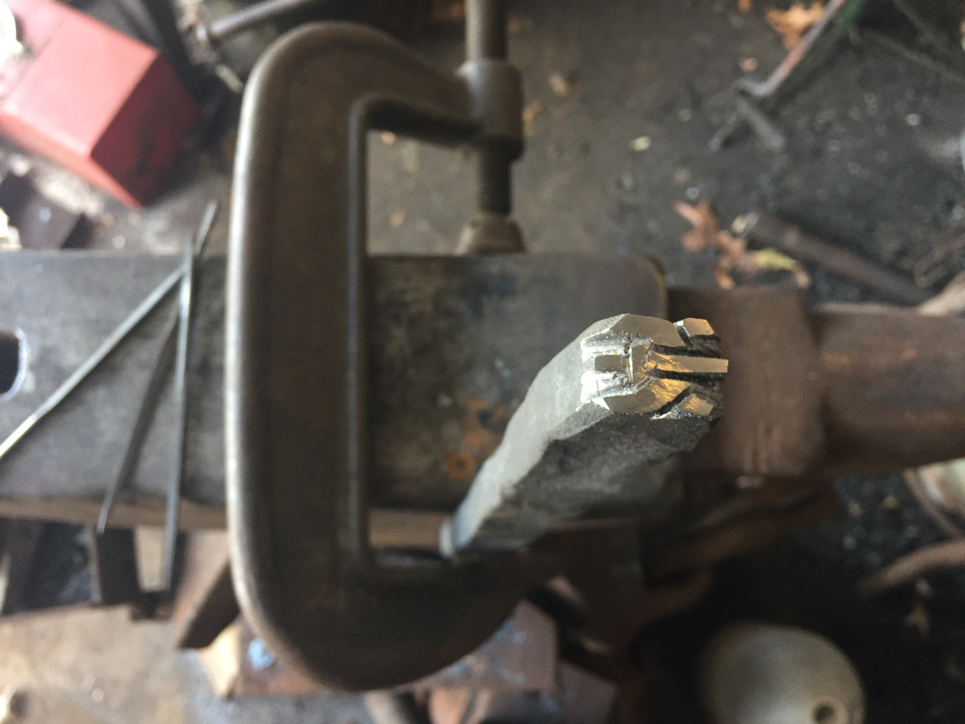

Working on a new touchmark.

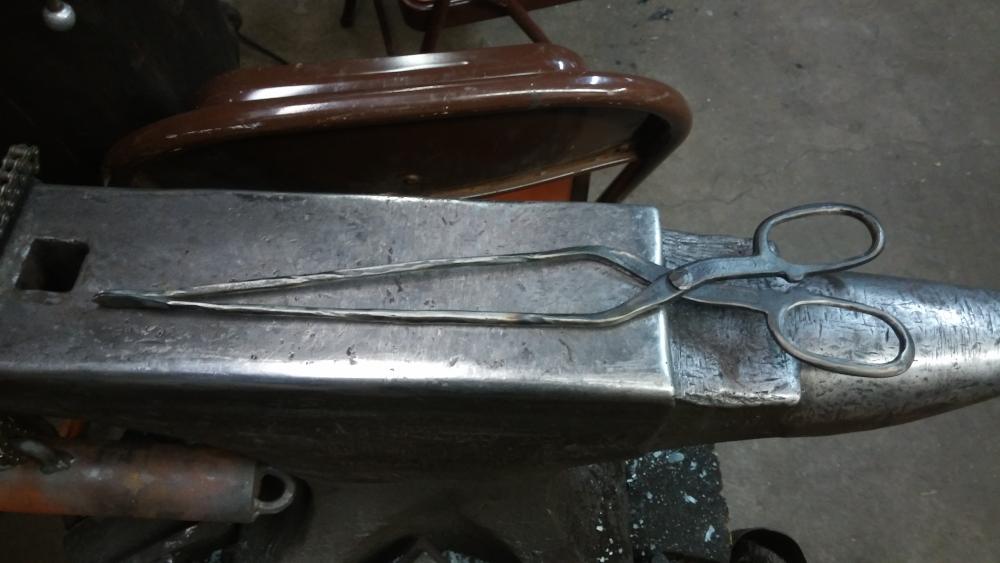

Clinker grabber tongs made from an old pair of tin snips

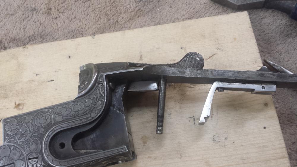

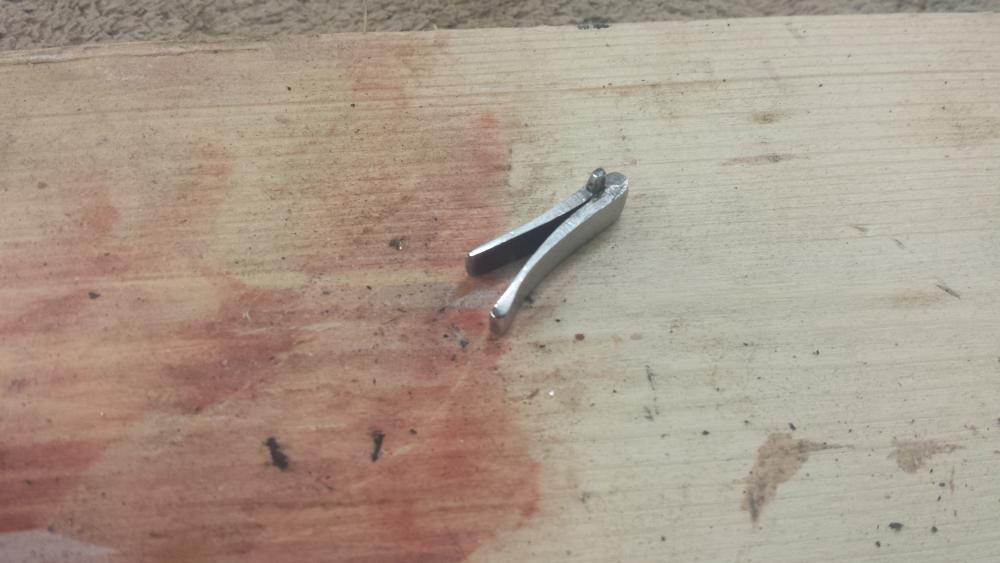

I thought I would share this with the group.  I sometimes have to make a spring for a firearm, pictured is a flat V spring for a German made double rifle.  I broke the original while disassembling the gun, the German's are very good at making things fit together tight, this time things were a little too tight, the original spring gouged into the main bolt stopping it from being removed.   The metal is 1075 which is a very forgiving alloy for spring making, easy to forge, quench and to temper.

snip... A cool book I found a while ago that was in a flood too.
An extremely cool book find.
Finding illustrations of Fritz Kühn's work was a revelation for me. He was the first artist blacksmith I knew of that was not working in the 18 century/baroque idiom. His work gave me permission to explore.
Makintosh, Horta and Gaudi were all architects designing for others to make...and I did not discover Mazzocutelli, Gonzalez, Benneton, Smith or Chillida until much later.
I never met Fritz Kühn but have spent some happy times with his son Achim, another fine artist blacksmith/sculptor, at various blacksmithing events over the years. Talented family.
I was honoured to receive an inscribed copy of "Fritz Kühn 1910-1967in Memoriam" from Achim. One of my treasured possessions.
Alan
58961b41c8f11_AlanEvansFritzKhnbookgiftfromAchim.jpg.022f2f4e921a12416b8c6c2235e3cc11.jpg
One of my "finds" from a 90 day business trip to Germany was a copy of Fritz Kühn's "Geschmiedetes Eisen" The 1939 edition.  I thank my highschool German teacher for allowing me to ask about blacksmithing books at fleamarkets in German.
