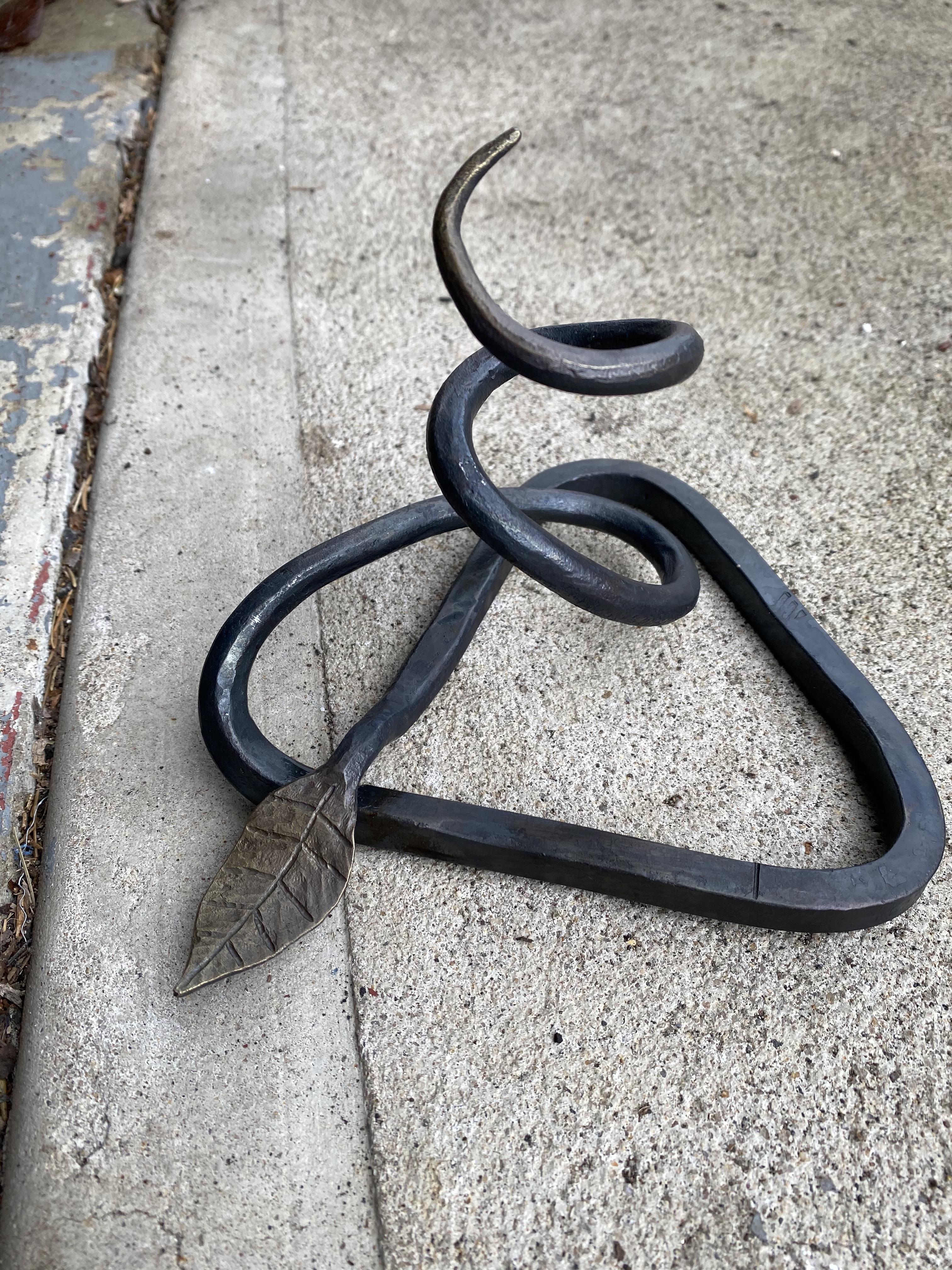

I usually only get to light the fire on weekends but work was slow yesterday and I had the itch...so I went home early and did some other “work” lol. This was supposed to be elegant with graceful curves but unfortunately those are not words I would use to describe the finished product. I want a coal forge and bigger anvil so badly for things like this where it just doesn’t fit in the forge after a certain point. But it works and I got to use the new touch mark I made for the first time. The touch mark needs a little work but the bottle holder does work so it was a good day.
One of the keys to smooth curves is to keep the workpiece moving and to avoid striking in the same place twice.
That said, I think that looks quite nice. Your dissatisfaction with it is a good thing if it spurs you to do better next time.
I really like that design, with a bit of improvisation you could just use a thick-walled pipe or round bar for making bends, I used that when I was a welder and it works pretty good.
Another thing to keep in mind is that metal will bend more when it's thinner and hotter. This means that if any one spot is thinner and hotter than the rest, it will bend more there. Even drawing out (eliminating all dents) and heating will help keep the bends even.
When I need to heat a length longer than my forge will; I dig a trench forge in the yard and use some larger black pipe with holes in the bottom of it for a tuyere and use a shop vac to blow it.   I once had to fold some 3/8" plate to make a fire tray for the Santa Maria replica in Columbus Ohio.  Built a trench forge in my inner city yard and did the folding around some RR Rail clamped to the 4x4" uprights for a shop extension I was working on.
Thanks - Good feedback. Like I said about the bigger anvil - that’s what gets in the way of being able to keep the work moving some times. I only wanted to go through putting a huge heavy stump 2 feet in the ground once so there’s no space under the horns. I use the extra bolt in the stump next to the one holding the plate as bending forks sometimes but again just not enough space. Hoping to get upgrade soon though. And yeah that little vise broke on the first hammer blow haha
That picture put a smile on my face, cute little anvil with a huge stump and some hefty chains. Reminds me of the flatbed truck with the tricycle on it.

Pat, get some pieces of steel 6 or 8 inches long 1/2" maybe 5/8" round or so bend into "U" shapes. Those can be put into that vice and used for turning forks. The closer or further apart the "tines" of the "U" the different size stock you can use them on. A welder, 2 pieces of angle iron, a couple inches of 1/2" square bar, and a handful of 1/2" drive sockets and you can easily make an adjustable bending jig for your vice also.
You HIT that poor itty bitty thing? :o You brute!
Put some large lag screws in the side or top of your stand at various distances for bending forks. Don't HAMMER them in! :rolleyes:
Poor little vise, what did it ever do to you? Seriously I have larger forceps.
