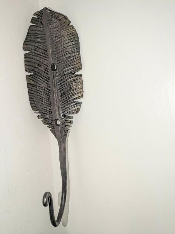

I took my first hook out of the vinegar bath and scrubbed it down with a wire brush in a pail of water, hung it out to dry, wire brushed it with the bench mount slow speed wire brush and dipped/wiped it with BLO and hung it on a wire in the shop---4 more to go!

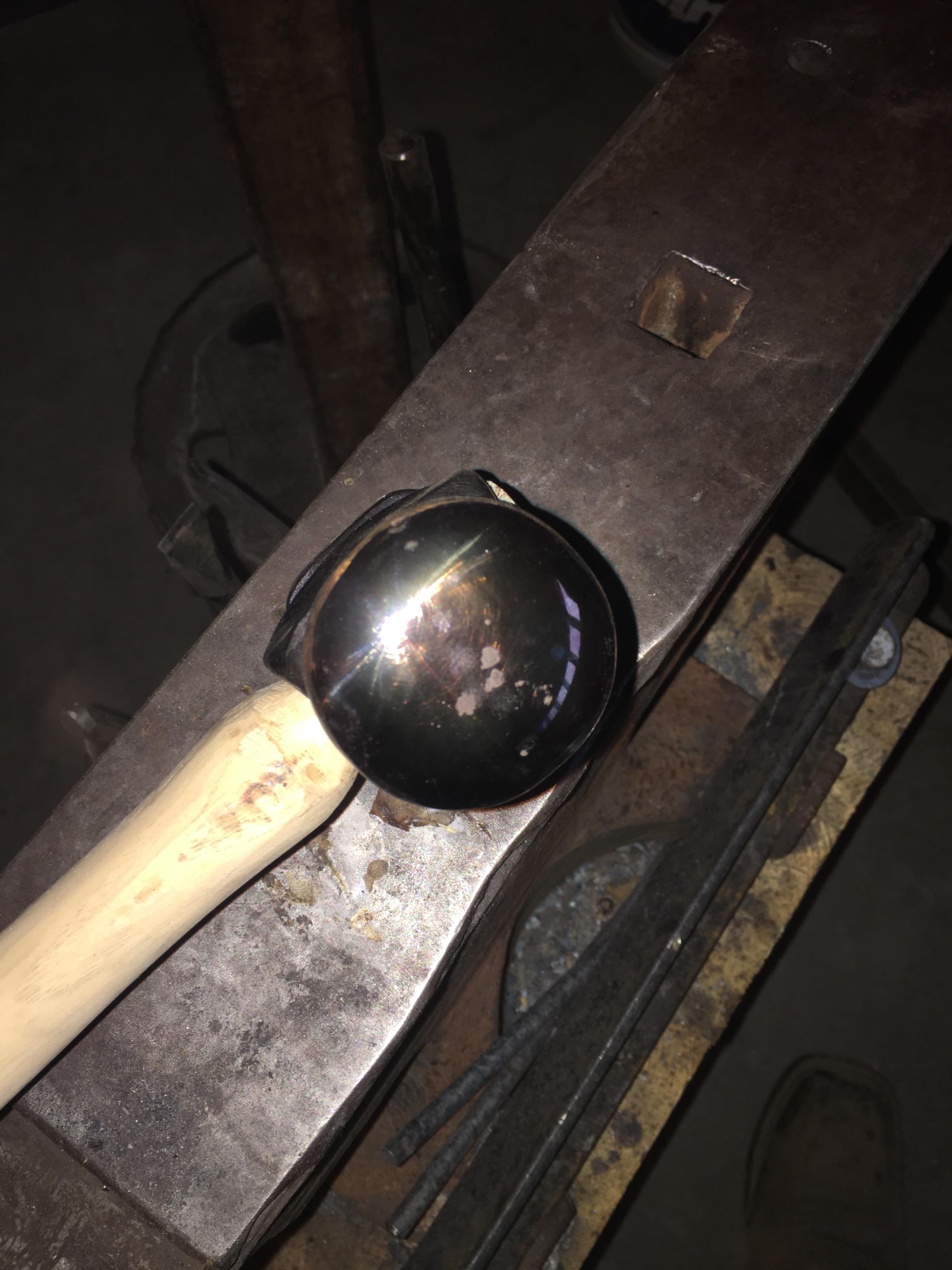

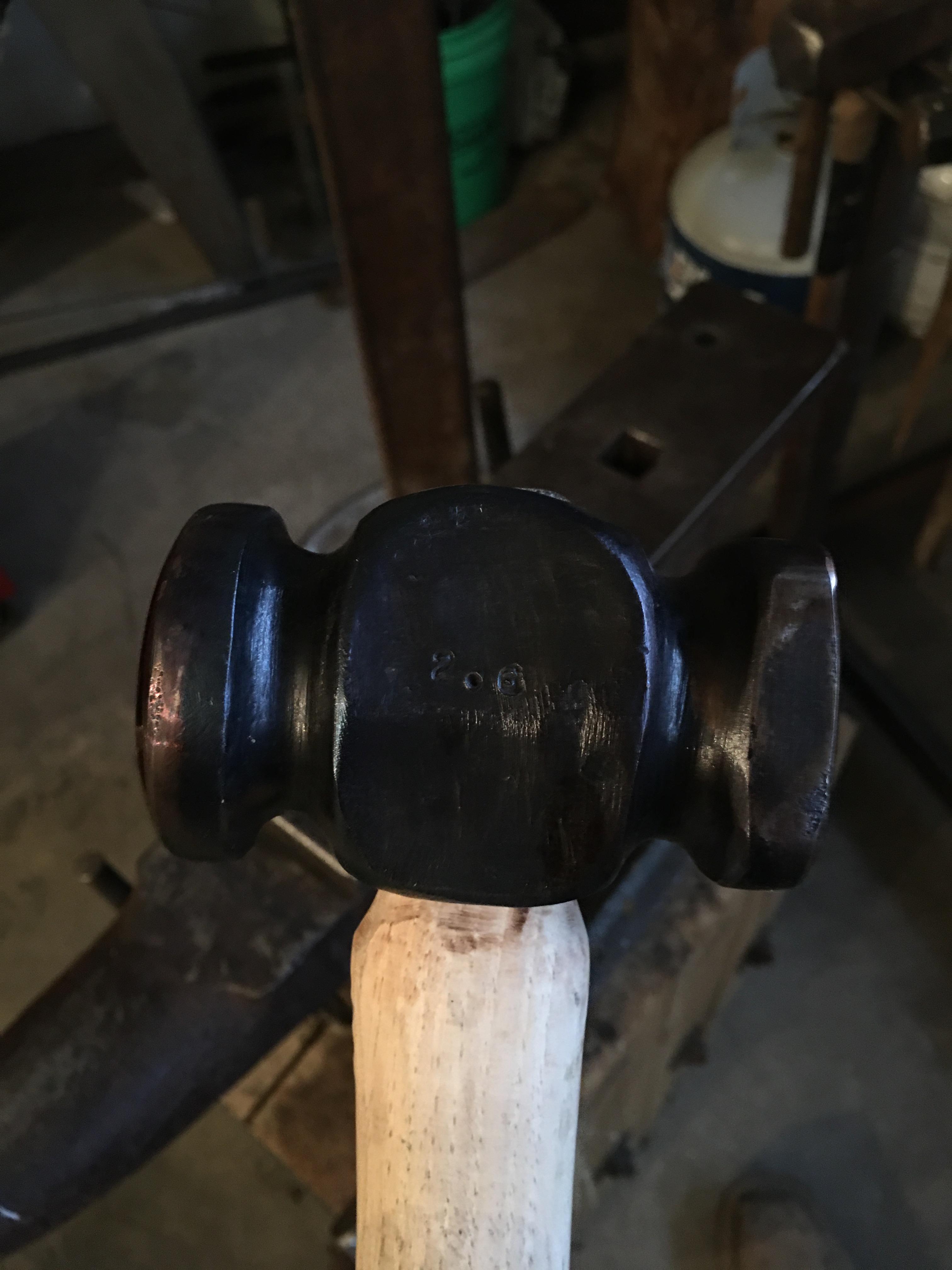

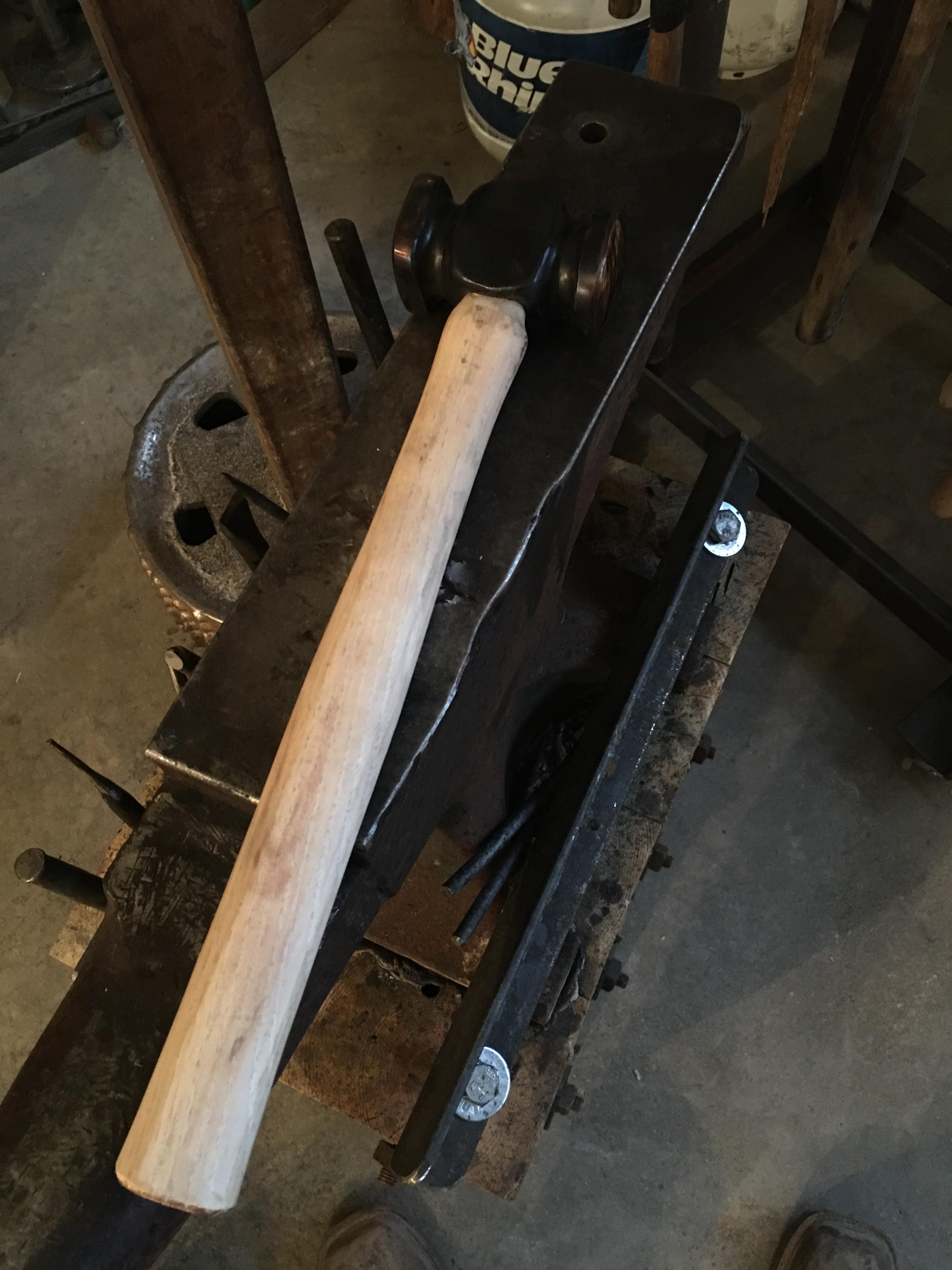

I finally took on one of the projects I've wanted to do since I took up smithing. I always wanted to make my own hammer. After the claw hammer and the small mechanics cross peen I had the confidence to try a rounding hammer. I decided to make the flat side square and the rounding side round for easy reference when using it. It came out weighing 2.6lbs and the eye is a little crooked. But for a first attempt I'm pretty satisfied!
Nice looking hammer. I have yet to make a hammer, but I index the faces by making one side of the handle flat and the other just slightly convex. I also carve the top of the handle flat and the bottom somewhat round (Top and bottom being in relation to the face I expect to use most.) If cut in half it would look something like a D.  Someone here said they did that quite a while ago and I tried it and liked it. I don’t have to look at the hammer to orient the face. I can focus on what I am working on.
Thanks, Nathan. It isn’t finished. I had thought I would rivet it to a copper or brass cross and then wood beneath that. But now I think I will try to forge a little larger Celtic cross from WI instead of brass or copper. I am still thinking I will go with bois d’arc under that. But who knows.
I thought about indexing the handle like that, and still might as it is a store bought one and could use some fine tuning. But I figured what the heck, do the faces this way and it will at least be unique. I'm sure others have done it, but I've never seen it.
Nice. Go put it to work!
Nice looking hammer Cannon Cocker. How does it feel on hot steel?
I may not be THE guy you remember but I've been shaping my hammer handles that way for years and have described it here often.  Flat towards the face and rounded to the pein side, like a D. :)
Thanks DHarris and frosty. I remember reading a conversation between frosty and Jennifer about shaping handles that way. Since this handle was just slightly larger than comfortable anyways I decided to give your method a go. It feels good in my hand but I'll know for sure once I put it to work later today. I got my hands on some good coal so I'm on my way out to the farm to grab my coal forge and a couple of extra propane tanks that I'm exchanging for o/a bottles. Hopefully I'll have something else to post on here this afternoon!
Just don't run a coal forge on acetylene. You've been warned.
I personally don't like "thin" hammer faces as they are more prone to deformation if soft and chipping/cracking if hard. I'd like to see a similar one with thicker faces.
I agree Thomas, these faces turned out thinner than i expected. That's one of the things I'll focus on differently next time!
Meanwhile you can use that one to destruction or save it for sheetmetal work!
