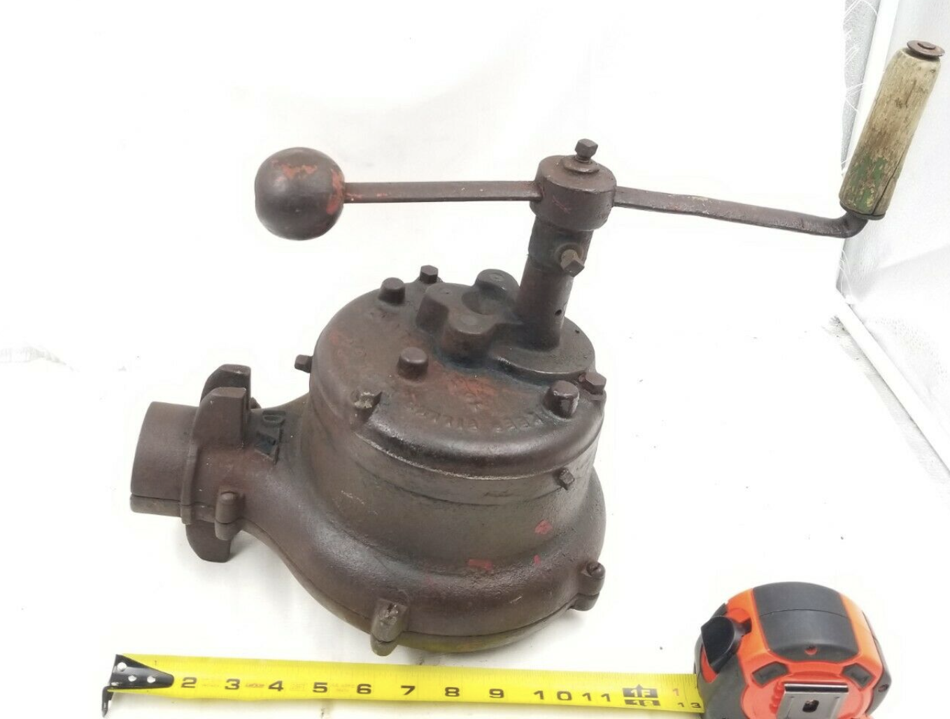

Out of the blue Ebay just Unsolicited Commercial Emailed me the listing on this one. I'd guess it's a ~7.5" fan. Based on the 1077 and 1076 in the pics, and this spare-parts page from that catalog, I'd bet an S-hook that it's a tinier-than-normal Canedy-Otto.
As you said, it's hard to tell the size from pictures. Can you measure something on it and say how big it is? From a Canedy-Otto catalog at http://www.bamsite.org/books/canedy.pdf their normal fan size is 10-12". Theydo show some lighter weight ones going down to 7.5" with "Capacity to heat 1-inch iron", and heavier ones going up to 14.5" with "Capacity to heat 4-inch iron". For their 10" fans they say has capacity to heat 3-1/2" iron. How big is tiny?
How tiny is tiny? If that's a 3" outlet, the pivot bolt head is about 1/2", the hub is about 1", the pipe is about 2", and the diameter is about 10". Is that about right? That would be huge compared to the new 6" tall "80W hand crank" blowers sold for BBQ grills on Amazon.
