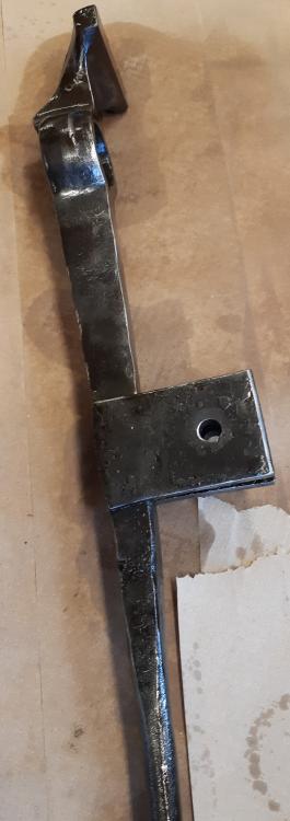

bluerooster Posted March 18, 2021 Share Posted March 18, 2021 I need to put up a privacy fence around the swimmin' pond. So I decided to try my hand at making the gate hardware. Started a hinge. parent stock is 1/2" x 1". So most of the time was spent getting it to a suitable dimension to start. All done by hand, with many heats. I need to hit up the local supplier for some drops of a closer dimension. Quote Link to comment Share on other sites More sharing options...

bluerooster Posted March 18, 2021 Share Posted March 18, 2021 Thomas, as a complete noob to this smithing stuff, the experience I've gained from 1/2"x1" into 1/8"x2", then into an almost doable hinge half was worth it. But, now that I've gained that experience, I'll be sourcing material more suited to the task. Another bit of experience I gained was in the holes, two were punched round, then drifted square, the other two were punched square. Quote Link to comment Share on other sites More sharing options...

bluerooster Posted March 19, 2021 Share Posted March 19, 2021 Got hinge #1 ready for a pin, and a good start on hinge #2. Found some old lawn mower blades that work real well for this. Sure is nice to be able to start off with metal of a size closer to the task at hand. Quote Link to comment Share on other sites More sharing options...
