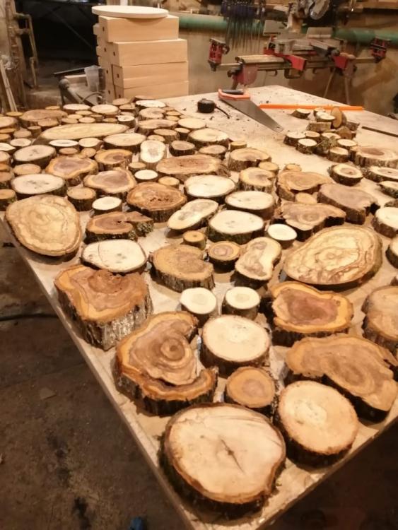

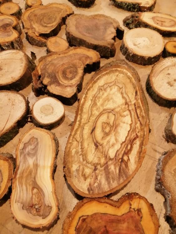

alexandr Posted March 15, 2021 Share Posted March 15, 2021 Started a new job. Table top made of epoxy resin and wood scraps. Link to comment Share on other sites More sharing options...
ThomasPowers Posted March 15, 2021 Share Posted March 15, 2021 Are they nice and dried out? Link to comment Share on other sites More sharing options...
alexandr Posted March 15, 2021 Share Posted March 15, 2021 2 minutes ago, ThomasPowers said: Are they nice and dried out? It needs to be dried. The heating in the workshop is still on, I spread the pieces of wood on the radiators. Link to comment Share on other sites More sharing options...
Frosty Posted March 15, 2021 Share Posted March 15, 2021 That'll be attractive, I was thinking about how much "Cactus Juice" it'd take. That's the brand name of heat cure epoxy resin used to stabilize wood for knife handles. Dad made a couple few coffee tables from slabs of semi precious stones. Yours is going to remind me of the petrified wood table. Frosty The Lucky. Link to comment Share on other sites More sharing options...

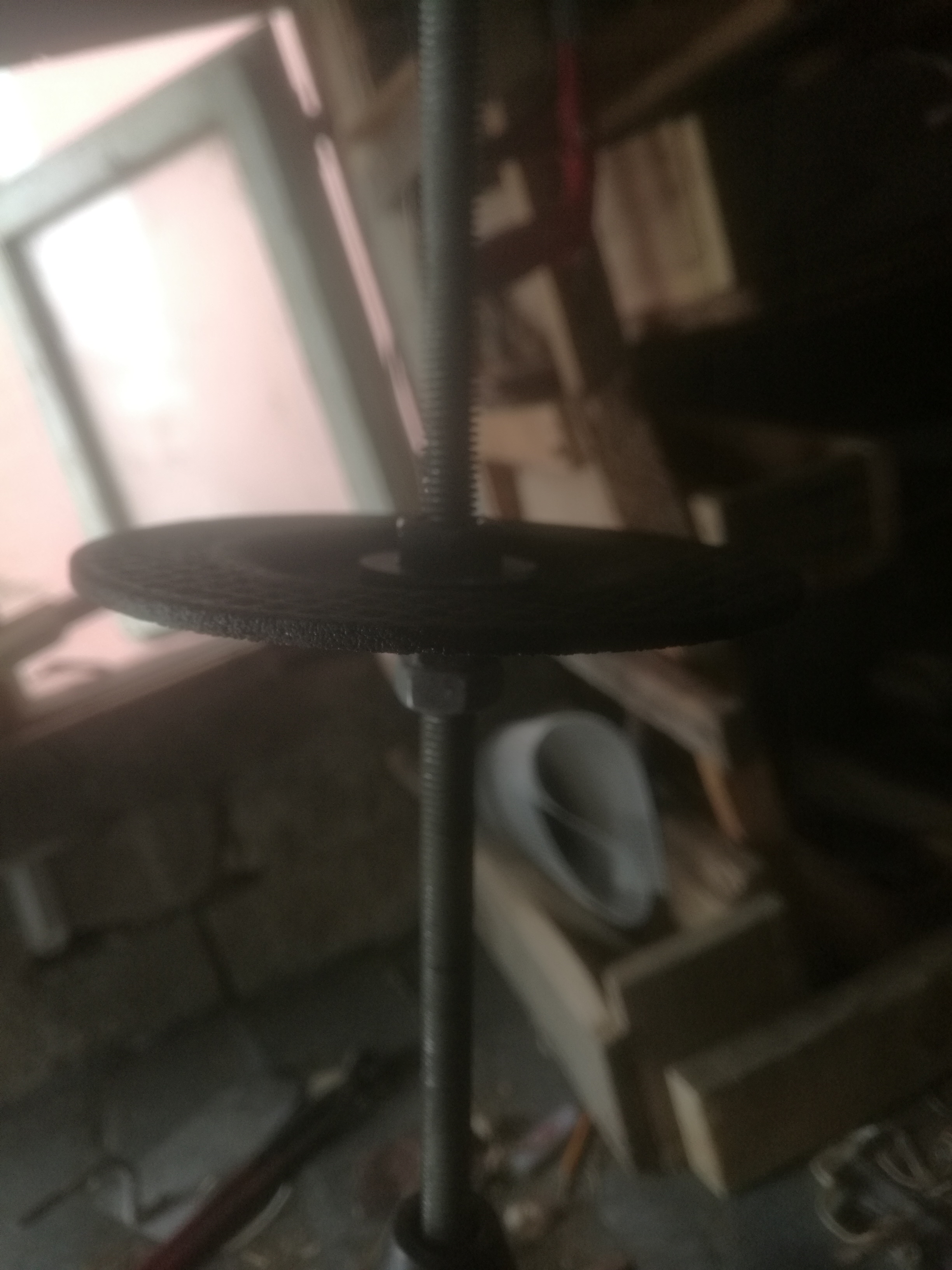

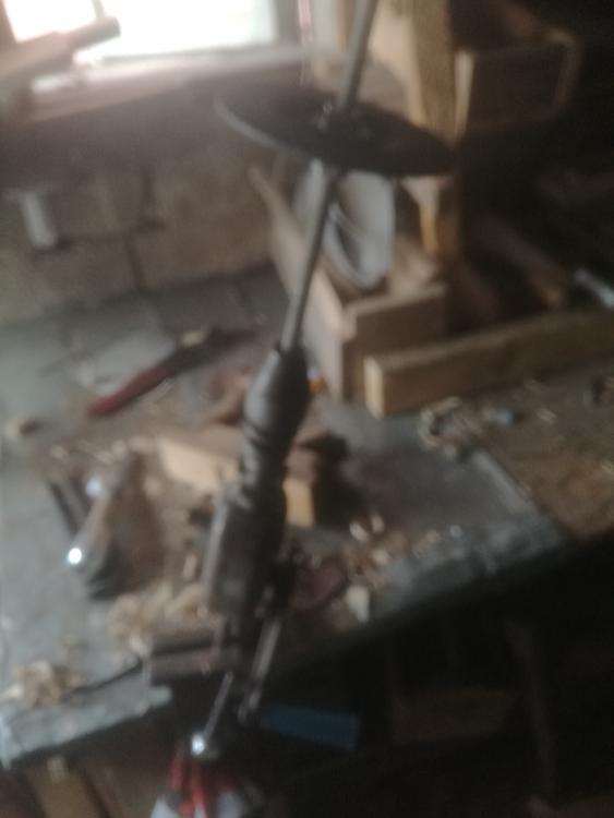

natkova Posted March 15, 2021 Share Posted March 15, 2021 Improvised some hand crank grinder Dont try this at home, it can be even added on power drill, but i fund it dangerous. Hand crank is more better bet. Link to comment Share on other sites More sharing options...
