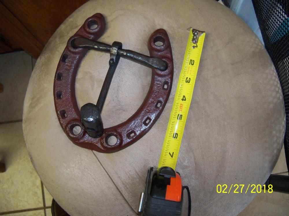

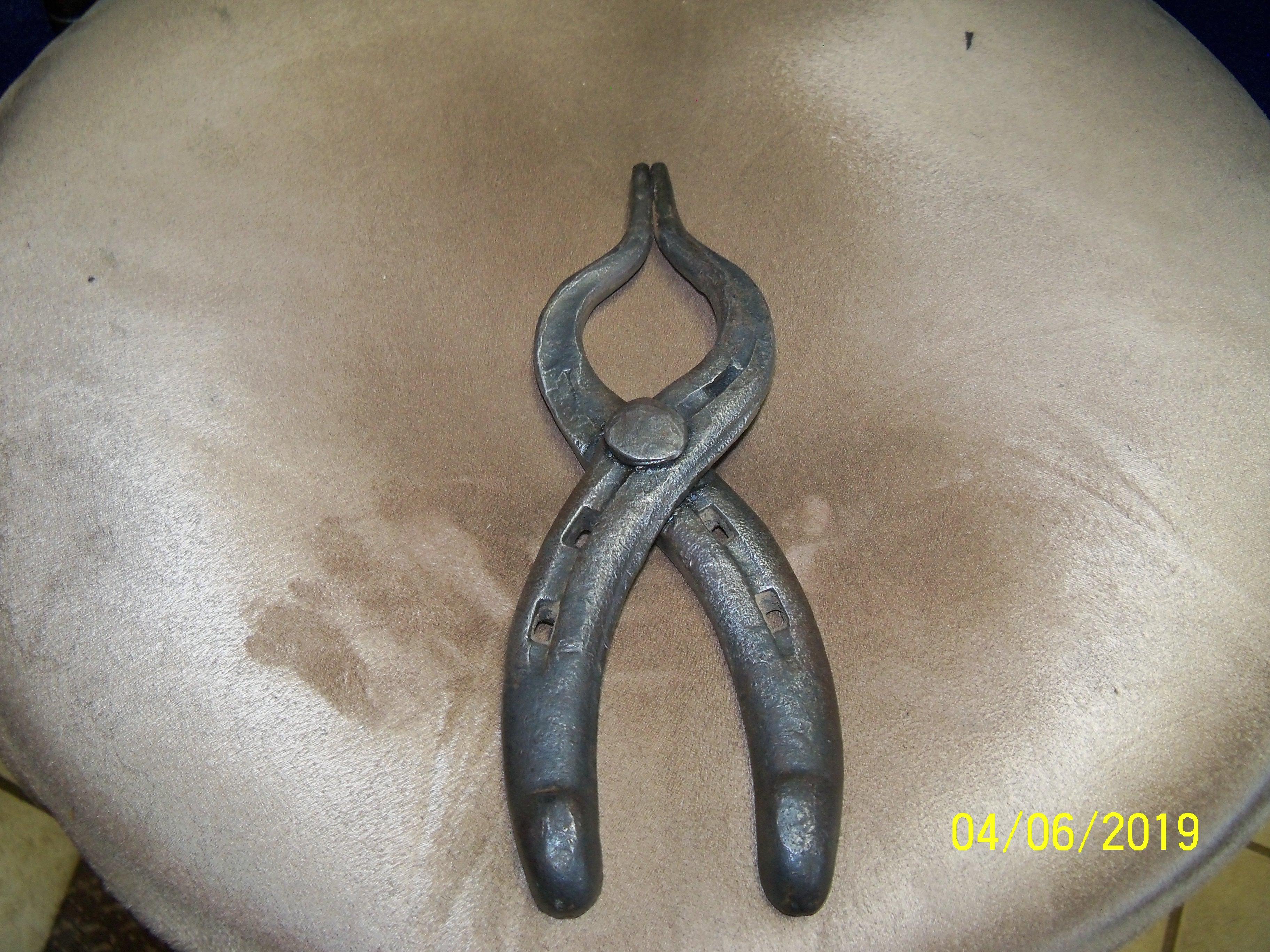

Irondragon Forge ClayWorks Posted June 19, 2019 Share Posted June 19, 2019 I made a door knocker out of one. This pair of scrolling tongs was made by one of our club members. Just have to make them as a mirror image so the sides are right when riveted. Quote Link to comment Share on other sites More sharing options...
CrazyGoatLady Posted June 19, 2019 Share Posted June 19, 2019 Very nice doorknocker. Does that require welding? And I saw those little tongs before in one of your posts and thought they were really neat. Thank you Quote Link to comment Share on other sites More sharing options...
Irondragon Forge ClayWorks Posted June 19, 2019 Share Posted June 19, 2019 The cross bar holding the hammer is riveted flush on the back side no welding required. Quote Link to comment Share on other sites More sharing options...
CrazyGoatLady Posted June 19, 2019 Share Posted June 19, 2019 Ok thank you so much. I will have to try that Quote Link to comment Share on other sites More sharing options...
