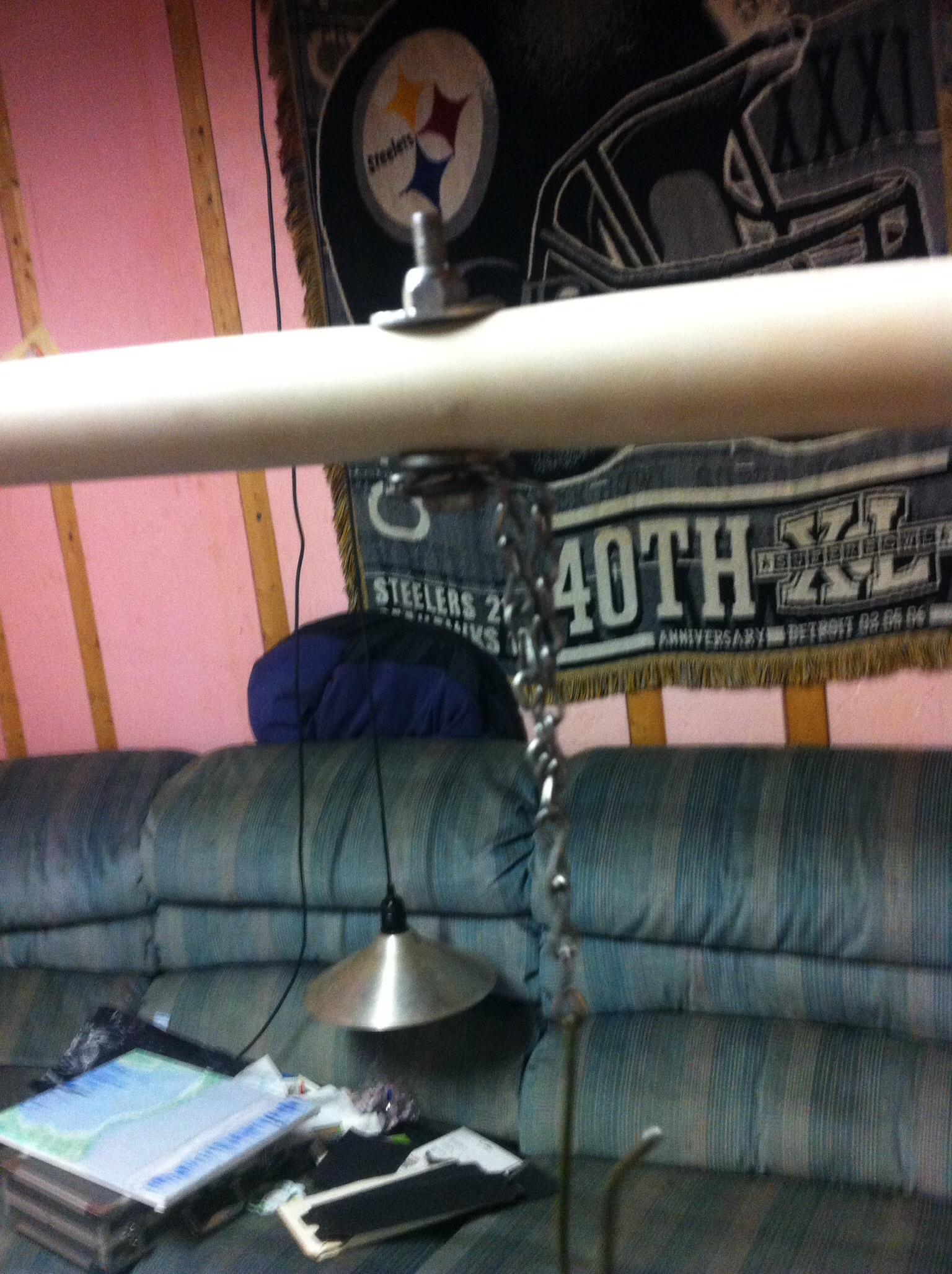

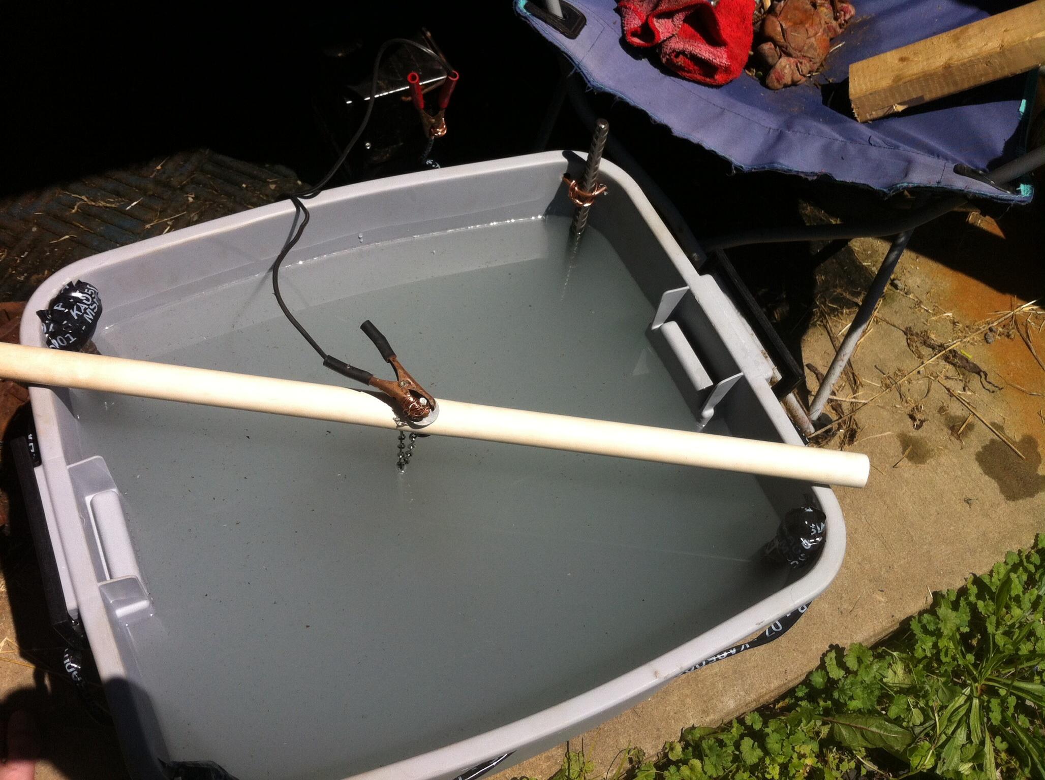

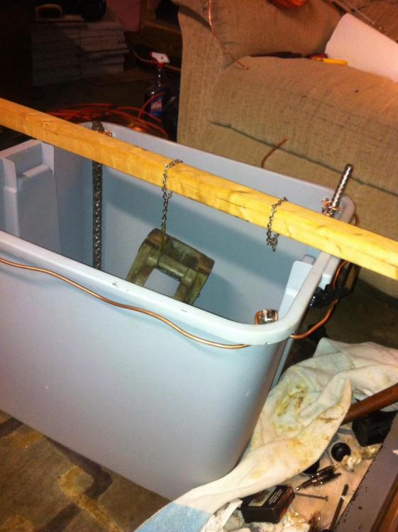

Pr3ssure Posted June 11, 2019 Share Posted June 11, 2019 Finished setting up my electolysis setup a bit ago. Having some coffee and a cinnamon roll while I wait. I think I made a pretty nice setup. Ive got some .175" thick copper cable, solid, I ran it around the tote and back in around rebar. Boy was it hard to bend after a few bends. Work hardening is real folks! There is one piece of rebar in each corner, I then tied the rebar to the thick copper with some actual copper wire. (I've got a lot of copper in a lot of shapes in sizes.) I changed out the wood for a plastic pipe and put a bolt through it. I also put put tape around all the exposed copper wire except where I attach the battery charger I had to turn baking soda (sodium bicarbonate) in soda ash/washing powder (sodium carbonate) via my oven. Since I forgot to see if they had any when I was at the dollar general. Quote Link to comment Share on other sites More sharing options...

Daswulf Posted June 11, 2019 Share Posted June 11, 2019 Pe3ssure, just know that you'll need to clean the rebar (anodes) occassionally so it's good to make them easily removable. I believe Slag was just pointing out where to look online for images to study. It's all good. Quote Link to comment Share on other sites More sharing options...

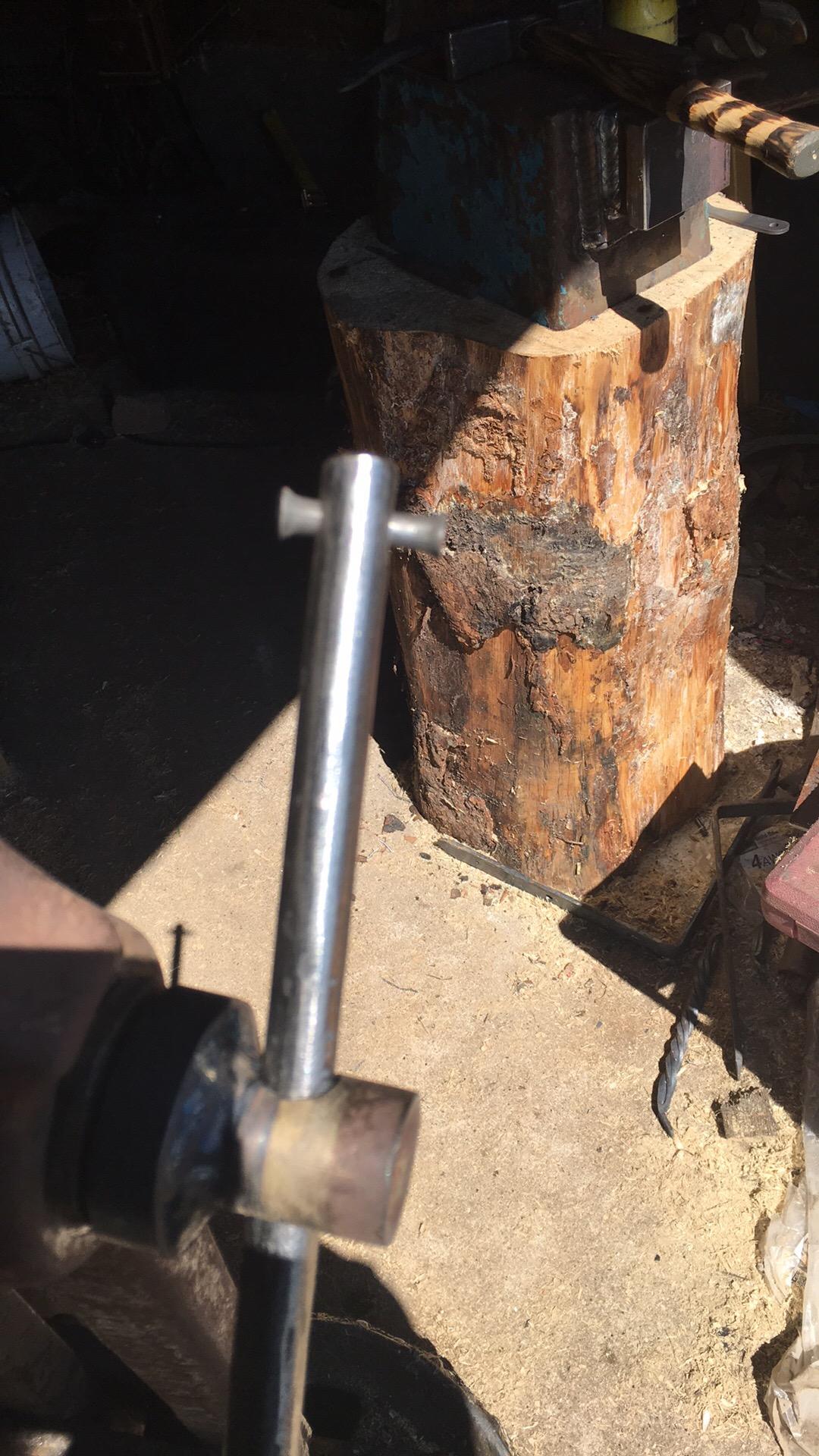

Michael Posted June 11, 2019 Share Posted June 11, 2019 Made a stake tool out of jackhammer bit over the weekend. My friend Angelo opened up his shop to a bunch of (sort of) locals and a bunch of tools were made. Quote Link to comment Share on other sites More sharing options...

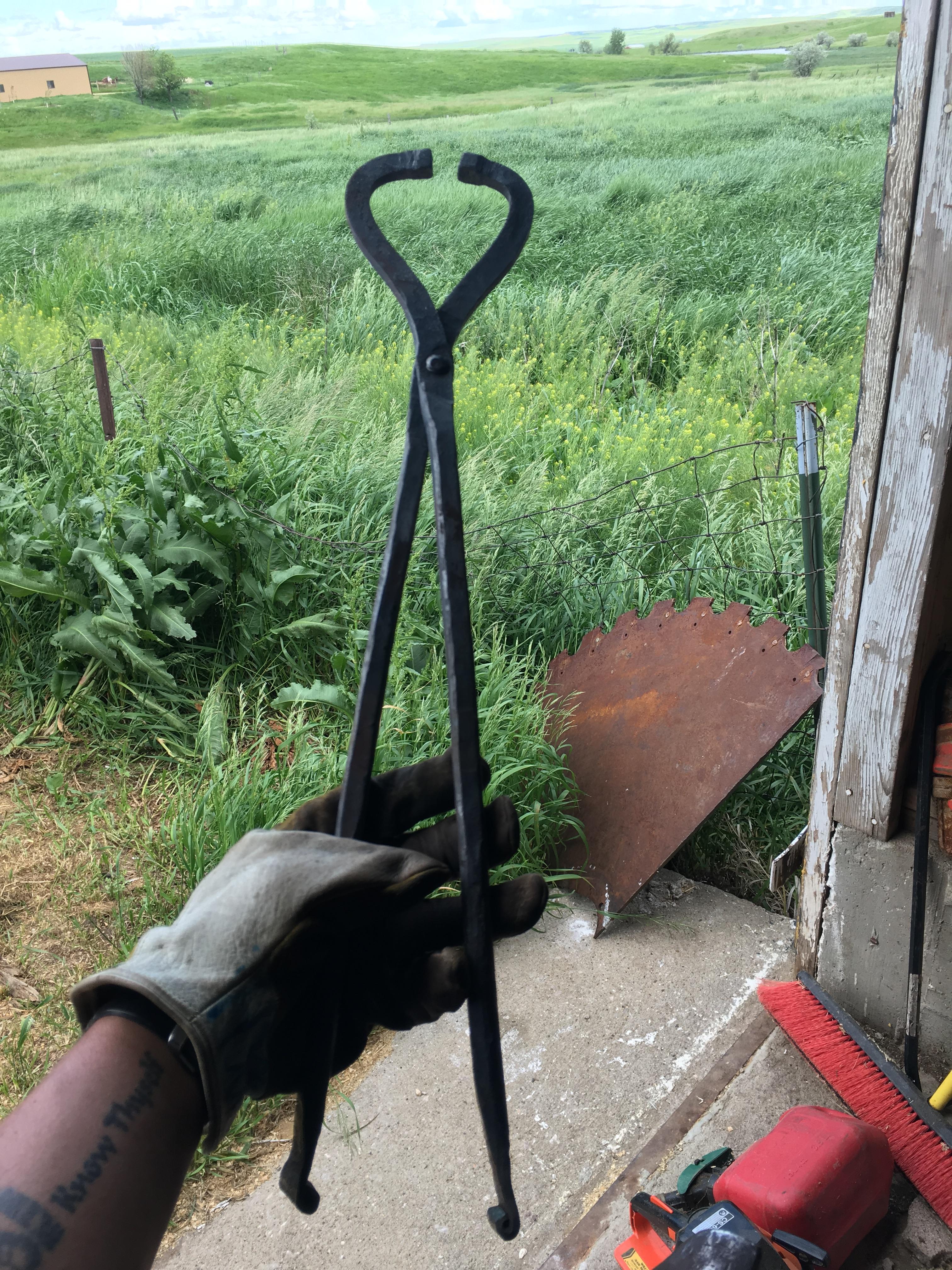

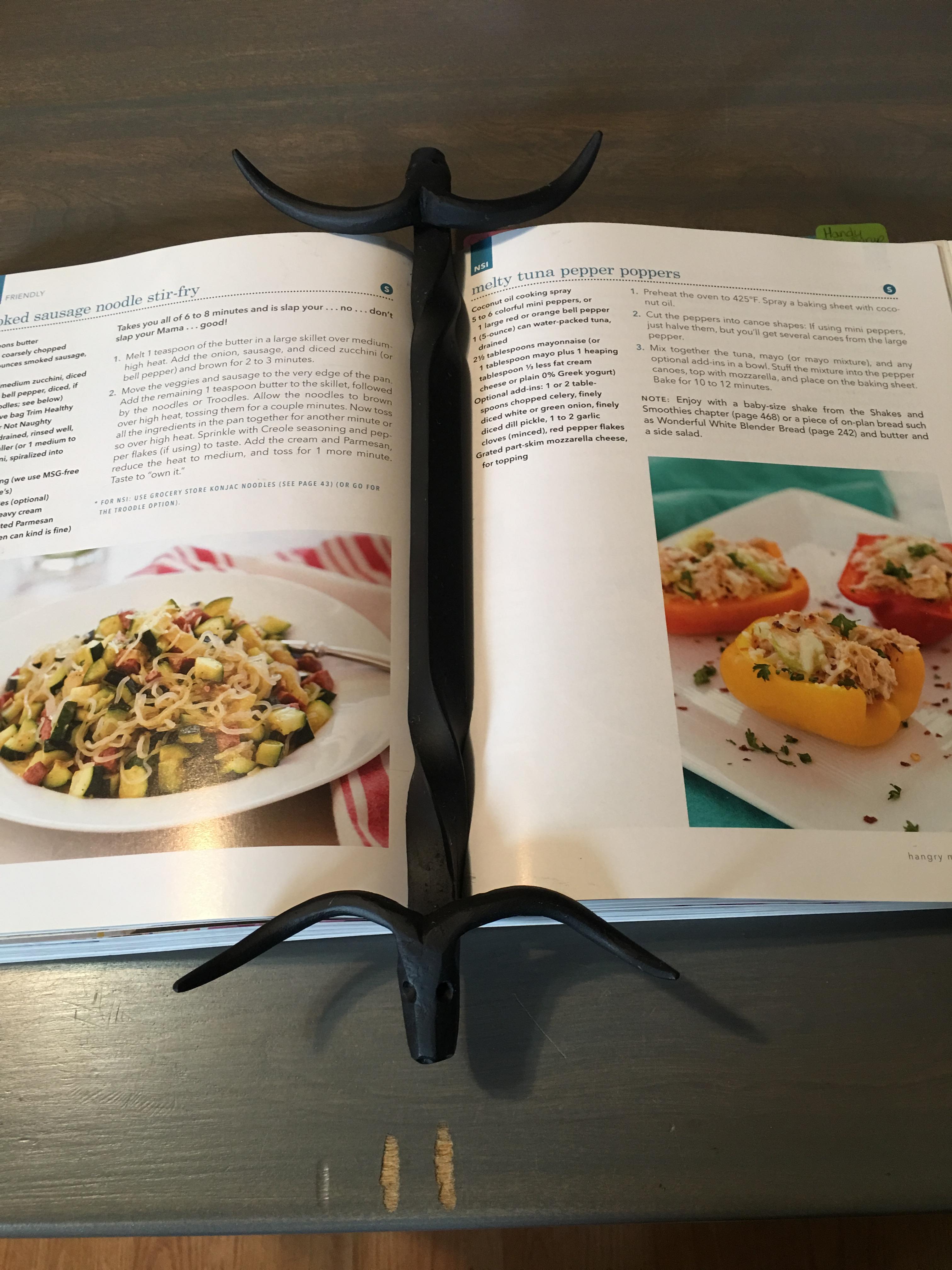

Cannon Cocker Posted June 11, 2019 Share Posted June 11, 2019 I had a good day in the shop today. I put a new handle on my post vice. I finished my wife's cook book holder opener And I finished a set of pick up tongs I started a long time ago Quote Link to comment Share on other sites More sharing options...
