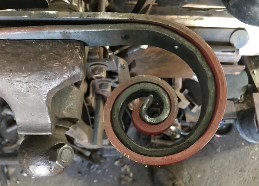

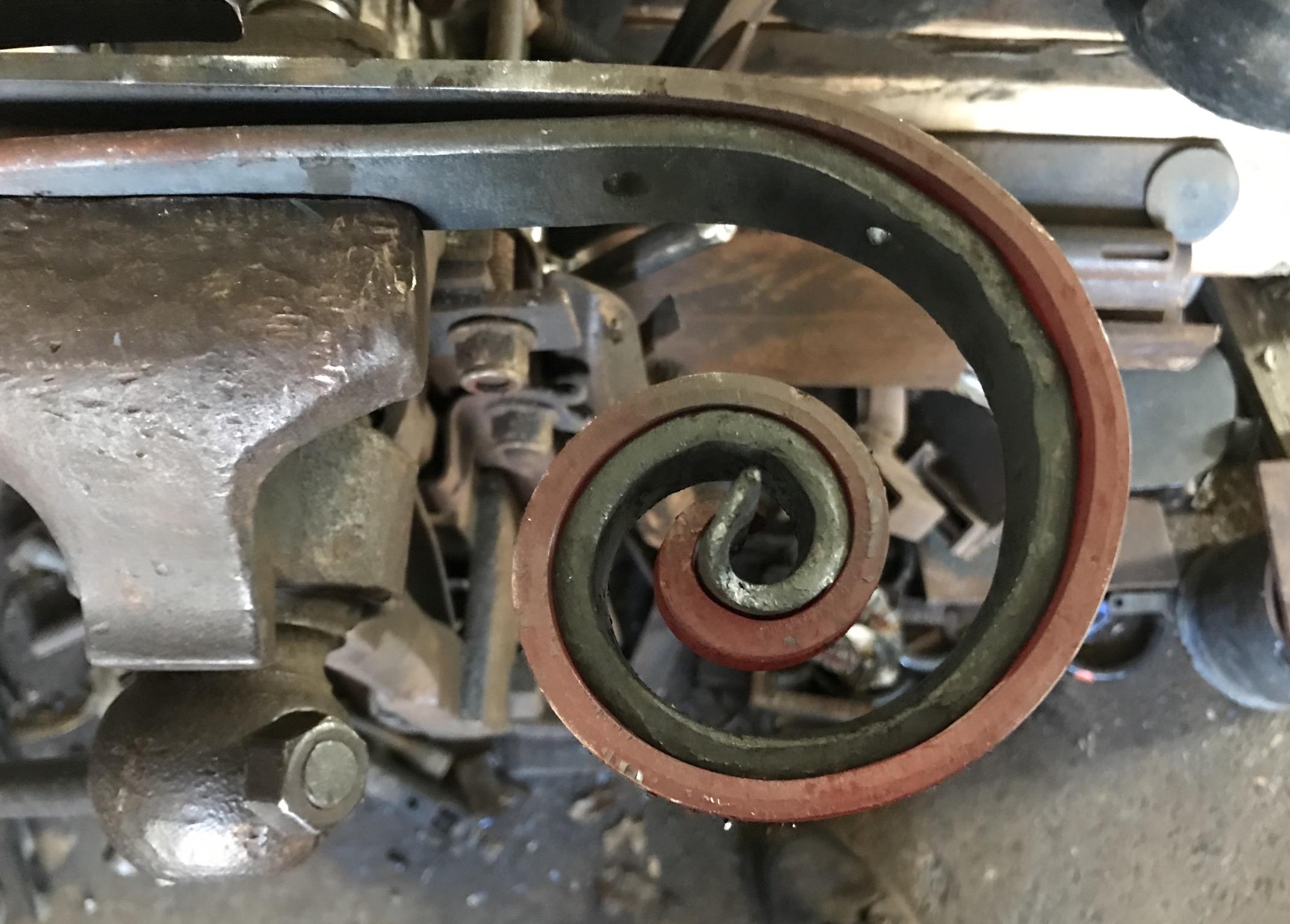

JHCC Posted April 21, 2019 Share Posted April 21, 2019 In addition to doing some corrective work on a hammer head and straightening some sections of coil spring for punches (currently annealing in the hot box and therefore not shown), I made a fork (which still needs some filing): Modified some old twist tongs that never really worked into a pair of punch-and-chisel tongs: And made a scroll former and a test scroll: (with a spiral based on the discussion HERE). Quote Link to comment Share on other sites More sharing options...

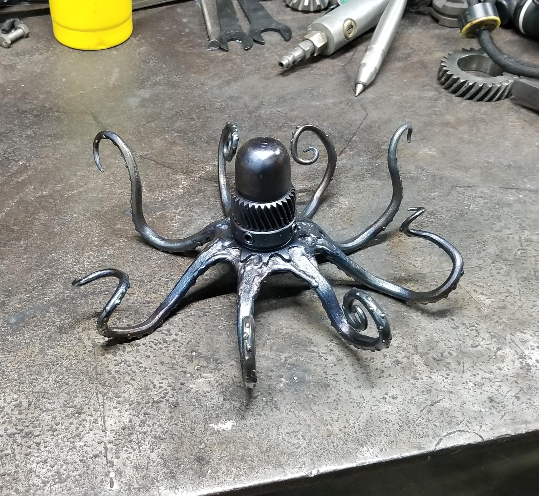

Daswulf Posted April 22, 2019 Share Posted April 22, 2019 Finished the octopus. It's an octopus. If you decide to forge octopus tentacles out of rebar, you better have a good reason lol. Thought I'd utilize some of the texture but didn't. So it was way harder forging and bending the tentacles than it should have been. Quote Link to comment Share on other sites More sharing options...

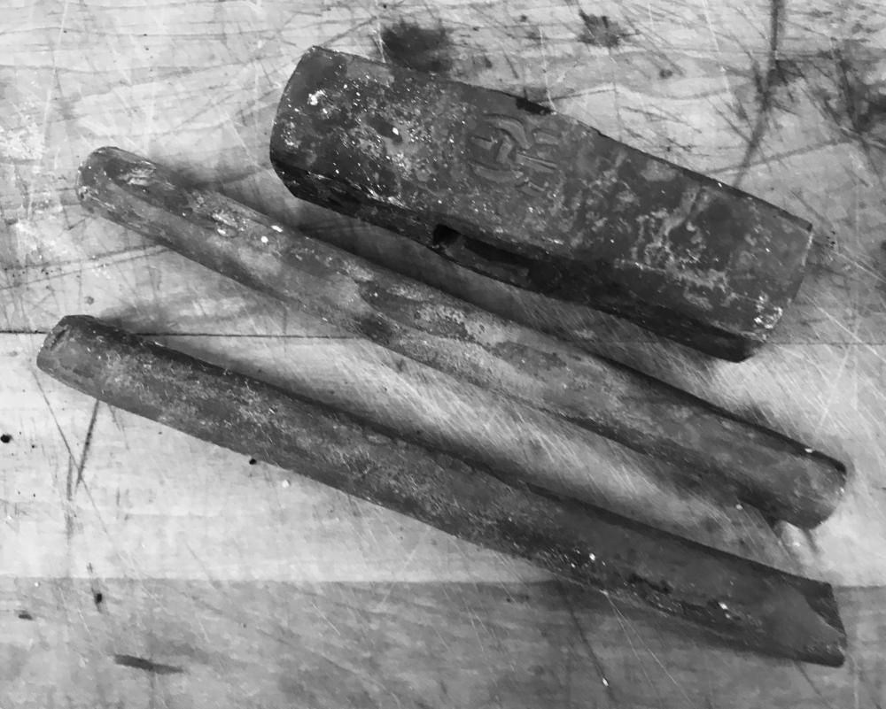

JHCC Posted April 22, 2019 Share Posted April 22, 2019 Rebar is for suckers. 4 hours ago, JHCC said: a hammer head and straightening some sections of coil spring for punches Voila. The hammer head still needs some more forging and grinding, but a major flaw has been largely eliminated. Quote Link to comment Share on other sites More sharing options...
Daswulf Posted April 22, 2019 Share Posted April 22, 2019 I'll leave the suckers to the MIG welder and stick with regular old mild steel for the tentacles. Nice fork John. The tines turned out great. Quote Link to comment Share on other sites More sharing options...

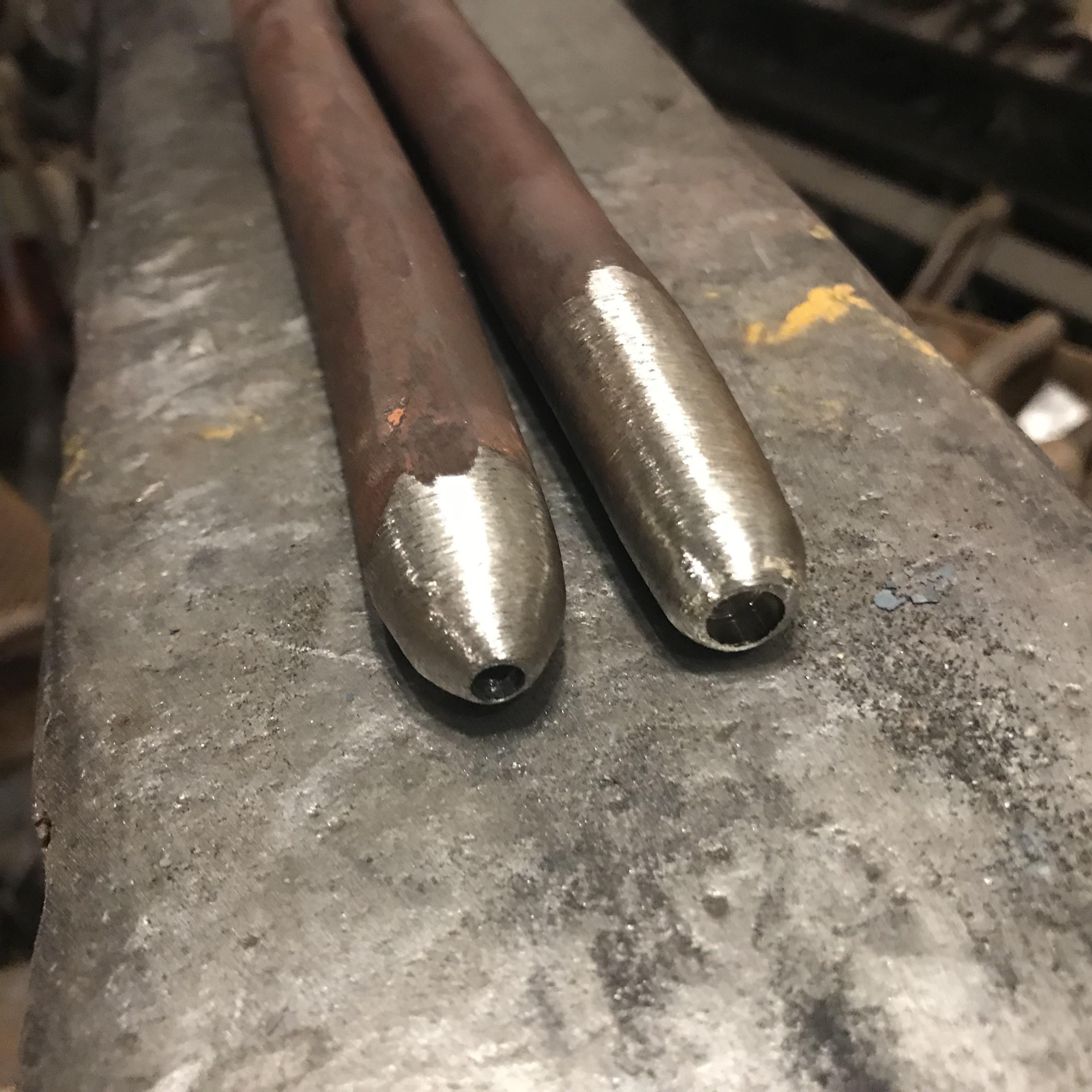

JHCC Posted April 23, 2019 Share Posted April 23, 2019 Drilled and ground a couple of eye punches, to be hardened and tempered later. Quote Link to comment Share on other sites More sharing options...
Frosty Posted April 23, 2019 Share Posted April 23, 2019 21 hours ago, Daswulf said: Finished the octopus. It's an octopus. I love it. The body makes it look like a cyborg octopus: Borgtopus, Octoborg, Octobot, Roboctopus? A couple brass gears and it'd be a SteamPunktopus. No rebarcotopus. Thank's Das, that's in my book of mistakes not to make for myself. Frosty The Lucky. Quote Link to comment Share on other sites More sharing options...
Daswulf Posted April 23, 2019 Share Posted April 23, 2019 Well if you ever thought about making octopus tentacles......Lol. I like octobot or roboctopus better. Quote Link to comment Share on other sites More sharing options...

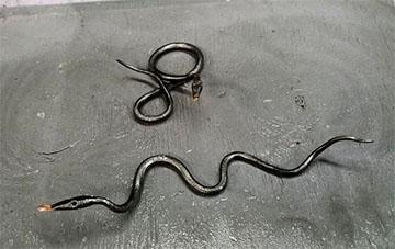

Daswulf Posted April 23, 2019 Share Posted April 23, 2019 Made a couple snakes and started tome leaf key chains and a feather. Certainly never enough time at the forge anymore and I do what I can when I can when there. Quote Link to comment Share on other sites More sharing options...
ausfire Posted April 23, 2019 Share Posted April 23, 2019 A fine octopus, Das. I feel your pain with the rebar. Interesting snakes. Can we have a close-up of the head with the copper (?) tongue? Very useful eye punches, too, John. Drilled first and shaped? Looks too neat for the ball bearing method. I would like to find a way of forging an eye punch that has a spot in the middle. I don't think it's possible. My demo today was ram head bottle openers. Nothing special enough for photos. Also did a couple of 6mm round bar knots into key holders. Tried one in 6mm stainless and it finished up in the scrap bin. Painful stuff to bend into a knot. Quote Link to comment Share on other sites More sharing options...
