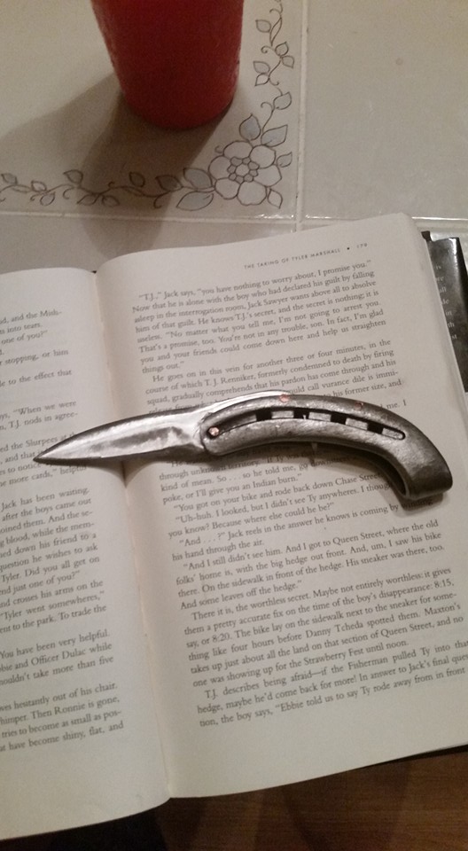

Nobody Special Posted December 4, 2015 Share Posted December 4, 2015 Playing with a new to me type of folder. Body's half a horseshoe, blade's 5160 scrap, copper pins, and a leather spacer. A little heavy, but not too bad. Might shave the inside down a bit on the next one. Wife provides the shoes, she gets the prototype. Pics are loading sideways, so make sure and turn your head. Quote Link to comment Share on other sites More sharing options...

Frozenthunderbolt Posted December 4, 2015 Share Posted December 4, 2015 Thanks for the idea NBS, there is no locking mechanism in this one correct? Could we get a picture of the spine view open and closed? Quote Link to comment Share on other sites More sharing options...
Nobody Special Posted December 4, 2015 Author Share Posted December 4, 2015 Nah, just a friction folder type, and the blade/spine fetches up against the pin as a stop. It was a little loose, so I put a leather washer in it, firmed it enough. No pics today, my wife's off giving riding lessons. Quote Link to comment Share on other sites More sharing options...

Nobody Special Posted March 30, 2016 Author Share Posted March 30, 2016 Been working on some larger ones, and ground down the insides of the handles; it really cut the weight. Quote Link to comment Share on other sites More sharing options...
Nobody Special Posted April 3, 2016 Author Share Posted April 3, 2016 New version, longer, lighter, niftier. Quote Link to comment Share on other sites More sharing options...
