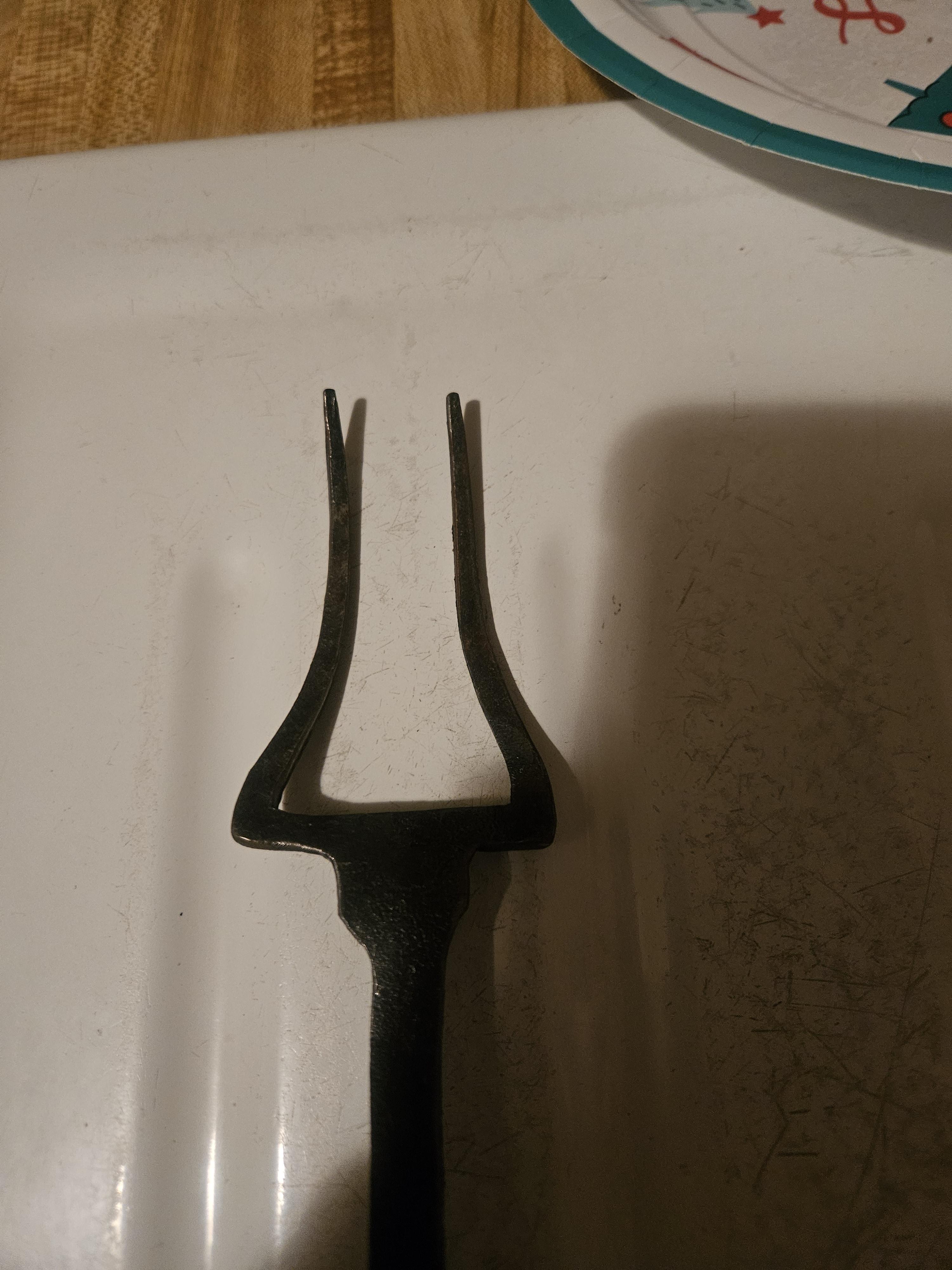

Gewoon, when i do BBQ forks i have found that getting the bar to "T" shape is best before bending the forks. I use a vice and upset the center with a few quick hammer blows. As of late i have been putting upset corners about 1" from center to get my forks done. You can see real well what i mean by "T" shape.

Interesting way to forge a BBQ fork Billy, it would be easy to forge into a more rounded "traditional" shape. I like to make mine more of a feminine profile. I use an anvil bridge to forge the tines, trim them even lengths and open and shape them and lastly file the tines to finish. I use a hack saw or my band saw to split the tines after forging the uniform taper preform.
I form the inside of the fork over a bottom fuller, using the horn tends to twist things being conical.
BBQ forks are a challenge and were I to start producing them in any quantity I'd make purpose built swage and fuller.
For a while i did, i guess Colonial style, where i bend the tines back toward the handle about midway, then use an anvil bick to get "bellies" at the base of the tines. They look kind of like a keyhole spatula shape.

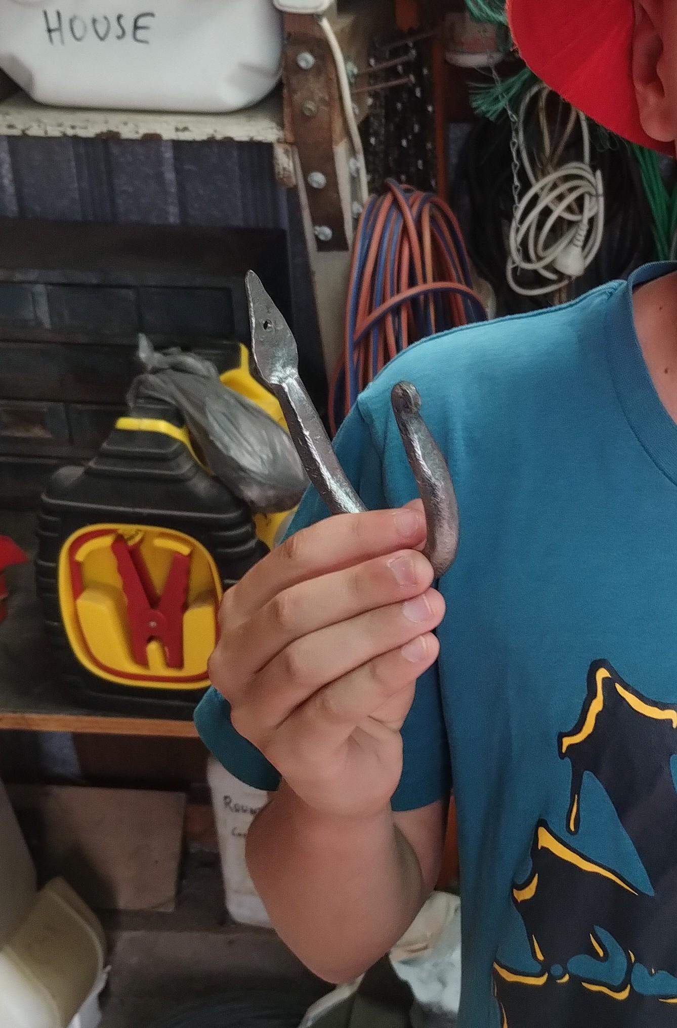

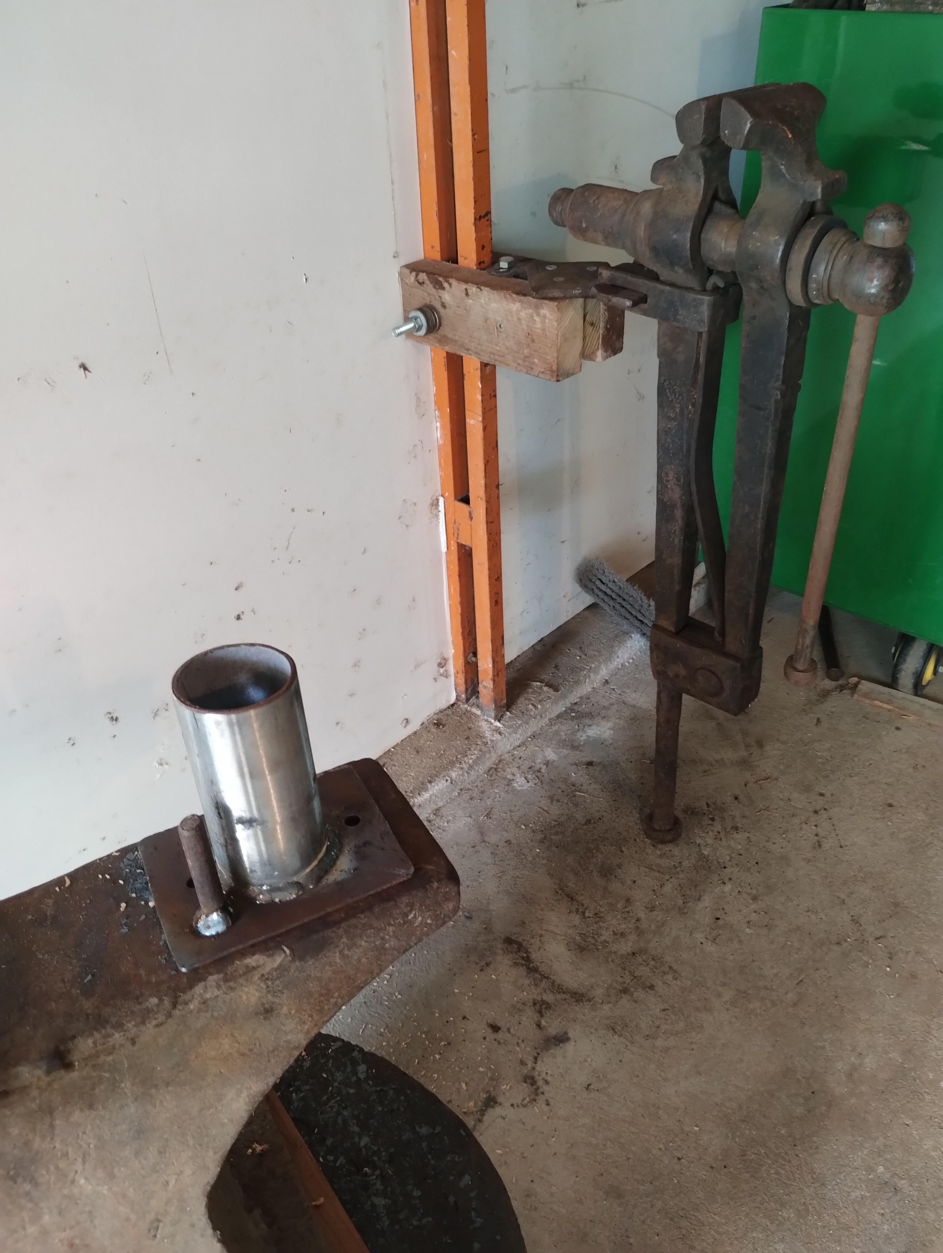

Today I roughly mounted my post vice to the wall as I cannot seem to find the piece of I beam I thought I had. I'm sure it will turn up one day and then I will make a moveable set up.
I had my nephew over and he has started to have an interest in making stuff with wood so I showed him how to make stuff with metal.
I made a bending jig for the hardy hole and then made him a J hook which he took home.
Still have a long way to go with the hooks but getting better with each one I make.
Any suggestions on what to coat the hooks in to stop them rusting? Is there any stuff I could make myself?

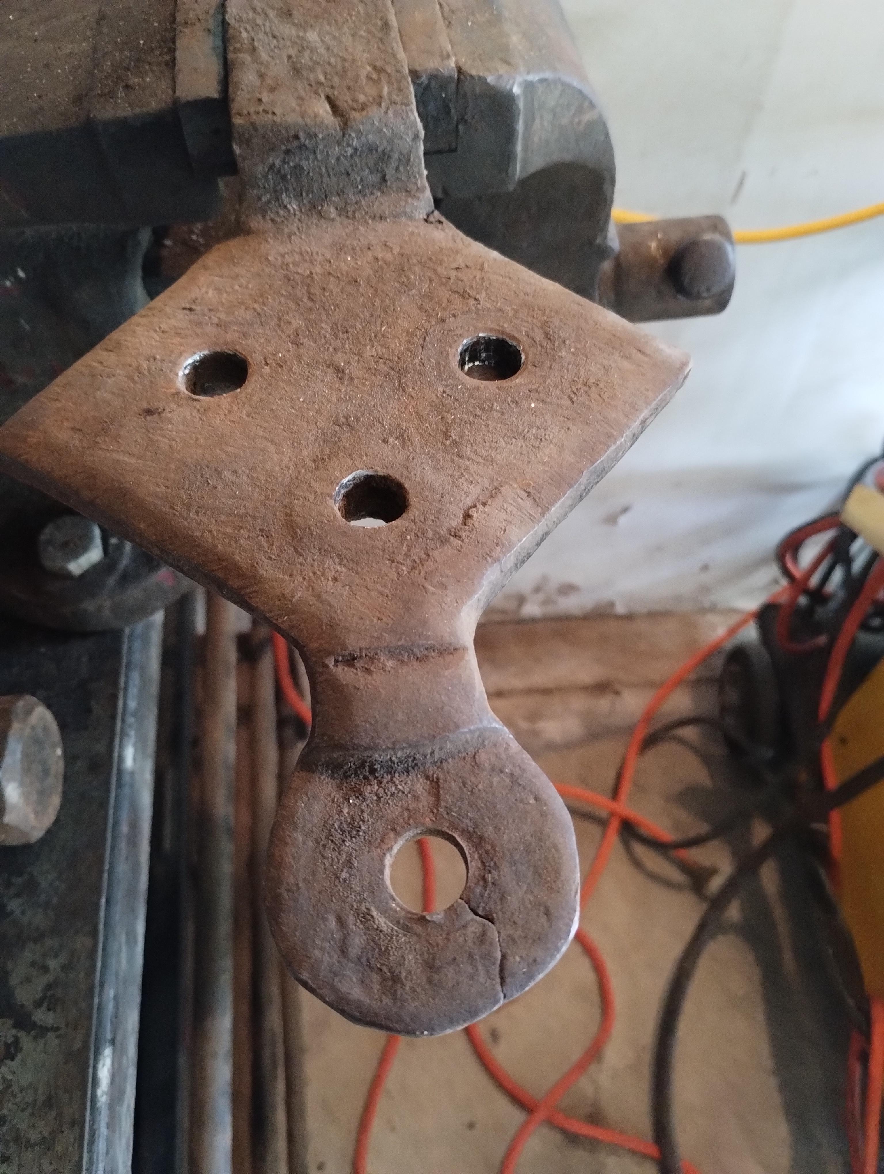

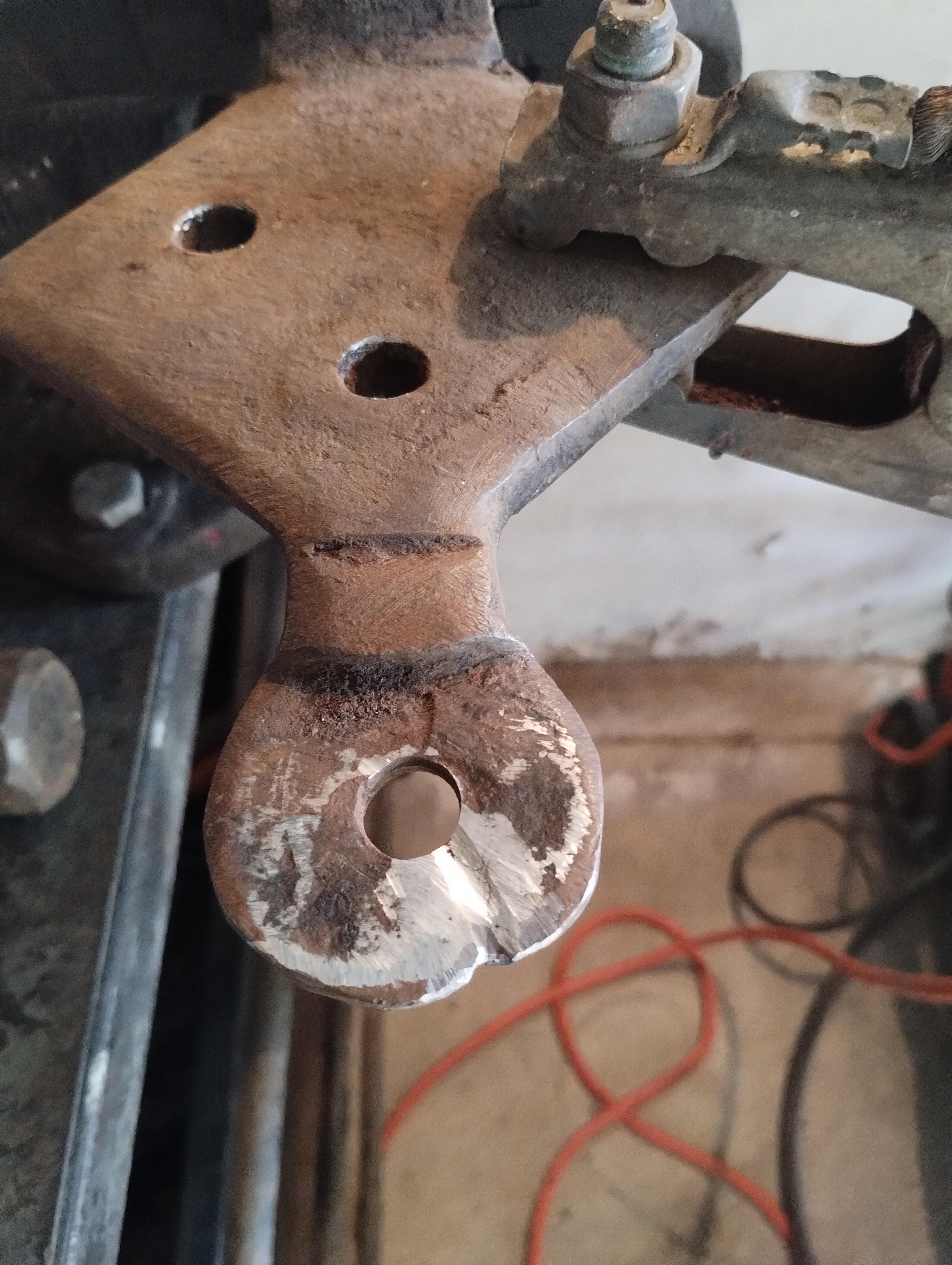

I also found a crack on the post vice mount plate which I repaired both sides before I installed it.

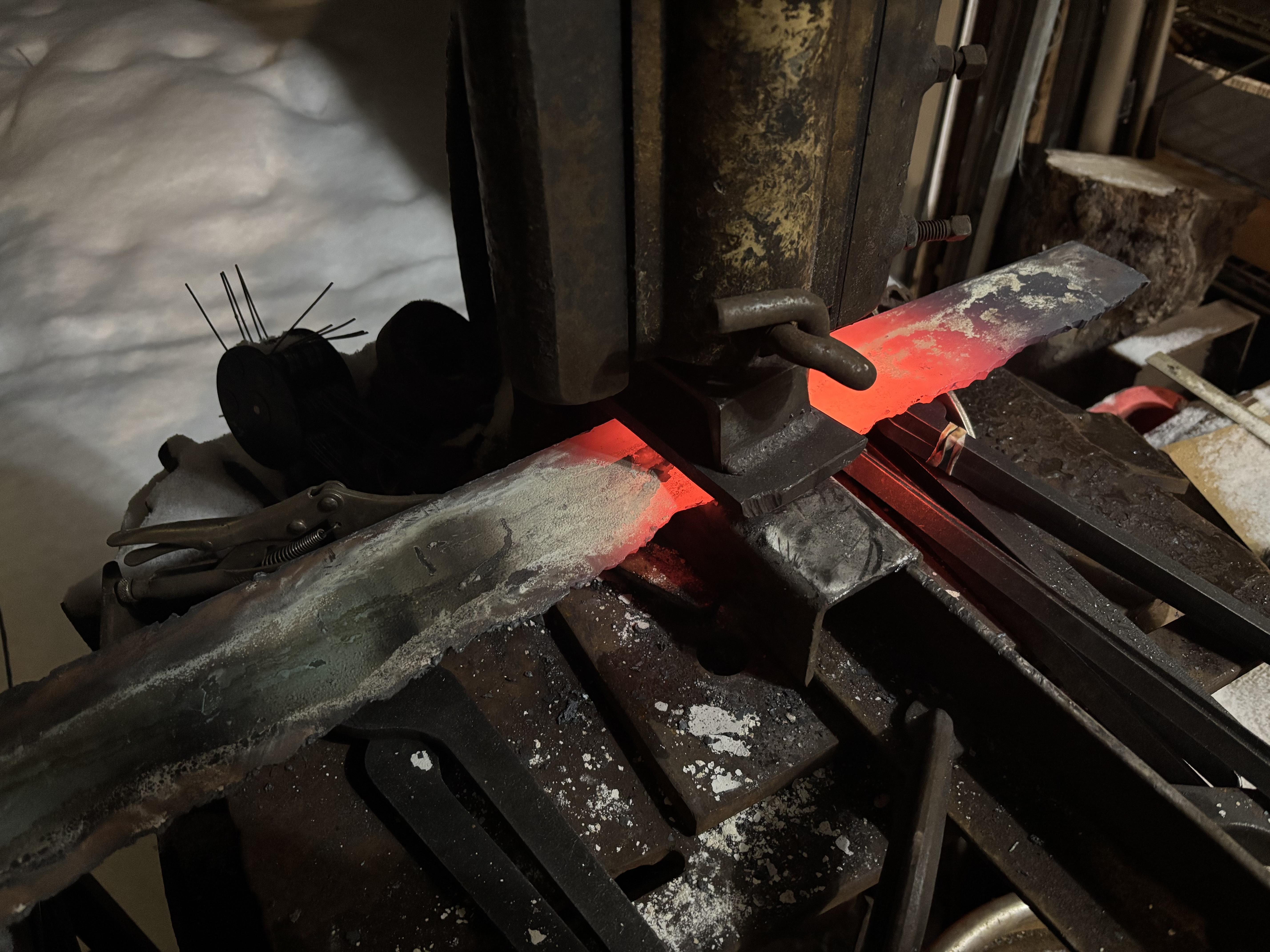

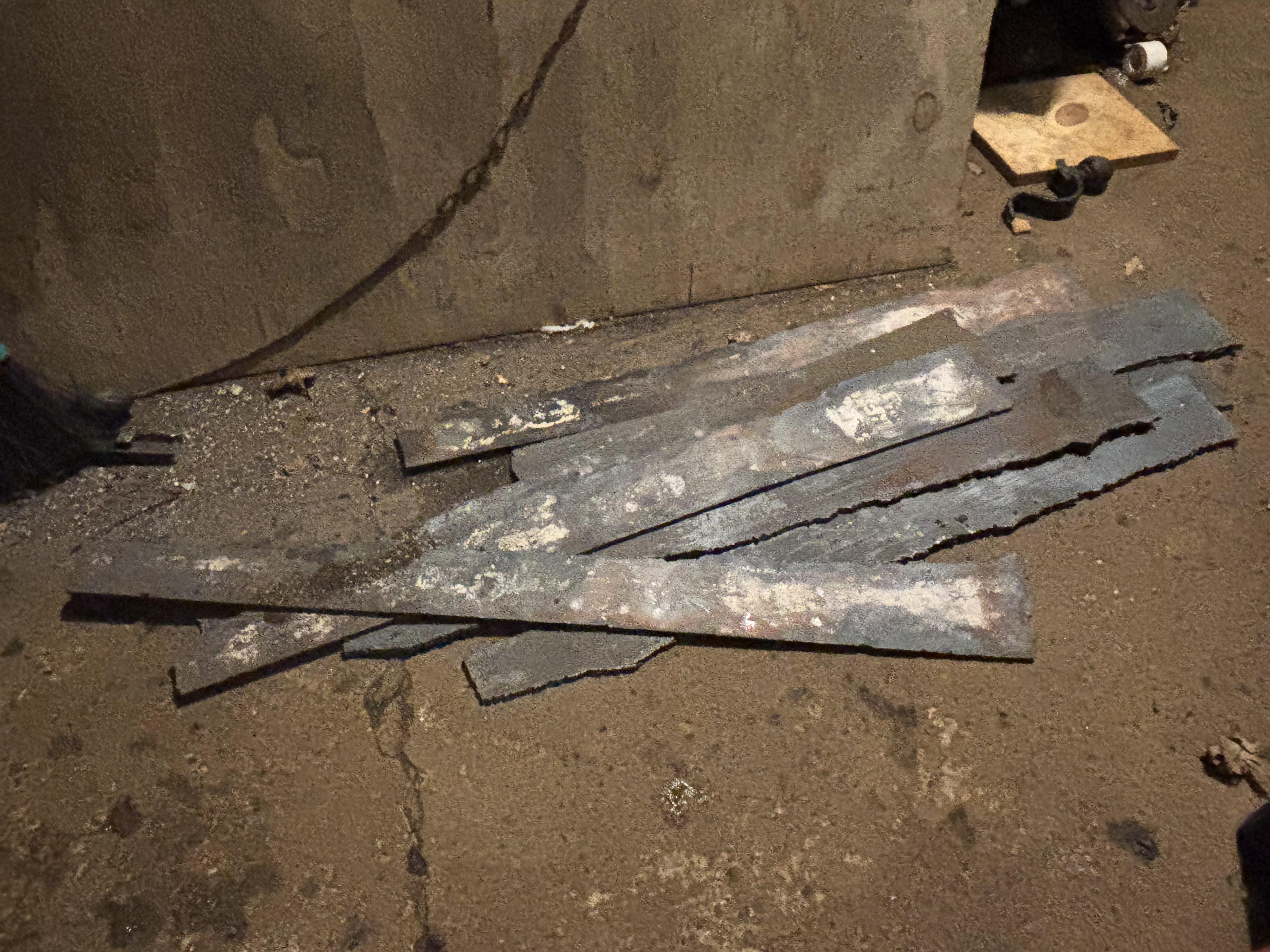

Finished flattening out the gas cylinder sections on the fly press:

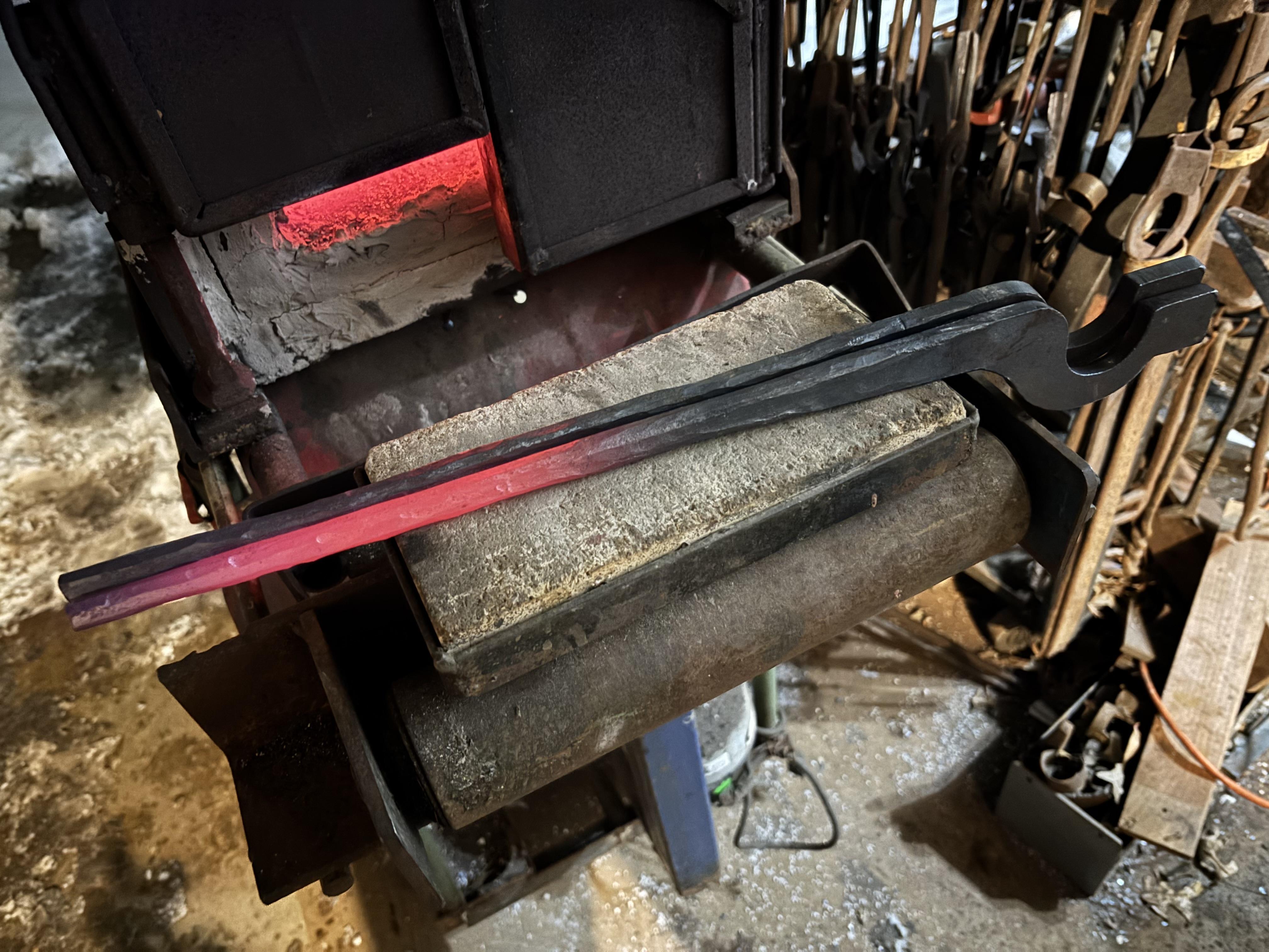

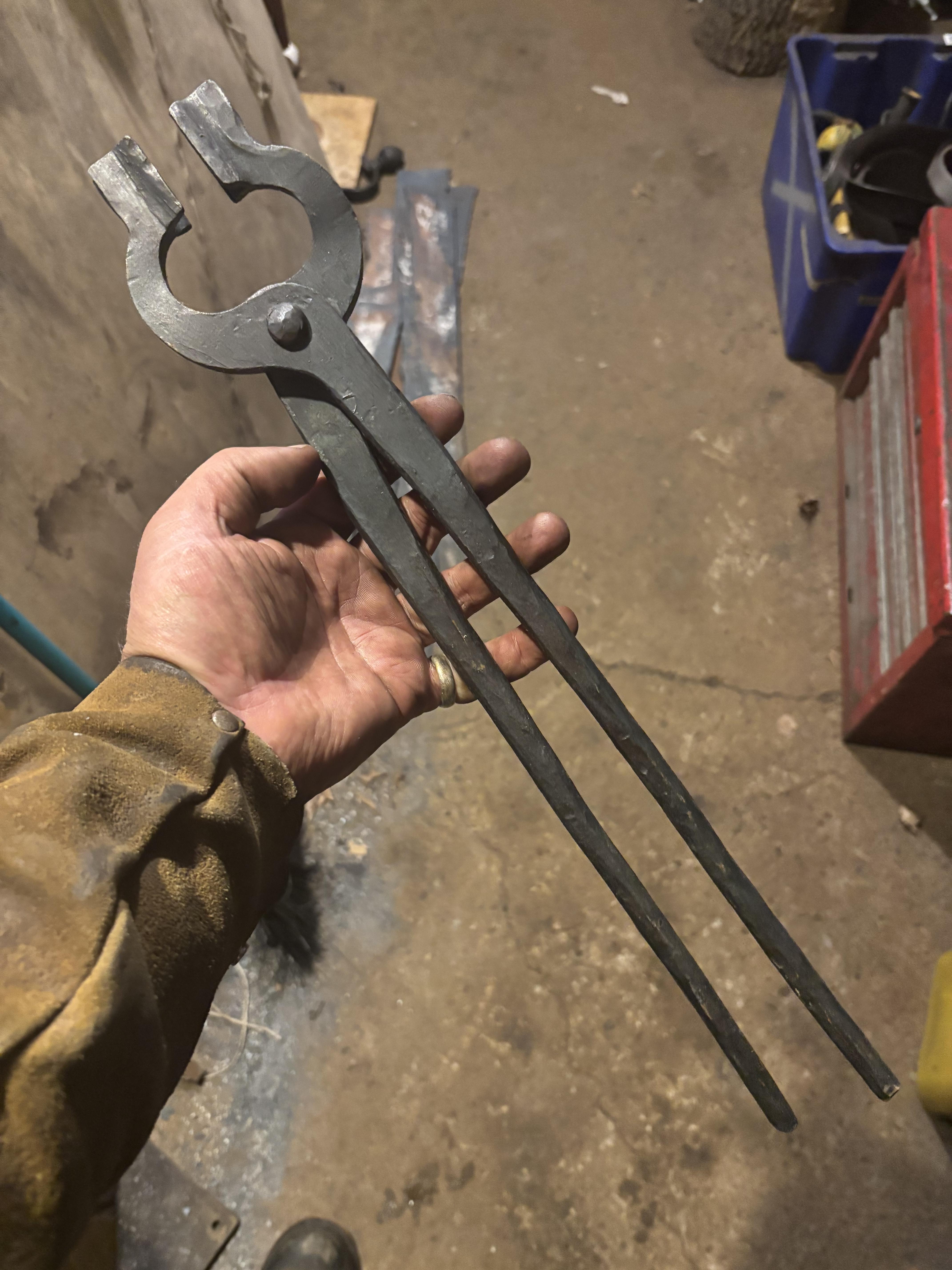

And started drawing out the reins of a pair of Ken’s Custom Iron bolt tongs, before my tanks froze up:

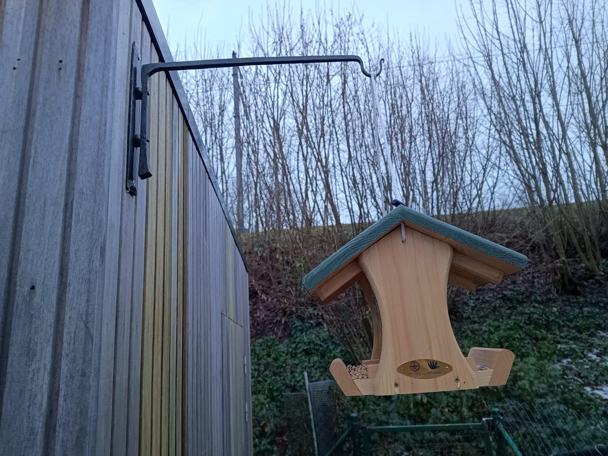

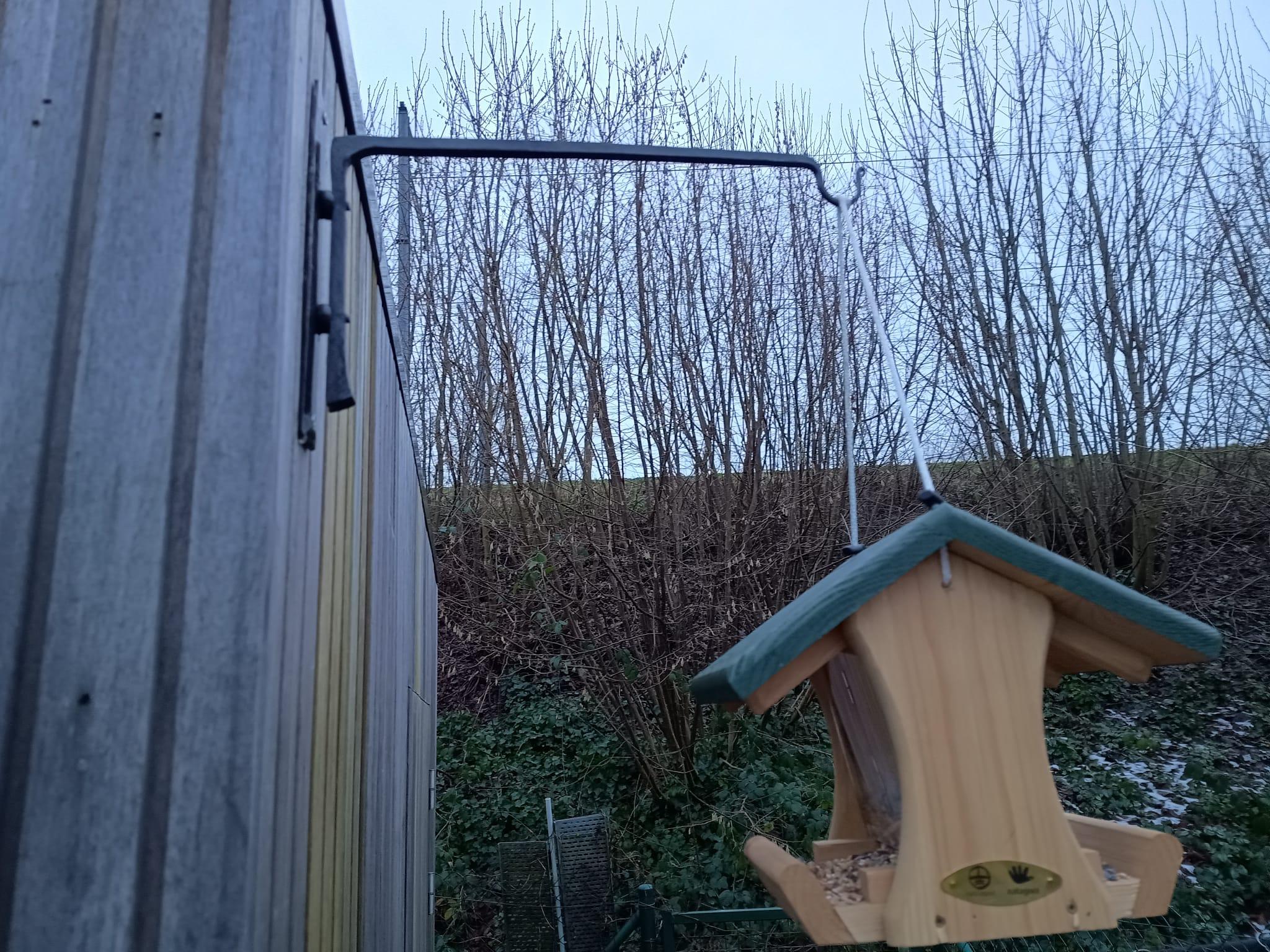

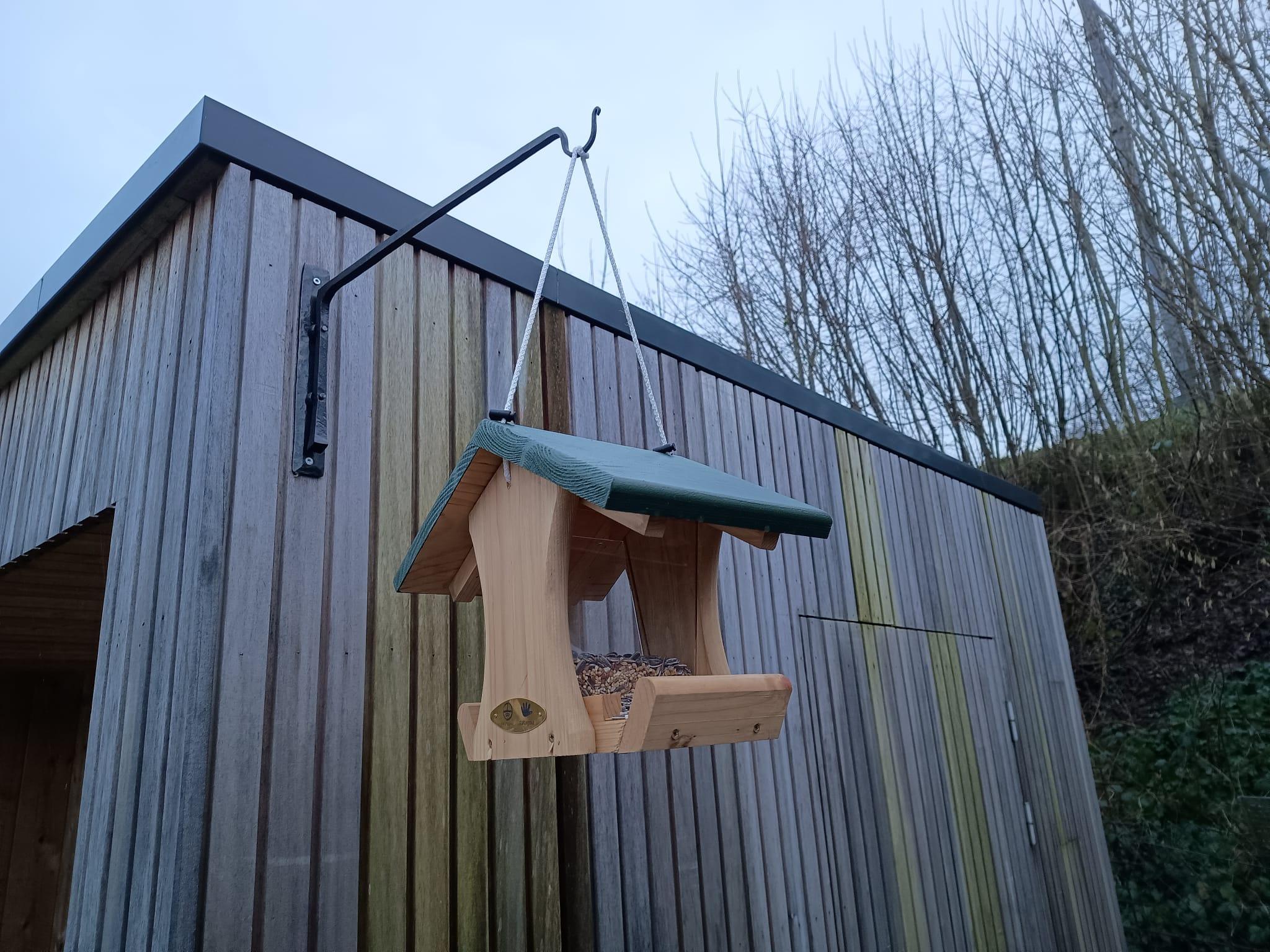

A nice hook for a birdfeerder (actually some time ago, but now i finally took pictures)
Nice corners on that Gewoon.

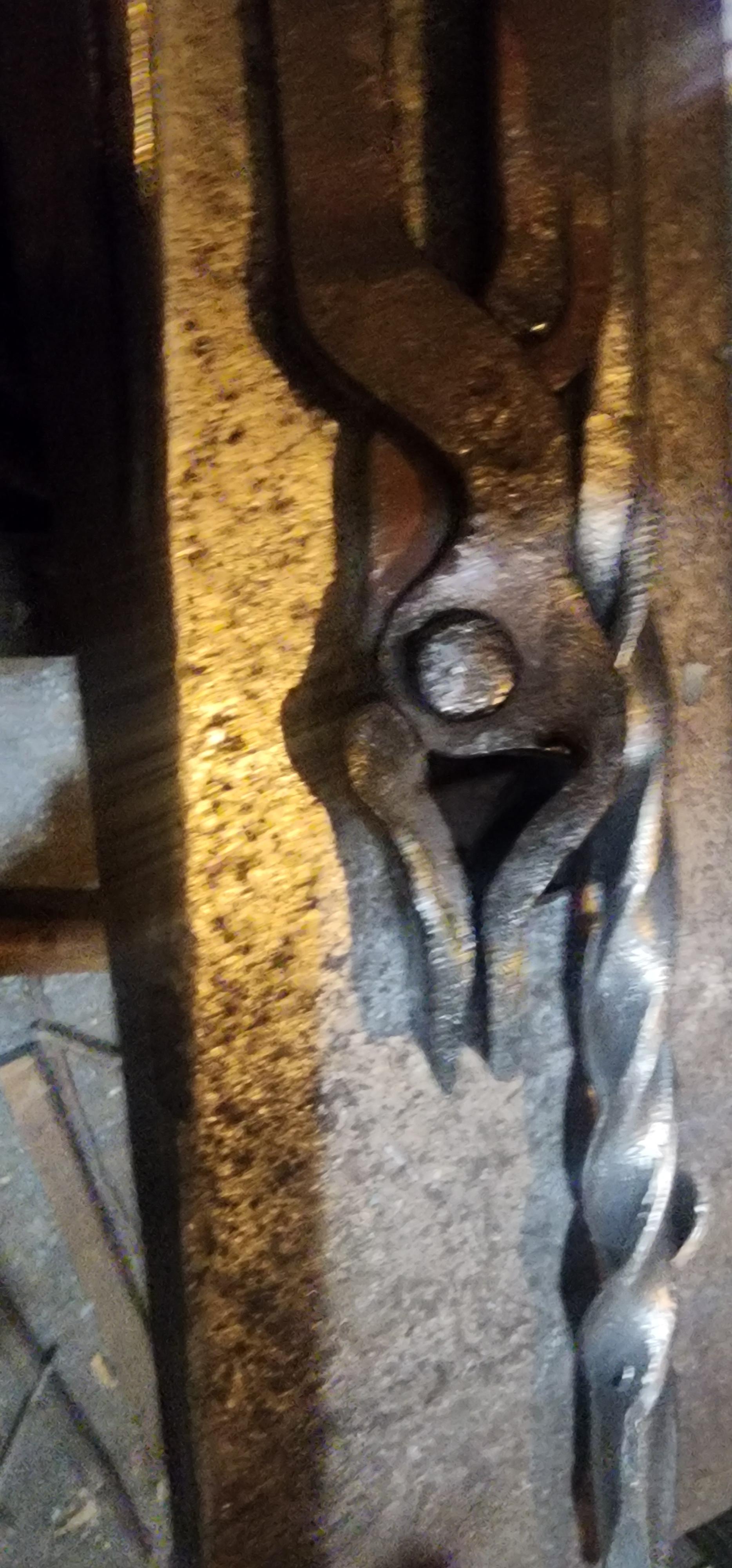

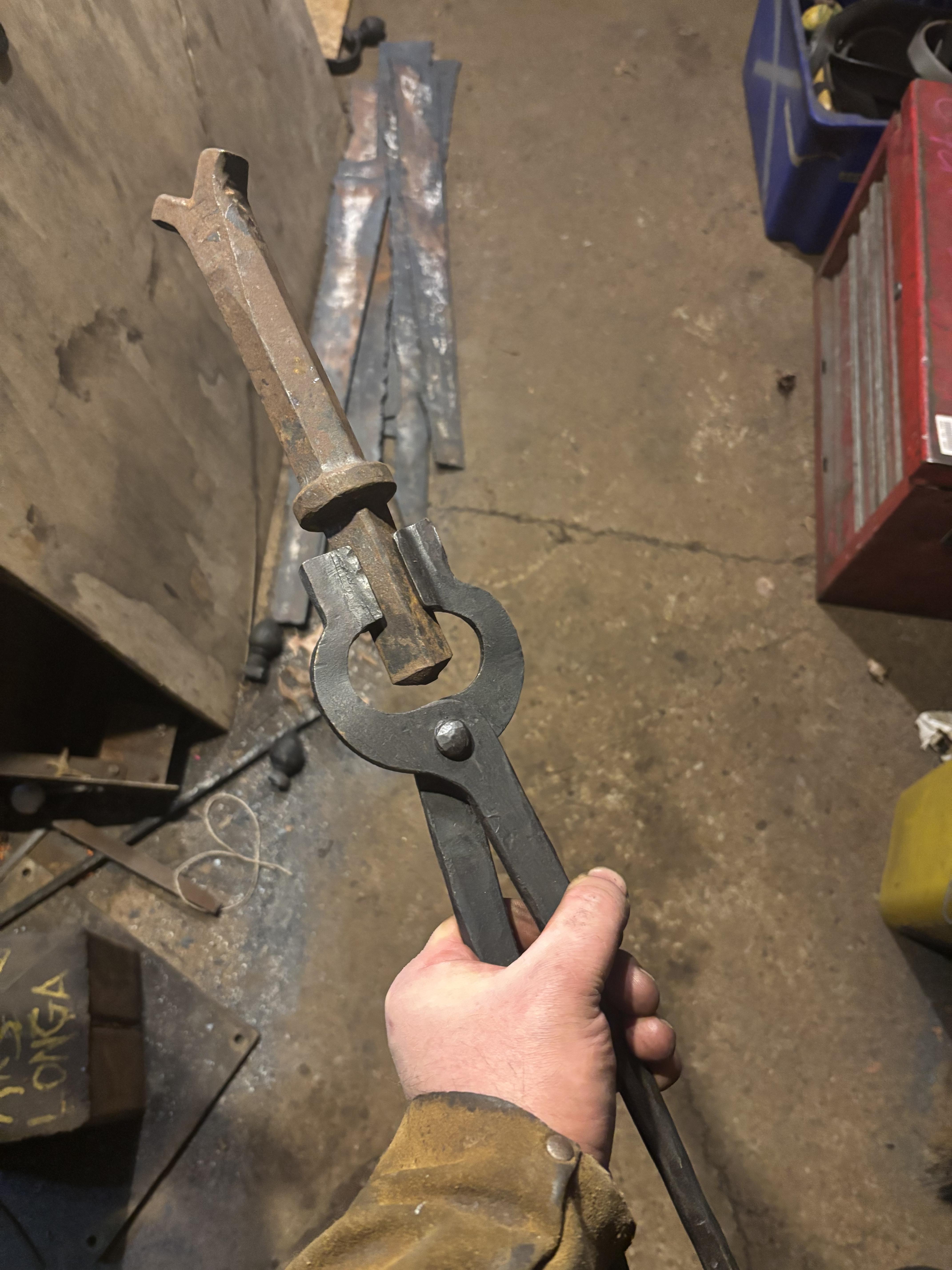

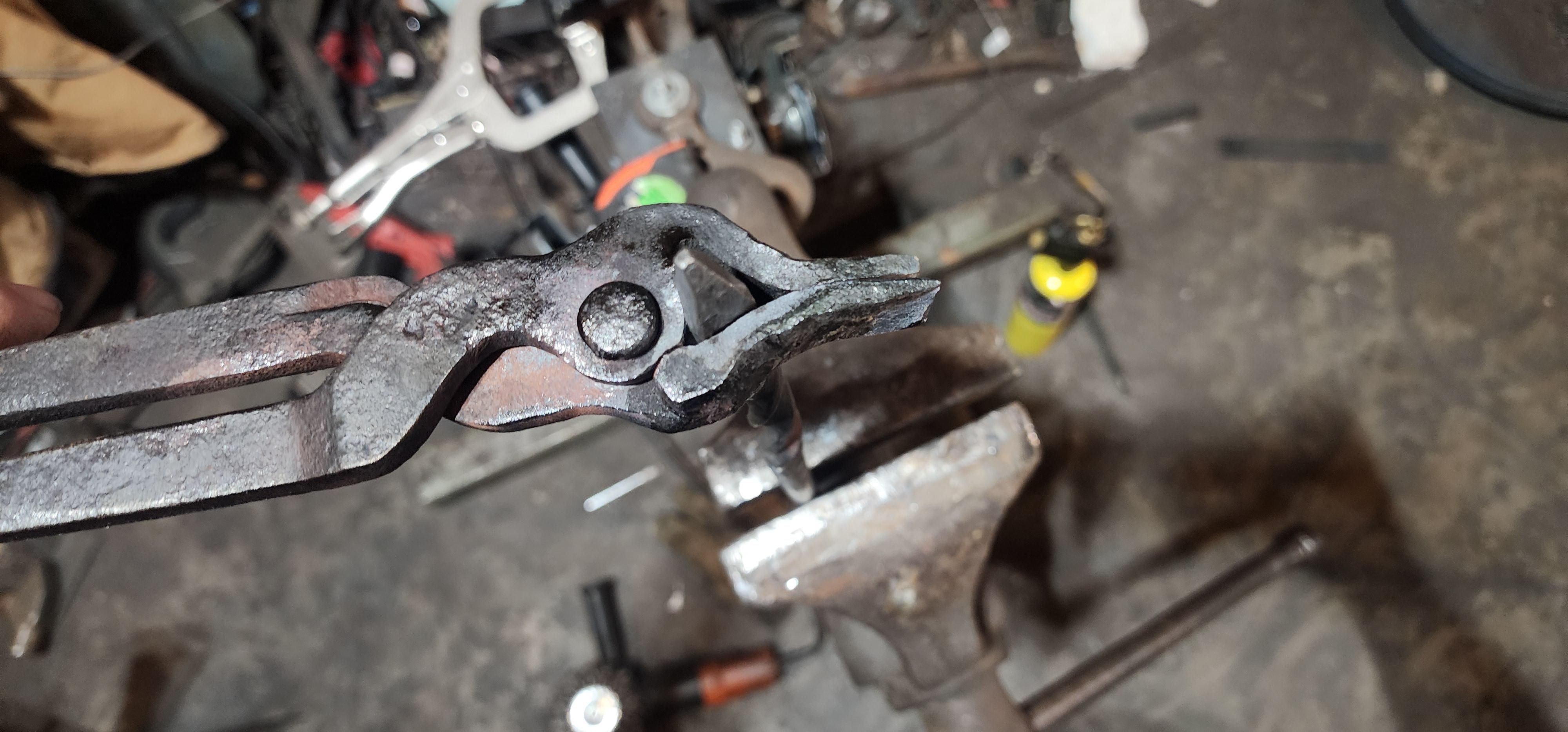

Frosty, I finally got out to the shop and took a couple more pictures of the modified nippers for the triangle twist tongs.  Not sure what you wanted to see on them. My thinking was to purposely leave them with the ends flat so I could use them to handle a but if flat stick as well.   I need to figure a way out to make them so there's a handle on the opposite side of the reigns.
So, if I read the picture right, the triangular space between the bits and the boss is for grabbing the triangular stock while you make the twist? Clever.

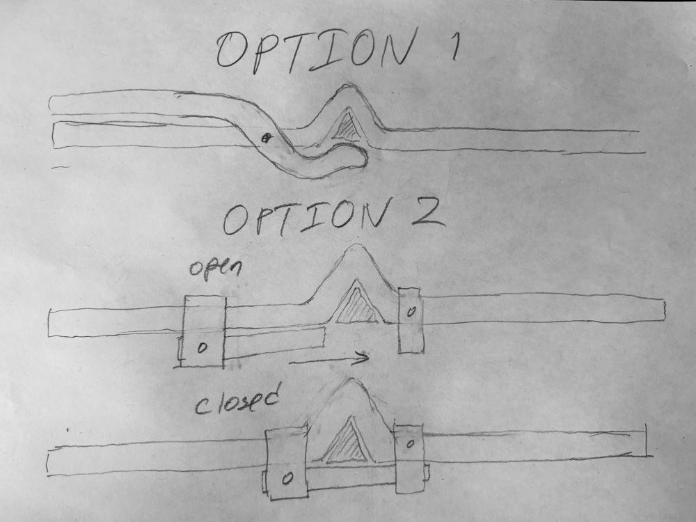

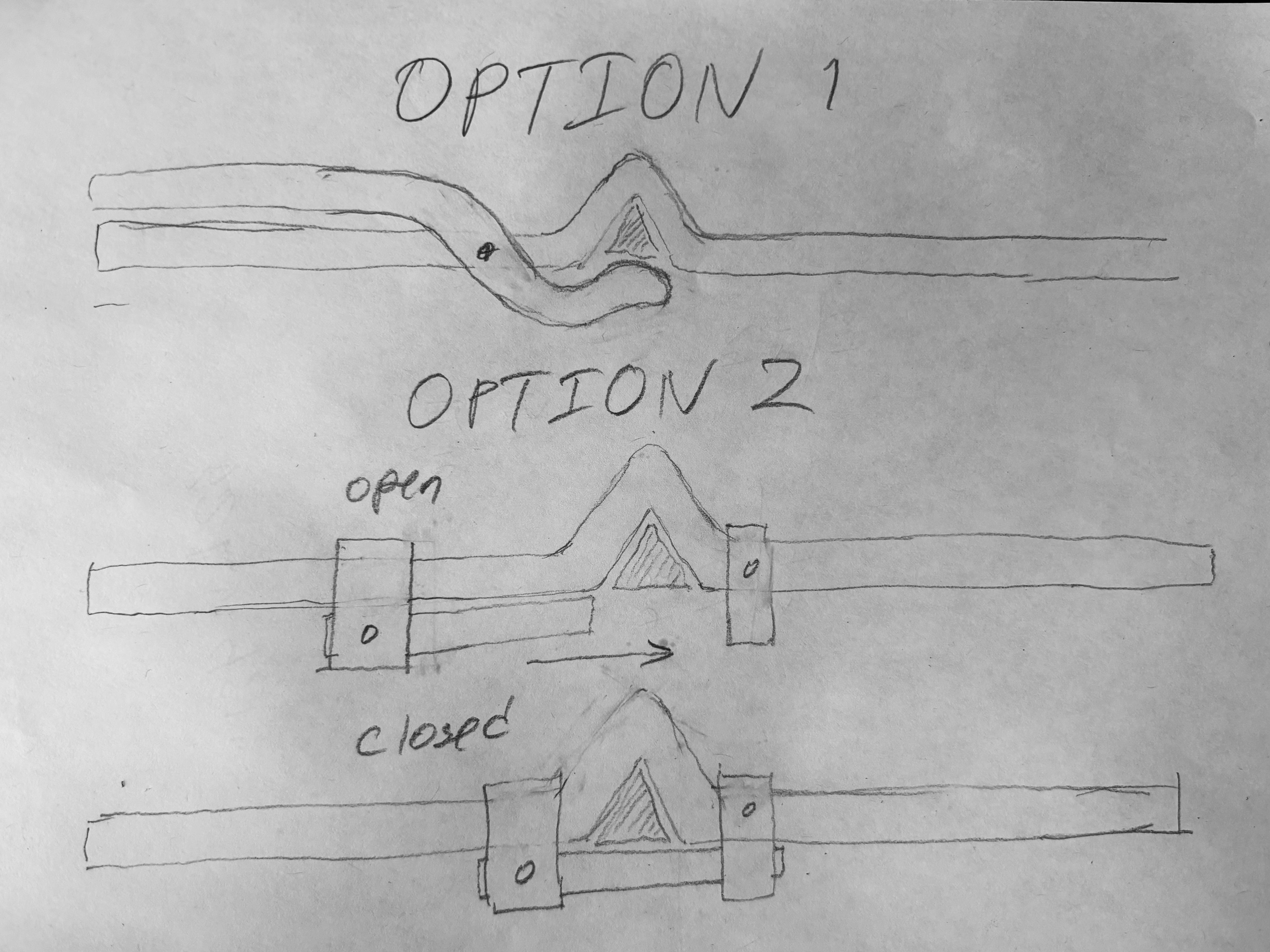

Two possibilities occur to me.
Option 1 is to make a purpose-built pair of tongs with one very long jaw as the handle. This has the advantage of accommodating some variation in the size of the stock.
Option 2 is to abandon the tong idea entirely and make a twisting wrench with a sliding bolt to lock the stock in place. This has the advantage that you wouldn’t have to worry about squeezing the reins while you twist, but would be less forgiving to variations in stock size.
There’s a third option not show here, which is simply a long piece of flat bar with some triangular holes in different sizes. The disadvantage of this option is that it only works if you can fit the wrench over the end of the workpiece.
Very pretty. I like the spacers between the hook and the mounting plate. A simple detail that makes the design much more sophisticated.
I really like your bird feeder hanger Gewoon. Ditto what John just said above it not only looks very nice it shows off your talent as a smith.
Slick tongs Chad! The easy way to add a twisting handle without modifying or heck making something is to use another pair of tongs on the bits on this pair so you're holding a pair in each hand.
It won't be like having a purpose made twisting wrench but it'll be much better than twisting from one side. Hmmmm, maybe?:)

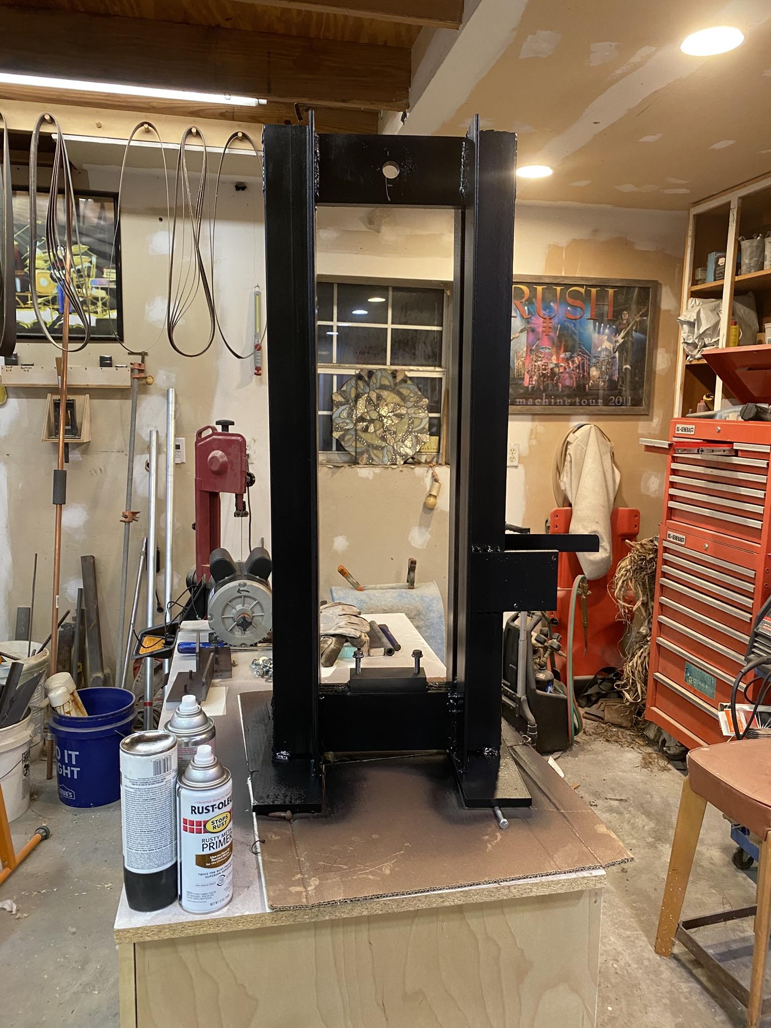

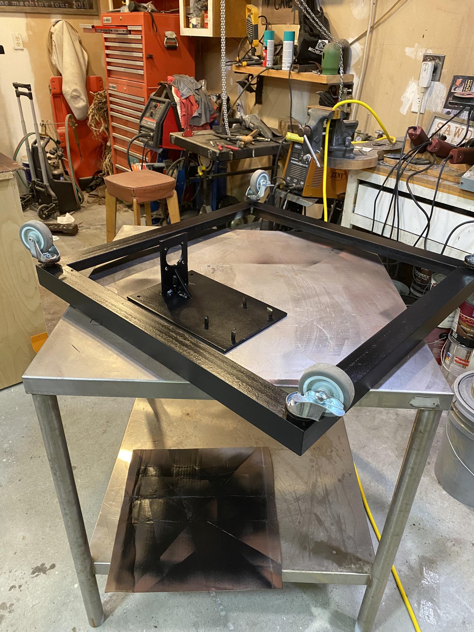

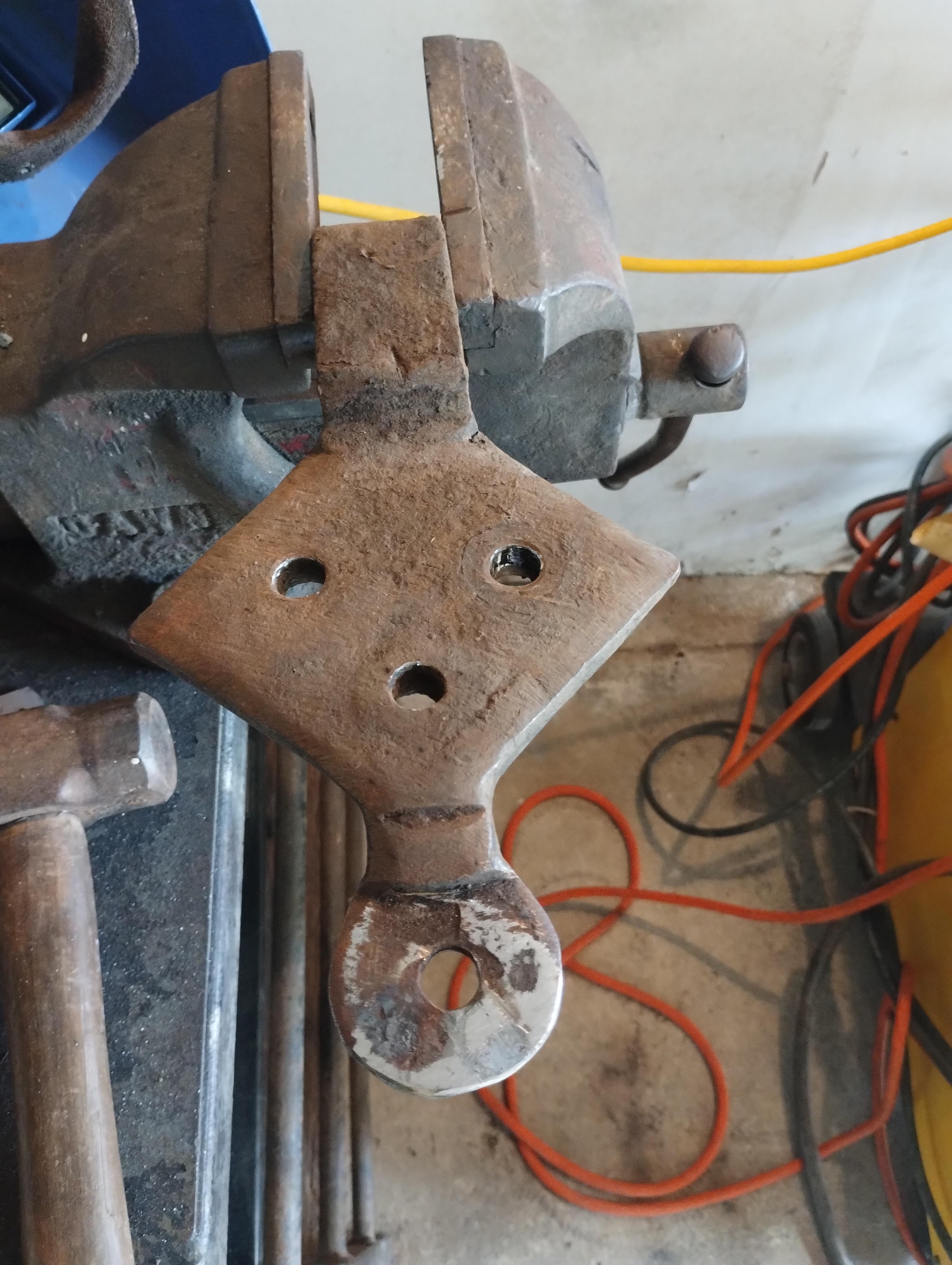

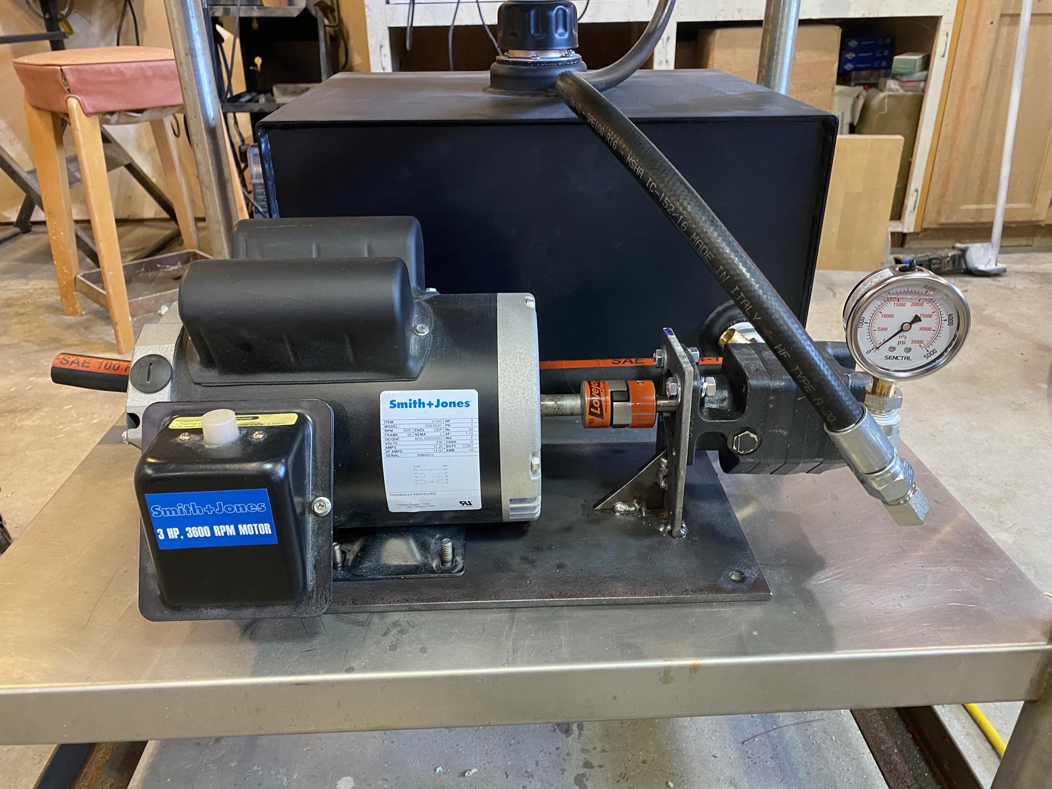

Painted. Getting ready to move everything to my smithty and put it all together.

Finished my first pair of Ken’s Custom Iron bolt tongs. These are sized for 7/8” square, which just happens to be the proper shank size to fit the hardy holes of my two main anvils.

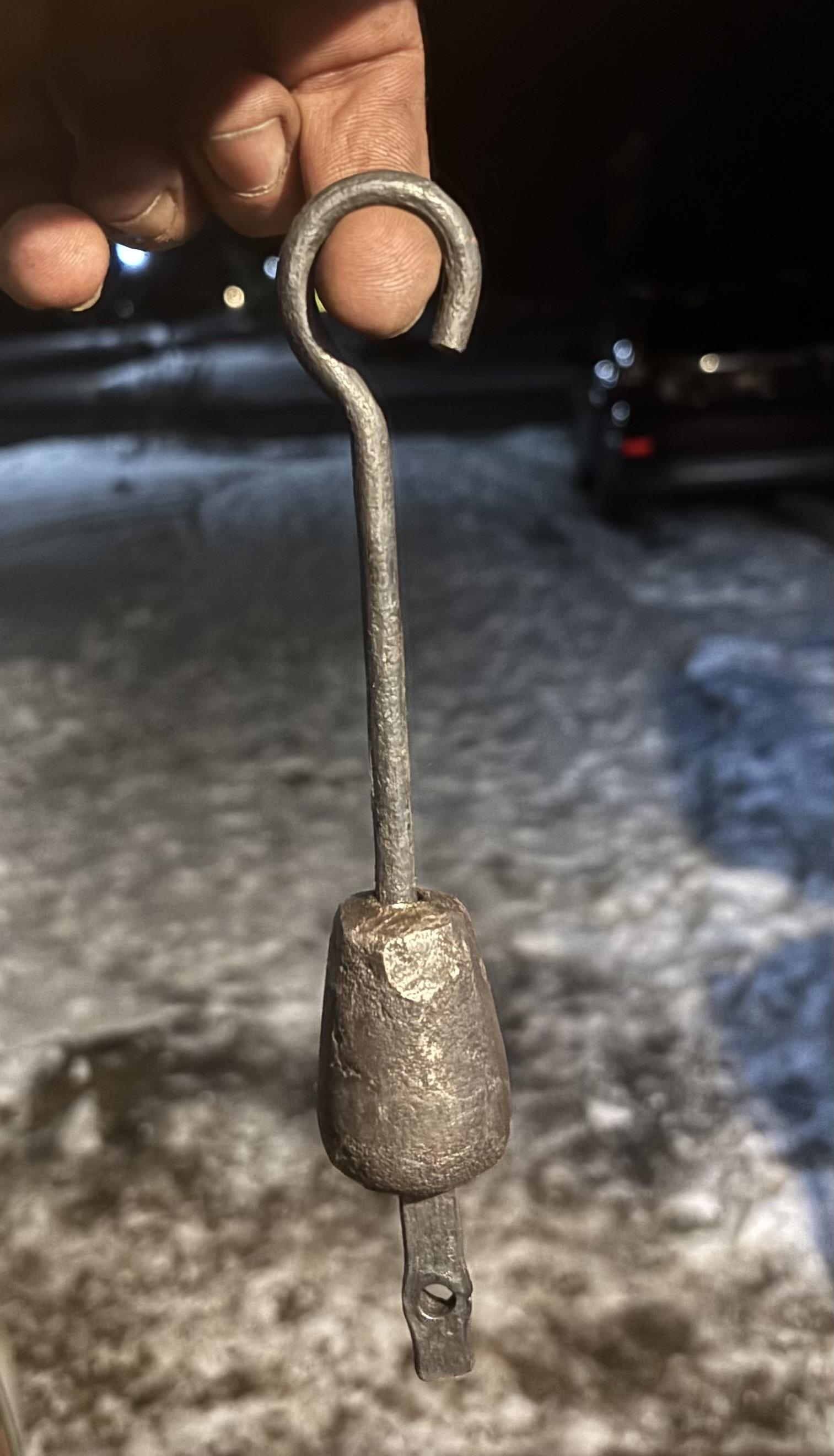

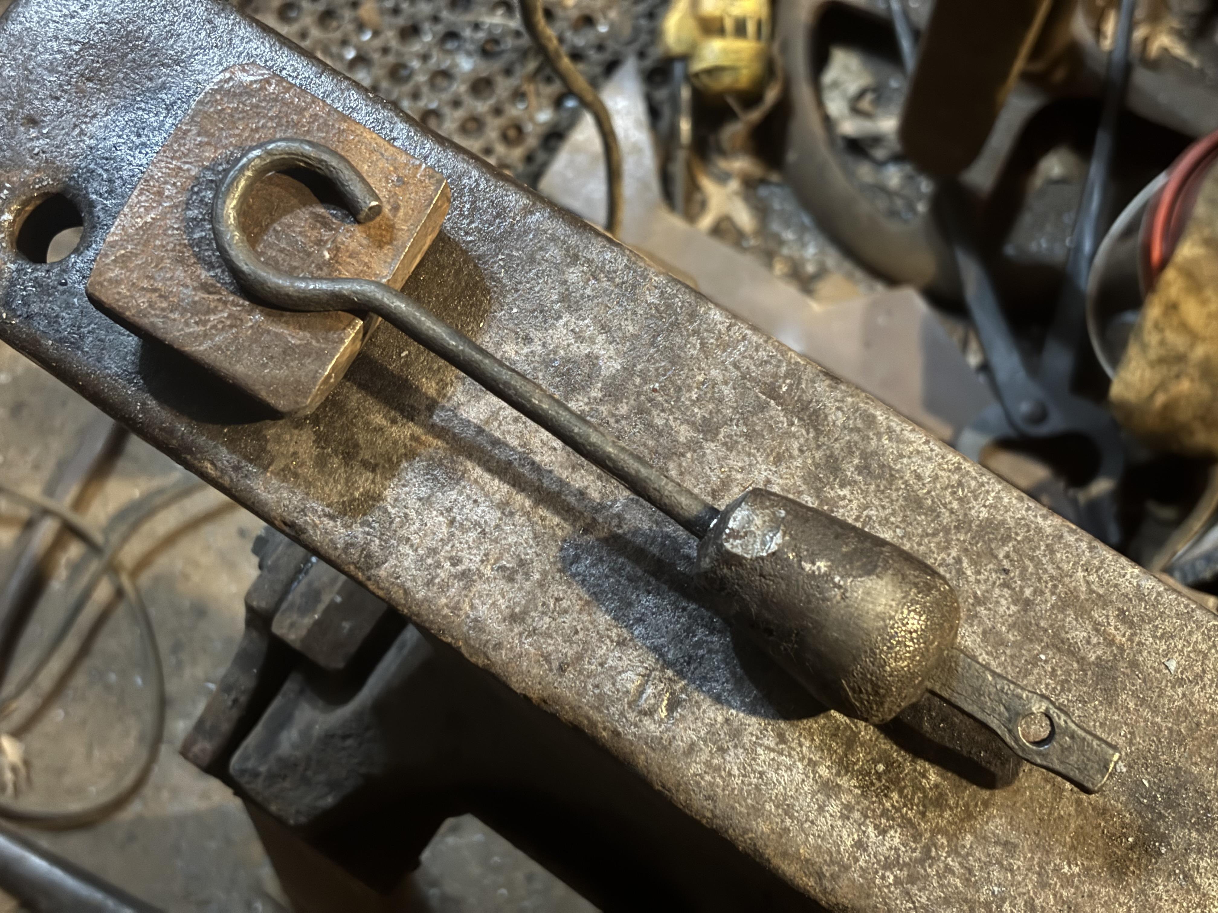

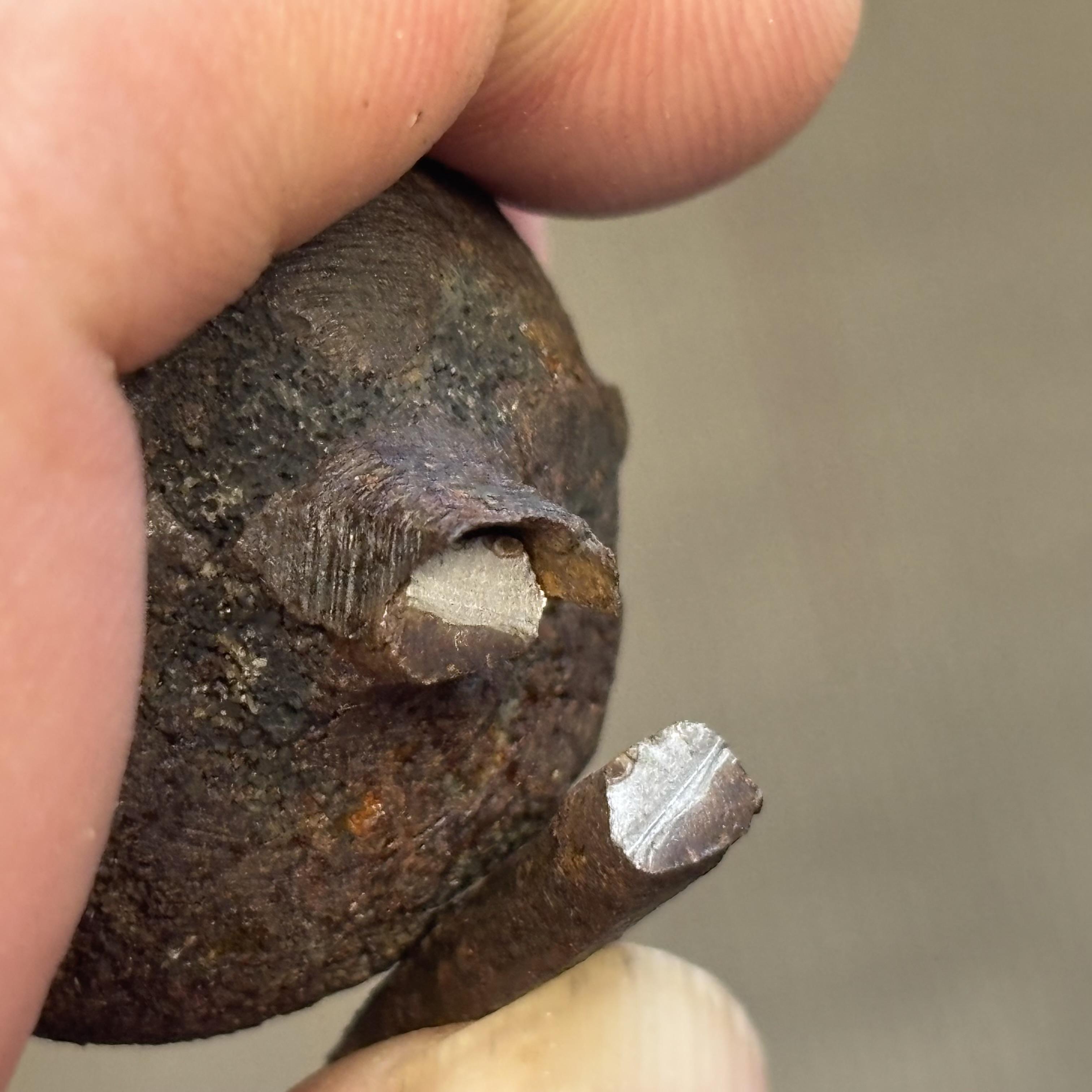

Also, an unusual job: replaced the shaft on the clapper of a small church bell. The original had the iron clapper ball cast in place around it, and had broken off just below the ball.
I had to cut it off, drill out the bit in the middle, and forge a new stem. This turned out to be a total bear, as the original shaft — which should have been made from wrought iron — was some kind of high carbon steel that wrecked a bunch of my drill bits before I finally got it out. Very happy with the result, though.
The new stem is a nice piece of fine-grained wrought iron forged down to 1/4” round except for the bottom tab, which is about 3/8” x 1/4”. I drilled a 1/4” hole through the ball with a 3/8” counterbore at the bottom; the ball was hammered down the shaft until the bottom tab wedged into the counterbore, so everything’s nice and solid.
(Fun fact: wrought iron is preferred to steel for the shafts of bell clappers, as it’s less likely to work-harden and snap, as happened here.)
