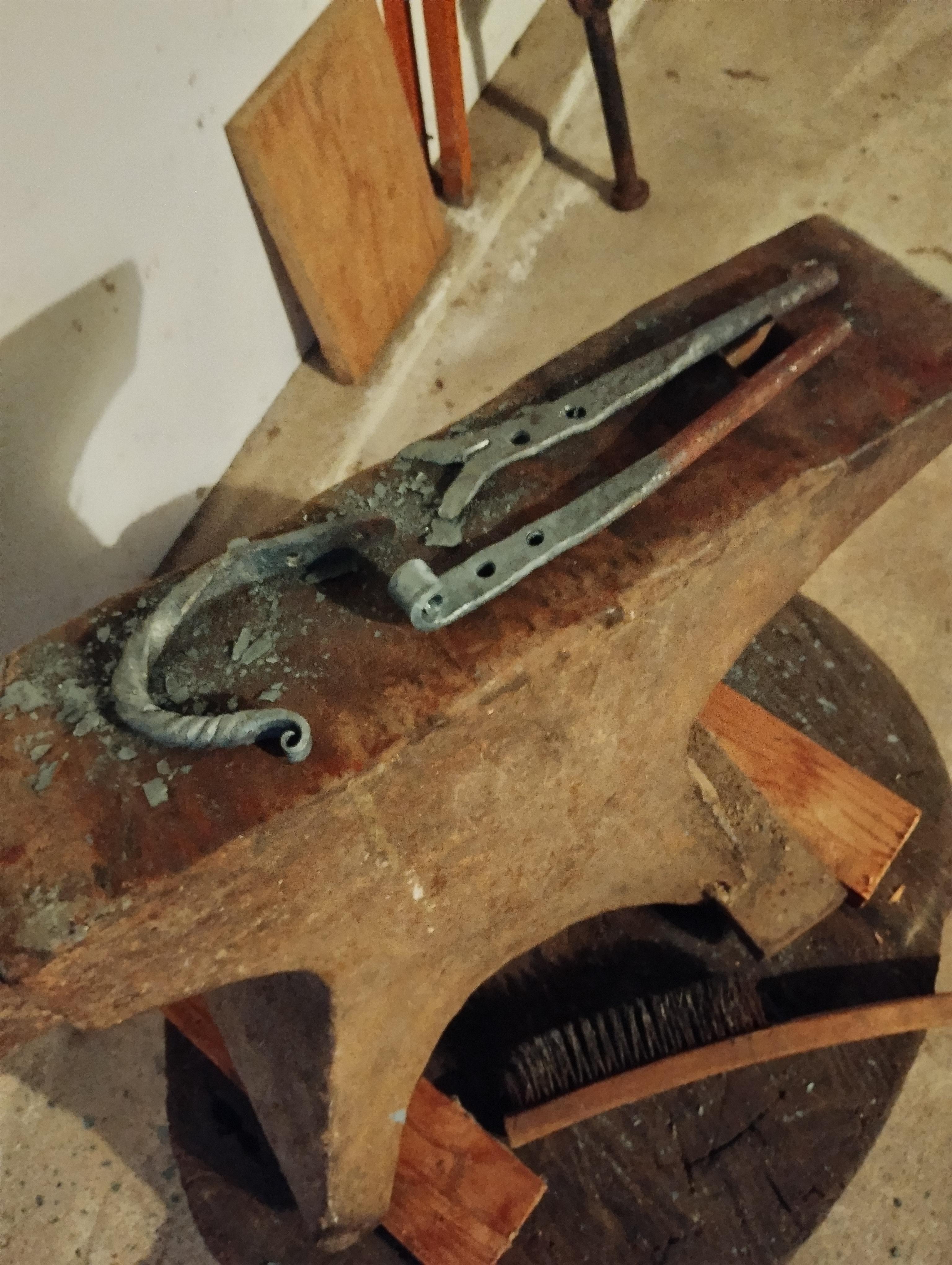

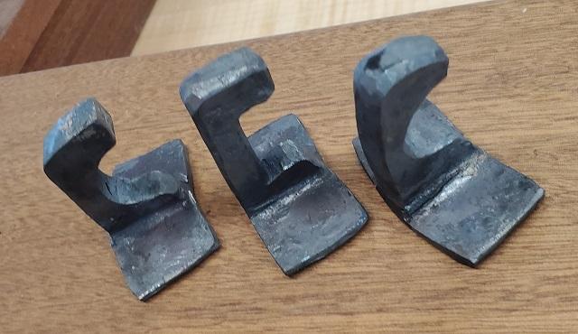

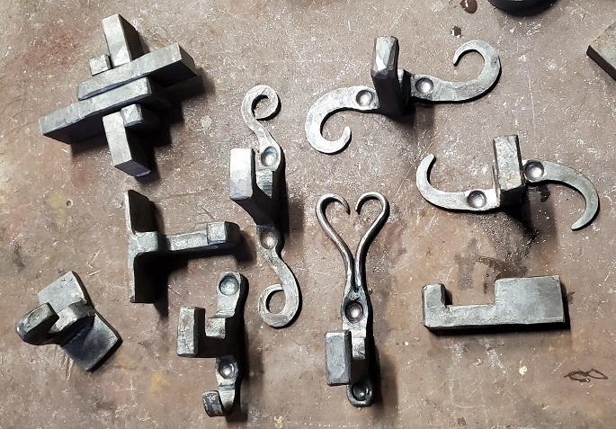

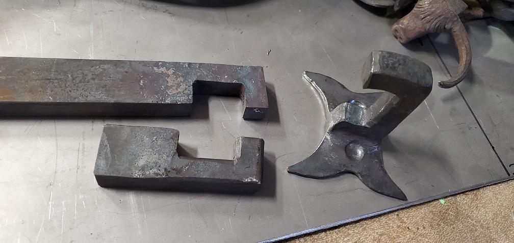

A friend of mine asked me to make her a dozen hooks a couple months ago.  I was finally inspired over the holiday week and came up with an idea using 1/2" x 1" (12x25mm) flat bar.  I forged out 3 quick variations
and wouldn't you know, she liked the one with the upset square corner the best.  So I forged out a dozen blanks with square corners:
And realized there was enough material in the 'wings' to play with and Phoebe encouraged this, not wanting 12 identical hooks,
and so far have finished half of them:
As an aside, as I was forging the corners, I had a realization that confirms a deep seeded belief I have in the laws of Karma and reincarnation:  Most of you would probably agree that forging upset corners is a PITA and try to avoid doing it as much as possible.  In my life, however, for some reason I have always enjoyed them, mainly for the challenge and the satisfaction I feel when I get one as perfect as I can.   1-1/2 years ago I purchased and induction forge and with the heat control this provides, this process has gone from challenging to very easy to do, which makes them even more fun.
So my flash was of me being a blacksmith in the past, having to do a bunch of these and as I was doing this, I was hoping/dreaming/praying for an easier way to do this.   This desire was so strong that my spirit waited until the 20th century to return to this plane of existence to fulfill that truly deep desire of my soul:  to have a tool that makes upset square corners easily.
The moral is:  be careful what you wish for, because you will get it.   Sometime.
Here's hoping 2025 turns out better than expected for everyone!

Billy those are some great hooks!  I love the playfulness of the designs.   I know I need to work on my upset corners more and my collars as well,  then there are the upset corners on the collars...  anyway those look great.

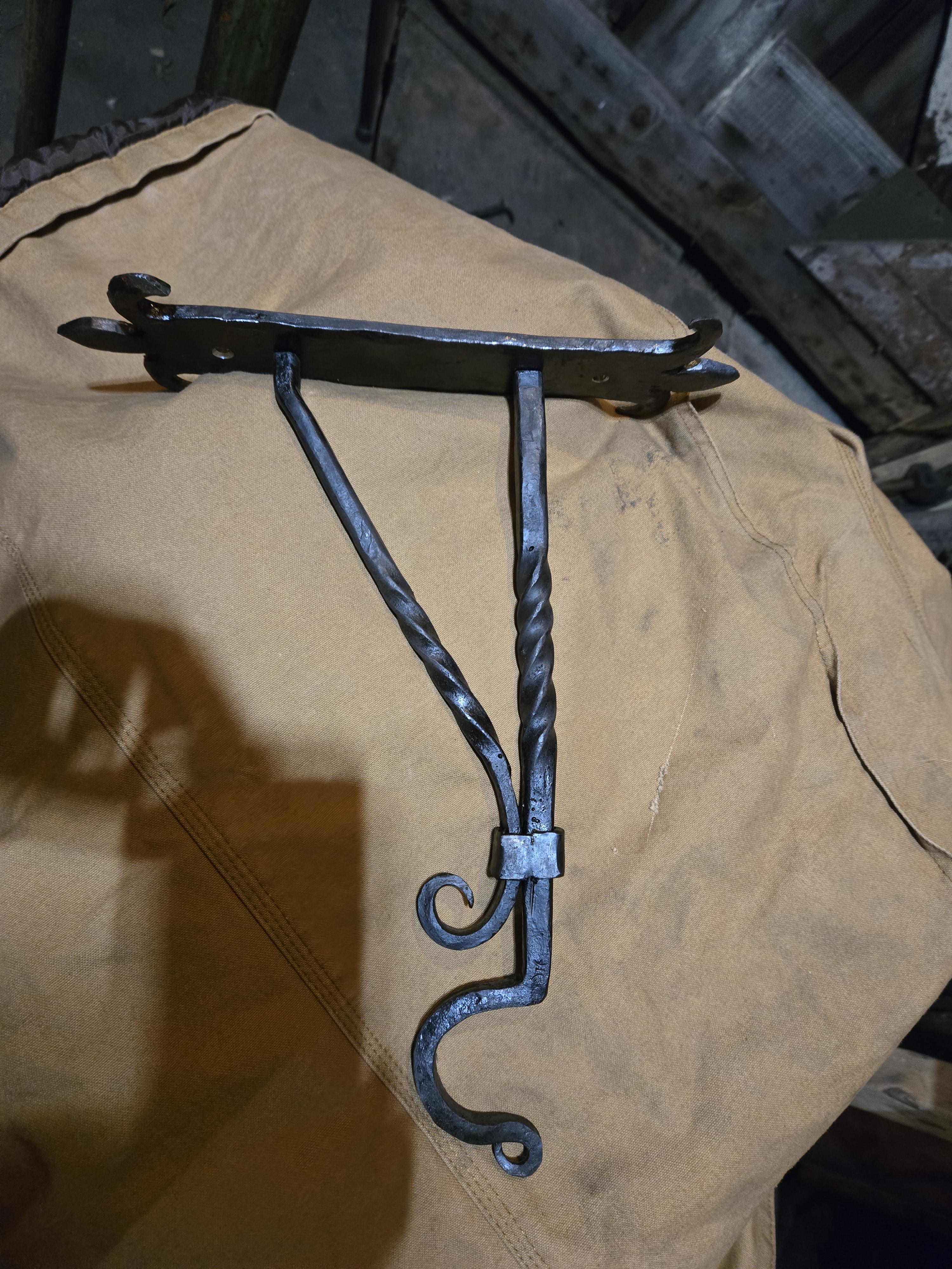

Here is my finished plant hanger.   Didn't make the tennons long enough so I riveted then hit it with the welder for insurance, made the collar too long so I made a couple cuts to shorten it and hit it with the welder for insurance...
Billy, i like those hooks, may steal the design :ph34r:. However, i think if i were doing a bunch of them i would have cut them out rather than forging.
When i do upset corners i use the vice to hold them with the corner sticking straight up. This makes it so you can upset both sides with out having to flip the work around.
Chad, Mark Asprey has a really good video on doing collars. Nothing wrong with using the welder, it was a blacksmiths creation after all.
Billyo, I like that hook style - very clean lines. You definitely have a knack for the upset corners.
Chad, I think that hanger turned out nice. I've had to do the same with tacking short tenons before. Another tip I frequently forget with tenons is to make the hole square so that the tenon upsets into a square hole and fastens more securely.

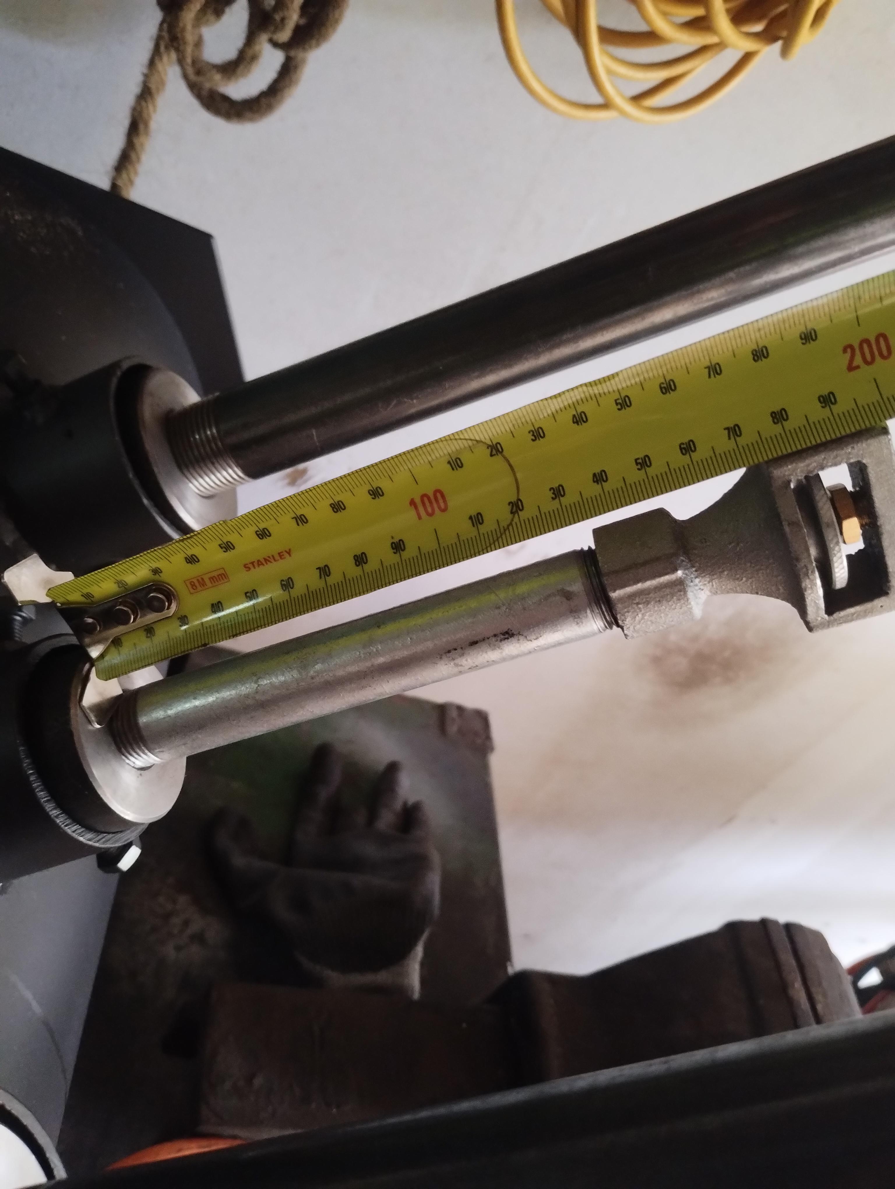

IMG_20250109_091318716.thumb.jpg.40dd91e12c916d9a70da0262f94bbf5c.jpgIMG_20250109_091309296.thumb.jpg.ff1101b6e1f36b33394ef595061b6002.jpgFrosty- the forge was plumbed by the manufacturer. If the mixing tubes are too long what effect does it have?

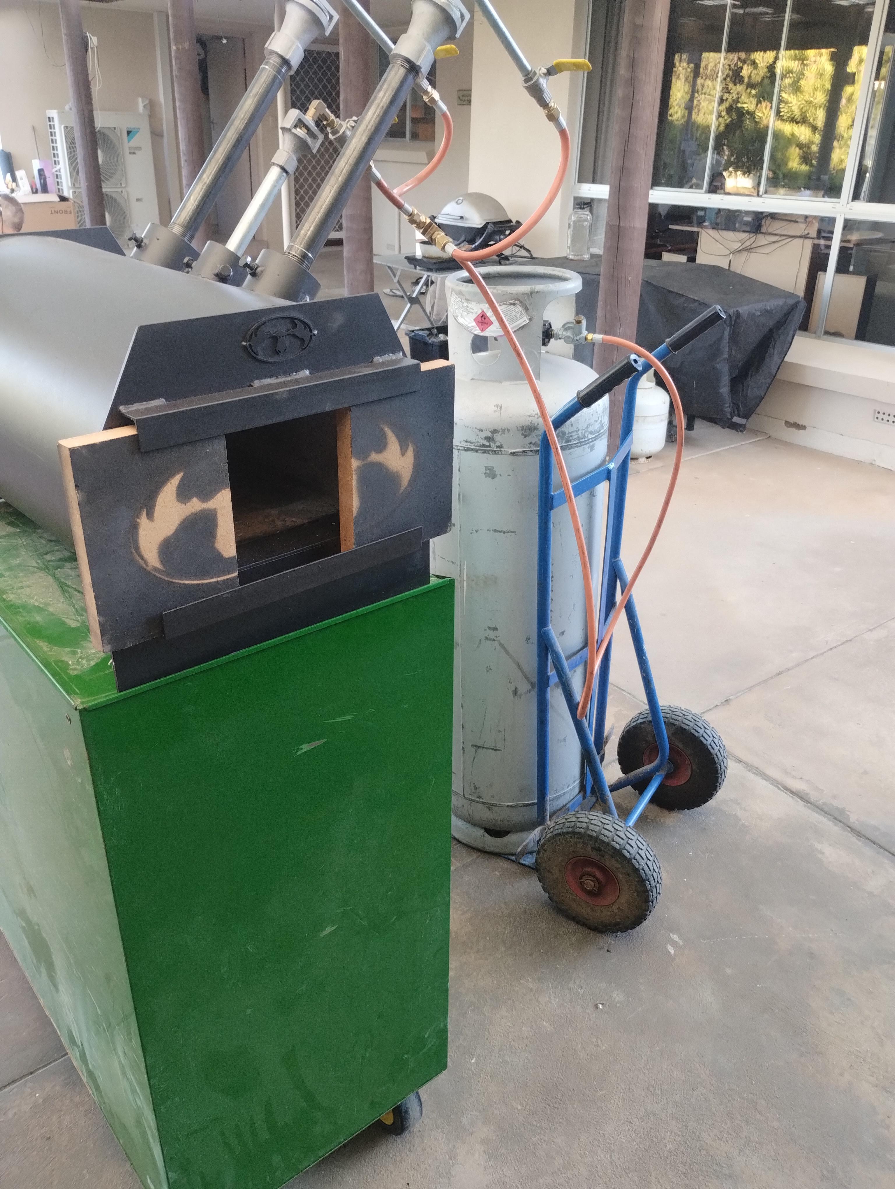

I have put the pics with measurements.

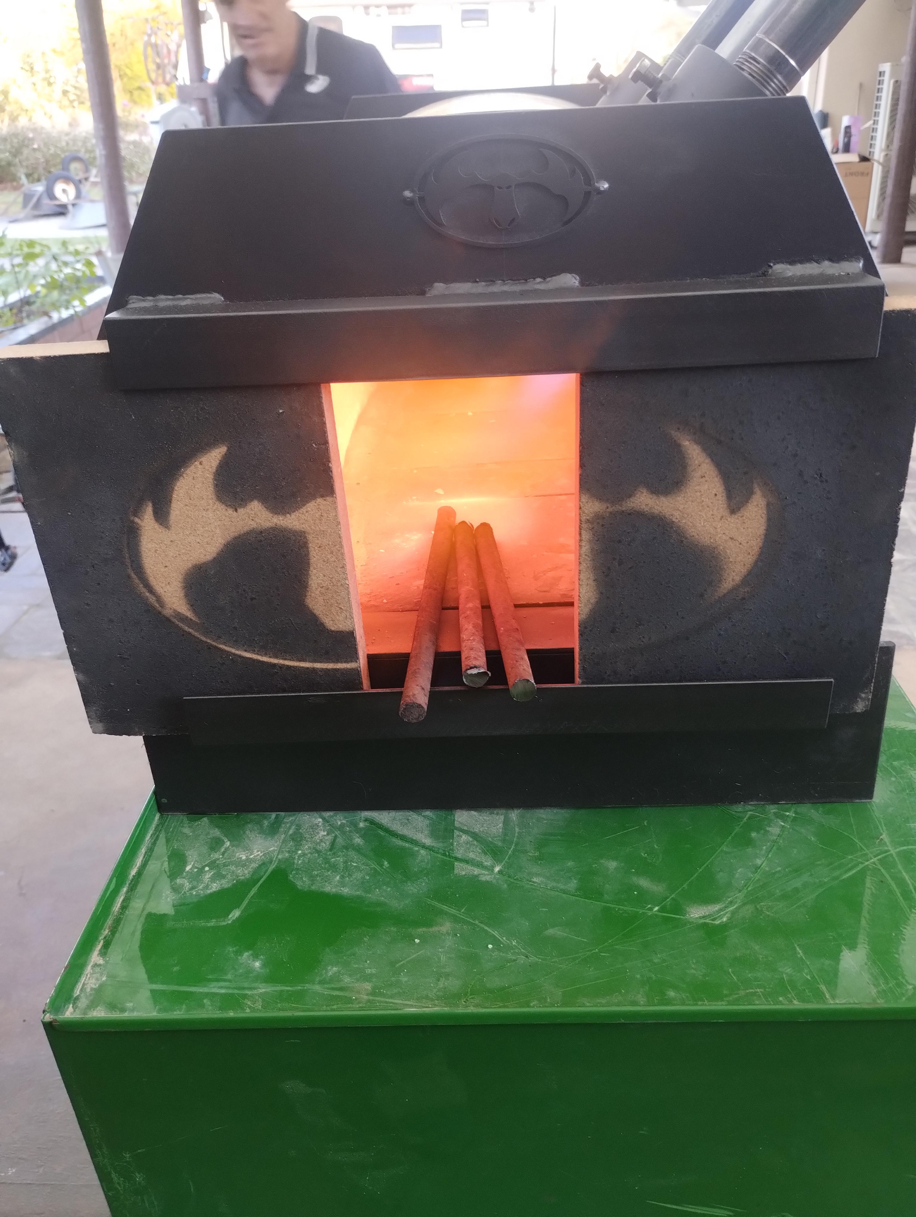

The only thing made by a legitimate burner manufacturer is the casting you connect the propane to. The mixing tube and whatever connects to the burner mount were screwed on by a 3rd. party vendor looking to make money from other peoples product.
The short burner tube should be 4" long and the long ones should be 6". Max.
Using too long a burner tube will reduce how much combustion air it can induce per unit of propane. This means the burner can put a lesser amount of the flammable mixture of fuel and air in your forge per second. Whatever unit of gross energy you prefer, say Joules, calories, etc. is irrelevant what is relevant is it will produce less heat. Not lower temperature, just less of it.
Thanks for that info Frosty.
I will ask the guy that built them to see what his reason for the longer pipes is.
The bloke that makes them comes highly recommended even from some professional blacksmiths that had used his forges.
You could just buy a couple 6" nipples and check out the effect. The guy who makes them will say it's the best length and if end users have never used different. . .

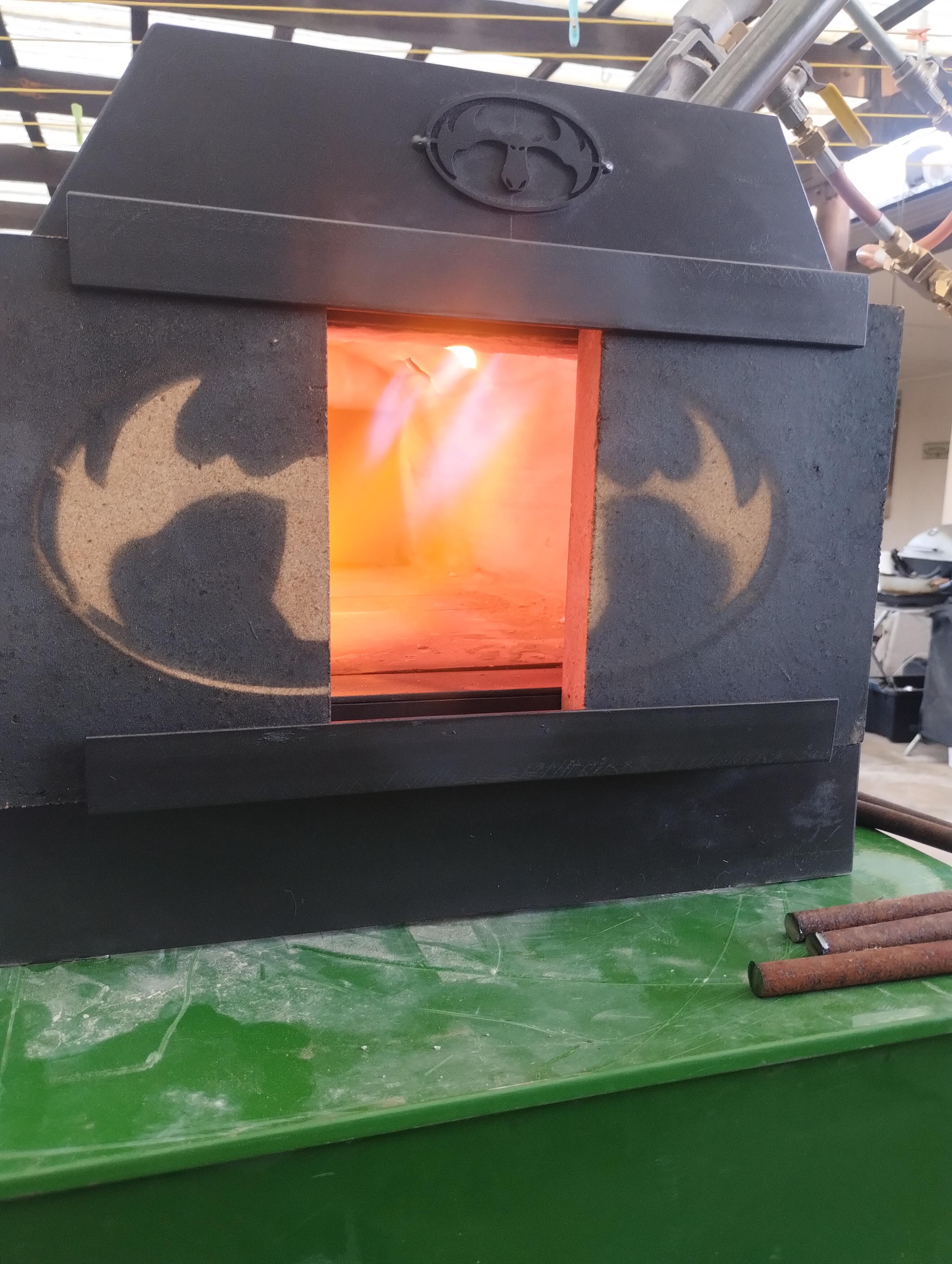

The forge has a brick base and I plan on avoiding borax if I can. Someone suggested soaking the metal in kero before forge welding and when it burns off it carbons up the surface which gives a clean weld. I will be trying everything until I work out what works. I hope to find some local smiths that I can learn off but in the mean time it will be trial and error + YouTube vids + reading forums and trying to find some good blacksmith books.
I plan on getting a thermocouple and a pressure gauge as I am a sucker for being able to see the numbers as then it's easier to record the settings as 12psi than 3/4 of a turn.
I am waiting for the gas bottle to be delivered. It's like waiting for Christmas. Any minute now it should arrive and I can fire the forge up.
I gave the forge a run and heated up some metal and started to make some hooks. It was a lot of fun.
There is a lot to learn on how to tune the burners so I will be researching that as I'm not sure what the ideal flame looks like and need to work out what to change to get it right.

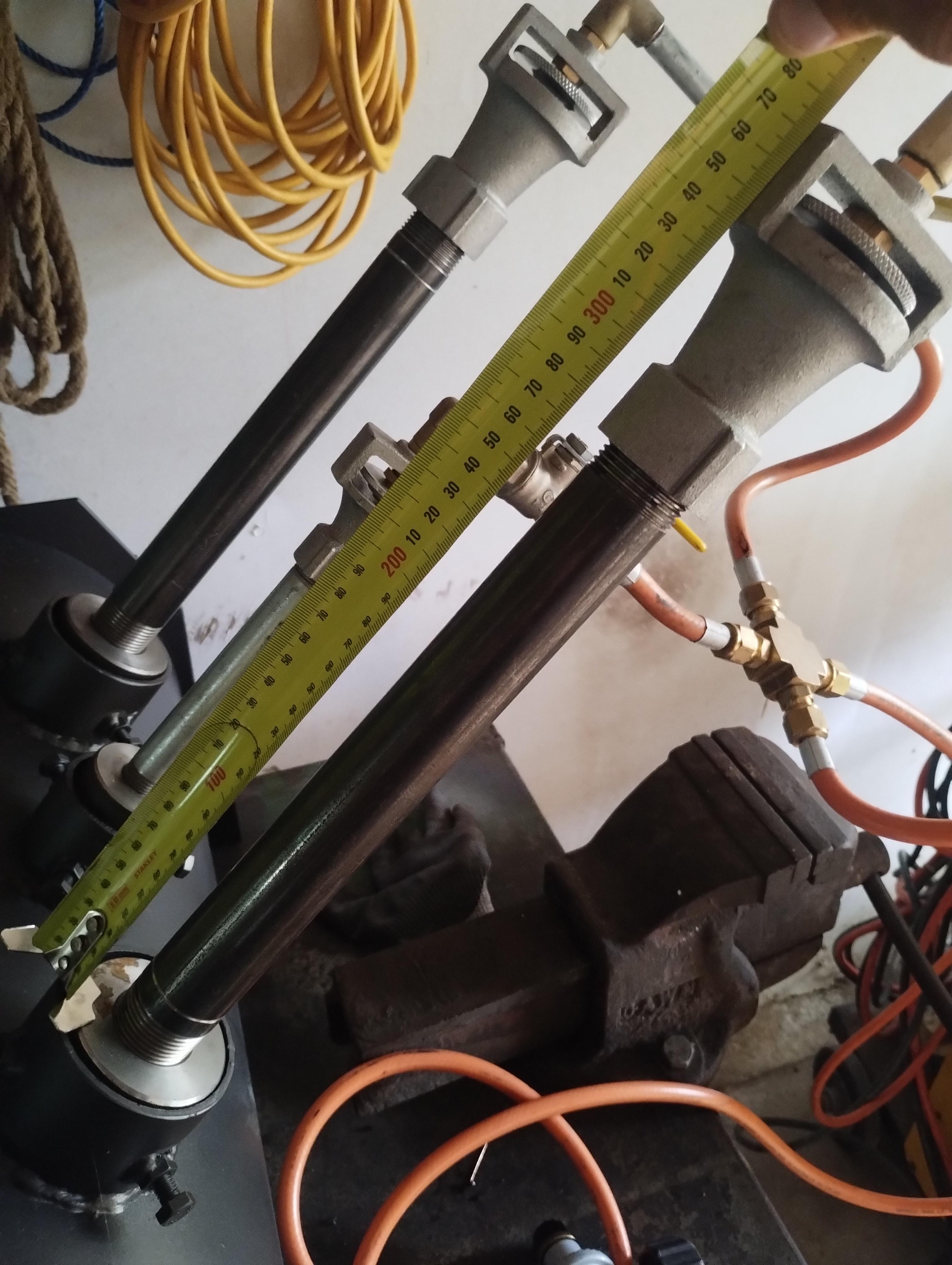

Two tips for tuning burners. First, is that all the hotter the forge got? Secondly the flames look to be on the rich side to me.
Unless you took the pic less than 10 minutes after lighting the forge it's not developing the kind of heat that combination of burners should.
Take a look at the flames in the last pic. The close burner has a long flame with a long nearly transparent dark blue center and a proportionally long pale blue almost opaque outer flame that has a thin tail. It screams "TOO RICH" to me, meaning too much fuel for the quantity of air it's inducing.
Open the choke plates a LITTLE at a time until two things occur. The flame shortens, the opaque light blue takes a larger proportion of the total flame and loses it's tail. The more transparent core becomes much shorter. The other thing you WANT to hear is the burner roar and loudly if it begins to shriek it's becoming too lean.
A sure sign the flame is burning lean is scale forming in the forge, if that happens close the choke plates a LITTLE until it stops scaling your work. Be aware your work WILL begin to form SCALE immediately when you remove it from the forge exposing it to atmospheric oxygen. Well tuned burners consume all the oxygen induced through the burner making the interior completely anoxic. Scale can not form without free oxygen. Make sense?
A serious word of warning here. A propane burner WILL produce carbon monoxide This is a B A D thing so you must have good ventilation and preferably not operate one in an attached garage even with the vehicle door open it can infiltrate the house. Running a burner rich turns one into a major CO machine.
Okay, I'm starting to ramble excessively I'll let you think about what I said, play with your burners and forge and be ready to answer any questions you have. You'll REALLY like it when the interior is running at high yellow temps rather than mid orange. Honestly you will.;)
Thanks for that info Frosty it will be very helpful. The pic was as it was heating up and I was playing with the pressure and air but with what you have said I know what to look for now.
The anvil is about 3 steps from the forge. I have the anvil in the shed and the forge just outside. It's all a temp set up until I work out where I want everything.

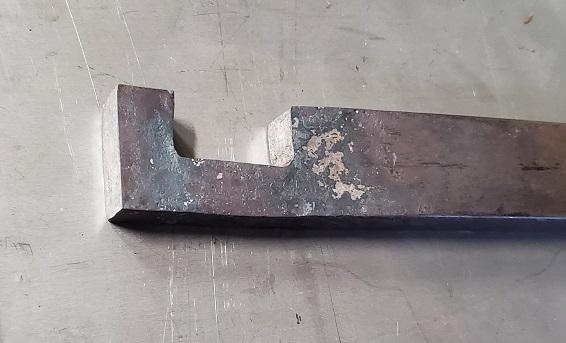

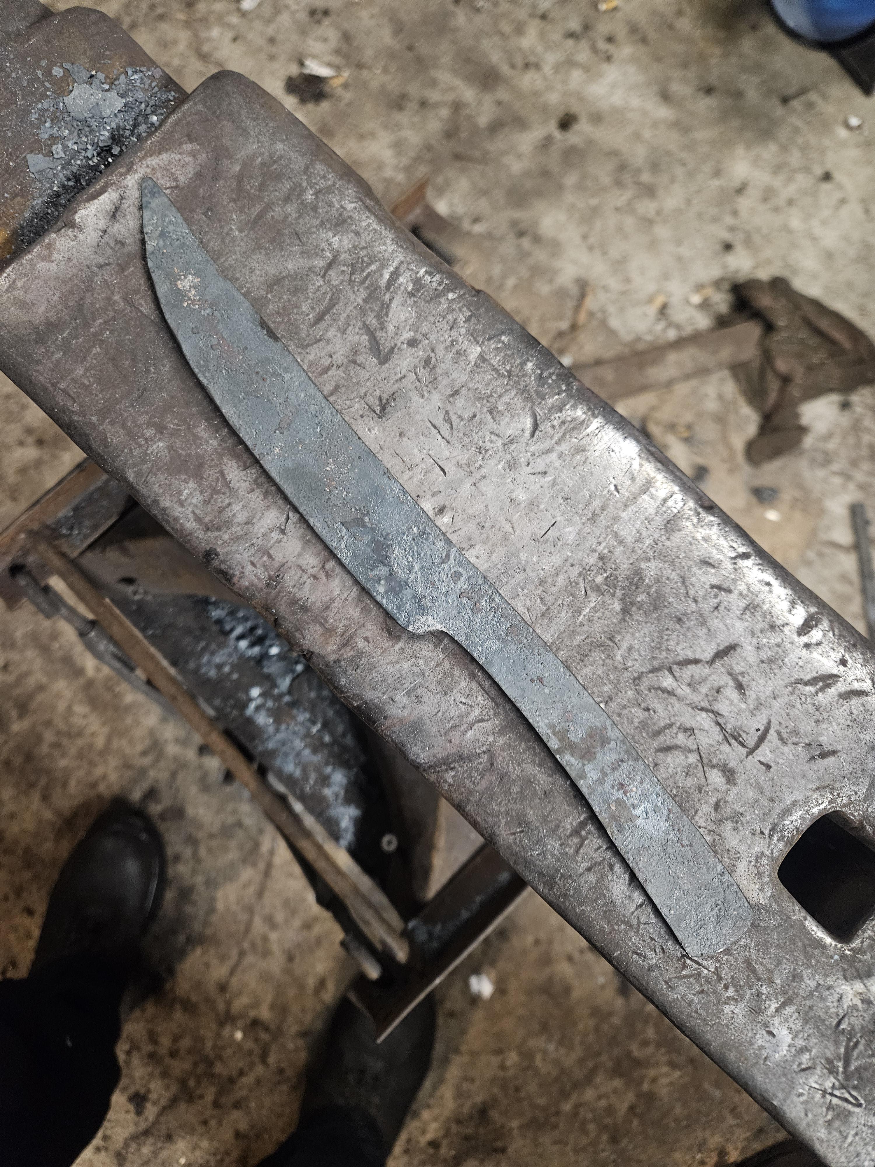

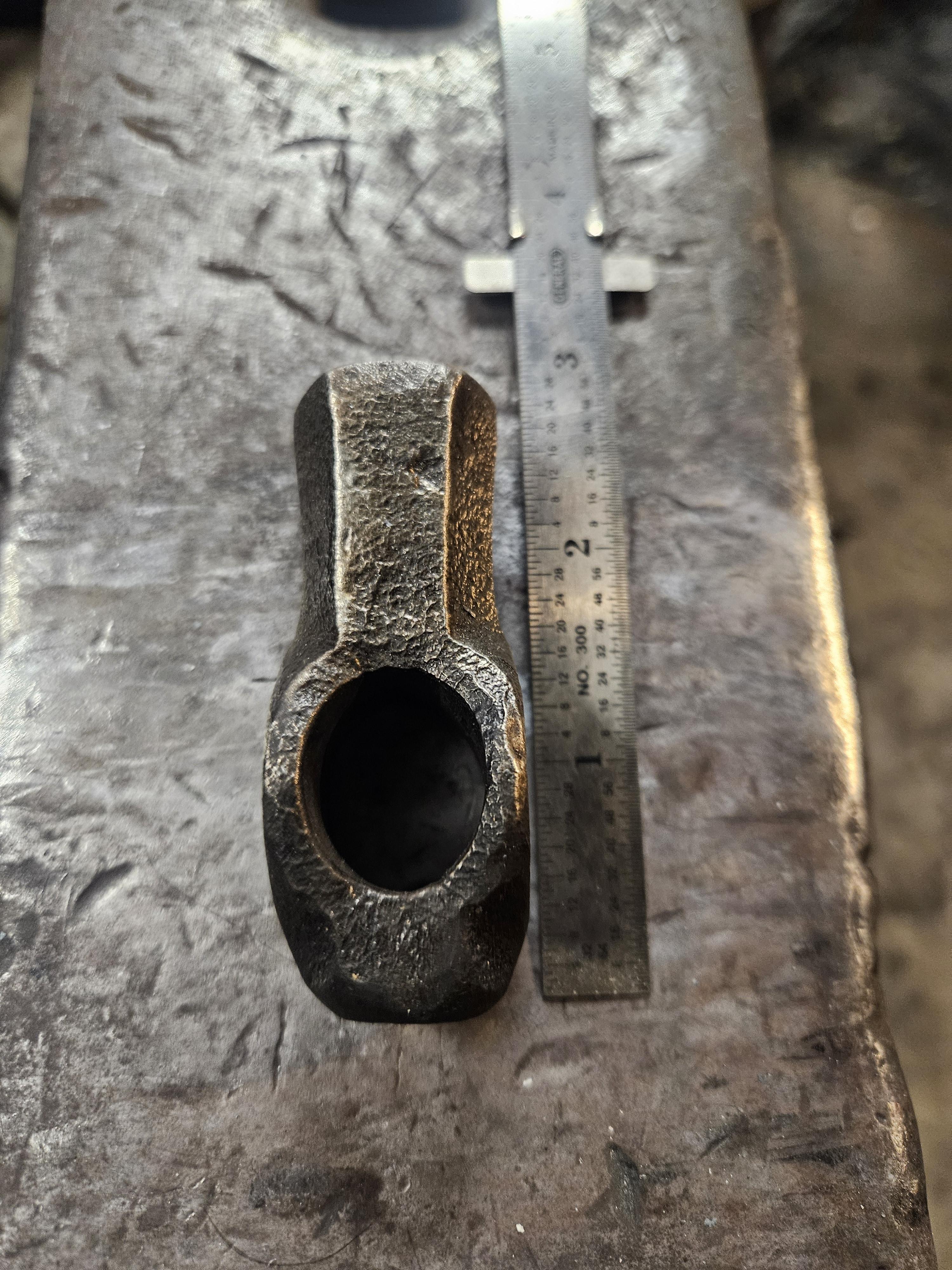

Got some work done. A coworker wants to make a knife, basically finish and handle, and asked if i could give him a blank. So i hammered this out of a piece of coil spring.

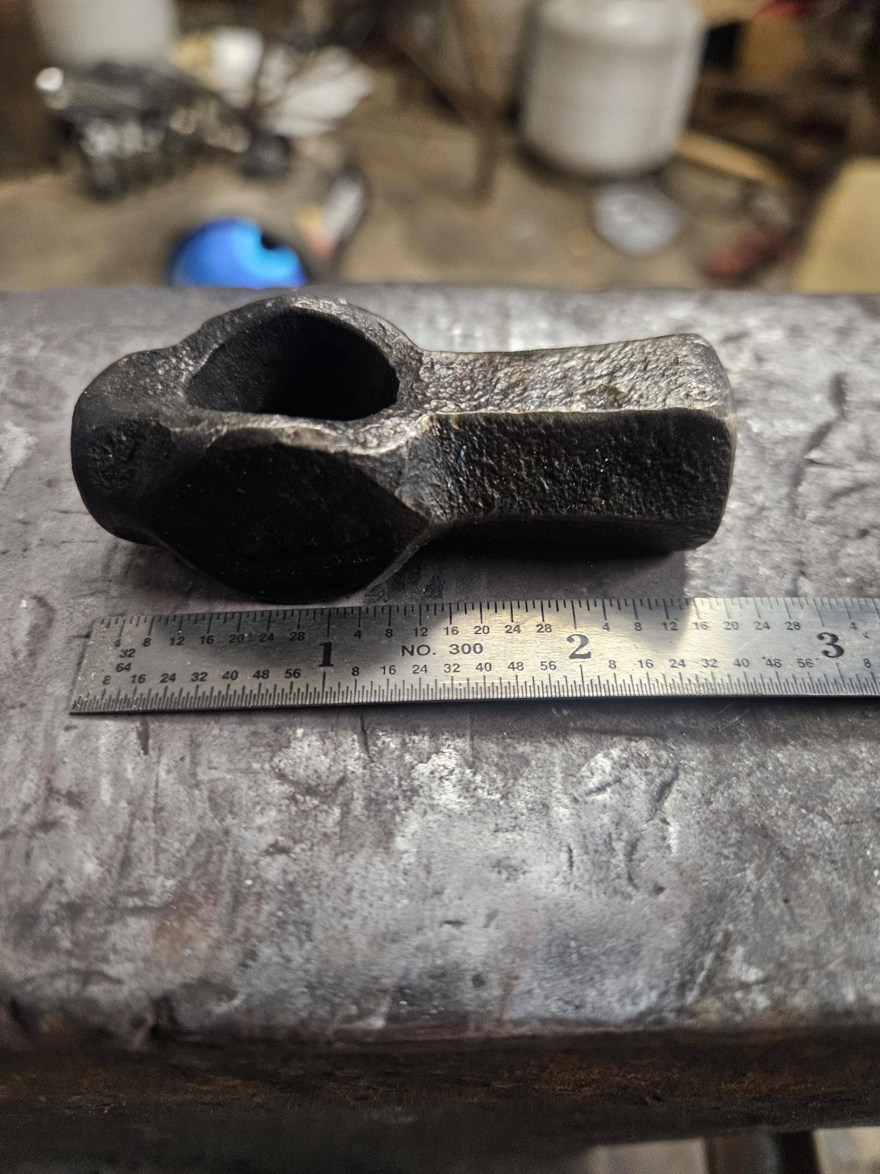

Then i made this little guy, 5.3 oz, was supposed to be a ball pien but i messed up the ball so it is a chihuahua faced hammer now. It is either 12L14 or 1018 steel, can not remember which, i quench in water just to give it a bit more and it skates a file, was not expecting that. I was looking for a small light hammer to tap something at work and could not find one so i made this one. I really like it i think it looks like it is 100 years old.
Did you draw a temper on it? An "as quenched" hammer head is a potentially dangerous thing. The face and edges will work harden further and become embrittled. The snap you hear when hardened steel chips is the sound of the chip breaking the sound barrier.
Don't take unnecessary chances with your eyes and especially not with someone else's!
I like the chihuahua face hammer, I have lots of light hammers and uses for them.
Yep, i only quenched about the fist 3/4" and let the color run. Then i heated again for linseed oil. I was just surprised being that low carbon it got as hard as it did.
Before I address hardening steels, alloys, etc. I have to say this and it goes to everybody reading this. If you know someone who isn't reading the forum have them read this, print it out, and pass it around.
NEVER NEVER NEVER put ANY steel with an in it's designation in a forge or weld it. The L stands for LEAD. Lead is added to the alloy to make what I grew up calling a "free machining alloy," it's included as a lubricant to make it easier to machine, reduce tool wear, etc. Forging welding or otherwise working it hot means YOU and those in your shop get to breath lead vapor. You might want to read what breathing or otherwise ingesting lead does for your brains/nerves/etc.
Being as where you work and that you made a hammer I expect it's your L grade steel, Do NOT do THAT AGAIN!
I know it's "traditional":rolleyes: for a blacksmith to be able to make things from found or salvaged steel but that just is NOT SAFE to do anymore. Too much steel is imported from countries that have zero concern for safety and happily dump literally ANYTHING metal in their steel production stream. Remember a couple years ago when it was discovered the shiny gold colored children's toys were gold colored because they were coated / plated with pure Cadmium? A true carcinogen prolonged exposure will cause cancer.
You said it skated a file. That is NOT low carbon steel. :rolleyes: Quenching 40 pt steel from high critical in cold water MIGHT skate a file. Unless you used an old dull file that is.
You can never assume you know what salvaged or drop steel is, that's why we do test coupons. Even new steel can be pretty inconsistent if used for something it wasn't speced for, say a knife, chisel, prybar, etc.
Modern steels aren't analysis speced, that's why "real" x1018 is an expensive custom order steel, there's no telling what "mild" steel is other than it has a tensile strength under IIRC 40,000lbs/sq in. I know I don't remember the modulus of deformation but it's not high. It gets bridge strength primarily from it's shape, angle iron and other shapes are tremendously strong IF used properly.
Anyway, mild steel is NOT 1018 and hasn't been for a few decades and there is no telling what is in it anymore. There are custom makers who sell specific analysis steels and irons. I don't know the company names other than Pure Iron and don't know if that one is still in business.

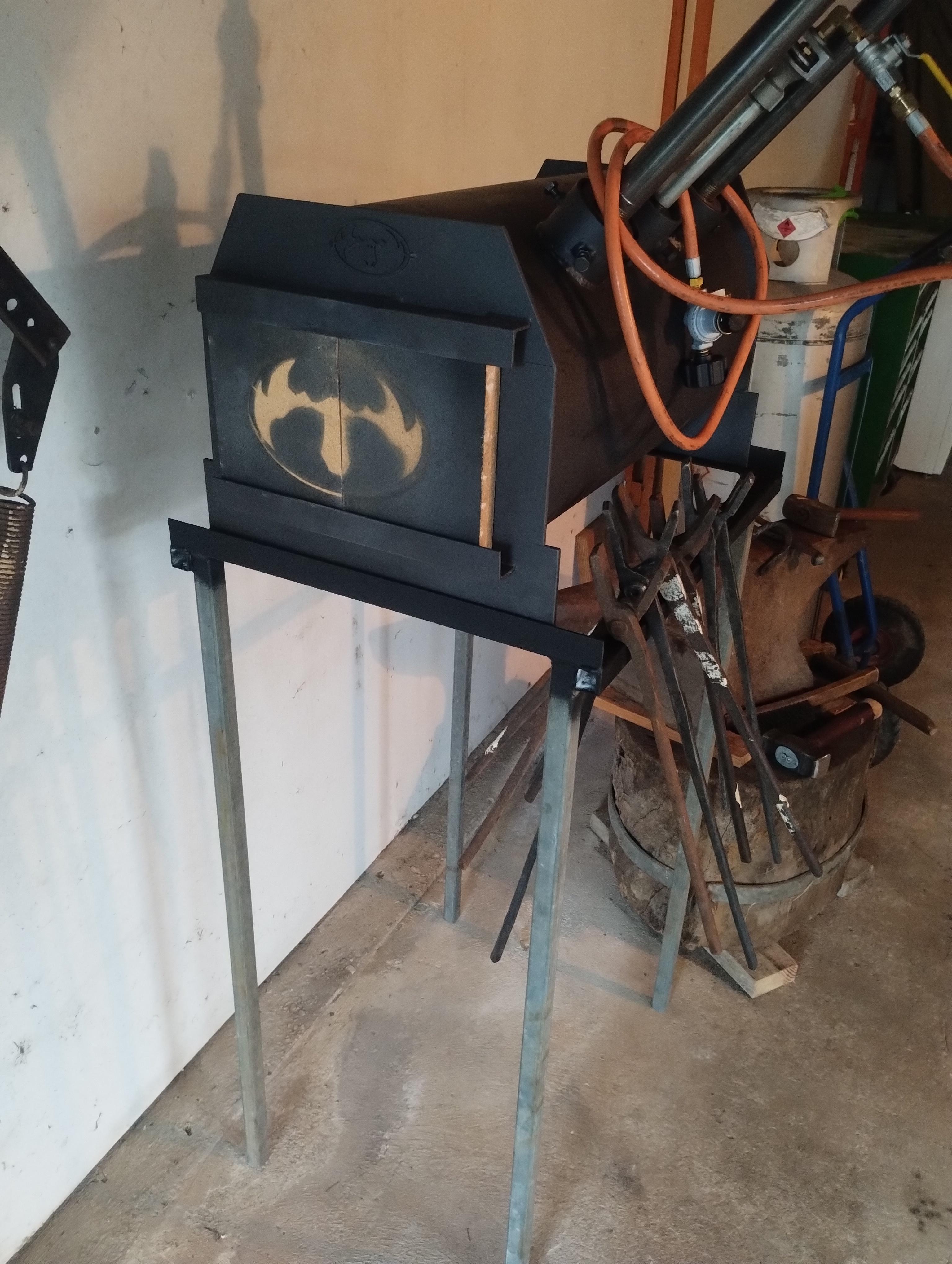

Today I made a stand for my gas forge.
I will add some lower bracing when I work out what wheels I am going to put on and also a tray at the front with an adjustable rest.
It's good to have somewhere to put the tongs.

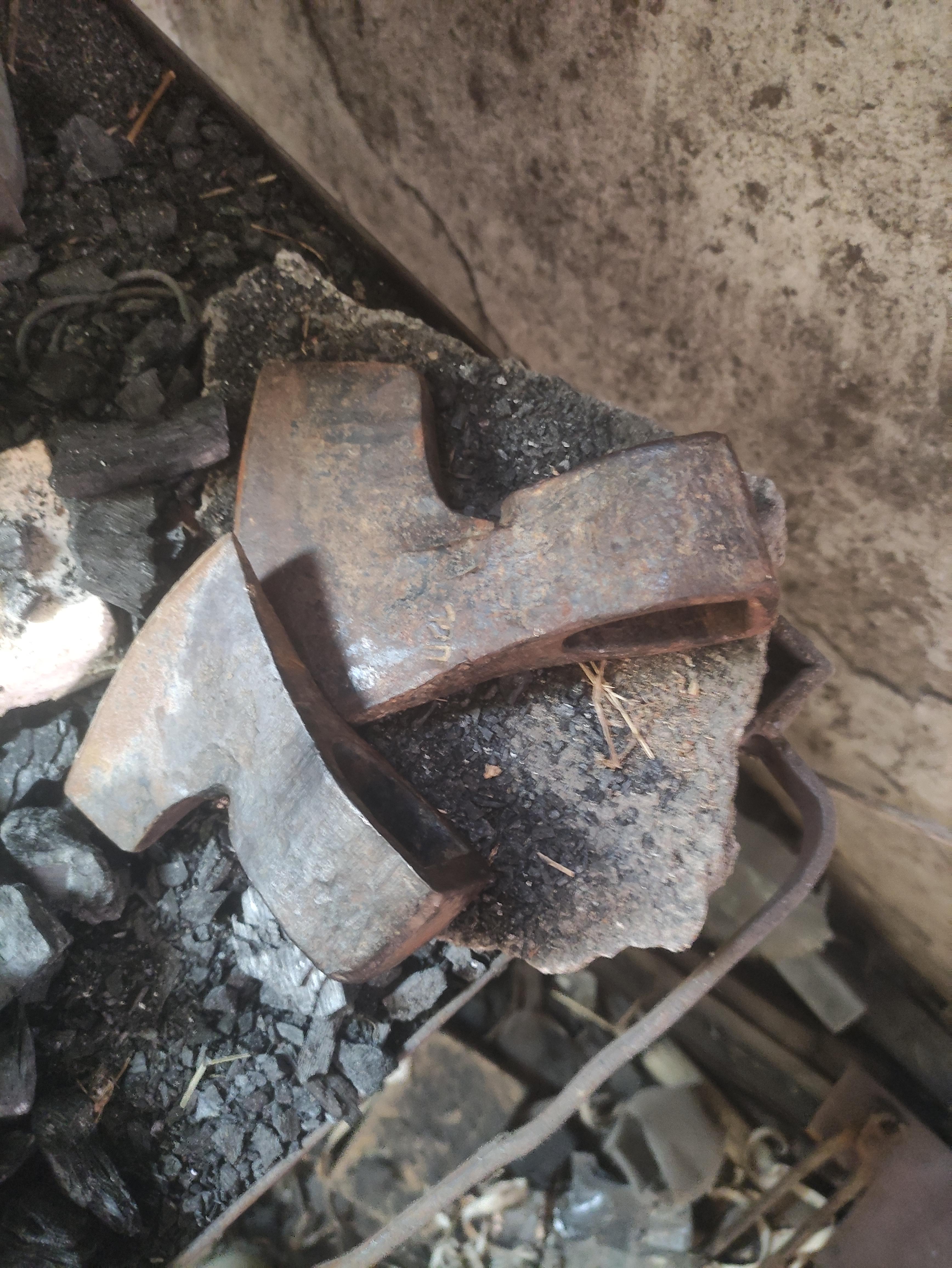

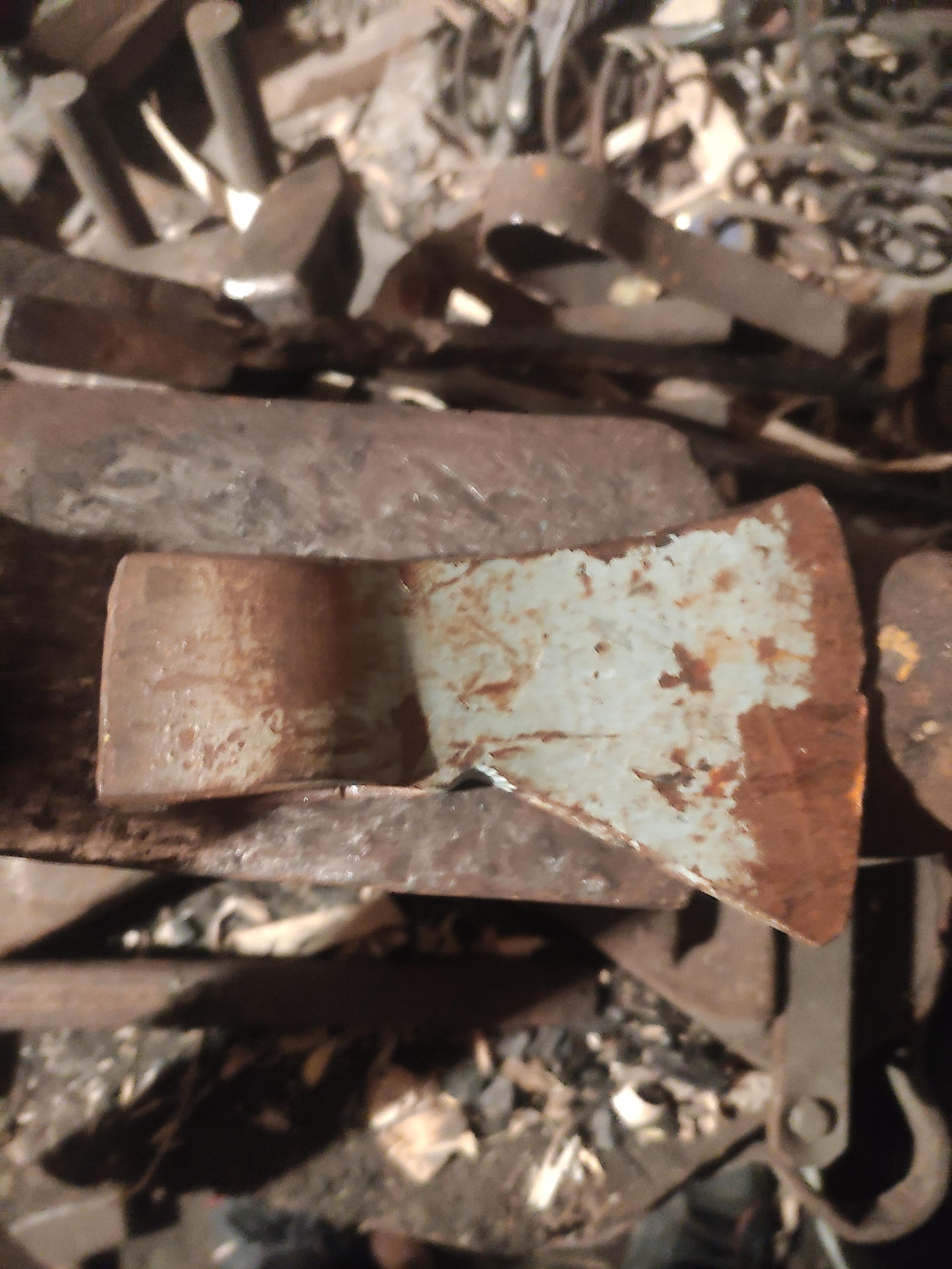

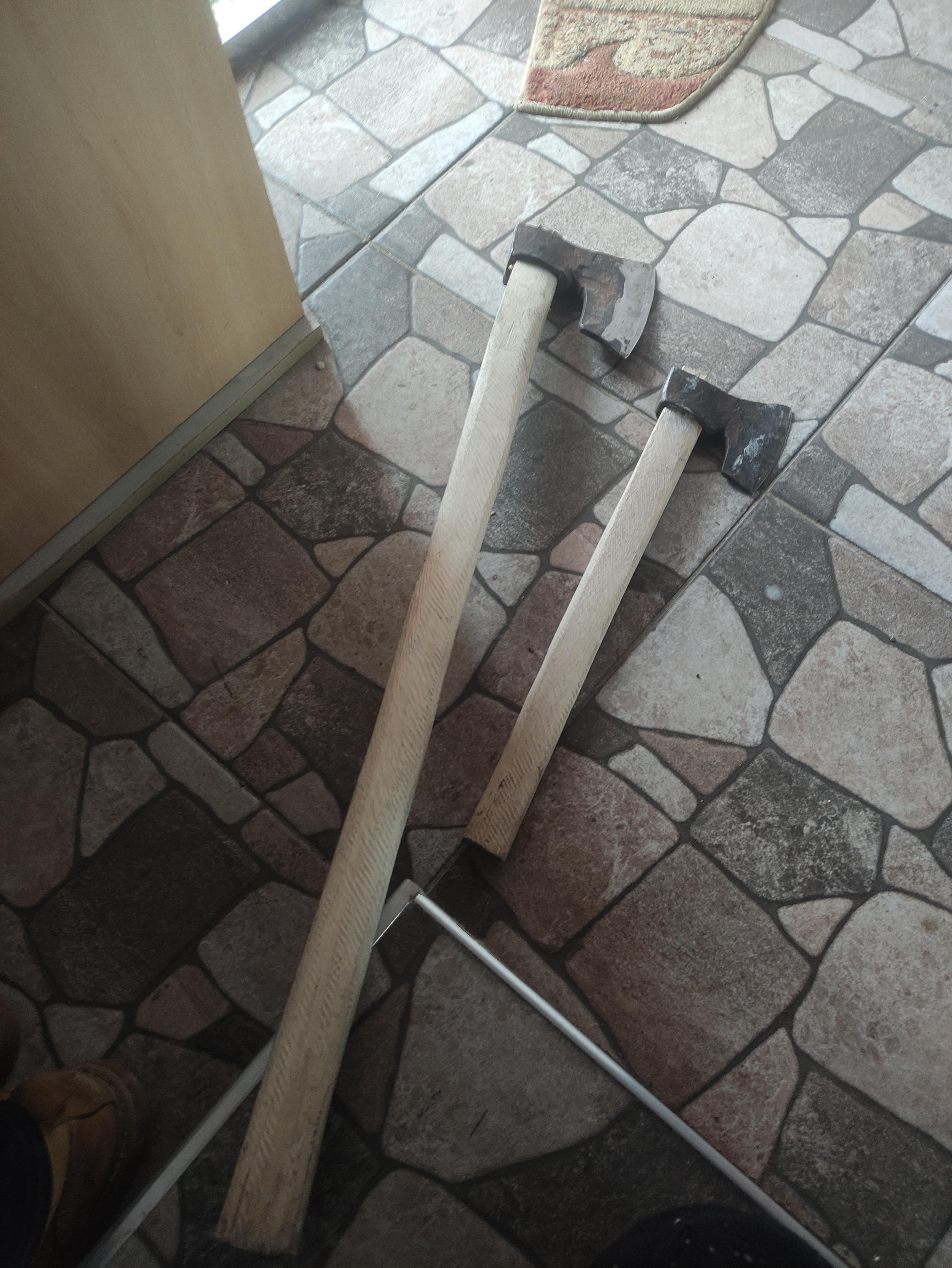

Made two axe handles , drawn out three axes and sharpened them.
This is before and after
