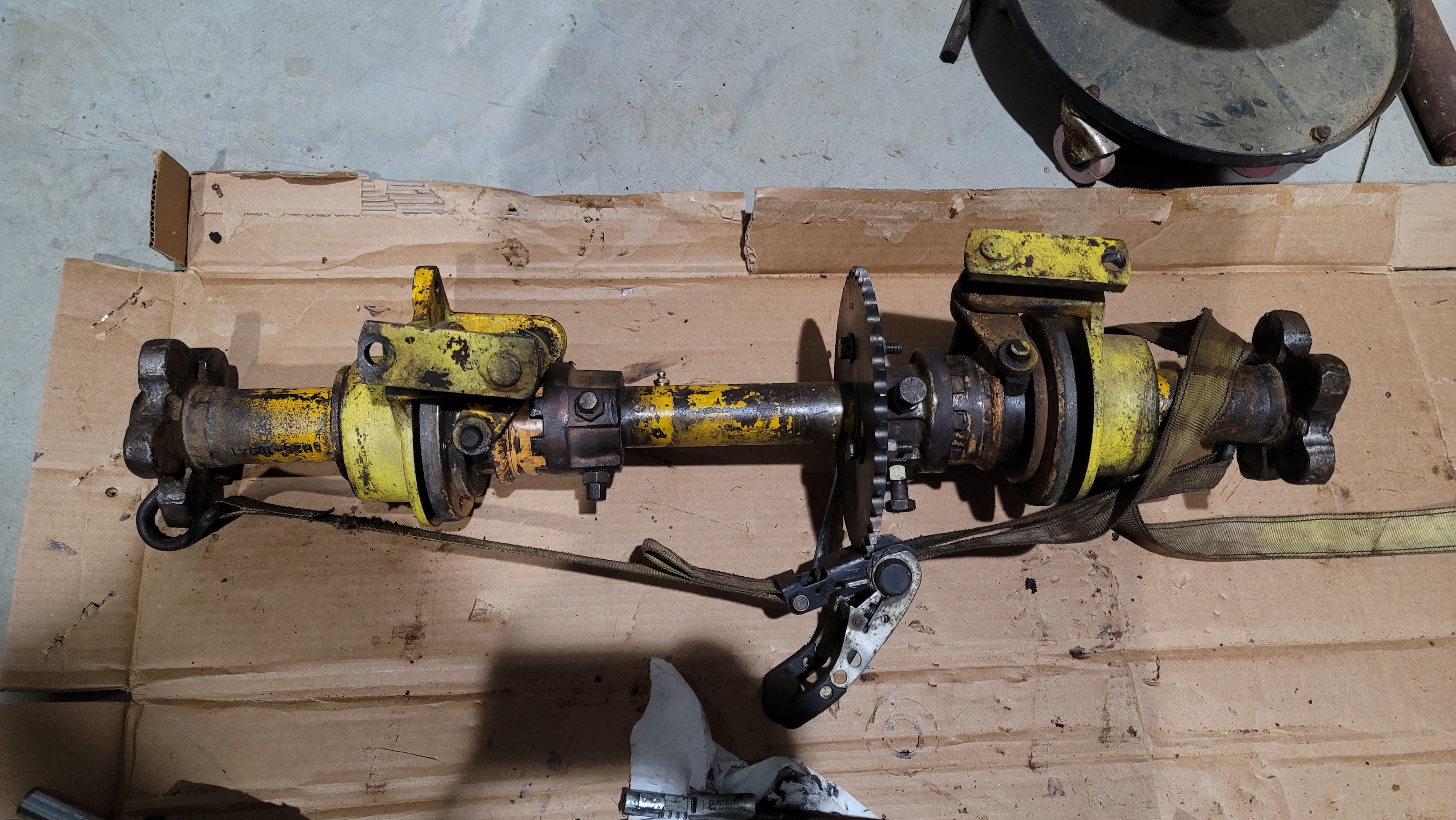

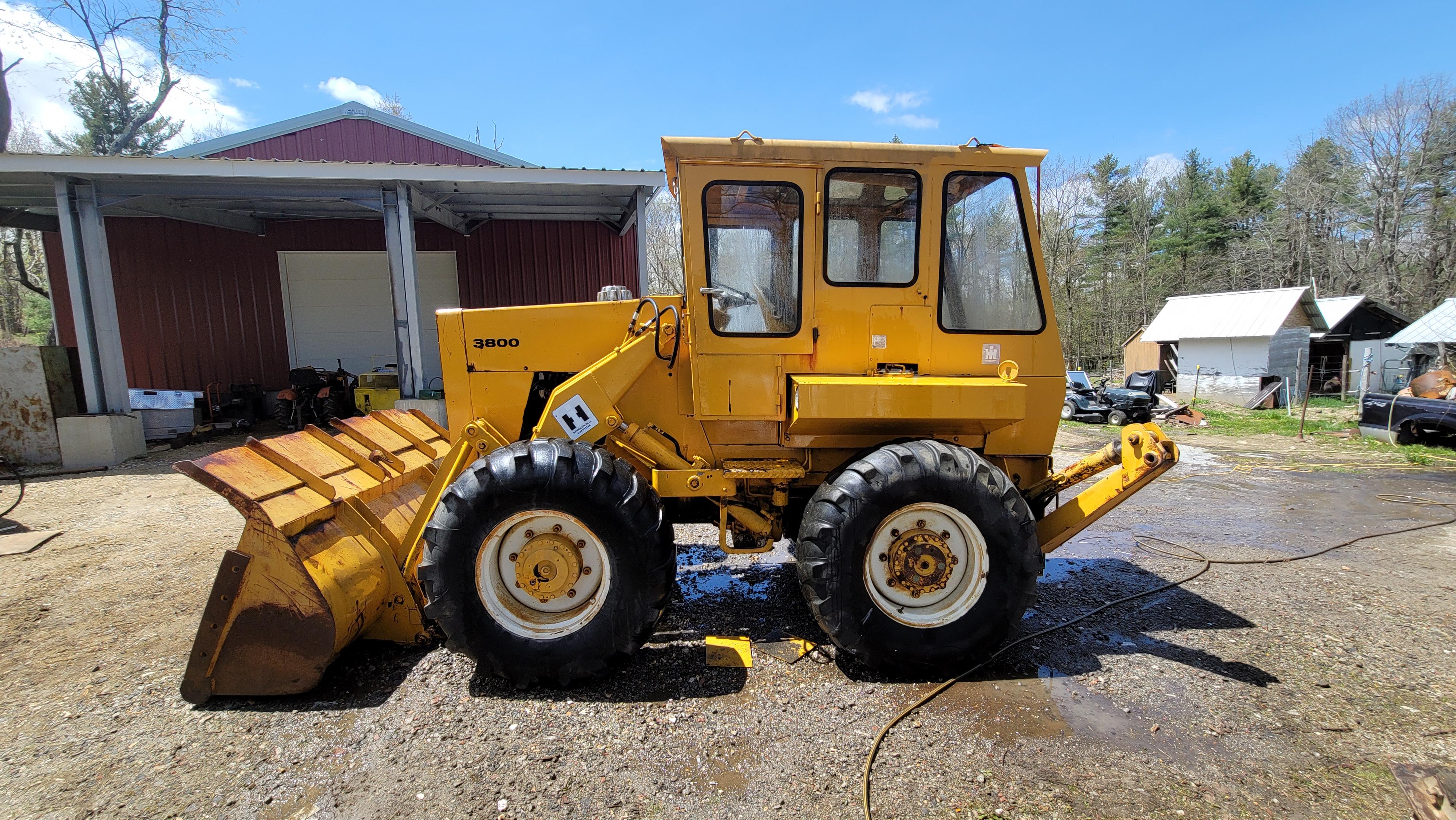

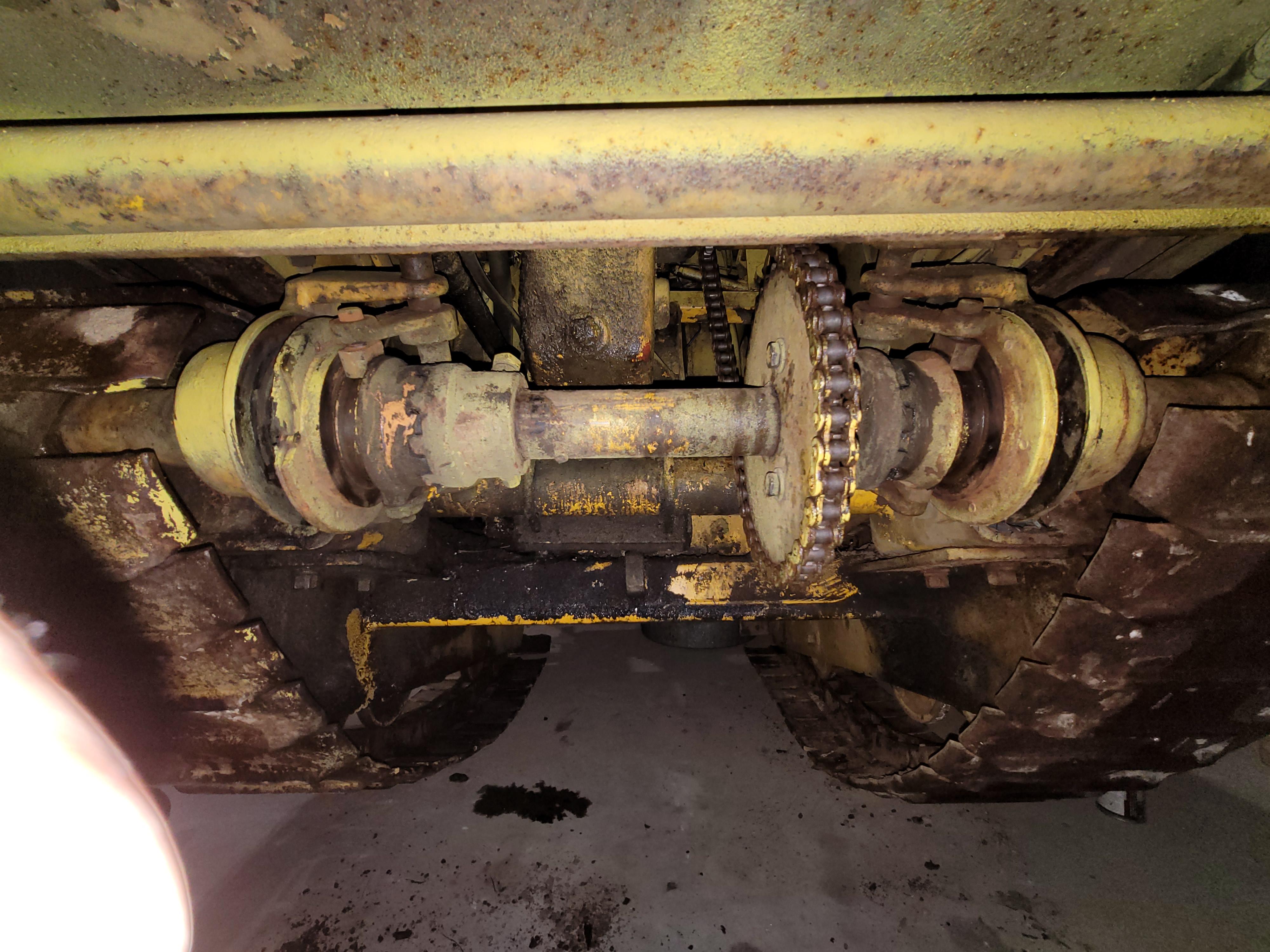

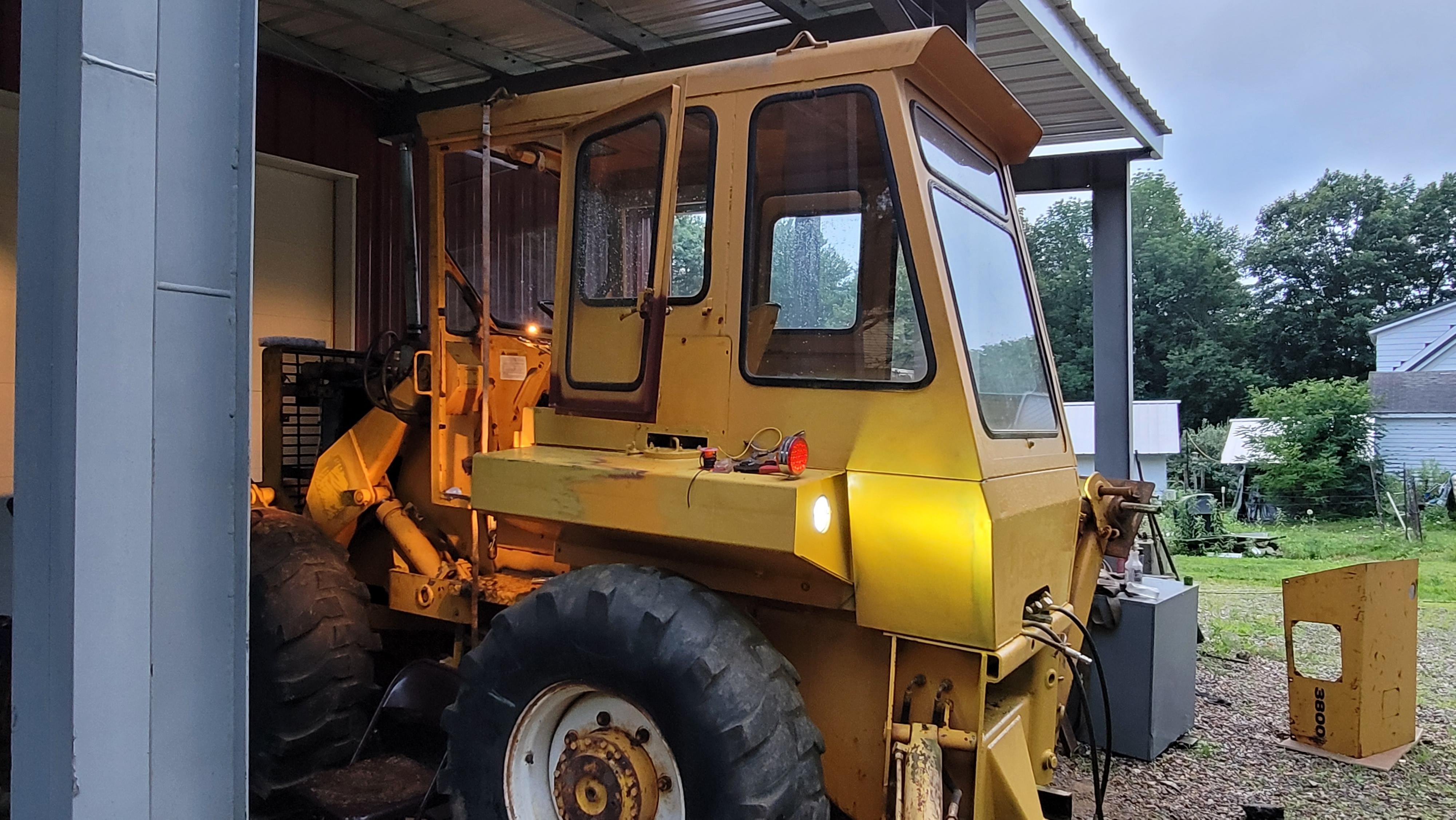

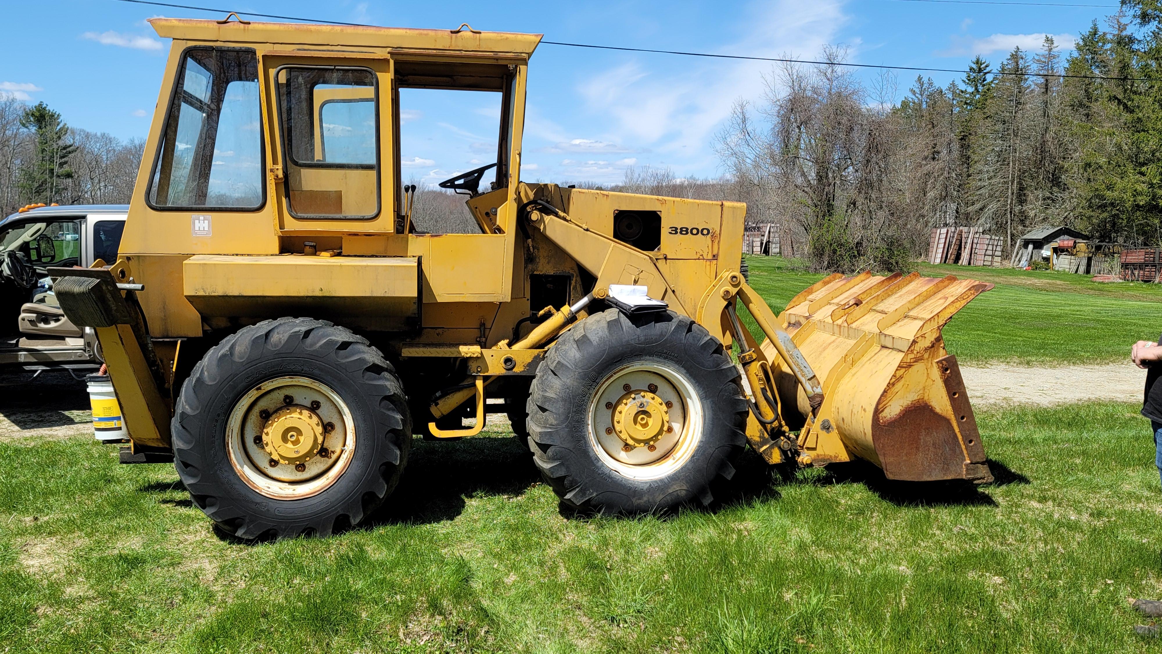

A late 50's  Davis taskforce 200 and about a month ago I picked up a late 60's IH 3800 backhoe ..
The Davis needed a complete redo on the drive line..
And the  IH has been taking care of the neglect and terrible repairs to keep it running.

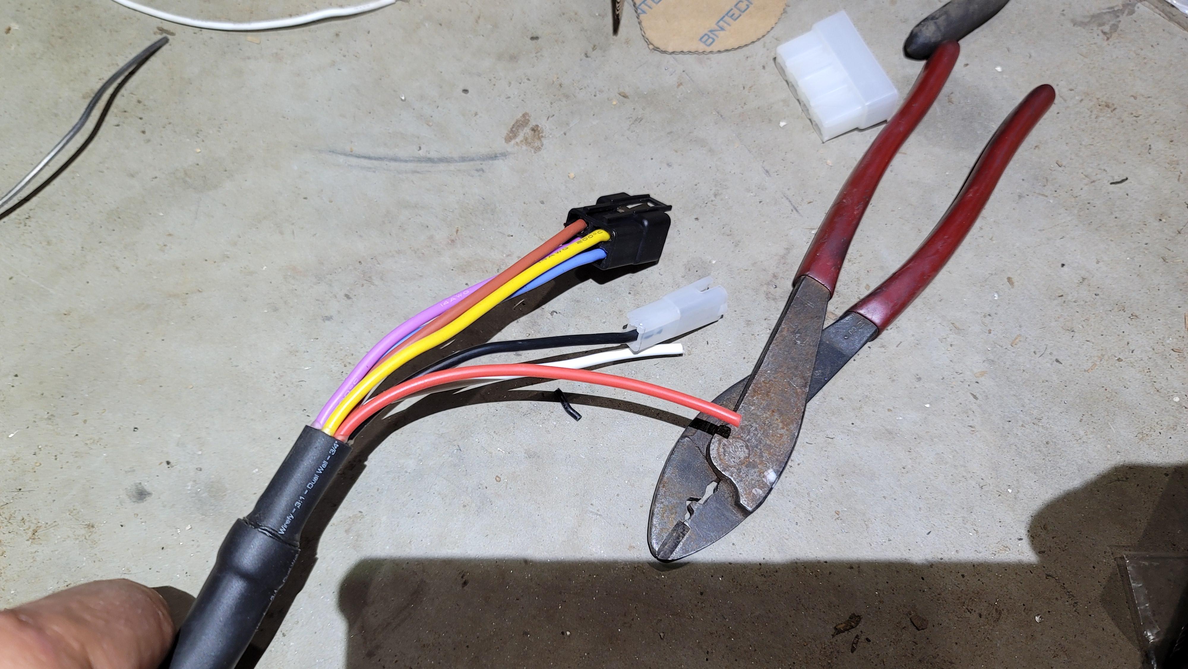

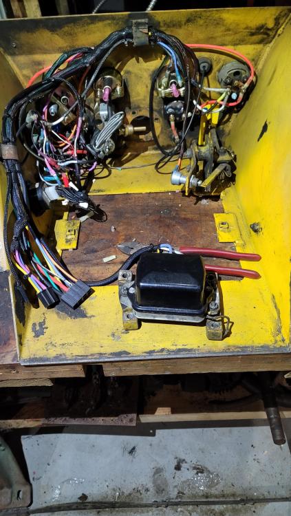

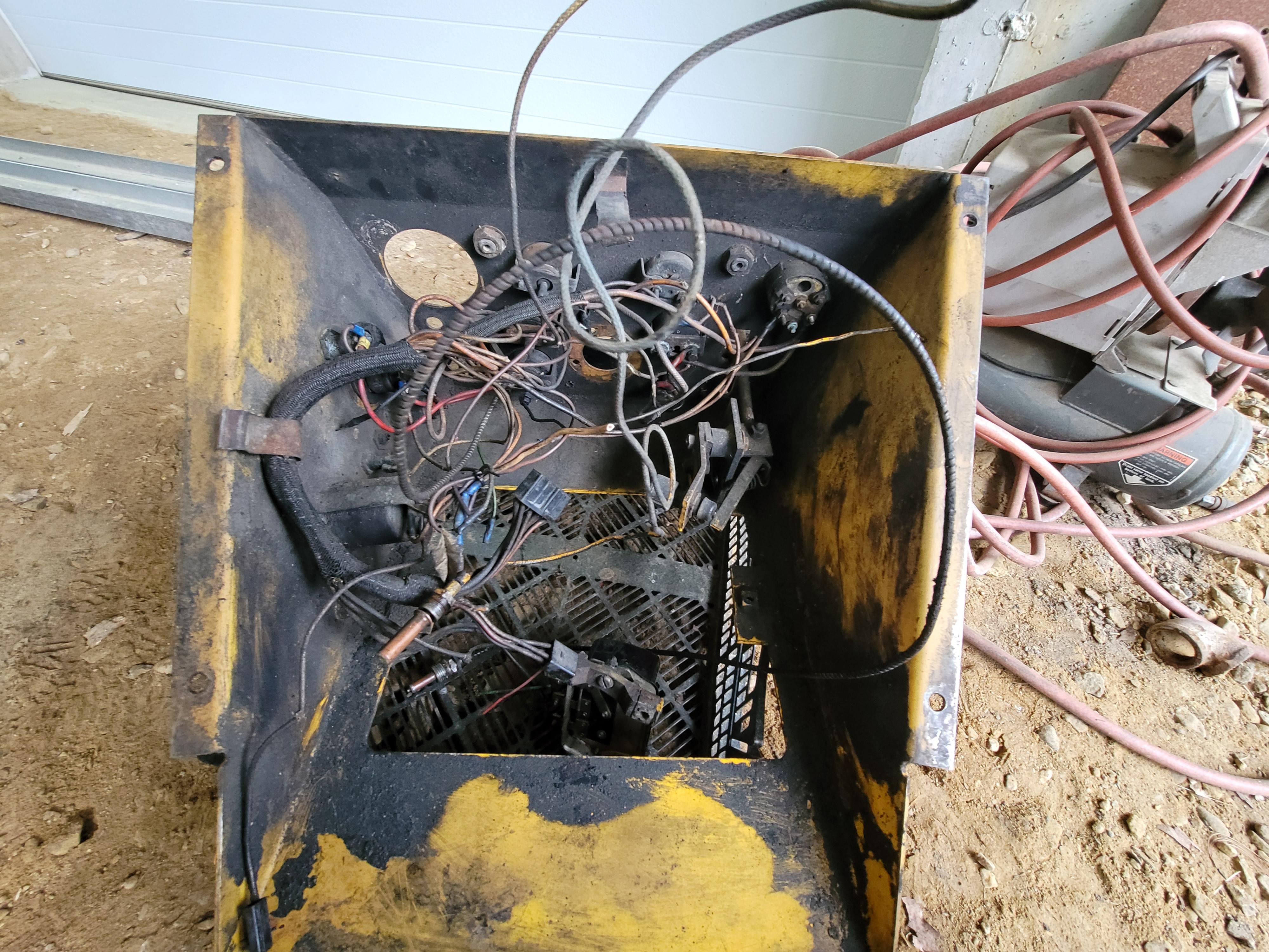

The wiring harnesses for the whole machine were really bad so started with them..  Console, glow plugs, changed trans oil.
Once the stuff is done I'm currectly working on I will take the brakes apart to get them working.
And a few of the IH3800..  For such a large machine, there is no room to work on anything.
I sorted all the hydraulic lines that reside under the floor boards.. They were crossed over and interfering with the trans selector.
This was a 4hr job...

The IH3800 is just such a cool looking machine and the price was right.   I contacted the guy back in December and never got a response..  Guy contacted me end of May asking if I was still interested in the machine..
Any yes that is my Mug..  Not the nicest photo of me but thought it was funny..

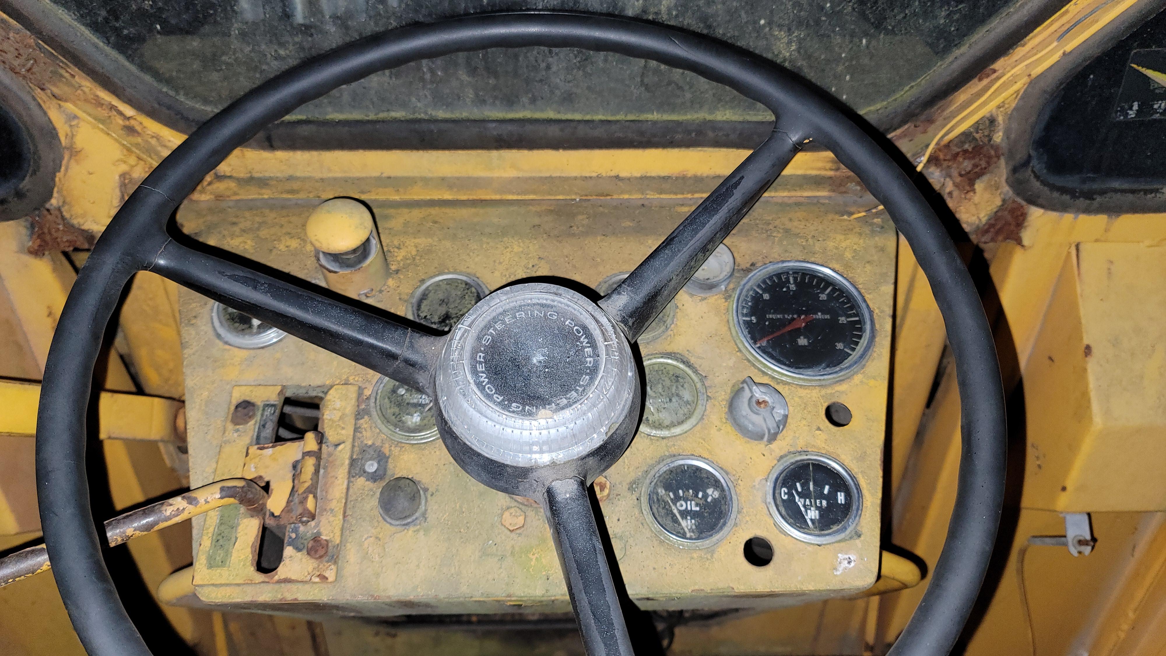

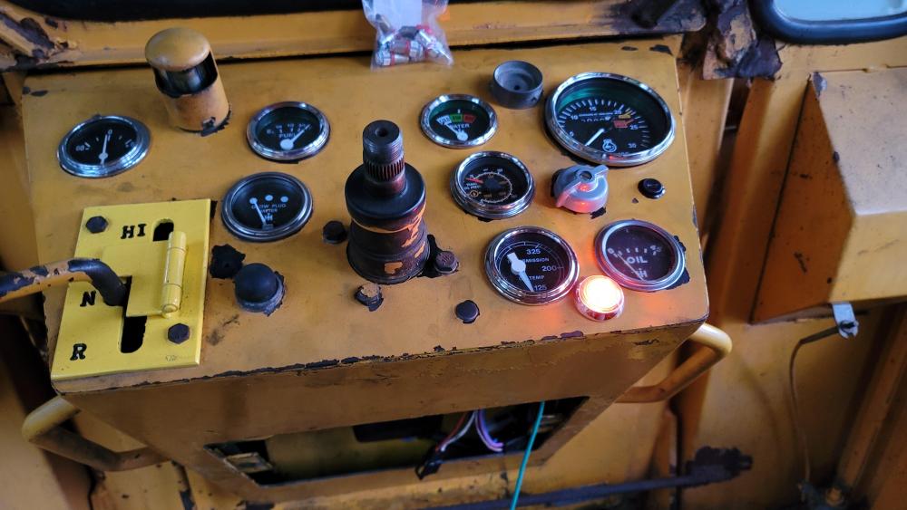

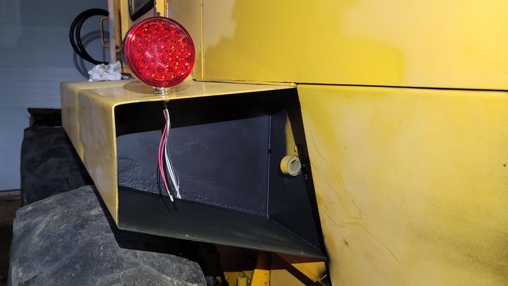

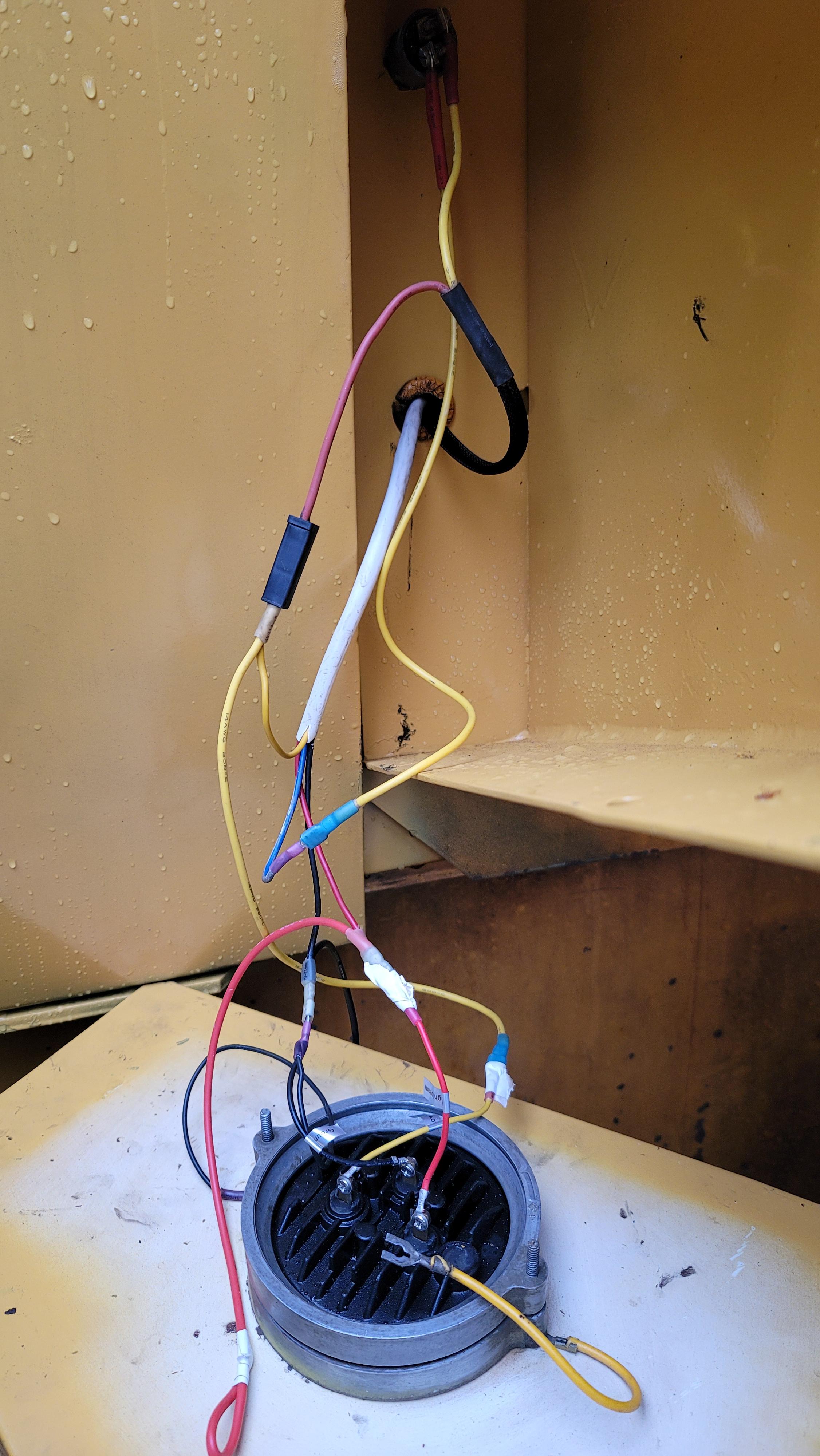

I got all the lights working though I need to find a low draw blinka relay.. I installed an LED light and it does not draw enough current to make it blink..
There has some wiring stuff which I don't really understand..  The console is completely powered even when key is off.
It looks as though the key really only controls engine functions vs lights and such.
I'm used to a key controlling everything including the lights..
The wiring is not as clean as I like to do.. But, I had to add wires which were not in the schematics to get the function I want.
The lights orginally were not grounded on a separate ground wire..  So added this wire and a few others..
if you dont end up getting the lights to turn off, the easiest is to hide a night switch in your main powerline this prevents any draw to to battery this also prevents unwanted use of the machine...
Night switch?  Do you mean one of those timer devices to turn on lights and such when away?
I have a new key switch from Polk that is a 3 position vs 2 position.
The key switch in there now is simply to energize the fuel injection pump and to energize like 2 other things..
Otherwise the whole console is live..  Not exactly how I would wire it.. But it's what was in the book.
Now parasitic losses or draws so far..  The battery keeps it's charge..
night switch is what we call a simple high amperage on-off switch mounted on machines or vehicles that you turn off when you shut the machine off for the day thus preventing draws overnight from radios etc.
I get it..  Have used them on race cars that have voltage leaks..
I have automatic switches on the Ford that will kick off depending on voltage..  As soon as you put the key on it reengages so it can  be started.
More commonly known as a "master switch" on equipment. It disconnects the battery from everything. Be imaginative when you hide the master. One of my favorite locations was out of sight behind the air filter but easy to reach you checked the oil. There's nothing suspicious about checking the oil but reaching up under a fender before starting it can catch folk's attention.

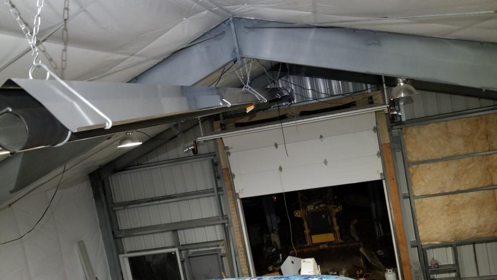

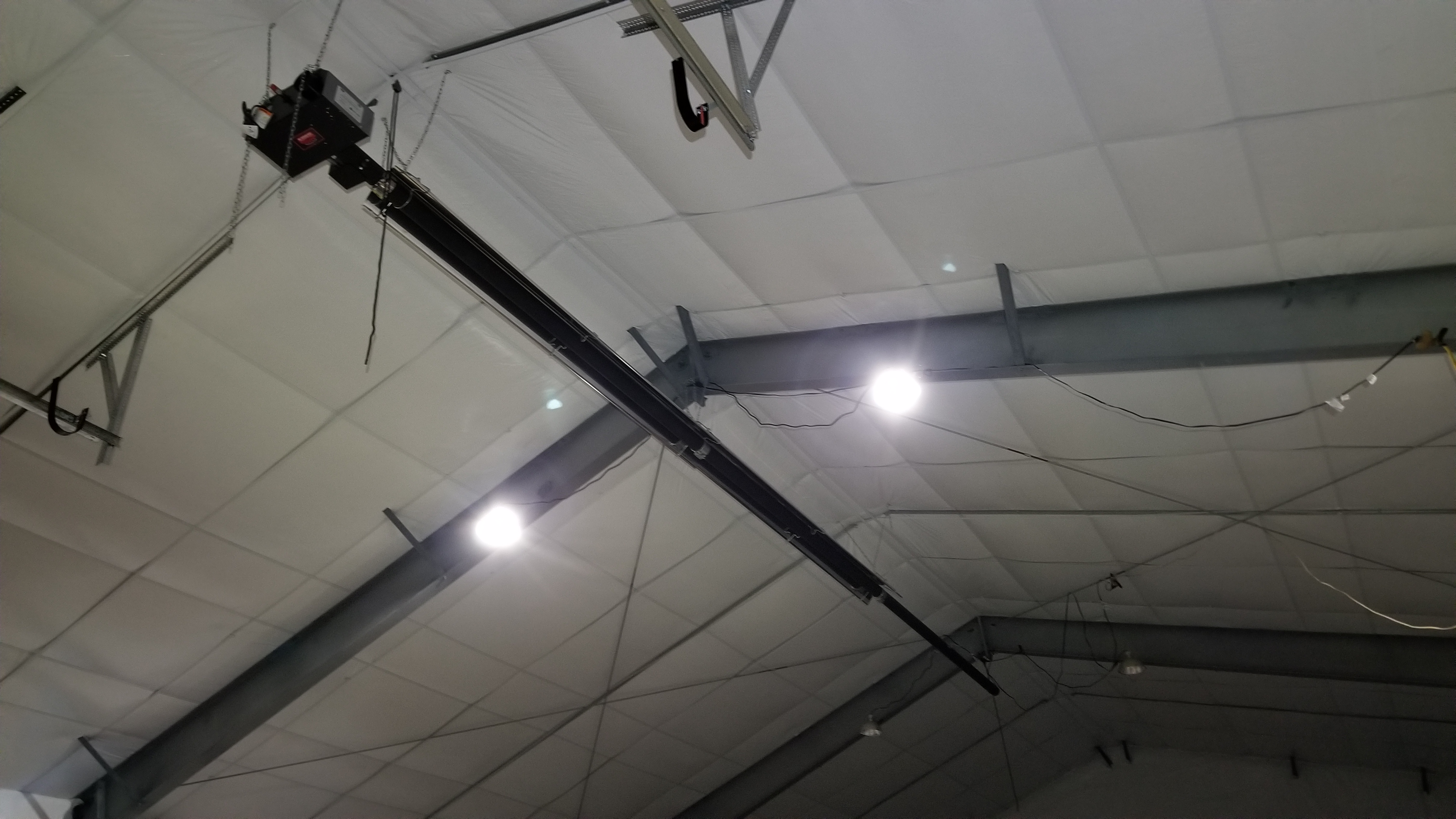

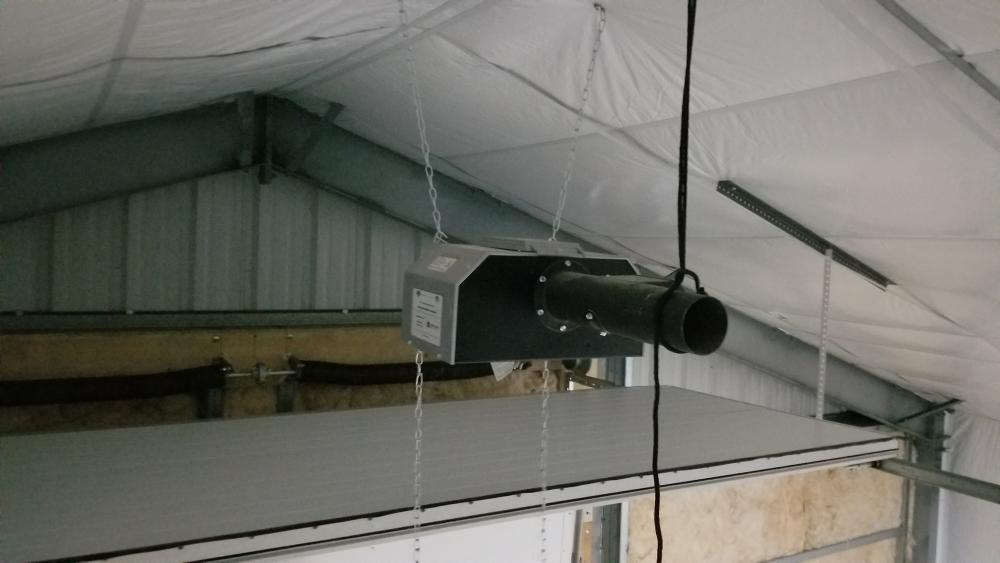

I started to hang the propane Infra red tube heater.  Because of the layout I went with a 150K unit 50ft long.
I think I have the measurements and mounting location correct. You can see where the burner is located just in front of the top of the door. This close you certainly don't want the IR tubes heating the back of the door.

George the IR tube heaters have no pores or holes that I know of..  The flame runs down the inside of the tube and makes it glow orange..  This is then reflected off the mirror deflectors in the direction of the open area of the reflector.
This type of heater heats the objects vs the air so when the objects are picked up they are warm to the touch vs cold with warm air.
Since it heats the objects all the machinery and equipment runs better on the cold days since the inners get warmed up quickly.
This types sip fuel and are very reasonable cost wise to purchase.  This heater complete with install kit was 1380.00 vs other types which are big money..  Getting a 120gallon tank outside can be done for free and just the cost of the propane is paid.
Not a great video but covers theory.
It has an intake from outside and an exhaust that routes outside..
Exhaust can be mounted horizontally or vertically.
I have an HL3 model 150K
https://www.reverberray.com/products/commercial-industrial/low-intensity-infrared-radiant-tube-heaters/hl3-series-2/
I was CLOSE anyway.

I ordered the install kit with the heater and it came with dog chain.
Not the easiest to adjust evenly. So will have to count links.
I ordered some turnbuckle as I'm not thrilled with the dog chain.
Will be easy to swap the chain out once its up.
