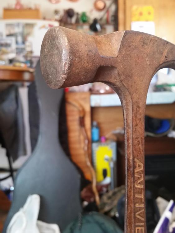

Anachronist58 Posted April 30, 2017 Share Posted April 30, 2017 (edited) I think Frank Turley said it well. I have yet to purchase a "true" rounding hammer, but this Stanley Antivibe, gleaned from a dumpster, is a lot of fun to use, even though I have yet to dress it proper. All it lacks is a wider face. My point is, if you feel creative you can dress that form into a flea market hammer to try it out. Dome faced hammers with smooth corner transitions, to me, are the most accommodating and forgiving of geometries. When I finally adopt my first "real" rounding hammer, all that I will need is the palm of my hand to test for feel, control, and weight. But that's just me. Robert Taylor Edited April 30, 2017 by Anachronist58 forgot picture Link to comment Share on other sites More sharing options...
