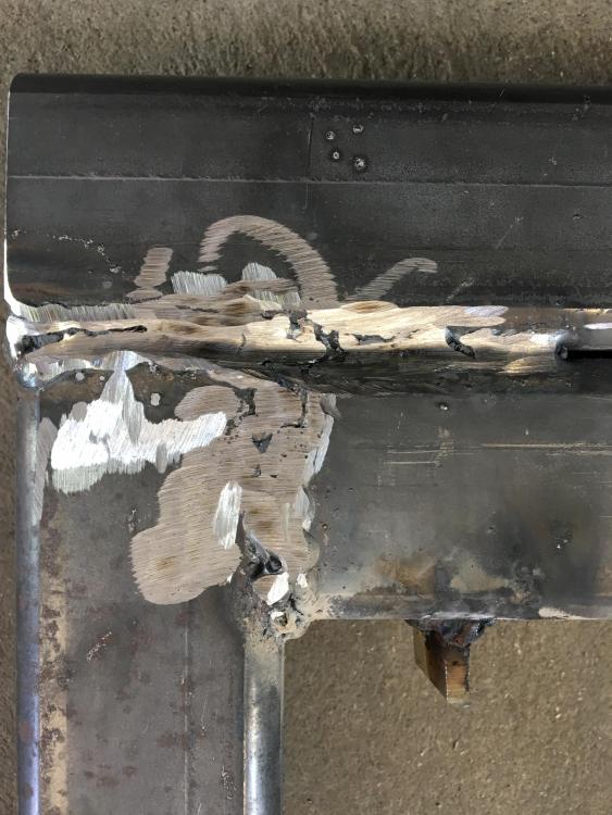

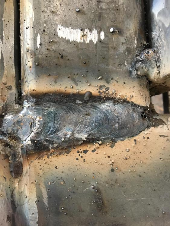

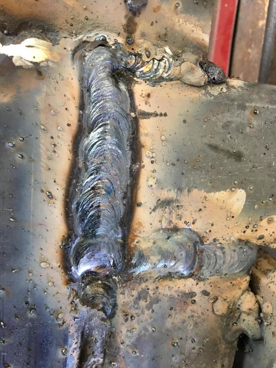

  18. Thanks for the feedback... I agree that most of what's welded there is crap. It turns out all I could get was 110A on my AC buzz box. I thought I had 170 but that's for some crazy German voltage or 3 phase. I think I managed to get a reasonable 6011 root pass (3/32") but all of the 7018 was way too cold and was sticking like heck so I ran tracks all over filling in voids. Nasty. I'll have to grind it back and weld this up at a friend's place. By the way, can you TIG over a mess like that to burn it all in? I'm looking at those Everlast multi units.

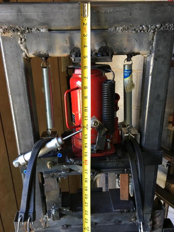

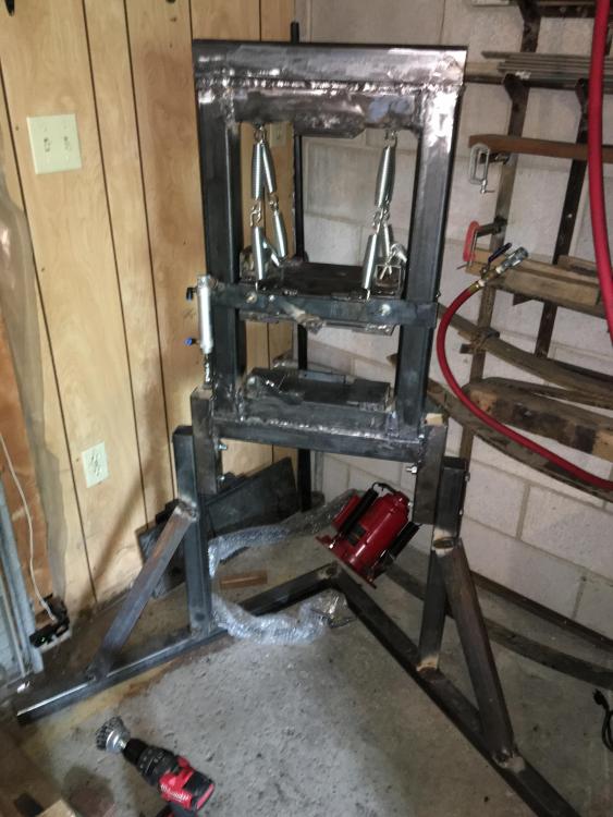

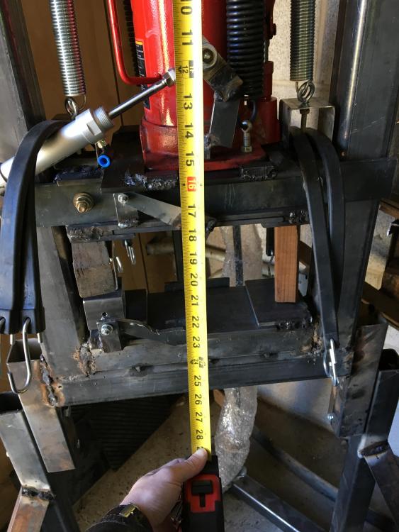

  19. Bit of an update... if one spring is not strong enough, just use more springs! I didnt get pictures of it all, but I added four springs per side to lift the bar and it works. Might need to weld on better rings for attachment points. This thing is likely to be slow and limited in its use, but if I can at least get some mechanical help piercing hammer eyes and fullering etc, it might serve a purpose. If I make a hydraulic press one day I will try to make the dies and die plates the same so I can repurpose them. This frame looks too short for the shortest hydraulic cylinders I can find.
  20. I heat treated my rounding hammer today, and then I tempered it... possibly a bit much. I think it's not hard. But then my anvil is not hard either so I decided to handle it and see how it goes.

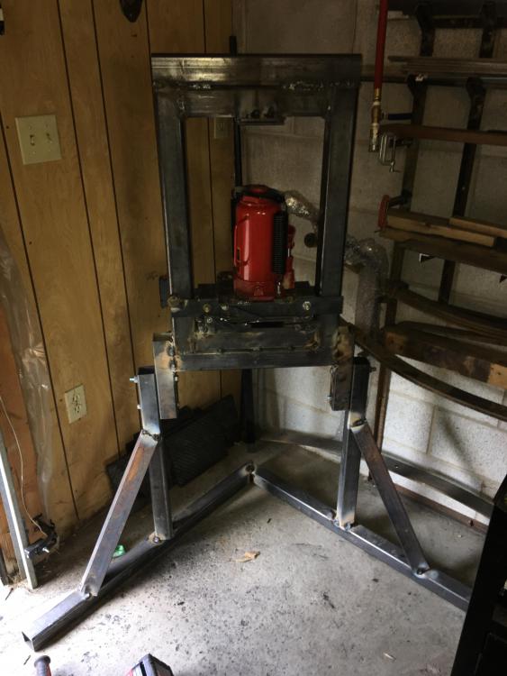

  21. Would this make for a decent press? https://www.princessauto.com/en/detail/3-hp-ac-2-stage-multifunction-hydraulic-power-unit/A-p8677247e (it's 6 gal/min and 1 gal/min pump speed). I did not build this thing for the dimensions of most hydraulic cylinders, and there is no mechanism to keep the H bar well aligned... it's loosely fit against the inside two faces of the vertical supports. I might be able to shim that up with HDPE. But in any case, I would need short cylinders... maybe 6-8" stroke with a length of 10" or so. I was intimidated by the risks of hydraulics, but now that I have this structure, it might make better sense!
  22. Hey, given that this is pretty beefy, maybe it could be converted to hydraulic later... maybe two small cylinders. What do you think?
  23. Hi all, i am just about done a forge press (air/hydraulic, for cost reasons) and have made good progress so far I think. See: I have to finish the return springs and the foot controls but it's starting to take shape. I think I over-built by 10x, especially for an air jack. Also, I wonder about the middle h bar not staying perfectly level. Any suggestions are welcome.
