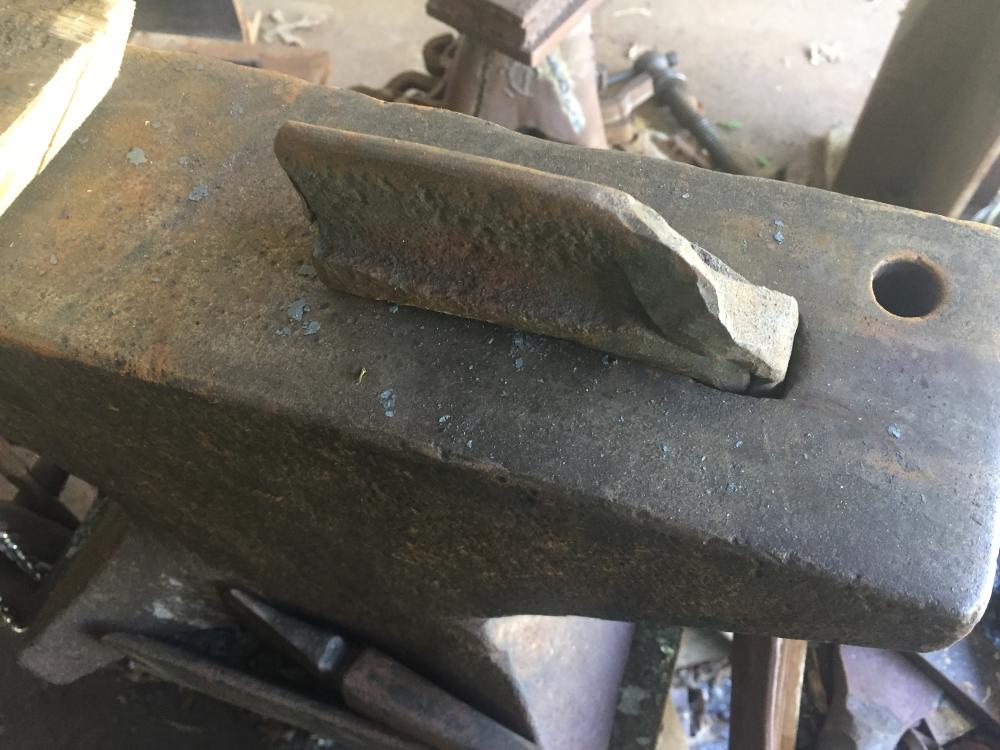

gote Posted May 6, 2017 Share Posted May 6, 2017 10 hours ago, littleblacksmith said: The time it takes to find a larger fuller, remove the smaller one and place the larger one in the anvil is time and heat lost, Ok, what I don't understand, is why use a bottom fuller when doing something liked drawing out a taper in the video??? I still don't see why it is any better. I switch hardy tools when the stock is in the fire so I loose no time at all. I further make all hardy tools in such a way that they are a thight but loose fit in the hole and that the force is transmitted to the face of the anvil. I can remove all of them by lifting between thumb and fore finger but they do not move sideways more than a tenth of a millimeter or so. I do not think that anybody has said that a bottom fuller is better. It is said - and very true in my view - that skill is more important than the tool but a bottom fuller is one of the tools that CAN be used. On 2017-05-05 at 4:47 AM, littleblacksmith said: I mean, with the flat side, it wont stay perfectly straight, and you will have to straighten it anyways. Yes it does but this may depend upon who holds the hammer. But you are right, it is necessary to correct but this is more because even over the edge, there is a certain amount of unwanted sideways squeeze. Quote Link to comment Share on other sites More sharing options...

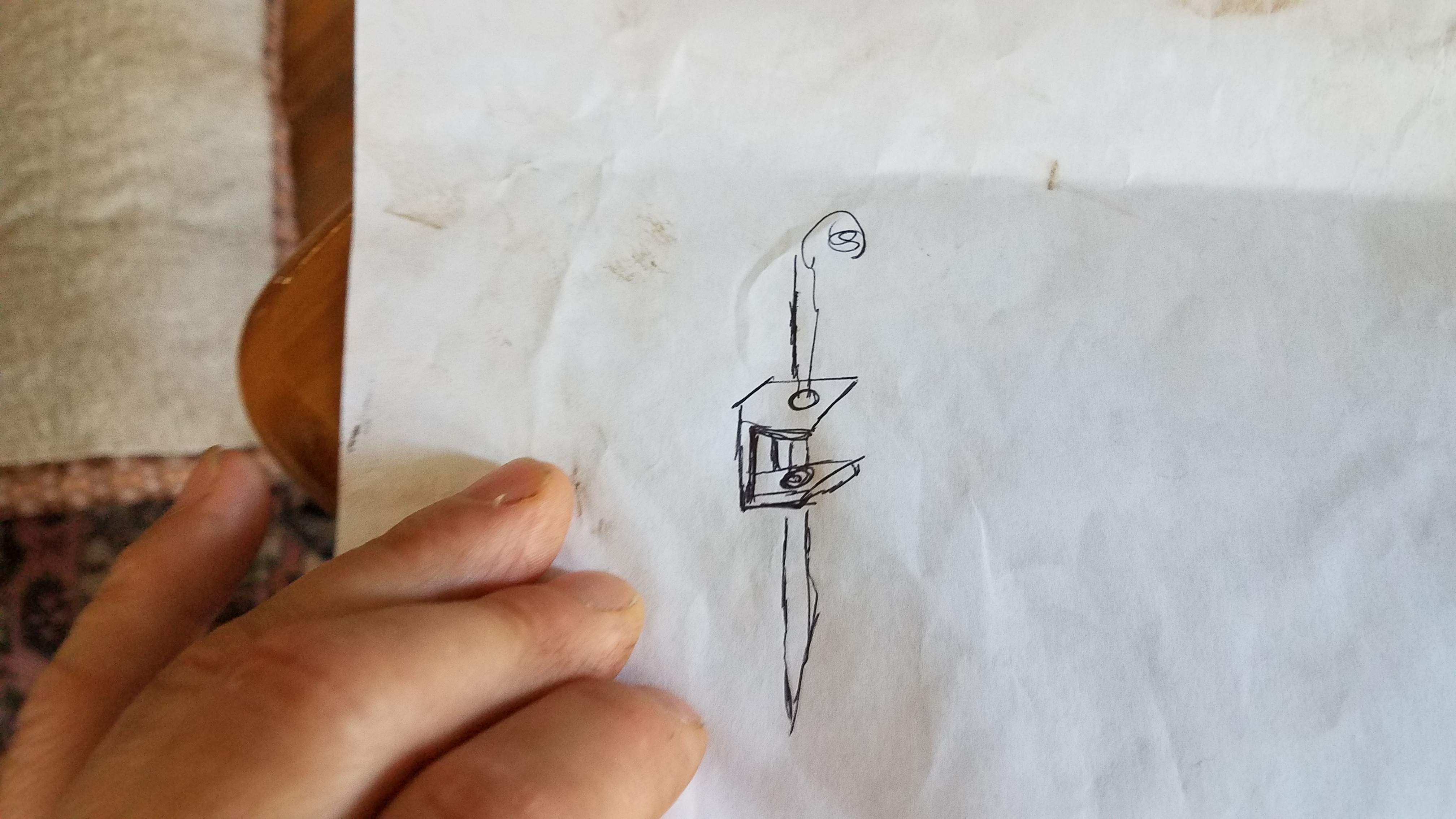

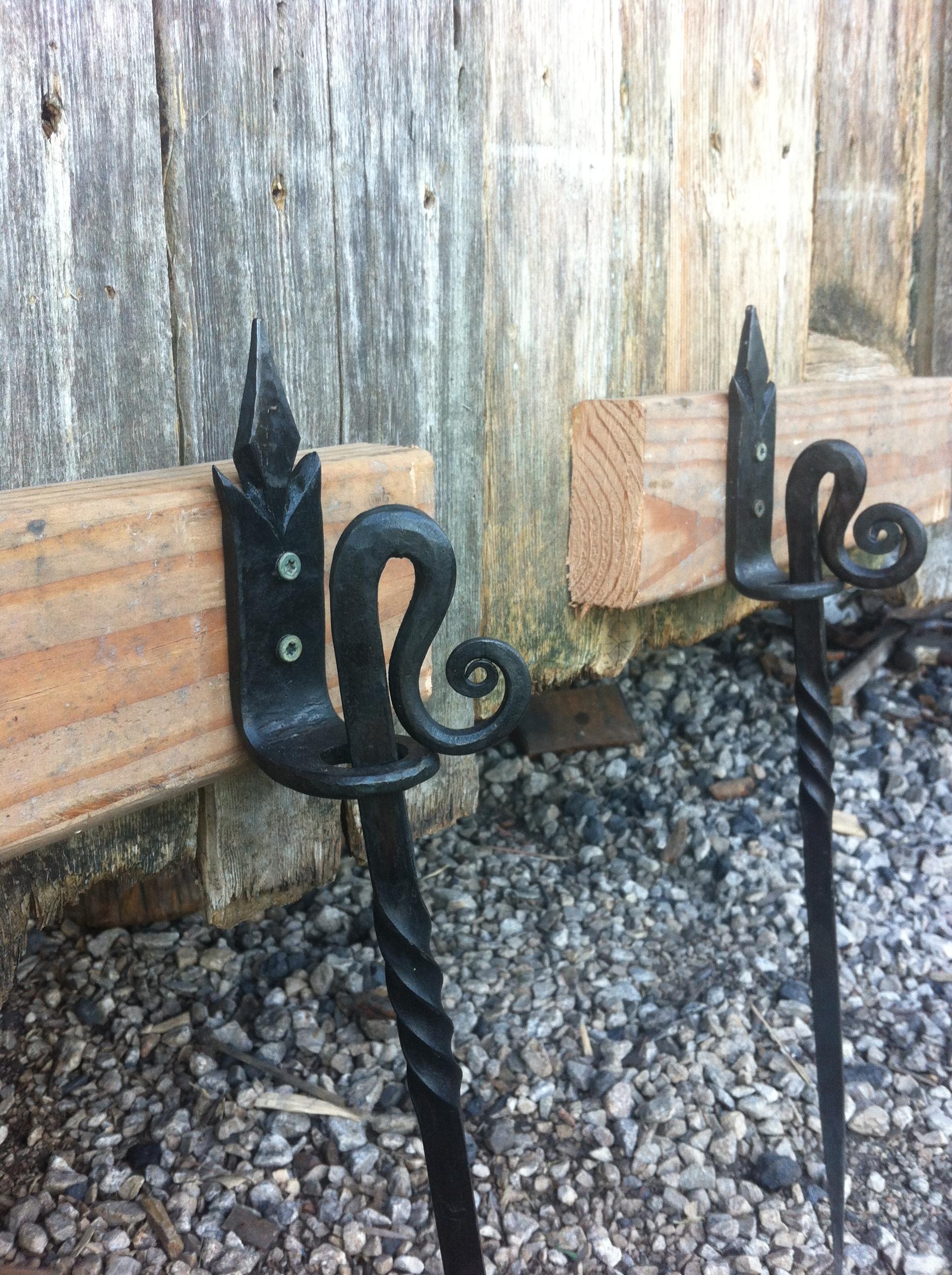

jlpservicesinc Posted May 7, 2017 Share Posted May 7, 2017 Nice work but not quite sure what they are for? If they are to hold doors closed only having one hole will become a problem as the pin will want to twist.. Quote Link to comment Share on other sites More sharing options...
gote Posted May 7, 2017 Share Posted May 7, 2017 these are very good looking whatever they are. May I suggest that you do something about the fixing. If home maid nails are out you can always get a screw with a hexagon head and bash it up so it gets in style with the rest. Quote Link to comment Share on other sites More sharing options...

Mark Ling Posted May 7, 2017 Share Posted May 7, 2017 10 hours ago, jlpservicesinc said: Nice work but not quite sure what they are for? If they are to hold doors closed only having one hole will become a problem as the pin will want to twist.. well, they are actually more for holding the doors open, I'll be making a latch later to keep the doors closed. open the doors, and that drops into a piece of tubing because I didn't make them long enough to go into the ground. Not the first time, and hopefully not the last, but I'm not sure what you mean by the last part? 6 hours ago, gote said: these are very good looking whatever they are. May I suggest that you do something about the fixing. If home maid nails are out you can always get a screw with a hexagon head and bash it up so it gets in style with the rest. will do. I didn't even think about that even though I have a pile of them from warm ups every day! 51 minutes ago, jlpservicesinc said: By the way I love seeing you at the anvil in the video.. All the new young blood coming to blacksmithing and having a skill set to boot.. Puts a big smile on my face.. Thank you very much, it means a lot coming from someone with more skill than me! I'll try and put out more videos! Littleblacksmith Quote Link to comment Share on other sites More sharing options...
jlpservicesinc Posted May 7, 2017 Share Posted May 7, 2017 24 minutes ago, littleblacksmith said: Thank you very much, it means a lot coming from someone with more skill than me! I'll try and put out more videos! Littleblacksmith If you use nails be sure to clinch them on the other side of the door.. drill hole undersized.. Make the nails 1/4" longer then all stacked up materials combined.. Make sure the nails are soft.. Here is a simple sketch of the better way to do it or make 2 brackets like you made and make sure the locking rods are long enough. Quote Link to comment Share on other sites More sharing options...

Alan Evans Posted May 7, 2017 Share Posted May 7, 2017 11 hours ago, jlpservicesinc said: Nice work but not quite sure what they are for? If they are to hold doors closed only having one hole will become a problem as the pin will want to twist.. 22 minutes ago, jlpservicesinc said: Here is a simple sketch of the better way to do it or make 2 brackets like you made and make sure the locking rods are long enough. I understood that the tubing in the ground was what kept the pins vertical/rigid. So the single loop was all that was required. Interesting reversal of the normal arrangement. Alan Quote Link to comment Share on other sites More sharing options...
jlpservicesinc Posted May 7, 2017 Share Posted May 7, 2017 1 hour ago, Alan Evans said: I understood that the tubing in the ground was what kept the pins vertical/rigid. So the single loop was all that was required. Interesting reversal of the normal arrangement. Alan wont keep rigid as they are tapered so unless they are going into tapered sockets.. Well you get it. If not supported in more than one place or a tight fit at the receiver.. the finial to shank being a v around a rounded eye will act more like a hinge than a lock.. It needs more support.. Besides that when a door catches wind it will take quite a bit to keep in from pulling or snapping off the screws.. I'm sure just pushing a little bit on the doors would show how the leverage effect would be in full application.. Quote Link to comment Share on other sites More sharing options...

Mark Ling Posted May 8, 2017 Share Posted May 8, 2017 Thank you very much jlpservicesinc I see what you are saying now! 12 hours ago, Jim Coke said: You are a very skilled young smith and I think the reason some of the older smiths offer you comments is that we see your potential. Just my 2c.. I do not see why the speed of drawing out a bar is so important. Thank you! Why do something slow if you can do it faster? I prefer to get as much done as I can and work at my full potential, and if I was to go slow and just work the bar flat on the face it would end up taking more work, and well, I'm lazy! 12 hours ago, Jim Coke said: Looking at your finished parts you started with square bar and the scroll portion on one stayed square and the other transistioned into round. What's the rush? Quality first quantity last.. I only wish you lived closer to spend some time in my shop. I'm sure I would learn a thing or two from you. Keep up the great work . Yes I start with square, then go to round, and then go to a flatten round, so it was flat on to sides and then rounded on the other two giving me a capsule shape. they are both like that, which one were you thinking was different? I'll see if I can get a better picture. yes, I wish we all lived closer, as my favorite thing to do is forge with other smiths! I would pay somebody to forge with me! Littleblacksmith Quote Link to comment Share on other sites More sharing options...
