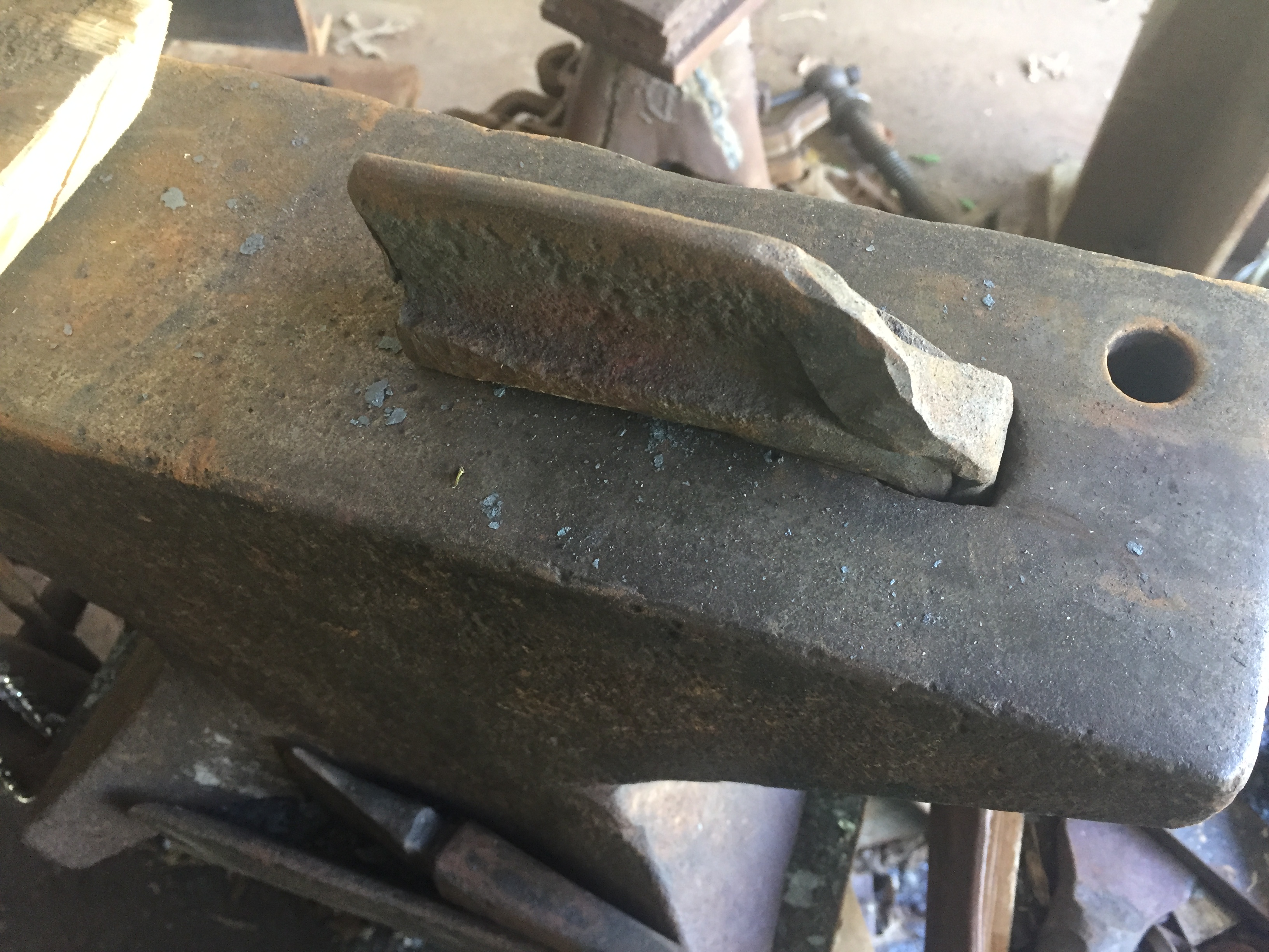

JHCC Posted May 4, 2017 Share Posted May 4, 2017 On 5/3/2017 at 4:36 AM, gote said: One can overcome this by using a fuller resting on the sweet spot with an extension to the hole for keeping it in place. Thus: (Made from a FAIR railroad track anchor.) Quote Link to comment Share on other sites More sharing options...
Mark Ling Posted May 5, 2017 Share Posted May 5, 2017 20 hours ago, gote said: I believe that it could be better to use a small radius fuller over the sweet spot than to use the edge if the anvil is light and rocking. I think that this is what I wrote did I not? I did not refer to the face of the anvil but I believe that using the peen over the face is better than using a flat face hammer on a rocking anvil edge. Not all anvils have suitable edges and the gurus of this forum always advice to wait before starting to reshape the anvil. In the meantime a bar laid securely over the sweet spot is a substitute and a kind of fuller. I will agree that a flat faced hammer is more forgiving. But, is it too difficult to straighten the bar? I mean, with the flat side, it wont stay perfectly straight, and you will have to straighten it anyways. I find a huge difference in moving metal with the round die of the hammer compared to the flat, or else I wouldn't be using it. This is a quick video I shot tonight. I realize It doesn't really have much to do with why the rounding hammer, but I thought it might help... Starting out I was a little more nervous and so my forging was more awkward and not how I normally forge. By the end of the video I became more comfortable and forged closer to how I typically do. That was the second time I had ever used the bottom fuller how I did, but I did find once you got to the end of the bar it kept slipping off, and you couldn't move as fast. Littleblacksmith Quote Link to comment Share on other sites More sharing options...
