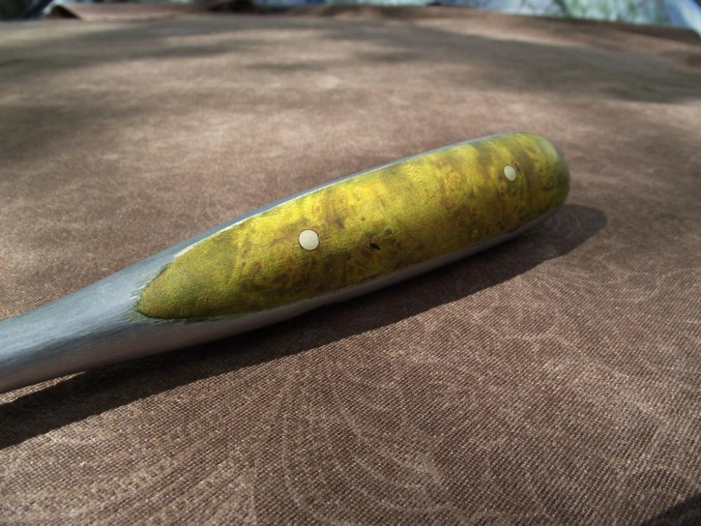

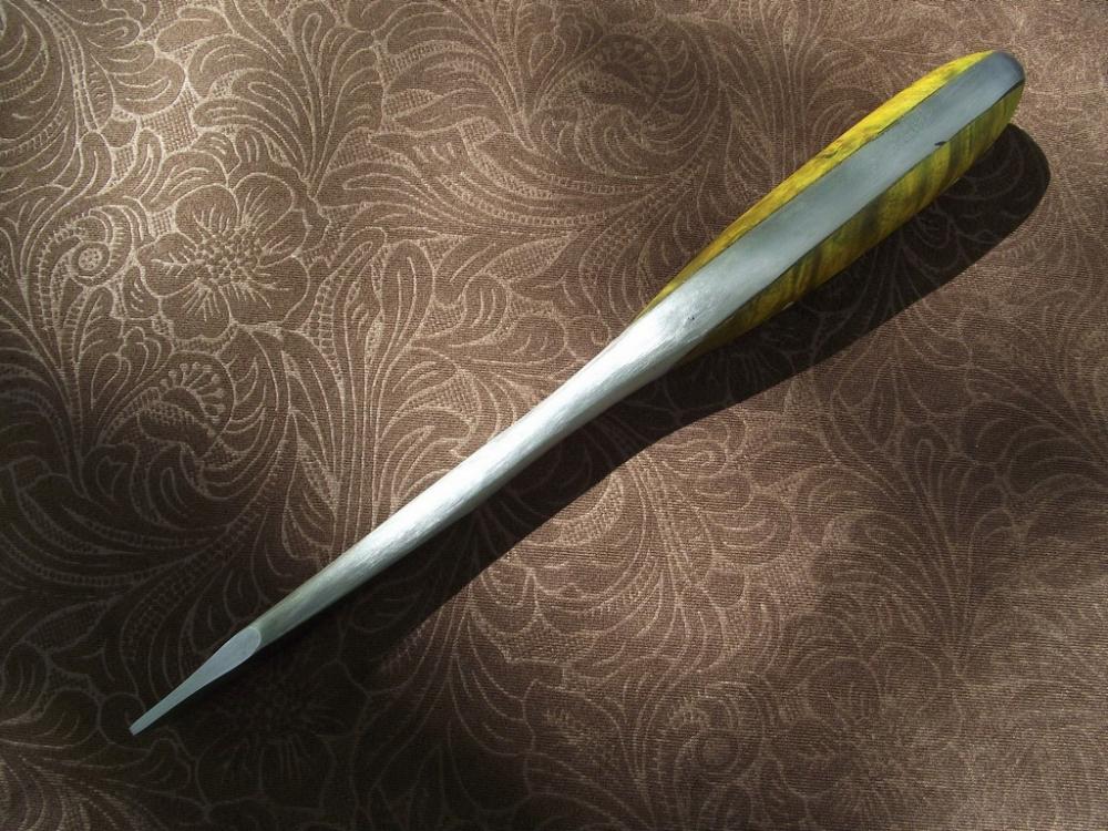

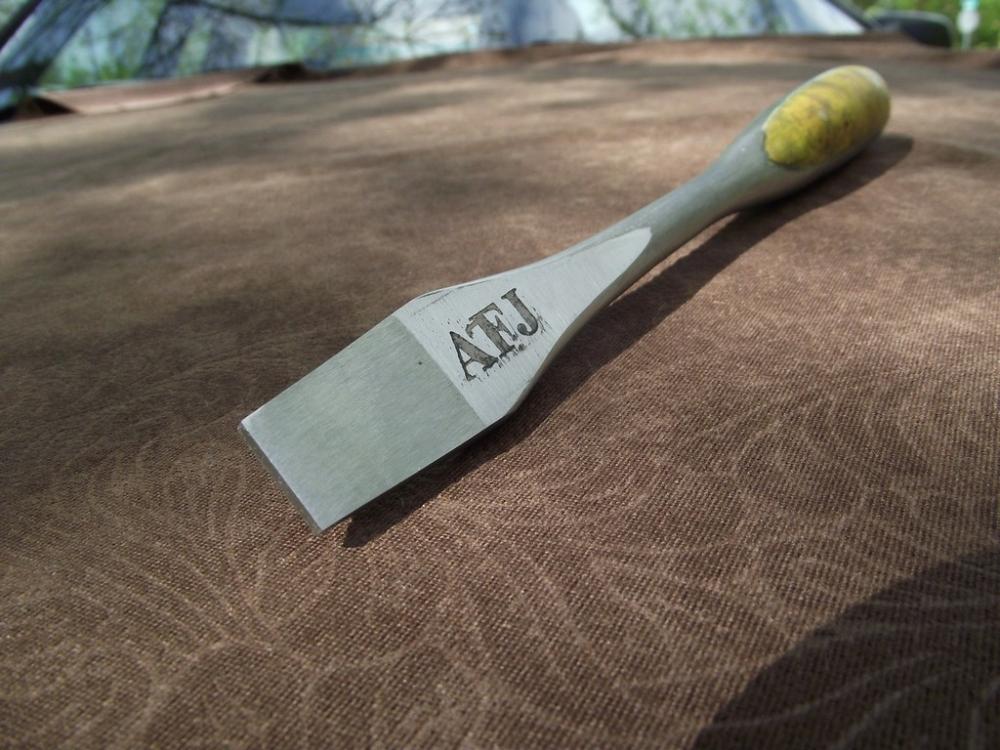

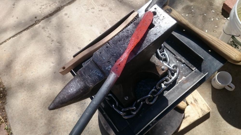

bobasaurus Posted June 2, 2016 Share Posted June 2, 2016 I forged this so-called "perfect handle" screwdriver for a tool swap on lumberjocks. I'm just starting to learn some blacksmithing to augment my woodworking, so it's not super clean but I'm proud of it. The blade is O1 steel that started as 3/4" diameter drill rod. I heat treated it myself in the forge and my kitchen oven. The scales are dyed maple burl. Finished with BLO and renaissance wax. Quote Link to comment Share on other sites More sharing options...
