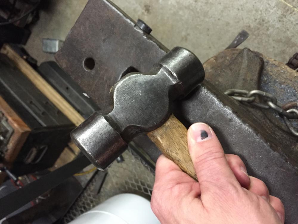

  8. Nice looking hammer enjoy. Here is my 2.5 lbs hammer.

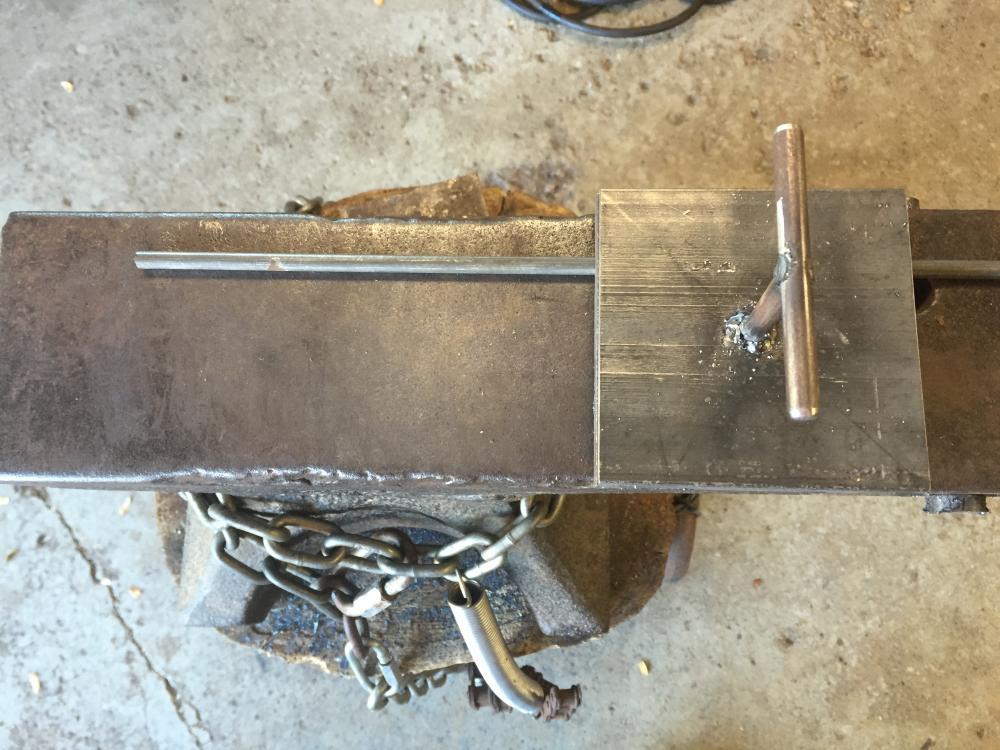

  13. I made one of these works great for small stuff. http://youtu.be/zMIA3_cKC-o Here are a photo the one I made.
