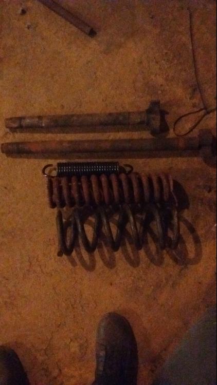

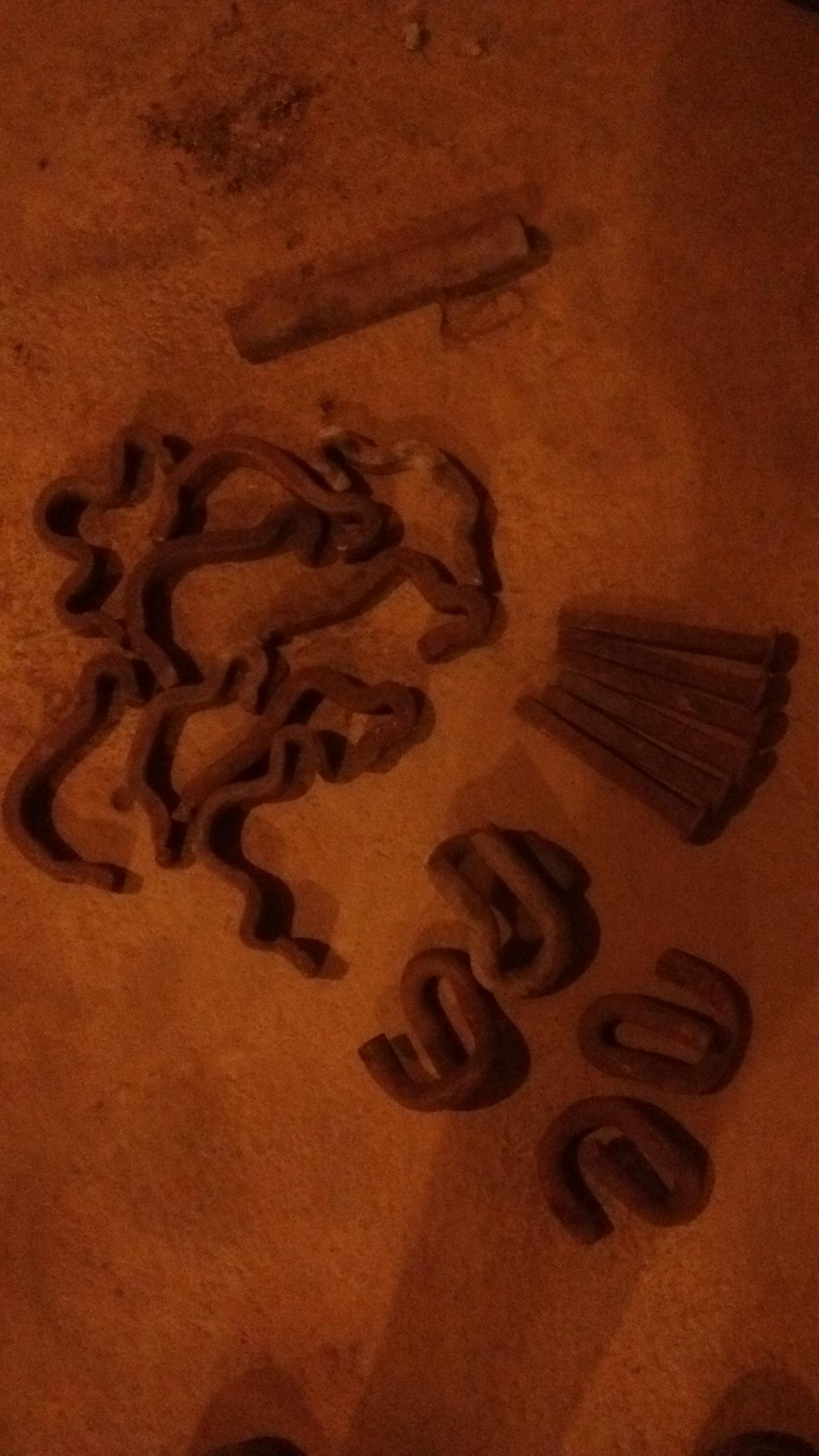

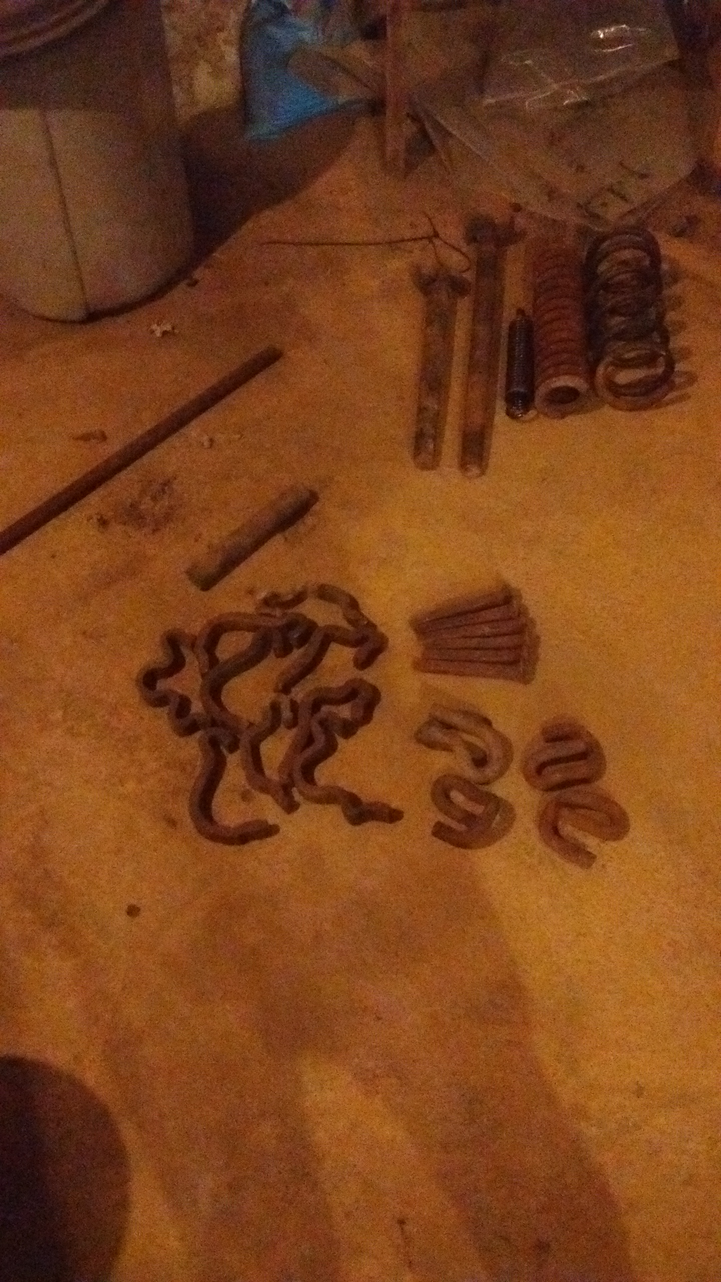

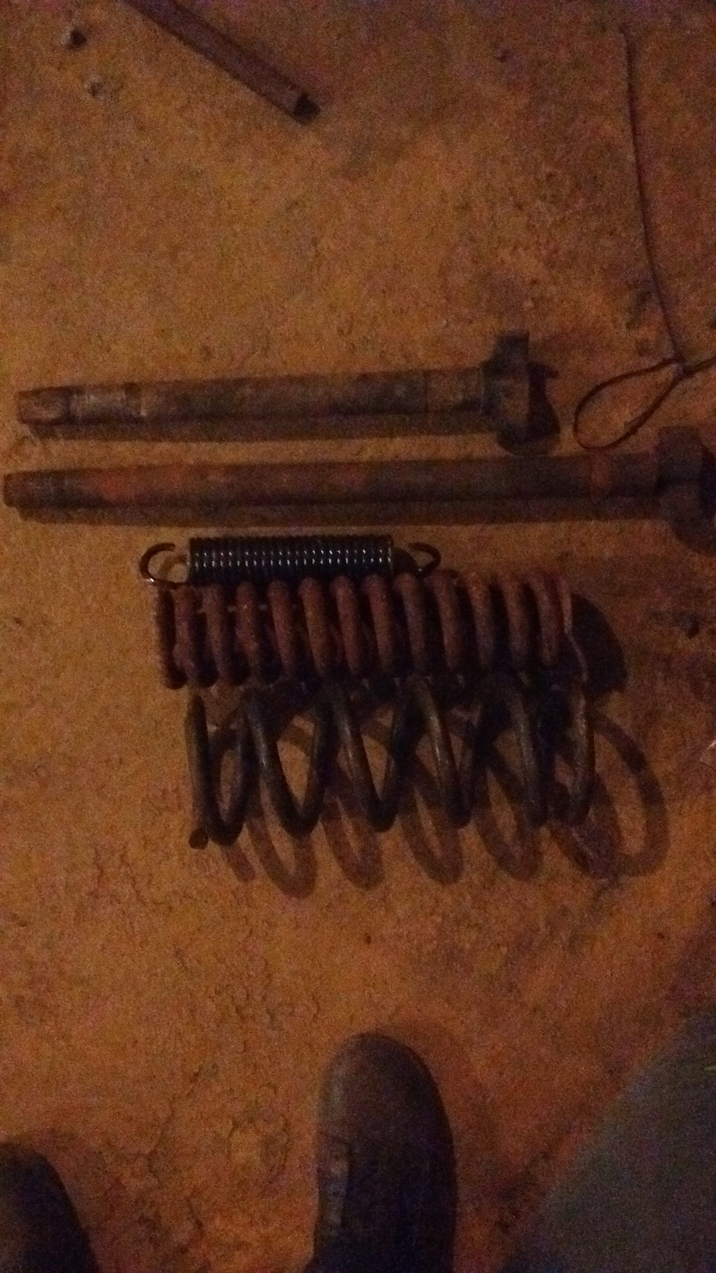

I will be using someone else's anvil to start, but I went to the scrapyard today and spent $40 on stock. Included in that was a section of rail which could be used as an anvil (gave it to my girl for her jewelry exploits but you get the idea). I'll be using a different anvil and forge, but nonetheless. There are blueprints on this site (55 Forge and other forges) which show you how to make a free or nearly free coal/charcoal forge so look there for that. Those costs will come up later on when I build my own. My $40 got me 130 lbs of scrap to start with. I got RR spikes and clips and a 12" section of rail (legally from an approved dealer), 2 5/8" coil springs, 2 axle shafts, and a 3' bar of 5/8" round bar. Later this week I will post what tools I make to work with AND the trinkets i make to sell to put money back into my shop. This is a systematic process from which you may consider me starting from just a forge and an anvil. Current shop expenses, US $40 maybe $50 but I am not including the cost of whiskey in my shop expenses lol ;)

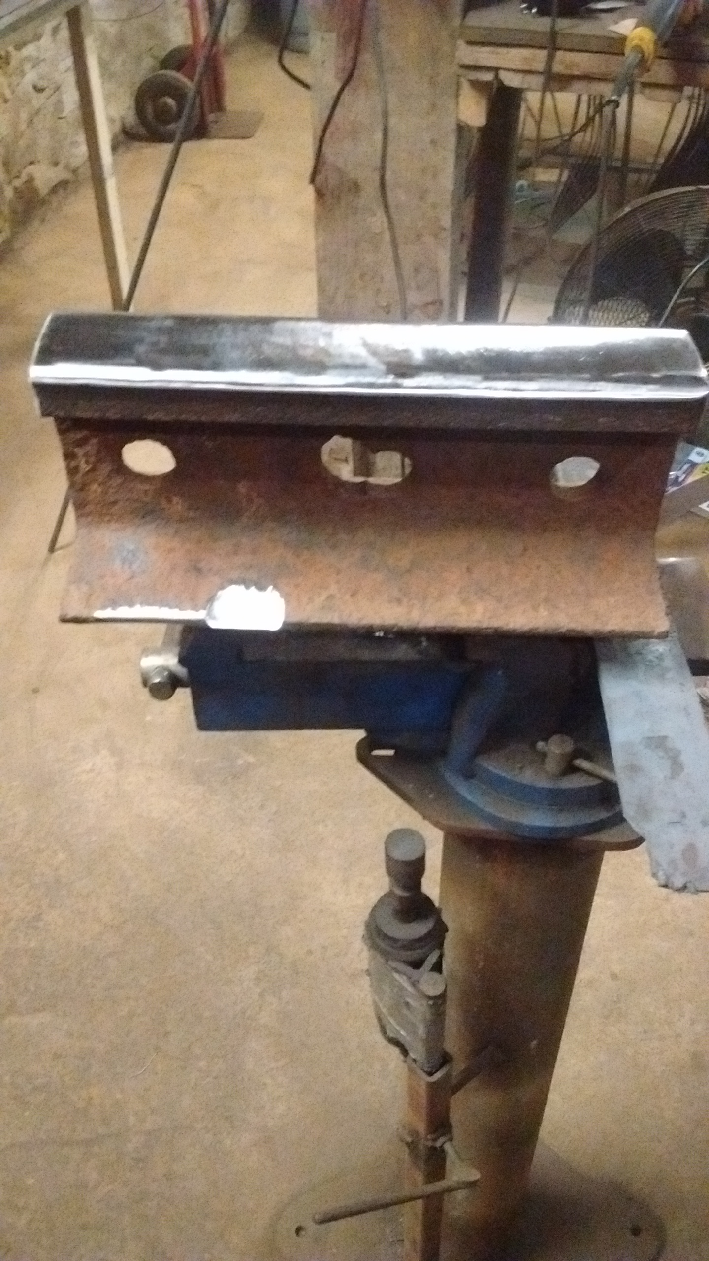

Some pictures of the haul from the scrapyard today. I gotta say, 130 lbs sure does look insignificant lol. On the track, you can see that I ground in a radius and hot cut on the flange. Once again, I am not using this, it is for my girlfriend to use but I include it in material cost. Plus, why not show it?

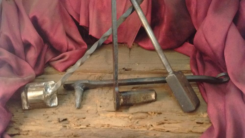

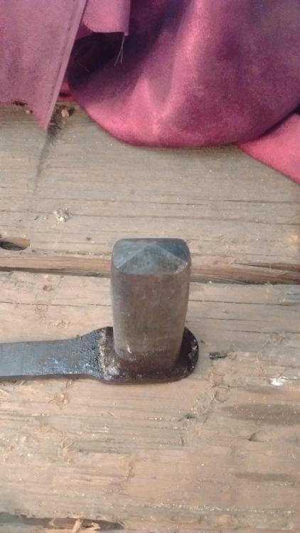

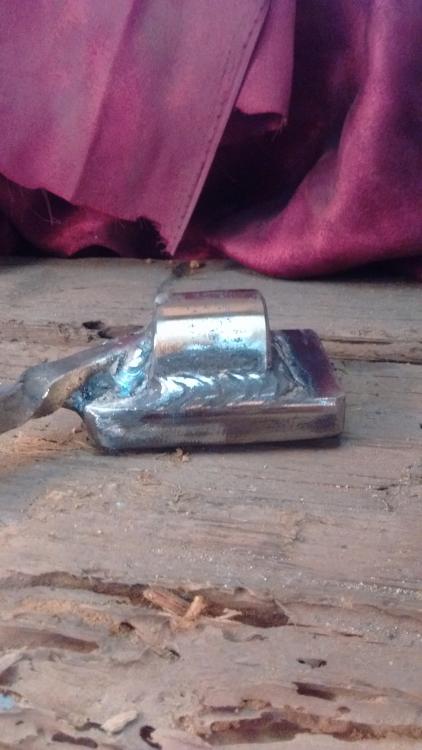

Here is a picture of what I was talking about. 1" X 1/2" box jaw tongs for working the RR clips (1060 ish steel) I got from the scrap yard and they will also hold the 5/8" coil springs I got reasonably well. They were made from the round stock purchased at the same time. I also made a center punch and a round punch from the coil spring. The spring fuller in the picture is 5/8" made from the coil spring. It was made to fuller a section on the order I got the other day. It has a base that sits in the hardy AND the pritchel hole for added stability in use. You may notice that it is  "floating" at the spring. This adds durability and adjustabity ease with ease for future adjustments in throat size. Since the fuller stock is 5160 or similar (junkyard steels are fairly unpredictable) I decidided to braze it to its base insteal of welding to better suit its durability in use. Hopefully I will have a full day of tool making sometime this week and post more goodies for y'all. 7663.jpeg.bfa743472fbdcb810b4bf129dd422f

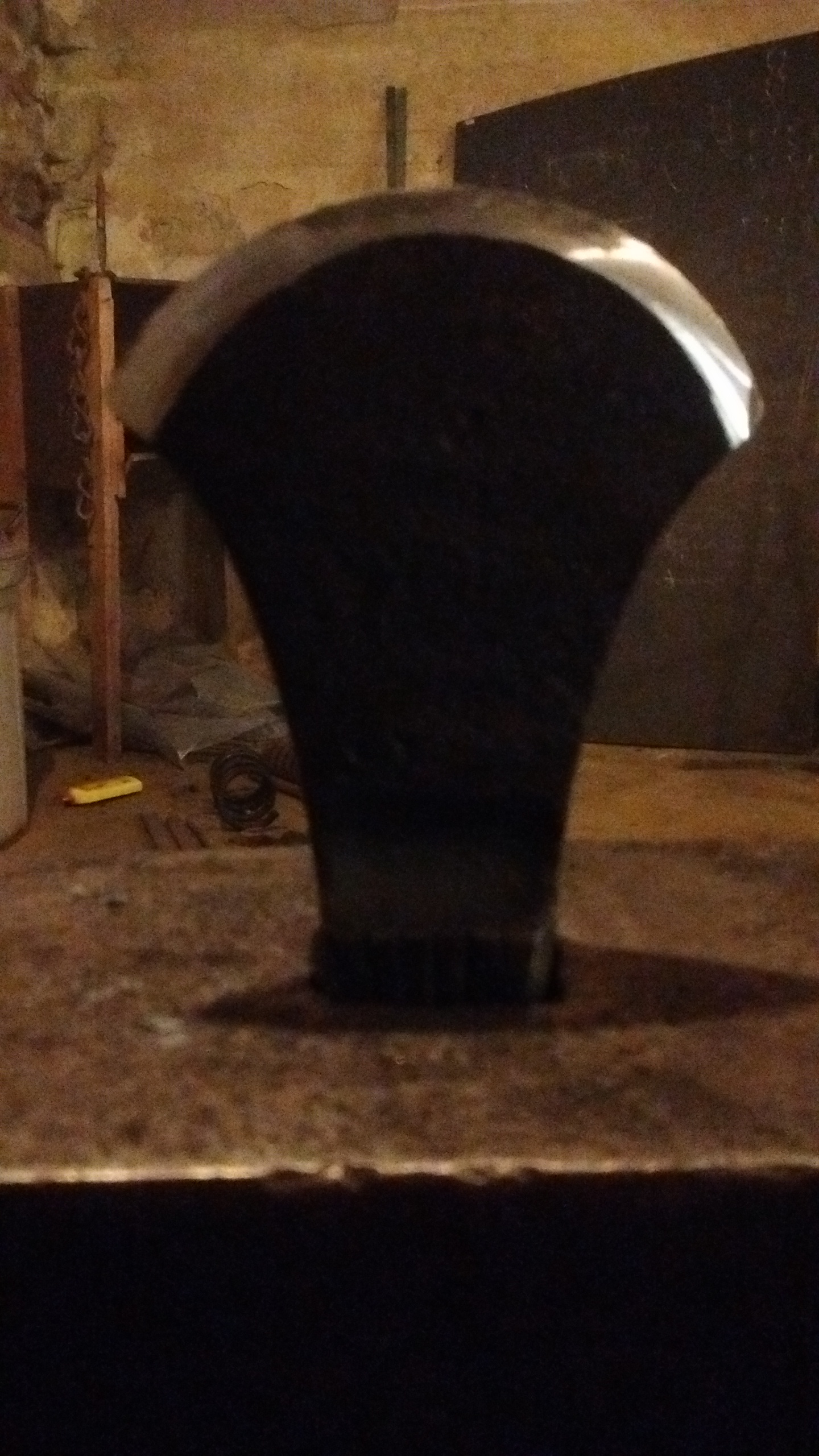

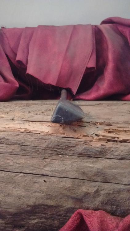

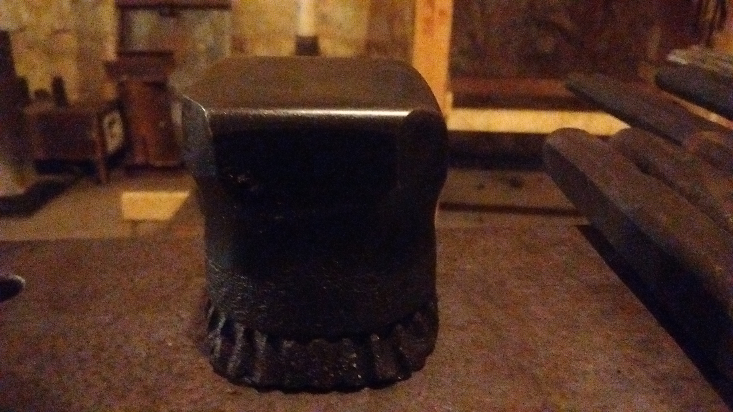

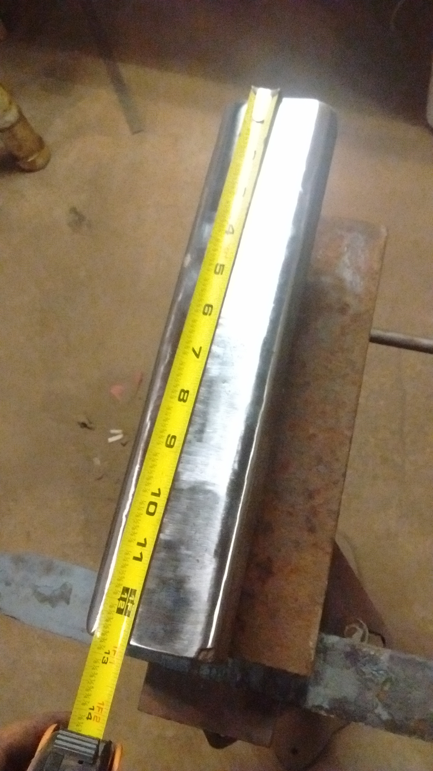

So I made more tools today from the same steel from the scrap yard. I made a Brazeal style hot cut hardy, a radius block with some nice flare on the base, some 1/4" flat bit tongs, 5/8" bolt head tongs, and some 1/2" duck bill tongs. The only picture that came out well was of the radius block, so here it is. I'll get better pictures of the rest later this week.

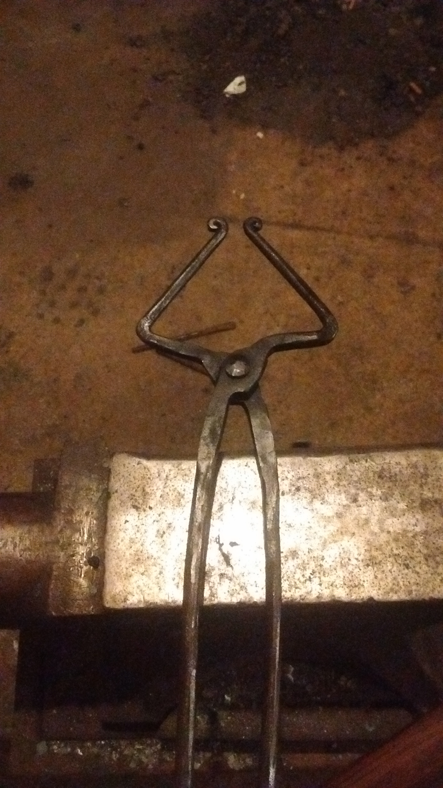

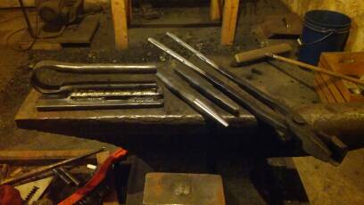

Today I got my orders for beeswax and a butcher block brush. I had an amazon gift card so that's where I got them. Even though it was no cost to me, I will add that cost to my tally. I spent $30 on them so my set up cost is currently -$20. Aside from that, I went to another scrapyard today and spent $16 on 16 lbs of some H13 plate. So now I am at $36 set up cost. Not too shabby. I am still pounding away on my previous scrap yard stock and made some hammer eye tongs out of the coil spring I had. They came out well and while not entirely satisfied with the result, they work flawlessly so that's the real goal here right? Anyways, here's some pictures of the tongs and a better picture I took of the hot cut hardy I made the other day. Tomorrow I will make a hammer eye punch and start making some stuck tools and soon do a production run on hammers. This will supplement my set up costs nicely provided they sell promptly. To keep things interesting, the first 2 people to message me will get a free (pay shipping) hand forged hammer forged from 4350. Anyways, here's the pics.

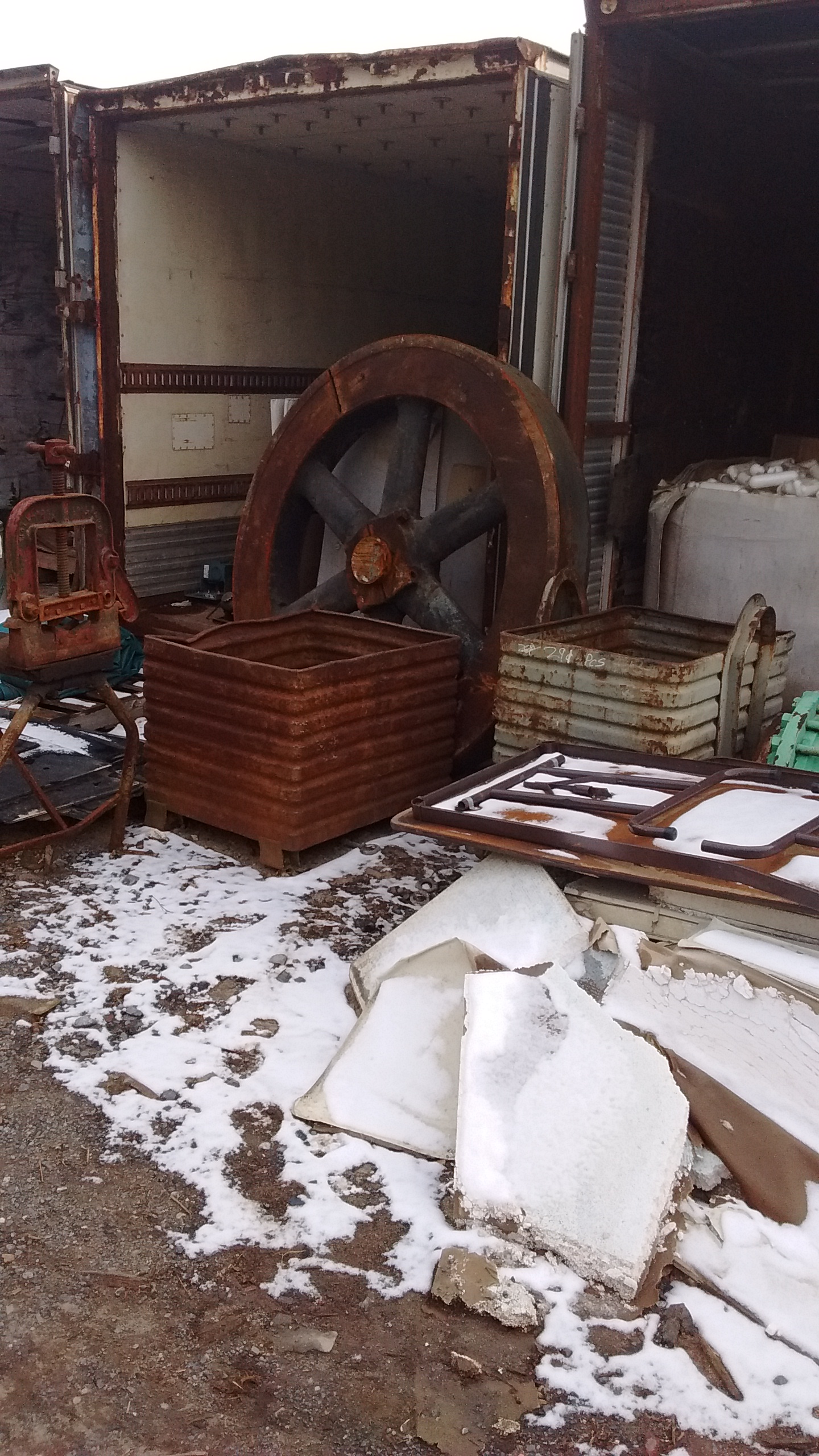

Also, at the scrapyard today, me and JWS found a perfect blower for my new forge and a great flywheel for my fly press build (grin)
