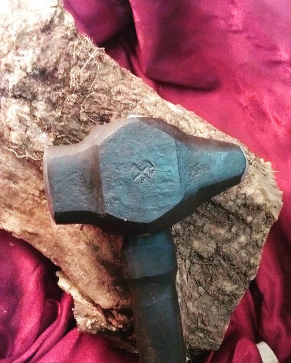

  6. I use my 6 lber and my 3.5 lber the most. That and my 10 and 14. All of them are used daily. I can only find a pic of my 6 lber right now though. Made by me.

  9. that handle gives you 4 different grip points. The bulge on the end locks your hand at the end of the handle (with a loose grip), the bulge in the center is either a forward hand gauge (to feel where your hand is mid swing when changing hold) and also as an intermediate forging point where I put my pointer finger over it (which also encourages and benefits a loose but secure grip), and lastly above the bulge is an excellent placement for planishing blows and the bulge acts as I've already mentioned. Make sense?
  10. Aside from what has been said, loose grip is a must. Add good hammer form (wrist, shoulder, elbow working together with your elbow tucked in to your side) and you should be okay. I designed my handles to encourage a loose grip while still maintaining a solid hold on your hammer. Pictures:
