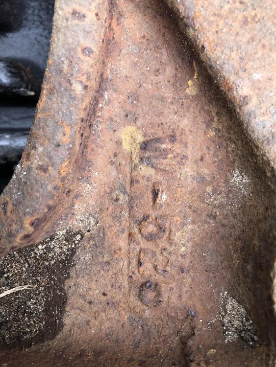

Will Brouwers Posted November 12, 2022 Share Posted November 12, 2022 Picked these up for $60 today. The post vise is a little guy with 4 1/4 inch jaws. It’s overall length is 27 inches, so I’m trying to figure out how to best mount it, including getting a spring and bracket forged. I am hoping that the shear will work for me too. I sprayed it with penetrating oil and will hope for the best. Quote Link to comment Share on other sites More sharing options...
JHCC Posted November 12, 2022 Share Posted November 12, 2022 If I were to come into possession of a 27” tall post vise, I would simply make a robust stand and use it as a striking vise without repairing the leg. Great way to get more power for upsetting at a height that’s more convenient for swinging a heavier hammer. You can use it to hold hardy tools (swages, fullers, hot-cuts, etc) at that height as well. Quote Link to comment Share on other sites More sharing options...
Will Brouwers Posted November 12, 2022 Share Posted November 12, 2022 Ooo!! Good idea! Thank you! Would such a small vise stand up to that kind of beating, I know they are made for heavy duty use, but it looks so frail next to my other post vise. I was also thinking of making it an only outside vise, because when I want to forge right now, I have to haul my big one upstairs. The only thing I really use it for is twists anyways, so I guess having a smaller one would work well. As I have been going over it, I saw that the jaws aren’t smooth, they have lots of teeth for grip. I should probably just leave it like that, right? Quote Link to comment Share on other sites More sharing options...

JHCC Posted November 12, 2022 Share Posted November 12, 2022 I wouldn’t put a four-person sledgehammer team on it, but you should be okay for most work. One of Alec Steele’s earlier videos showed a shorter vise he was using for striking and grinding; the relevant section starts around the 3:30 mark: https://youtu.be/_4ZE1AnCHVw Quote Link to comment Share on other sites More sharing options...

Cavpilot2k Posted November 15, 2022 Share Posted November 15, 2022 Question for the gallery about that post vise above: I see it is missing its normal spring. I have one a friend gave me for free that is also missing its spring. My plan has been to fabricate a new spring from a length of good steel, heat treat it, and bring it to a nice blue/purple temper for springiness. For Size and shape of the spring, I will just mimic the spring on the intact post vise I have. Are there any pitfalls with this plan that I don't foresee? Quote Link to comment Share on other sites More sharing options...
Les L Posted November 15, 2022 Share Posted November 15, 2022 Cavpilot, you can use a piece of mild steel flat bar to make the spring, it doesn't need to be special steel or heat treated/tempered Quote Link to comment Share on other sites More sharing options...
Frosty Posted November 15, 2022 Share Posted November 15, 2022 You need to make the spring fit the vise it's going into, the width of the jaw the U bracket fits over that holds the spring and mounting plate is the most critical followed by length. It doesn't take much rebound strength to open the jaw, mild is usually plenty. If the pivot bolt and hole is sticky it MIGHT take something springier. I lucked out by having a trailer spring almost exactly the right width, a smidge narrower so only had to bend the L at the bracket end and cut to length. If the jaw moves easily, as forged and bent mild is plenty of spring. Frosty The Lucky. Quote Link to comment Share on other sites More sharing options...
George N. M. Posted November 15, 2022 Share Posted November 15, 2022 As Les and Frosty have said, you don't need to go to the amount of work you describe. All the spring has to do is push the moveable jaw back about 5 degrees as you open the vise. Then, gravity takes over to move it with the screw. Also, you don't want a strong spring to have to compress as you are closing the jaws. "By hammer and hand all arts do stand." Quote Link to comment Share on other sites More sharing options...

Daswulf Posted November 16, 2022 Share Posted November 16, 2022 10 hours ago, Cavpilot2k said: spring from a length of good steel I made one from a thinner smaller trailer leaf spring chunk. Forged to the shape of an existing one on another complete vise I have and just air cooled (as in tossed on the concrete floor once done to cool.l works perfect. Mild would work but I had the leaf spring steel in close to shape so cut, forged and used it. Don't go overboard, it just needs to push the jaws apart initially. After that gravity usually takes over. Posted before I read George's wise reply. Quote Link to comment Share on other sites More sharing options...
Irondragon Forge ClayWorks Posted November 16, 2022 Share Posted November 16, 2022 This one is made from wrought iron normalized. The important thing is the pivot point is not tight, I had to loosen up the nut and oil the joint. Works like a charm. Quote Link to comment Share on other sites More sharing options...
Cavpilot2k Posted November 16, 2022 Share Posted November 16, 2022 Thanks all for the input. I do have some spare old leaf spring lying around, so I will still probably use that, but I won't overdo it. Quote Link to comment Share on other sites More sharing options...
Jobtiel1 Posted November 16, 2022 Share Posted November 16, 2022 I also made mine with leaf spring. I didn't heat treat it and it works perfectly fine. ~Jobtiel Quote Link to comment Share on other sites More sharing options...
