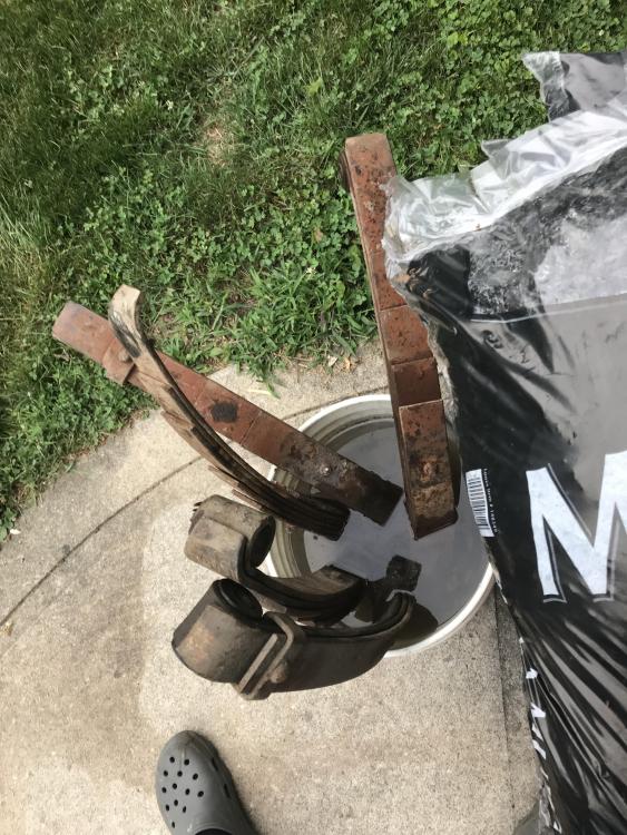

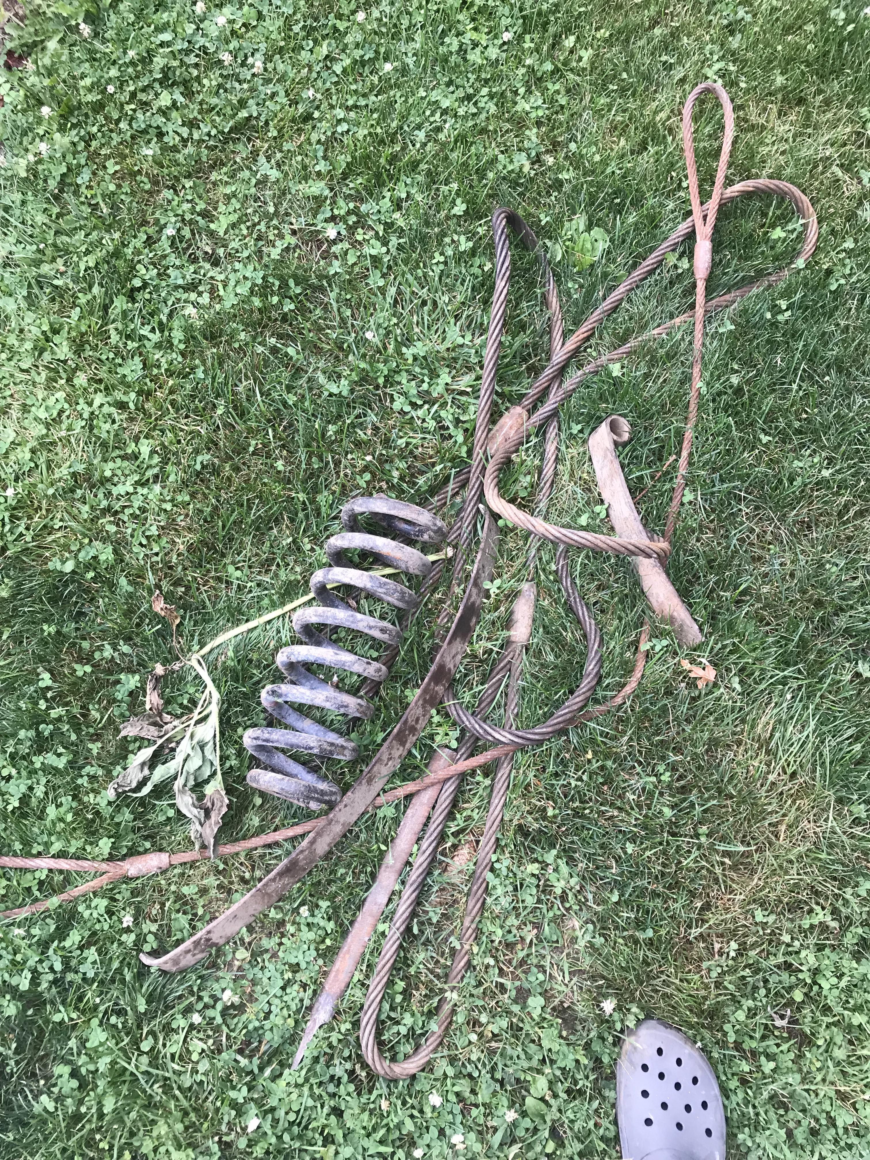

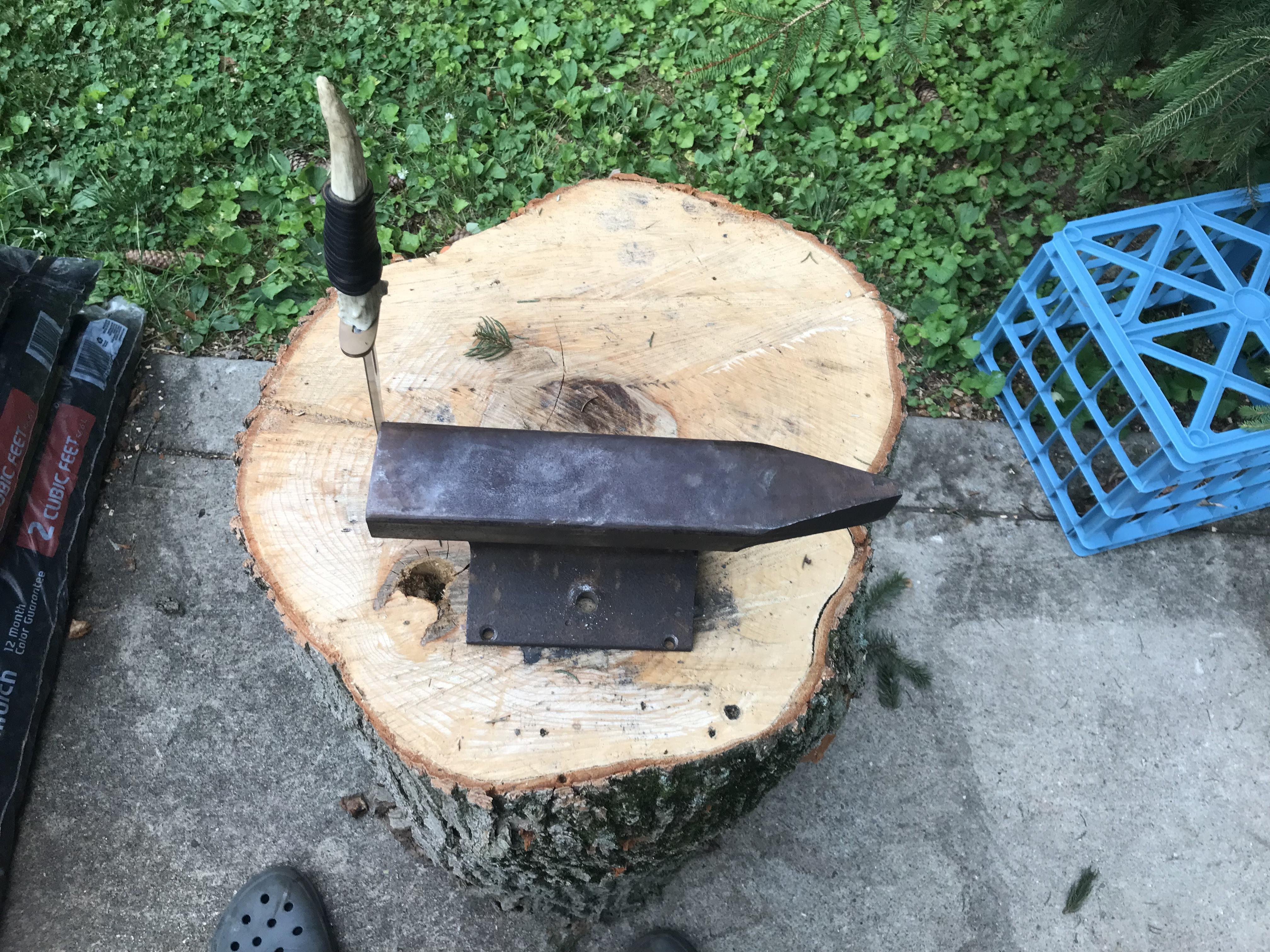

Chimaera Posted July 8, 2021 Share Posted July 8, 2021 Got some good stuff in the past couple days. Neighbor had a tree cut down and I made a big upgrade in anvil stands. Went from two rotting pieces of pine strapped together to a several hundred pound maple log. Has plenty of room for my eventual anvil upgrade. Visited the scrapyard for the first time and ended up with 140 lbs, mostly leaf spring with a big coil, some cable, and a huge file. Ended up costing $0.50/lb. more than I would’ve liked, about what I expected. Should last me a very long time once I break it down (a task I do not look forward to. Time to get an abrasive chop saw?). Quote Link to comment Share on other sites More sharing options...
JHCC Posted July 8, 2021 Share Posted July 8, 2021 A chop saw is safer, but a hefty angle grinder has more uses. Quote Link to comment Share on other sites More sharing options...
Chimaera Posted July 9, 2021 Share Posted July 9, 2021 Unfortunately, I’m probably going to end up doing it with a 4.5” AG Quote Link to comment Share on other sites More sharing options...
JHCC Posted July 9, 2021 Share Posted July 9, 2021 Just wear your PPE. Quote Link to comment Share on other sites More sharing options...
