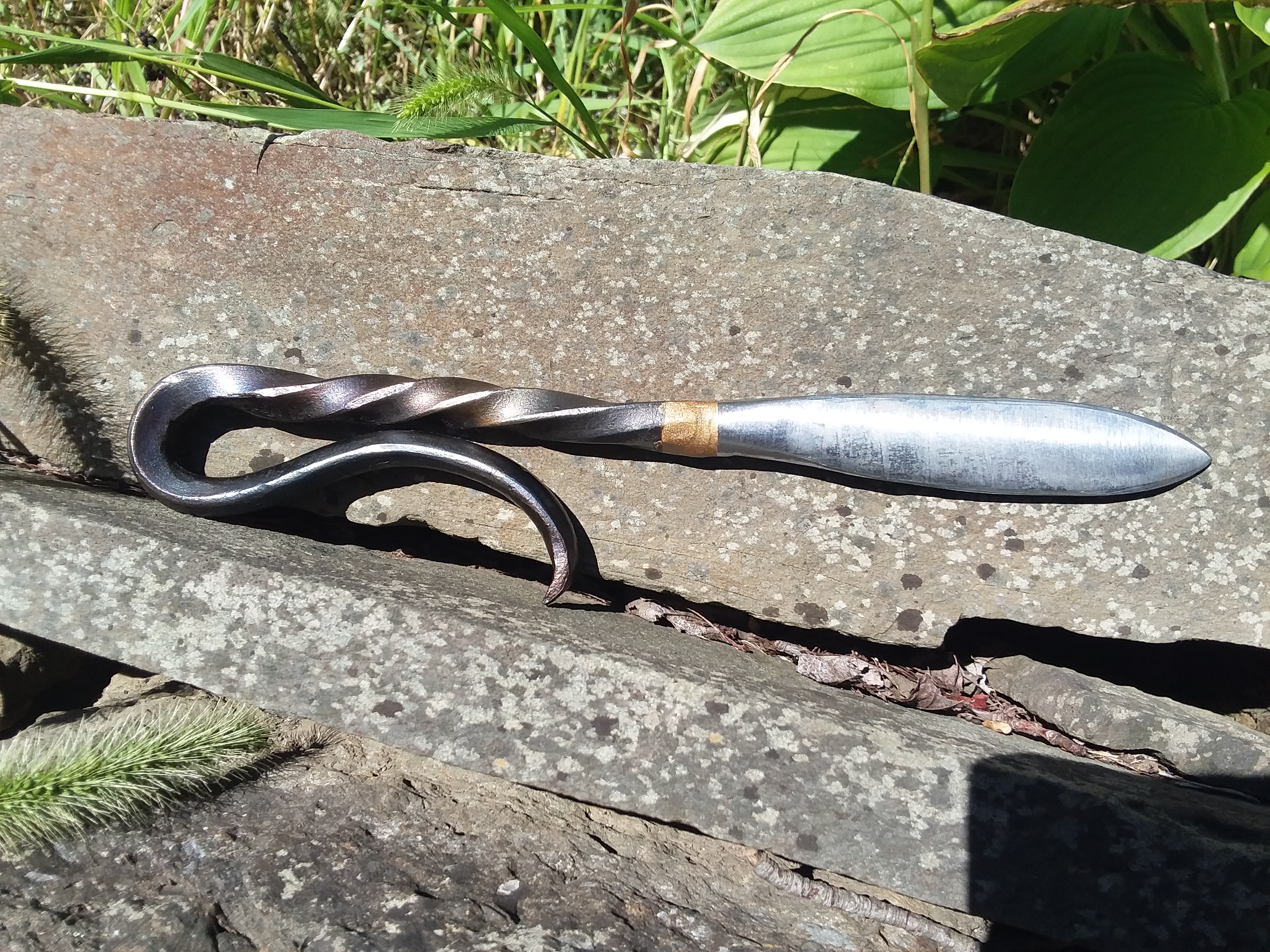

Justor JeiGallo Posted September 10, 2022 Share Posted September 10, 2022 TwistedWillow, this looked like fun when you posted it, so I gave it a try. Here's my entry: My first ever knife-shaped object (letter opener) is mild steel derived from the classic "blacksmith knife" design, handle hot-coated with goop and some champaign bronze Rustoleum on the transition between blade and handle. Hope you all like it. Link to comment Share on other sites More sharing options...
TWISTEDWILLOW Posted September 10, 2022 Author Share Posted September 10, 2022 Very nice Justor! That’s an awesome twist you put in there! Link to comment Share on other sites More sharing options...

BillyBones Posted September 10, 2022 Share Posted September 10, 2022 Justor, nice work. Blue, learning things and seeing others ideas is what it is all about. Link to comment Share on other sites More sharing options...
Justor JeiGallo Posted September 10, 2022 Share Posted September 10, 2022 It was definitely a learning experience. I've done basic twists before, but had never drawn out a blade area, so I did a 3" test blade first leaving it on my bar stock and practiced with the 1x30 belt sander I picked up at a yard sale. Originally I wanted the curled taper on the handle to be a thumb rest, but I didn't draw it out enough. This actually works better as there is a spot where the twist ends and transition begins that allows the thumb to rest perfectly, and the curve fits my hand almost perfect. The handle could be a TAD bit longer. I also learned how to make the oval draw out from square which I absolutely love with the curvature. Link to comment Share on other sites More sharing options...
TWISTEDWILLOW Posted September 11, 2022 Author Share Posted September 11, 2022 3 hours ago, bluerooster said: I guess I'll jump in on this as well Awesome glad to see you join! Cant wait to see what you come up with! Justor, I love it just they way it is! id be proud to use that letter opener any time! Link to comment Share on other sites More sharing options...
Irondragon Forge ClayWorks Posted September 11, 2022 Share Posted September 11, 2022 I agree a first class letter opener, one that will inspire others. I had thought about making one like that as the blacksmith/ Viking ladies knife are one of my favorite styles. Top notch Justor you should be proud of yours. Link to comment Share on other sites More sharing options...

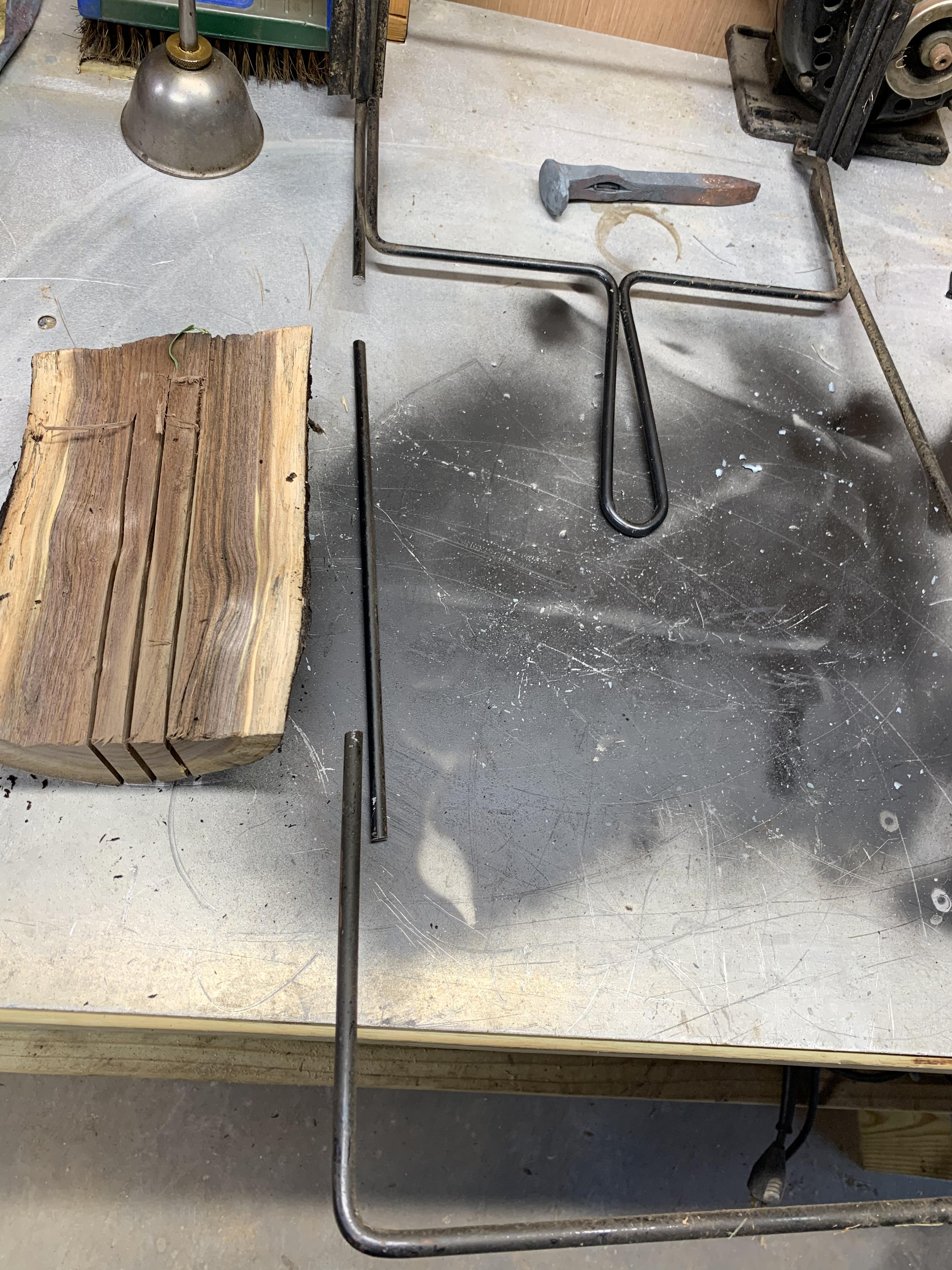

PCRDNADave Posted September 11, 2022 Share Posted September 11, 2022 On 9/10/2022 at 1:22 PM, Justor JeiGallo said: TwistedWillow, this looked like fun when you posted it, so I gave it a try. Here's my entry: Justor, that has a nice look to it. I’ve never made a knife either and I went simple but I like what you did better. I just flattened some round scrap and had a few simple goals: 1 end up with something that looks like a knife 2 get a handle attached that will stay attached 3 don’t cut myself It’s not finished yet I have the handle drying after using some JB weld epoxy and then I’ll need to do some final sanding and finish. it doesn’t feel like I did much forge work so I’ll probably try something else in addition to this. Link to comment Share on other sites More sharing options...
Justor JeiGallo Posted September 12, 2022 Share Posted September 12, 2022 Dave, I think you did great with that. You drew that bar out better than I could have at this point. I think your blade will probably cut better too. Link to comment Share on other sites More sharing options...

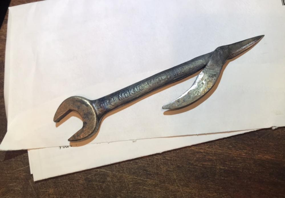

Rojo Pedro Posted September 12, 2022 Share Posted September 12, 2022 Good work everyone. Mine works but barely. My thought was a little tape cutter up front, which works fine, and a pull style opener but it is too small and I cant get it sharp. Forged like mild and wont harden so.. fun to make for sure. Yup its the 9/16” Link to comment Share on other sites More sharing options...
George N. M. Posted September 12, 2022 Share Posted September 12, 2022 Rojo, you might try quenching it in super quench (no tempering). It will not make it as hard as a quenched piece of high carbon steel but it is surprisingly hard. In my experience a file will just barely bite. You can find the recipie by googling "super quench." When I make RR spike knives I will use it because that makes them the hardest that steel can be. "By hammer and hand all arts do stand." Link to comment Share on other sites More sharing options...
Daswulf Posted September 12, 2022 Share Posted September 12, 2022 Good job Dave. Rojo I like the idea. Looks like it would be tough to sharpen. Try dome different grits of sand paper wrapped on the end of a dowel rod. Link to comment Share on other sites More sharing options...
TWISTEDWILLOW Posted September 12, 2022 Author Share Posted September 12, 2022 17 hours ago, PCRDNADave said: just flattened some round scrap Looks good from here! 13 hours ago, Rojo Pedro said: Mine works I like it! Kinda reminds me of a harpoon! Link to comment Share on other sites More sharing options...
PHDforge Posted September 12, 2022 Share Posted September 12, 2022 Nice work everyone, some interesting designs. Rojo, I like the design of the reversed blade. It does look like a harpoon. Cool looking! Link to comment Share on other sites More sharing options...

Rojo Pedro Posted September 12, 2022 Share Posted September 12, 2022 Thanks all. I dream of the White Whale ”..harpoons thrust to the sky!” Link to comment Share on other sites More sharing options...
BillyBones Posted September 12, 2022 Share Posted September 12, 2022 Dave, i like that wood. Rojo, cool idea with the wrench. Buzzkill, some eyes and a mouth on the "ball" end would make it look like a snake. The wife prefers something a bit smaller that a big ol' dagger looking opener so yesterday i tried again to make a more compact one. 3 attempts to get something i am happy with. 1/4" garage door spring. Getting that inside curve sharpened was... not real easy lets say. Dremel tool and a round file. No heat treating. Link to comment Share on other sites More sharing options...
