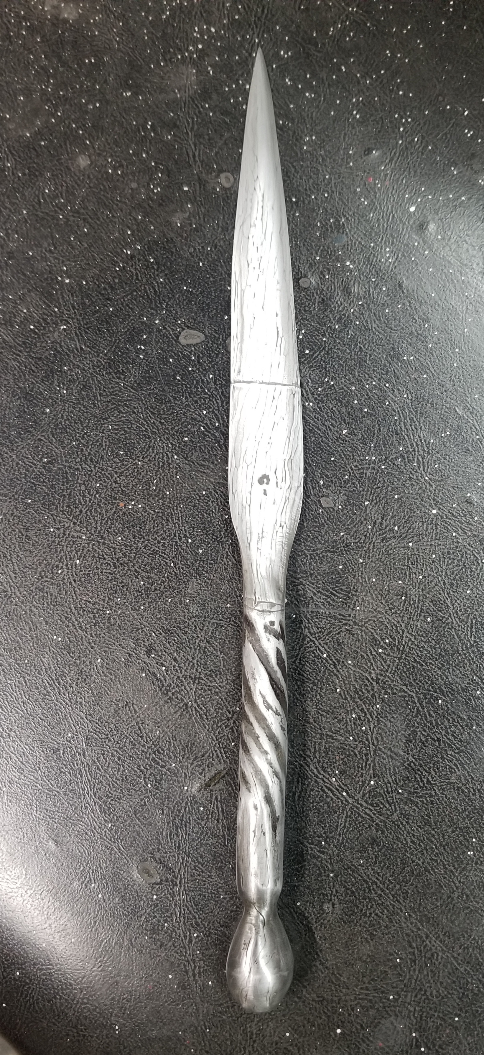

Pounded this out of some leftover cable damascus that was left on a rod from a knife I made. It was getting late and I rushed the ugly twist in the handle And got a little delam. The blade part is fine. The line across the blade goes all the way around. I wasn't getting as good an etch in my home made ferric chloride as I liked so I left it in over night with the handle side down and that line was where the rest of the blade was out of the solution. Doesn't seem to want to break easily and it is good enough for opening letters.
And another lesson or two learned.:rolleyes:
Thanks. I took a picture of the better side :lol:

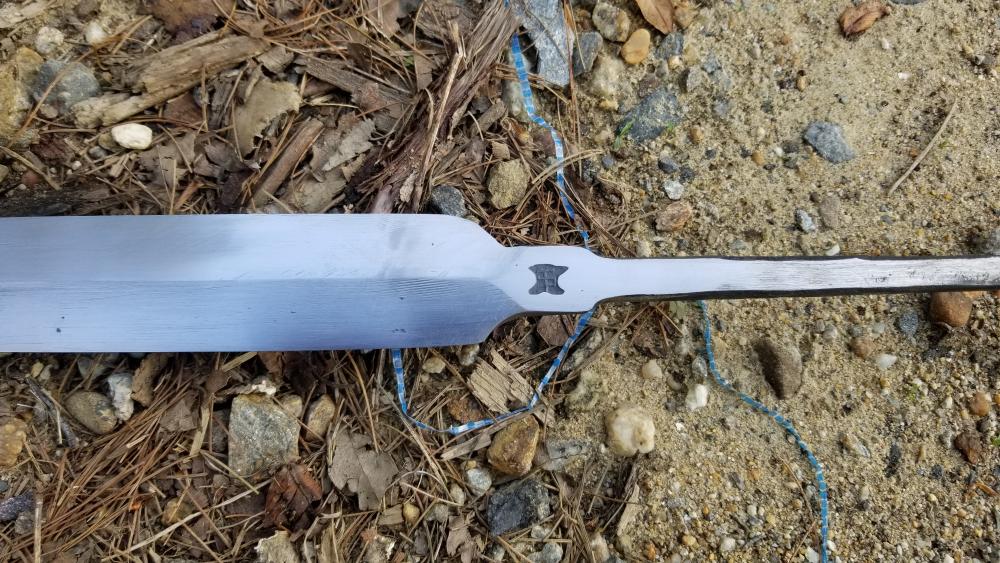

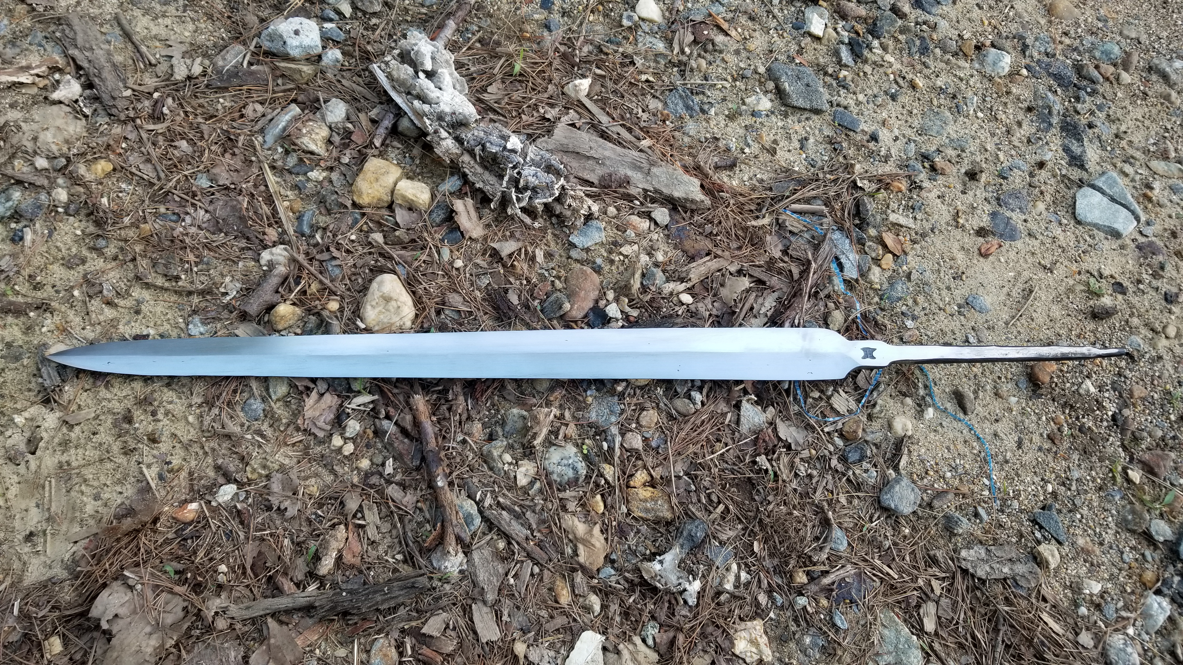

Here is my entry..  Regular sized letter opener..   I just have wee little fingers..  Ha, ha..
Still in design phase, but think I'm getting close.
Oh wow!!!
Jennifer that looks like it’d open up everything from a letter to an envelope to a box to a shipping crate!
it’s awesome!
what are ya thinking about doin for the rest of it? Or is that a surprise?
Its a cane sword blade so will be hidden inside a walking cane..  I'll do follow up thread when it's finished.. I suppose I could start one now..  It's the reason I finished the steeled wrought iron hammer.
I'm pretty sure I have the design for the letter opener.. Maybe this weekend. It will be the first time trying this technique.
Very clean and nice work Jennifer.
Look forward to seeing the sword cane.

Oh MY! That's some bade.
Jennifer, whoever ends up with the sword cane should be aware that in some places a sword cane is considered a concealed weapon.  I heard about one guy who got stopped by TSA at the airport and it was news to him that his cane had a blade in it even though he had owned it for years.

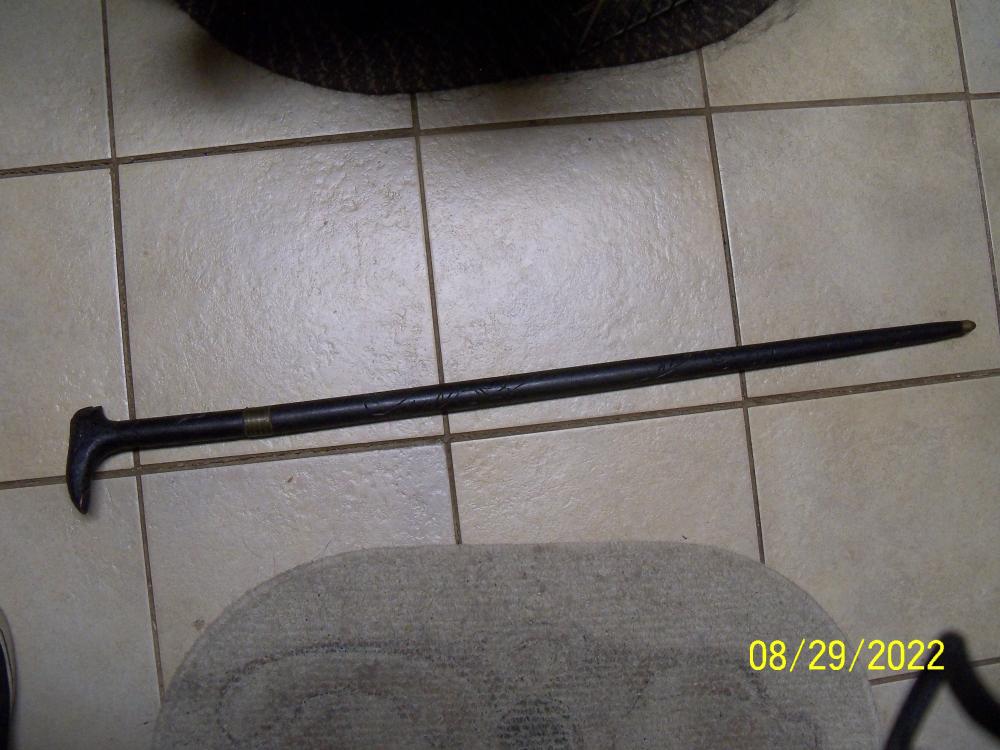

In Arkansas it's not illegal to own one but it is illegal to carry it. I have had this one for decades, don't remember where I got it. A little overkill for opening letters.:D

Nice sword cane Irondragon. I have a super cheap one with a dragon head handle but it is about worthless for how much you have to unscrew the handle and a short flimsy blade.
That one looks quality.
