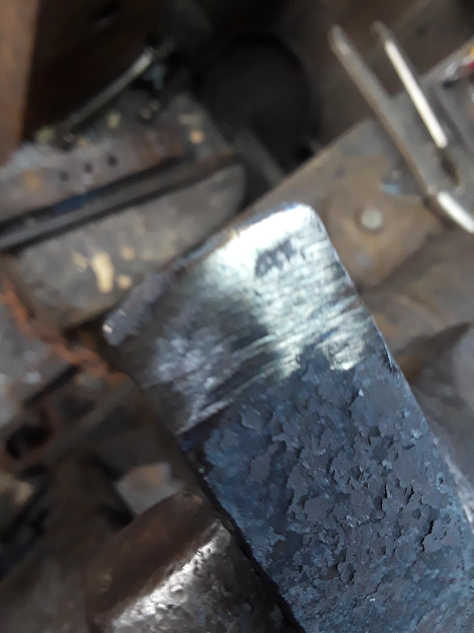

First the heartbreak. Started grinding my slitter and discovered a crack. It is far enough towards the end hopefully i will be able to lop it off and draw it out some more to salvage the piece. I think i worked a little to cold at some point.
About halfway up the grind spot on the left going diagonally towards the end. You can see it good on my phone but not so much here.

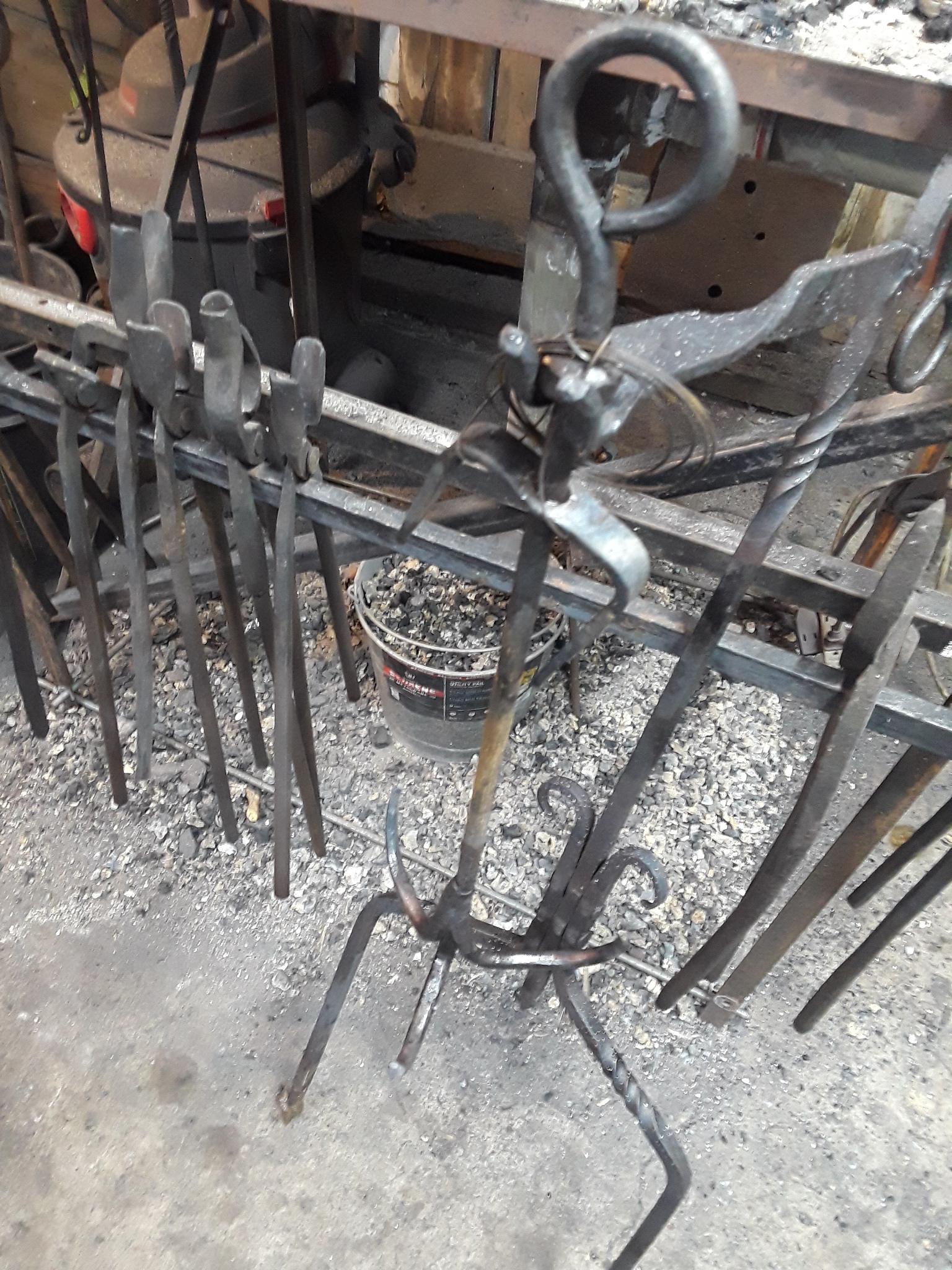

Now the overthinking and not thinking. Made a chicken cooker for the hangy thingy. Was having trouble getting the weld for the treble hook. I figured the 3/8 bar may be cooling to fast and loosing welding heat from forge to anvil. So i put an anvil on my forge (read that as a 15# block of 4140) Put my iron in the fire, set my hammer close, on my tong rack, got my heat, grabbed my iron and then about blistered my hand. Not thinking, Hammer handle that close to the fire gets a little warm.
Overthinking, chicken cooker is basically a vertical spit. Spits have forks for holding the meat when cooking. Spits have a fork on each end. So i made a sliding fork to hold the top of the chicken. Overthinking, how do i get that big fork through the bird? Going to be hard enough for that ring.
The wire was for holding the useless fork back while i was welding the treble.
Would like to give a special thanks to Jenifer, her blacksmiths diamond video gave me the understanding to do the welded collars.  You can see one right below the loop on top. The idea is to be able to turn the hooks so you can get an even roasting.
Also trying out a new finish. It is called Howard's Feed and Wax. A combination of beeswax, carnauba wax, and orange oil and "other ingredients" (what ever they are) Seems to like to go on metal much cooler than other stuff. Gives more of a silvery black finish also.
I also made a hook, no pic, for grabbing the top loops to turn or remove the meat from the hangy thingy.

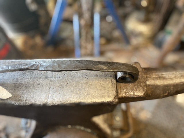

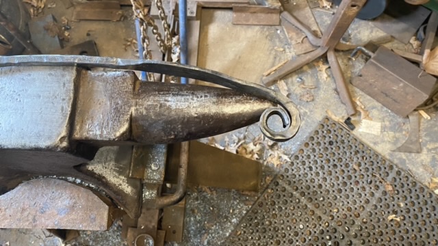

Since I’m probably going to be doing more stick welding in the near future, I decided to make a chipping hammer.

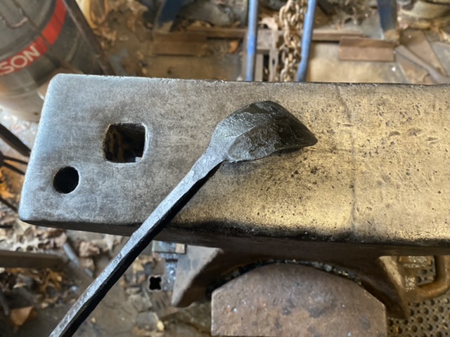

And a backscratcher:

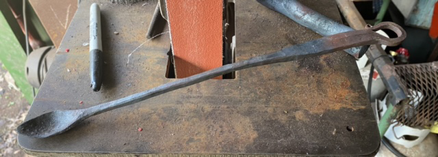

I also drew out the stem of my flux spoon to make it long enough to use without burning my fingers, forged out a square punch, and experimented with ways to straighten Pandrol clips.
(To be clear, the decision to make a backscratcher has nothing to do with the increased likelihood of my doing more stock welding.)

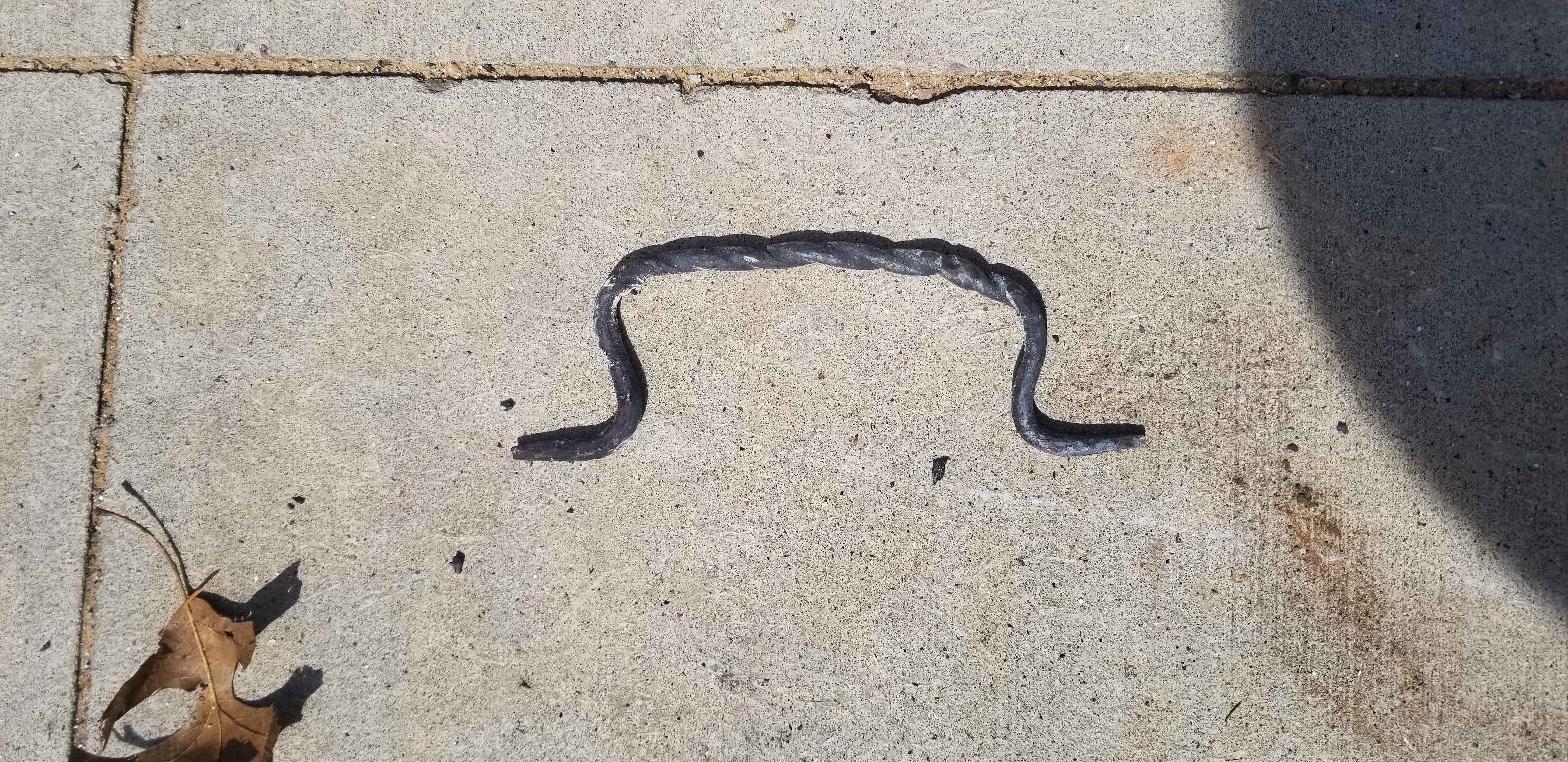

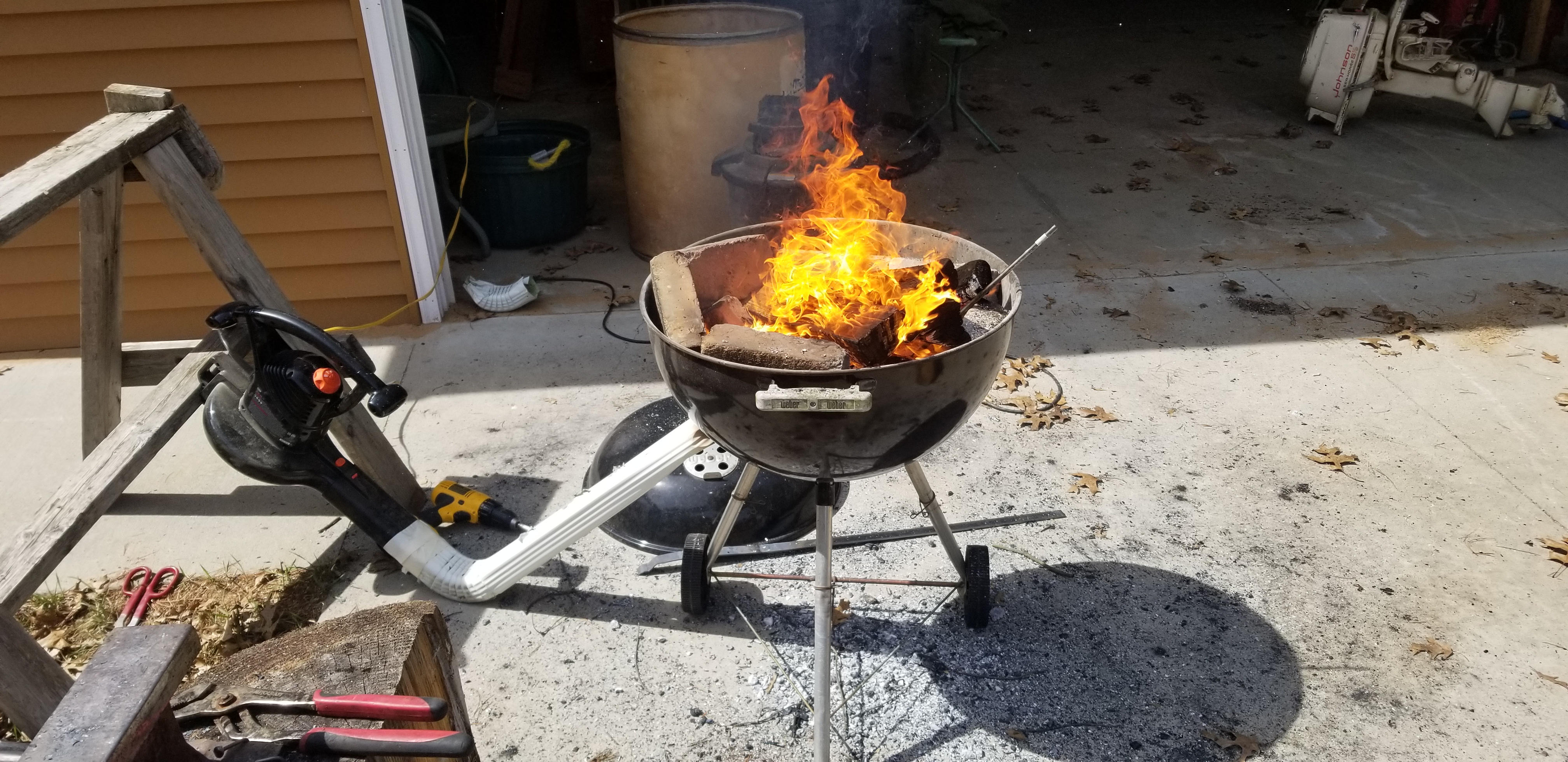

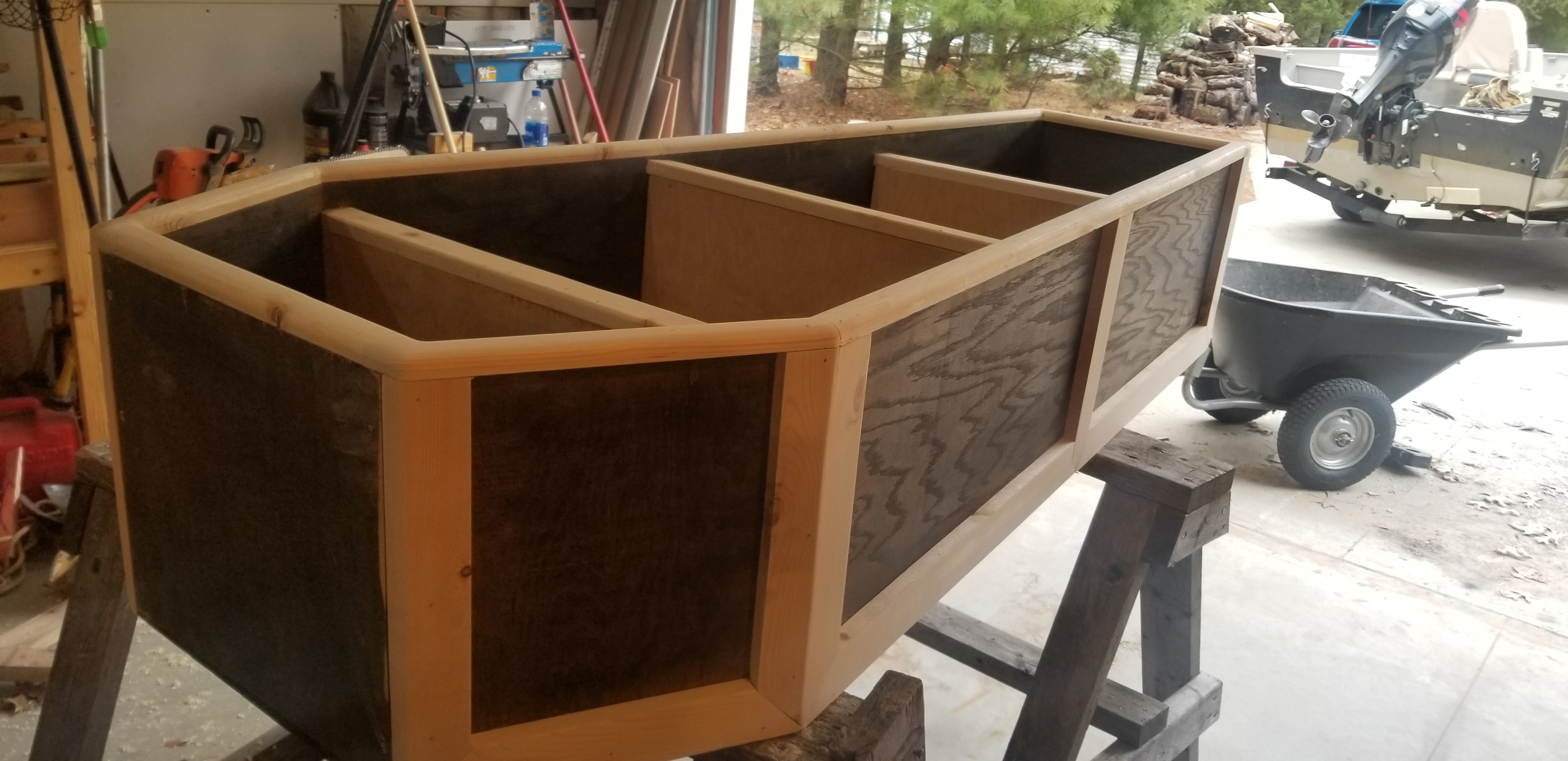

I was scrolling through Facebook today and what should come up but a reminder of a post from last year.   It was my first attempt at forging anything.   It had my make shift charcoal forge my railroad anvil and what I made.  I was at the time attempting to make handles for a book case I made for my youngest daughter.   I'll attach pictures of all.  I've spent some money since then.   You'll see I'm using a set of channel locks for tongs.  I've come a little way since then.

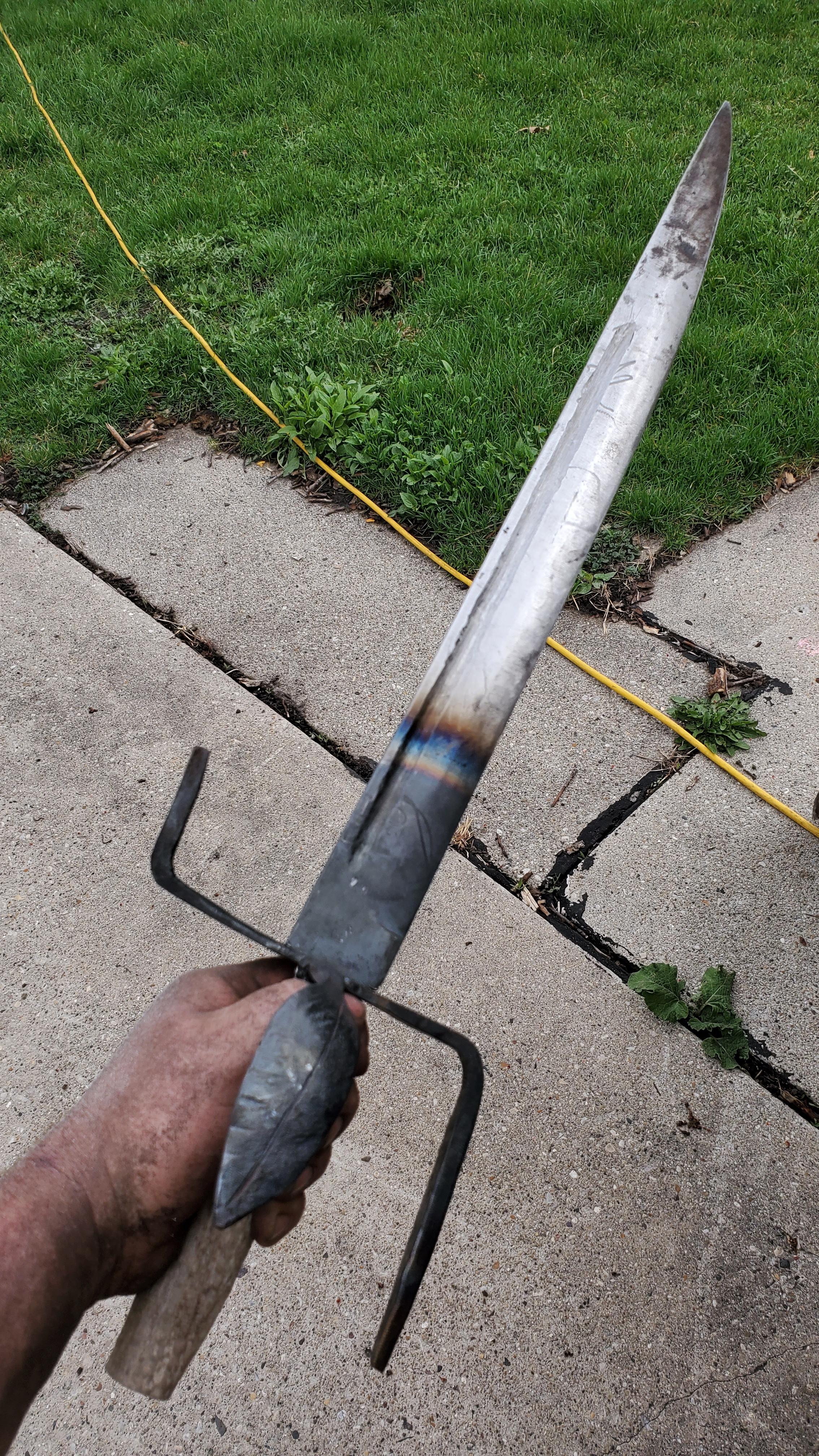

Oh, and what I was working on today is at the bottom.  Fitting the guard and handle on my short sword.  More on that in the sword thread.

JHCC- Though I didn't connect it to the stick welding, I did make an erroneous mental connection between the very vaguely spoon shaped object on the anvil and the longer handled flux spoon. I thought that perhaps you had made the handle a bit longer than necessary.
Haha! No, that's the business end of the backscratcher!
Chad J- beautiful work. Looks like you've come a long way. I must ask- why are you constructing a coffin? Especially one with so many compartments?

Cool casket book case. Book Coffin? I've seen row boat book cases but I think this is the first book coffin. I like it.

Chimera, my youngest daughter is into the goth scene and asked for a coffin shaped bookshelf, she wanted it stained completely black though I preferred the natural accents.  Also thank you,  I'm getting excited about finally finishing that blade though now I have to figure out a pommel.
Frosty, thanks!  I've toyed with the idea of making and selling those.  It seems like there are a lot of people who just want Halloween all the time now and it was a fairly simple build.  But that'll be when I get the shop set up completely.
Oh! I wasn't sure if it was supposed to looks like a coffin, or if it was just accidental. Either way, I definitely prefer the natural wood accents. It looks great!
I've seen a number of designs for bookcases and various cabinets that ultimately convert to caskets (the straight sides being better for this purpose than the tapered sides of a coffin). Oddly enough, the cabinet designs seem to favor liquor and guns, a combination that could indeed lead to an accelerated need for their alternate use.

And here it is. The section between the handle and the bowl has been drawn out to about half again its original length.
JHCC, what was the original piece? Bar stock square sock?
I made a new quench tank for longer blades.  It's 4 x 4 x 36 inches tall so I don't think I'll have to make another unless I start making sabers.
I honestly can’t remember — I first made the spoon a while back, before I started using a gas forge. Maybe 1/2” or 3/8” round?

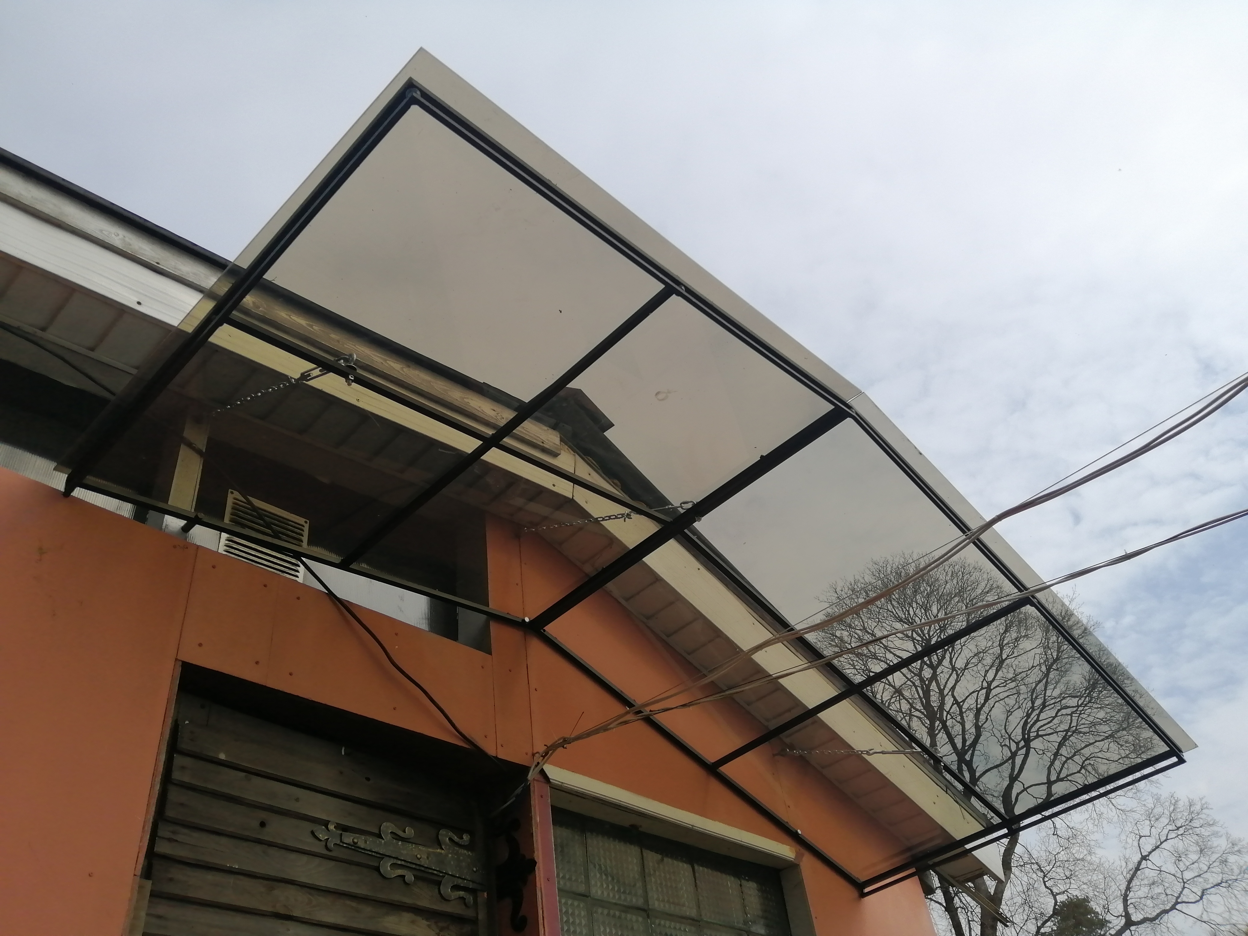

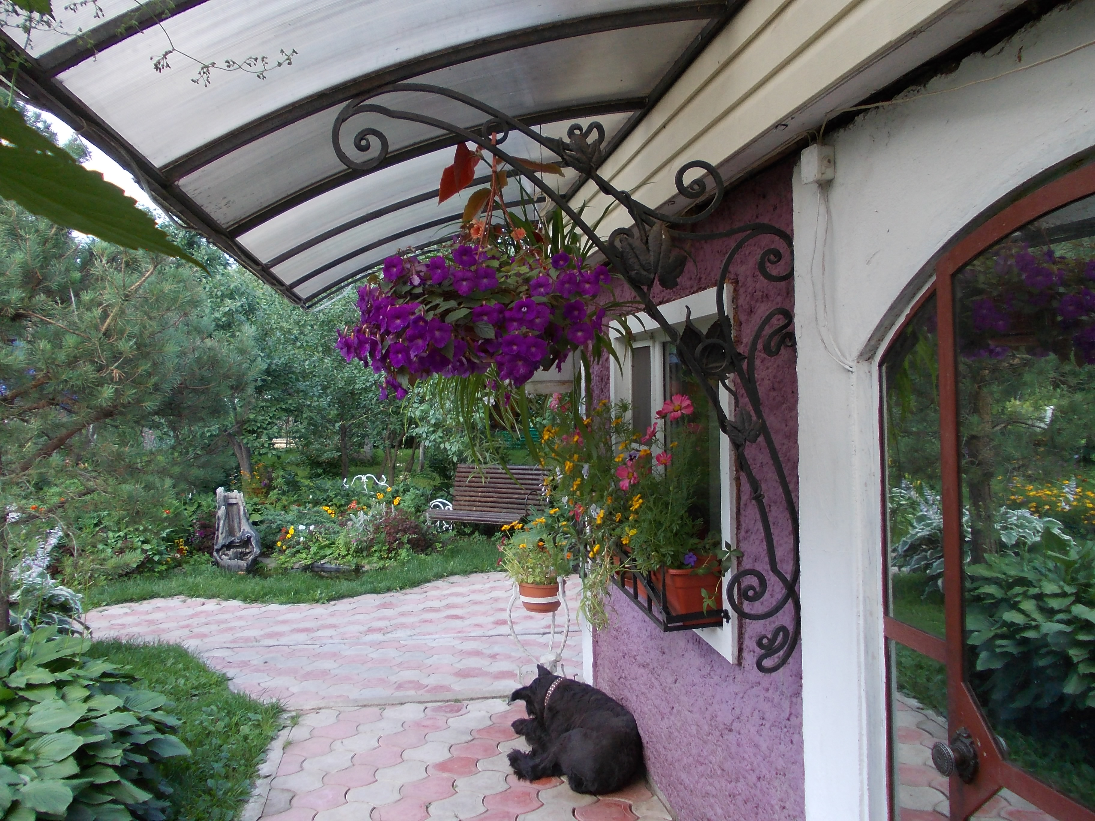

Made a canopy from production waste over the entrance to the workshop.
Somewhat more minimalist than your usual offerings.

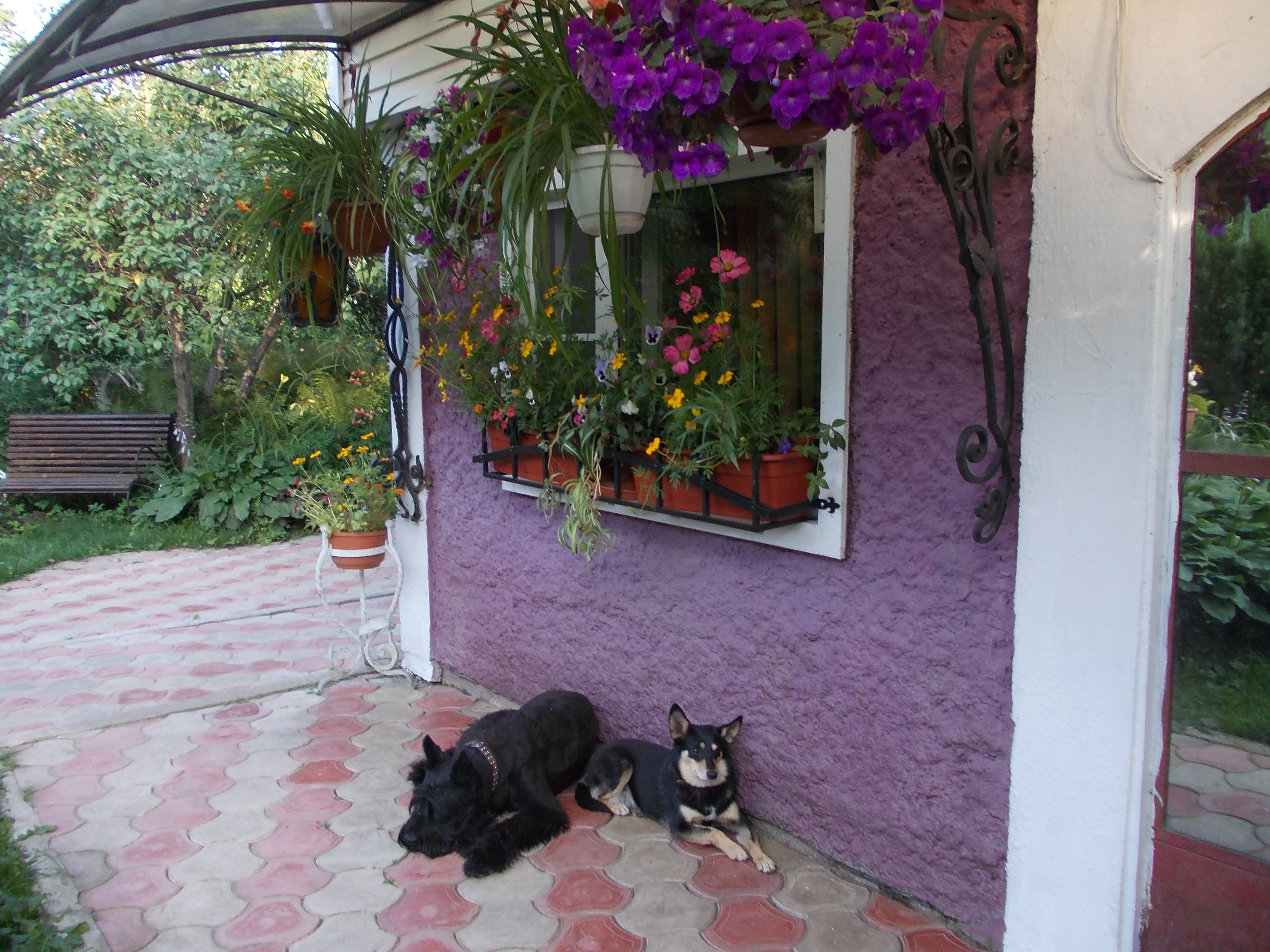

I did it on purpose. I plan to plant flowers like on the house.
