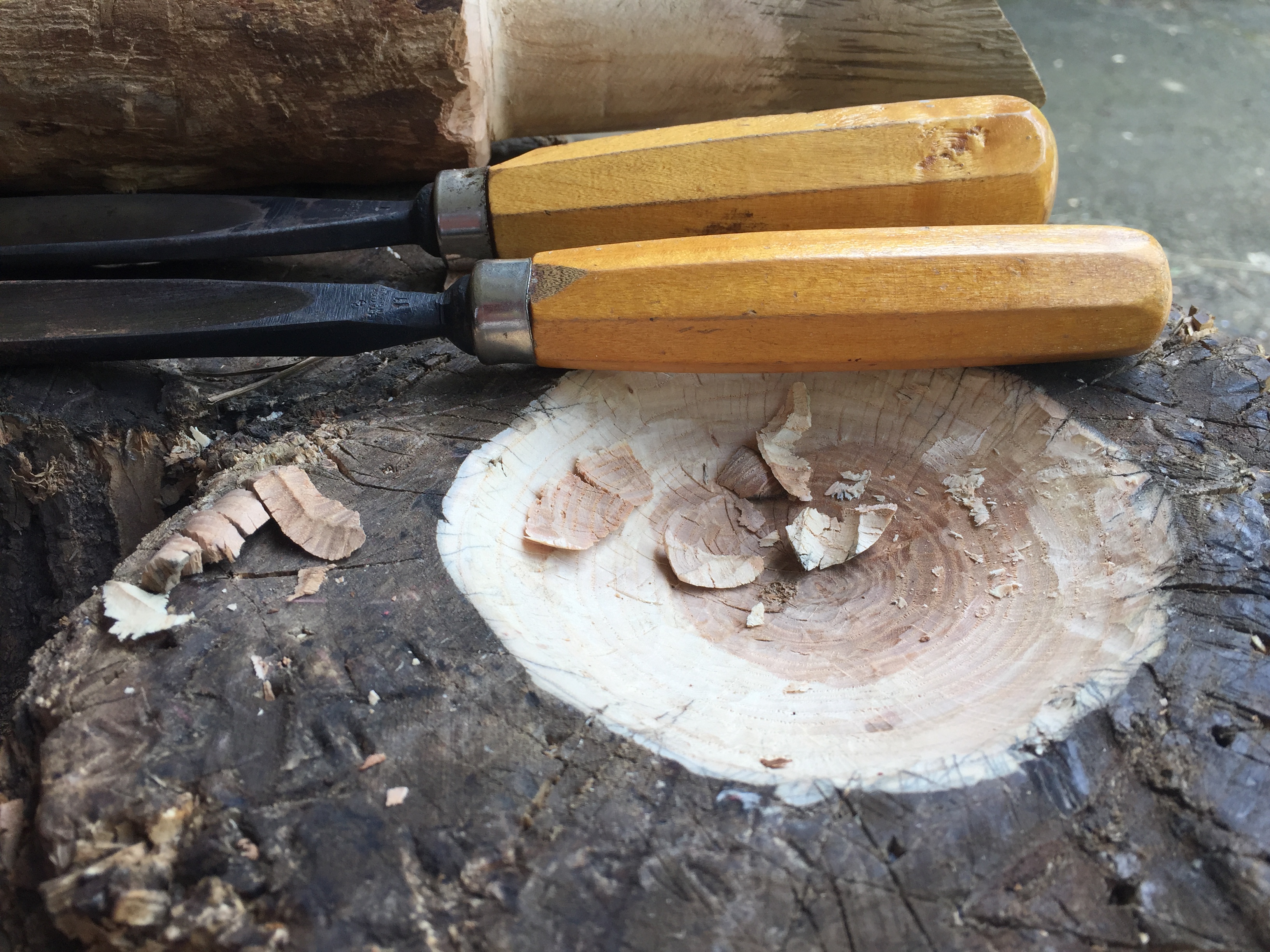

 Today was mostly gardening, but I did carve a dishing hollow into my old anvil stump.

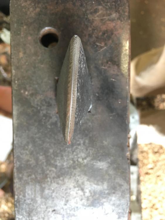

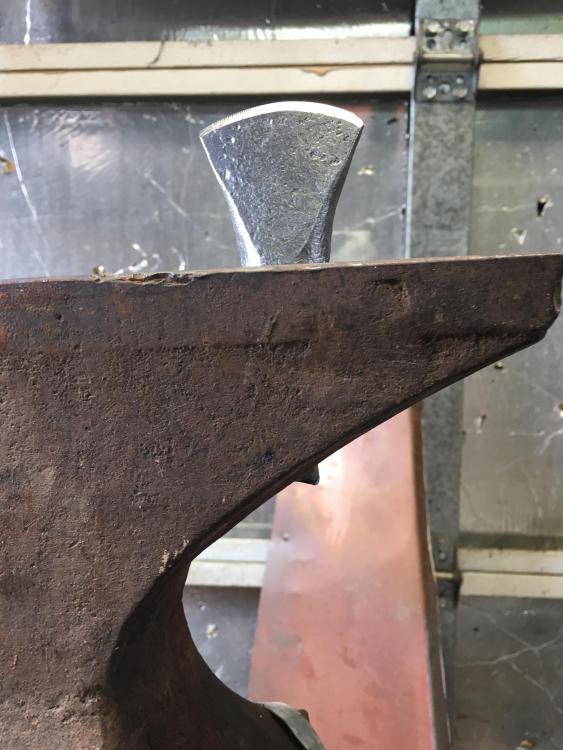

I made a mediocre (first attempt) hot cut today using some mystery steel. Also, I failed miserably at trying to make a cylinder for a candle holder I was working on. Only after shutting down for the day did I realize that I have cylinders of steel just the right diameter just needs to be cut to length, I have some pipe that would be almost perfect. At the end I included pictures of the ends of the mystery steel I made my cut off from if anyone can clue me in as to what it was before I started cutting it to use.

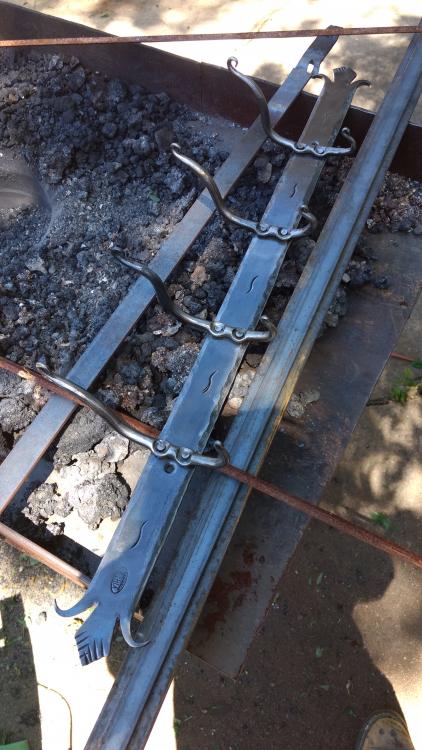

Finished a coat/ key hanger as a housewarming gift for my brother and his wife, and got started on a couple coat hangers for a friend's mom
Michael: The profile looks good but you'll have better results if you keep the scale brushed off while forging so it doesn't leave such deep pitting.

Michael Cochran: looks like someone re-purposed an axle or perhaps PTO spline into a digging bar to me. Which would make your hardy a third-hand use, or would that be second tier up-cycling?
I need to brake down and buy myself a proper brush. The cheap grill cleaning brushes just don't cut it half the time.
Thanks for the insight. I figured it had to be decent steel since it had the splines. I thought it could possible been an axle but wasn't sure. To clarify on it a little, the main body is a solid 1" round and it was about 40" long. I'll see how this holds up and if it turns out decent I'll see about making some special purpose little hammers from the same bar.
