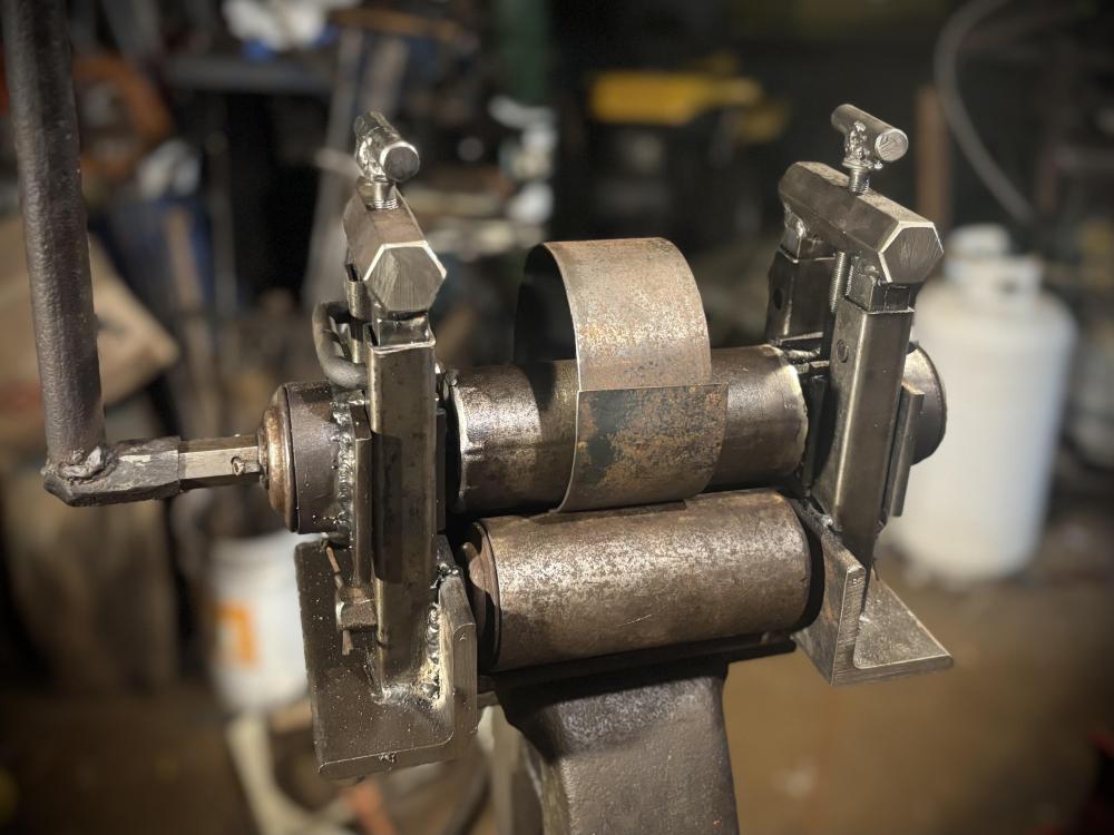

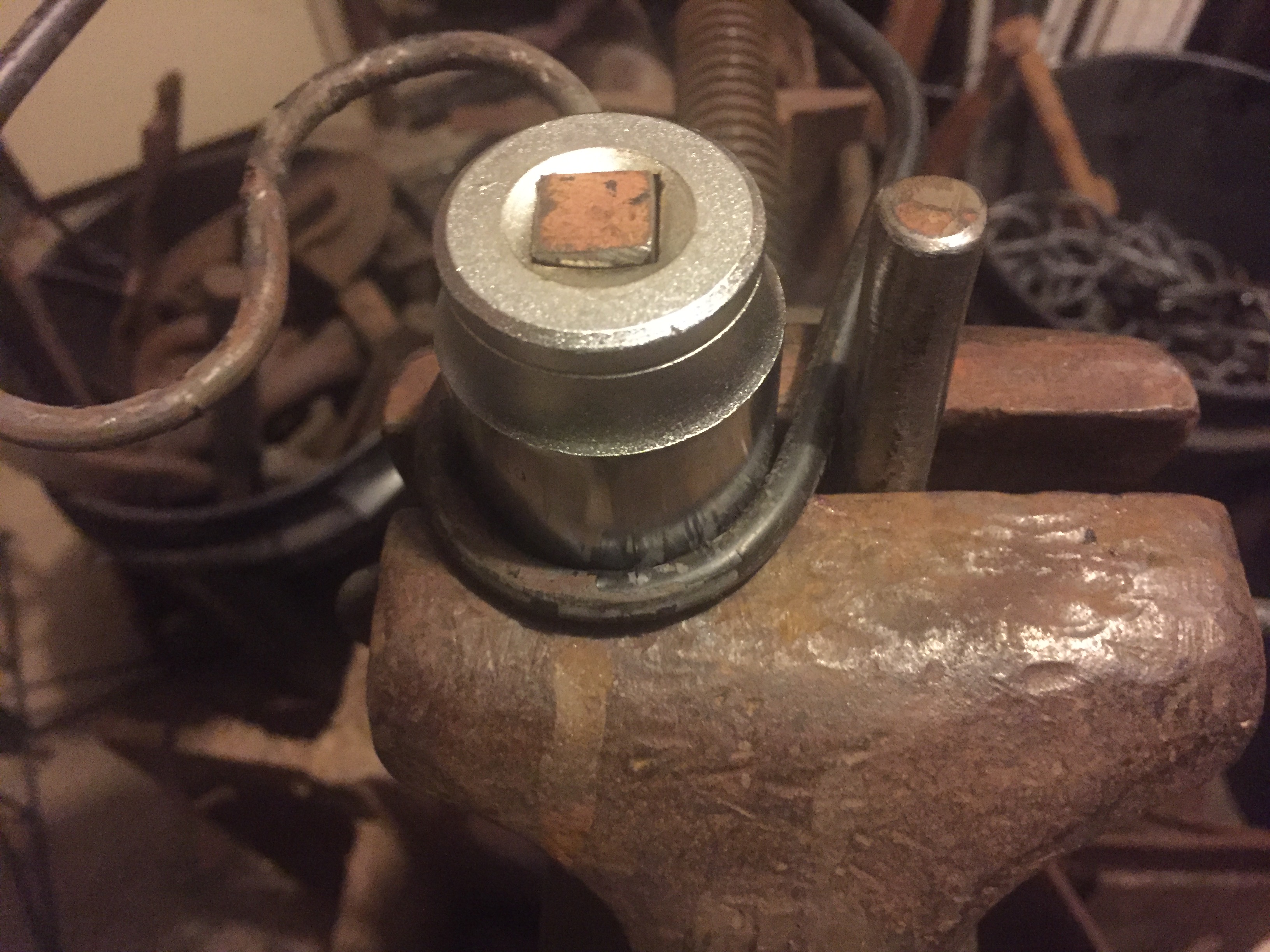

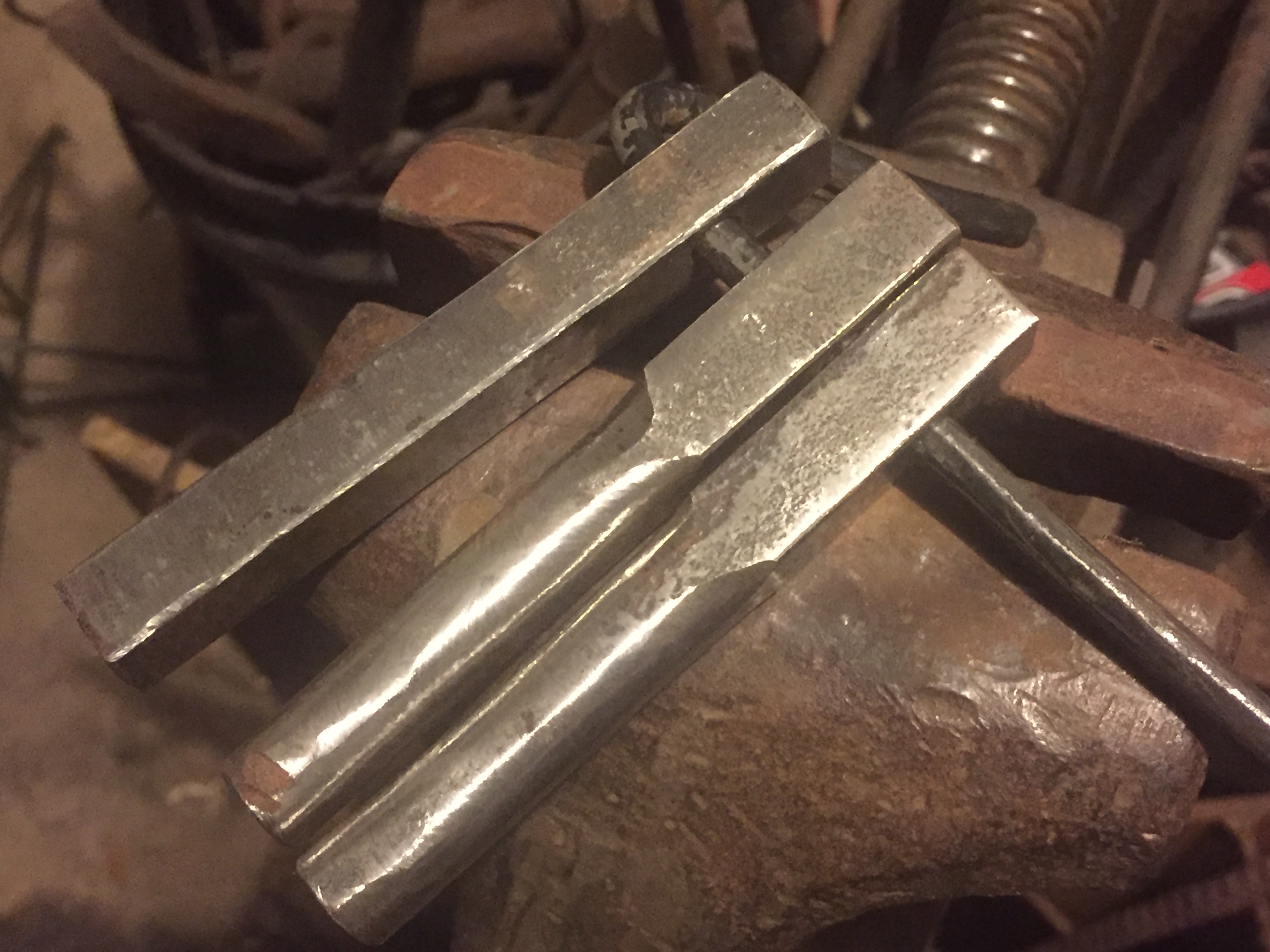

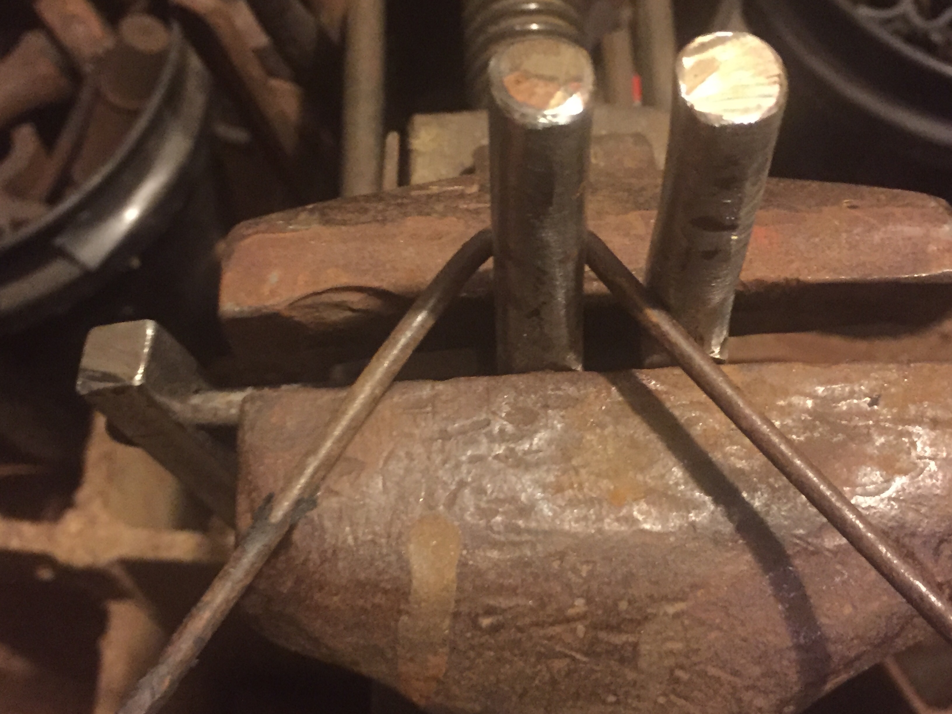

Here are some photos of the bending jig.
Three 1/2" posts: one square, two round.
Set up as a bending fork for scrolling freehand:
Set up with a 1/2" drive socket as a fixed-radius jig:
When I get a chance, I think I'll weld these to some bits of angle iron, for a bit more stability and ease of adjustment.

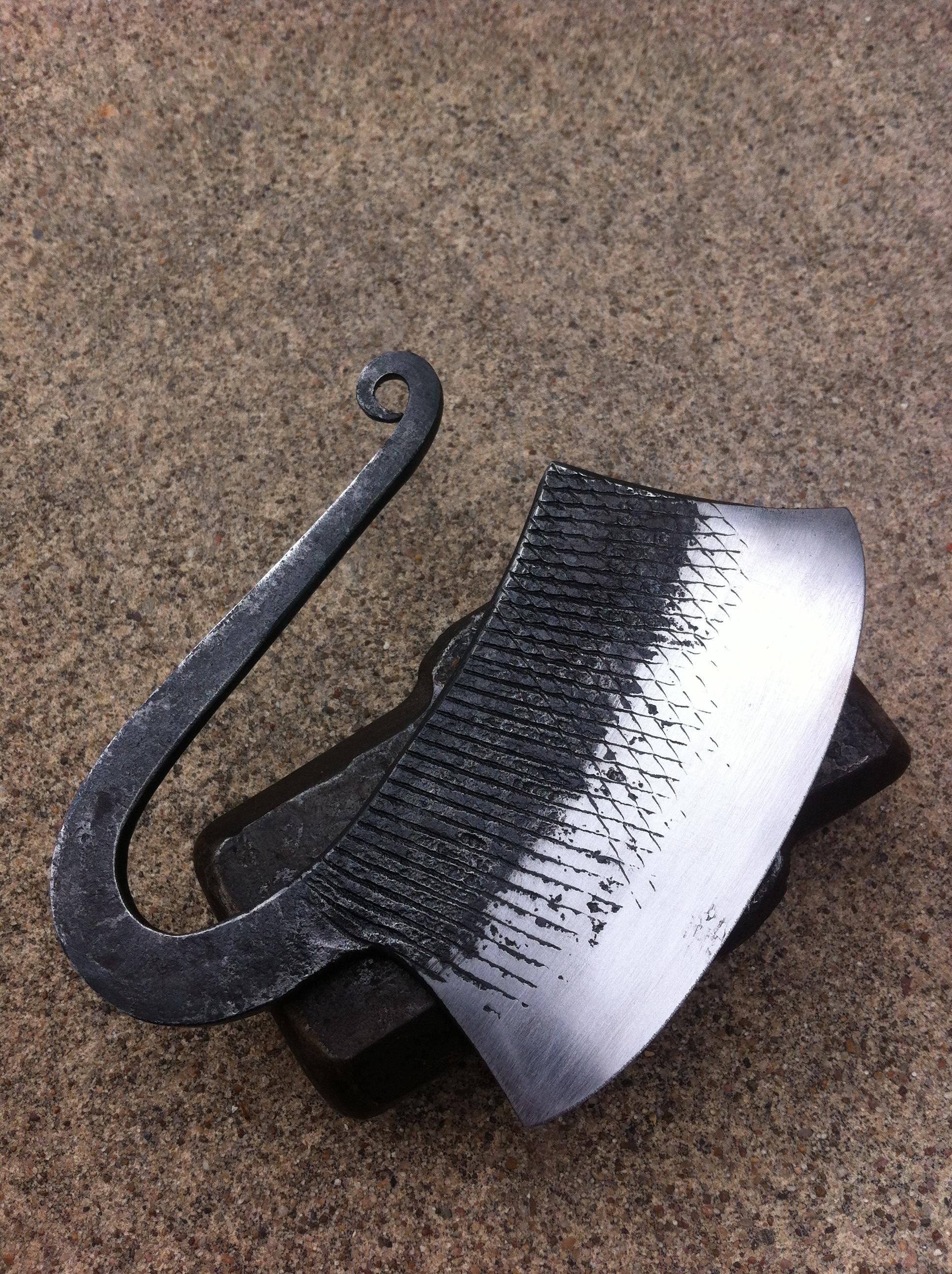

So I was going to build a forge but a friend near me let me borrow his. This is the fruits of day one. That is an oak board handle with brass pins. The finished looking one is quenched (while the other one isn't) and and now skates a file with a fine edge to match. Slices some water bottles and thick cardboard clean like it wasn't there. Also I think I'm now addicted. It's just simple, clean fun. I have some stock welded together and I think I'll try forge welding next. Also I love that I got two whole knives per file.

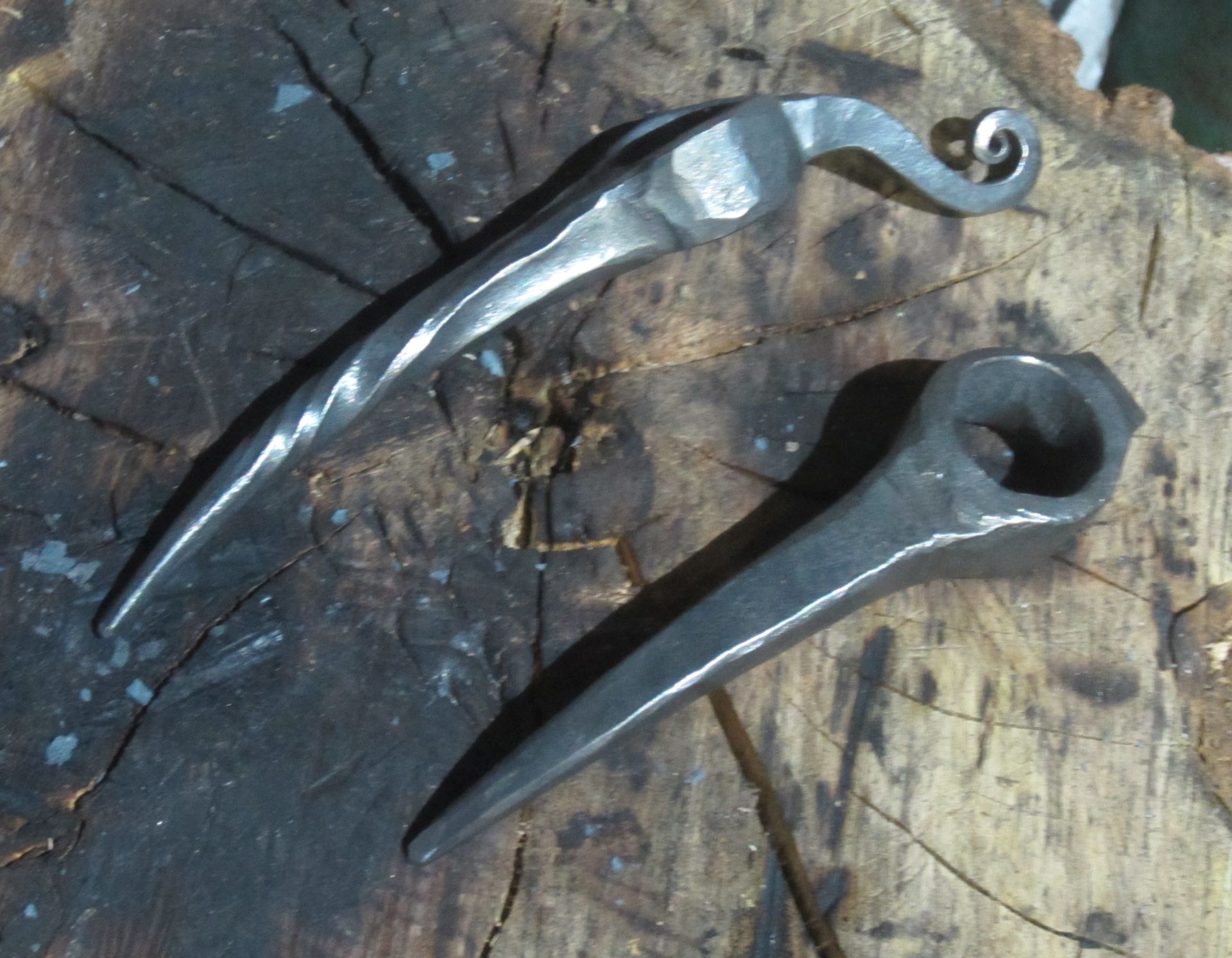

On 2017-6-17 at 5:32 AM, Frosty said:
Yeah, getting rings like that even and smooth isn't as easy as you'd think. Try modeling the ring with wire on a long tapered alignment , prick punch, spud wrench or bull pins are excellent, or pick a piece of rd. rod the dia you like. If you use the prick punch use a sharpie or something to mark the dia. you want.
Mark where you want the center of the loop away from the ends. Heat it and wrap it around the mandrel till the ends cross, in line facing opposite directions. Heat it up, drop it on the mandrel and twist the ends till the finial is right.
Another method than using the mandrel is to place the ring in the vise with the ends up and twist it.
It really just takes practice and if you don't do this for a while rust grows quickly though some folk just have a knack. I have to work at it to get rings right.
Hit the garage, yard, etc. sales with an eye out for punches, chisels, Allan wrenches, etc. A little sweet talking and you can usually get them thrown in on another sale or buy them all for not much.

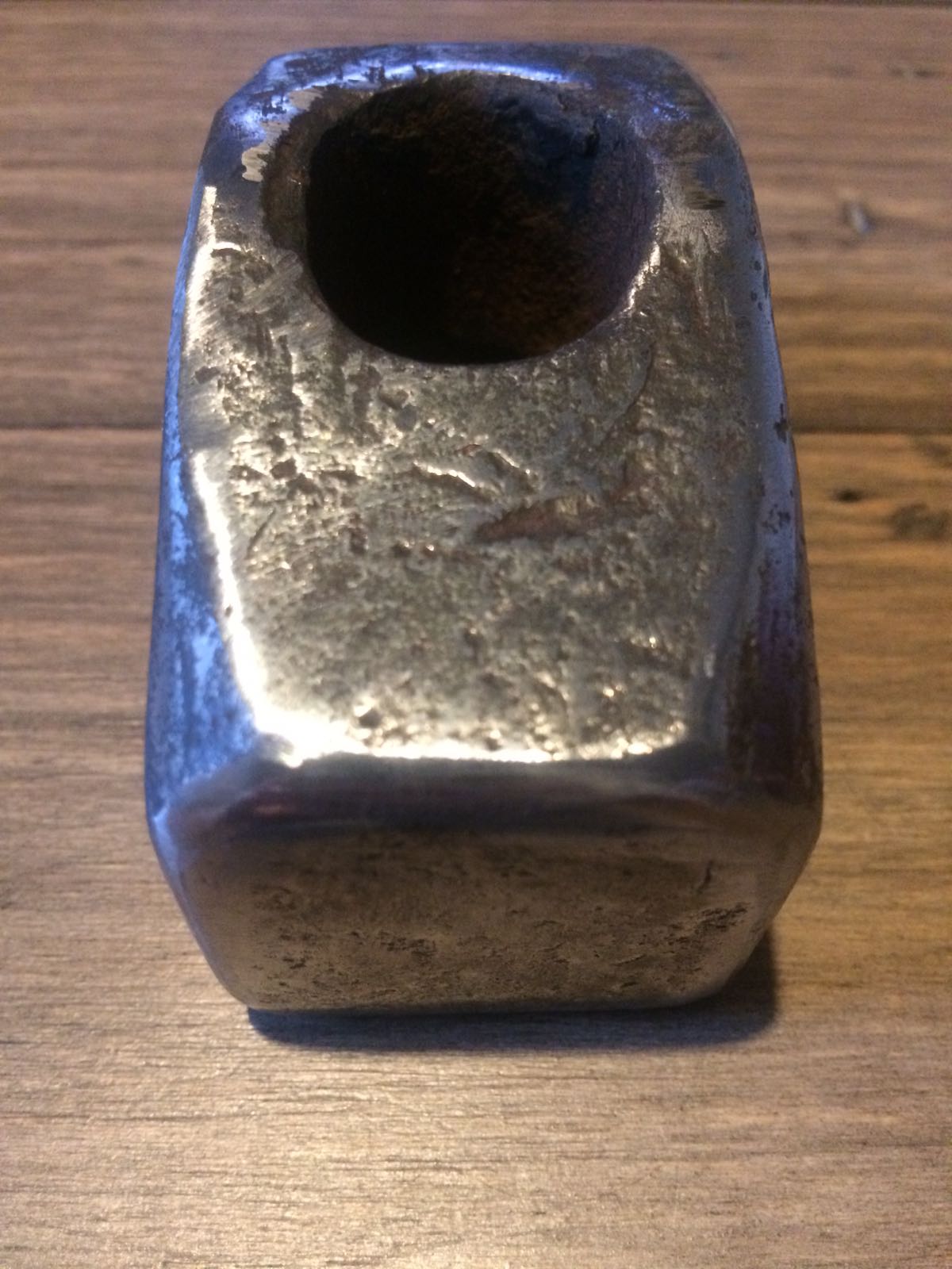

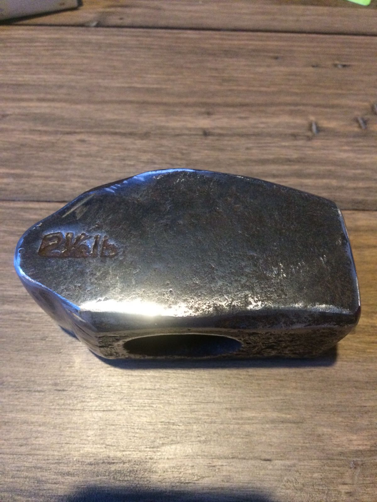

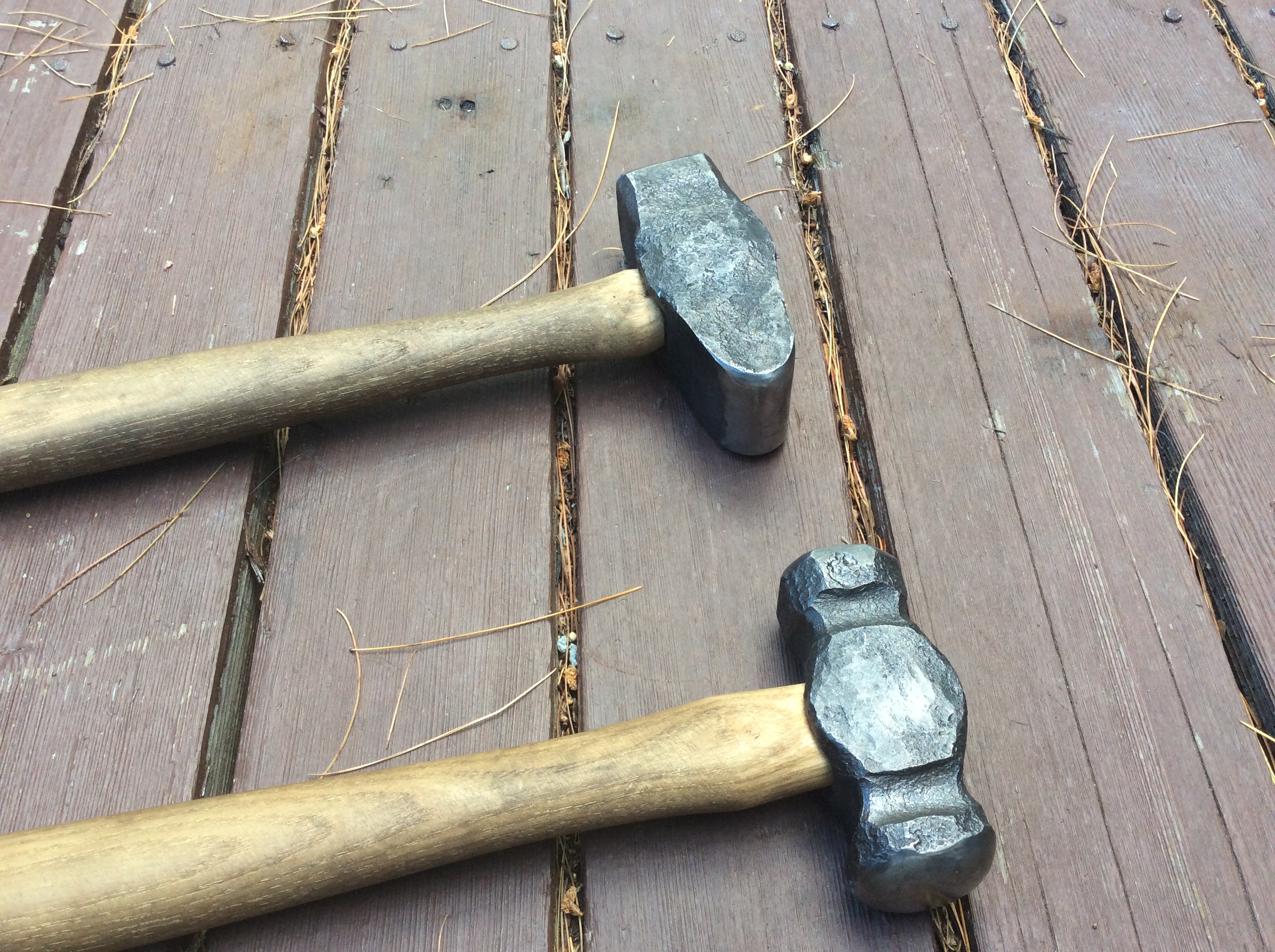

So one of the faces had been distorted with use, so thought I would make a broad cross pein. I am pretty happy with it overall.

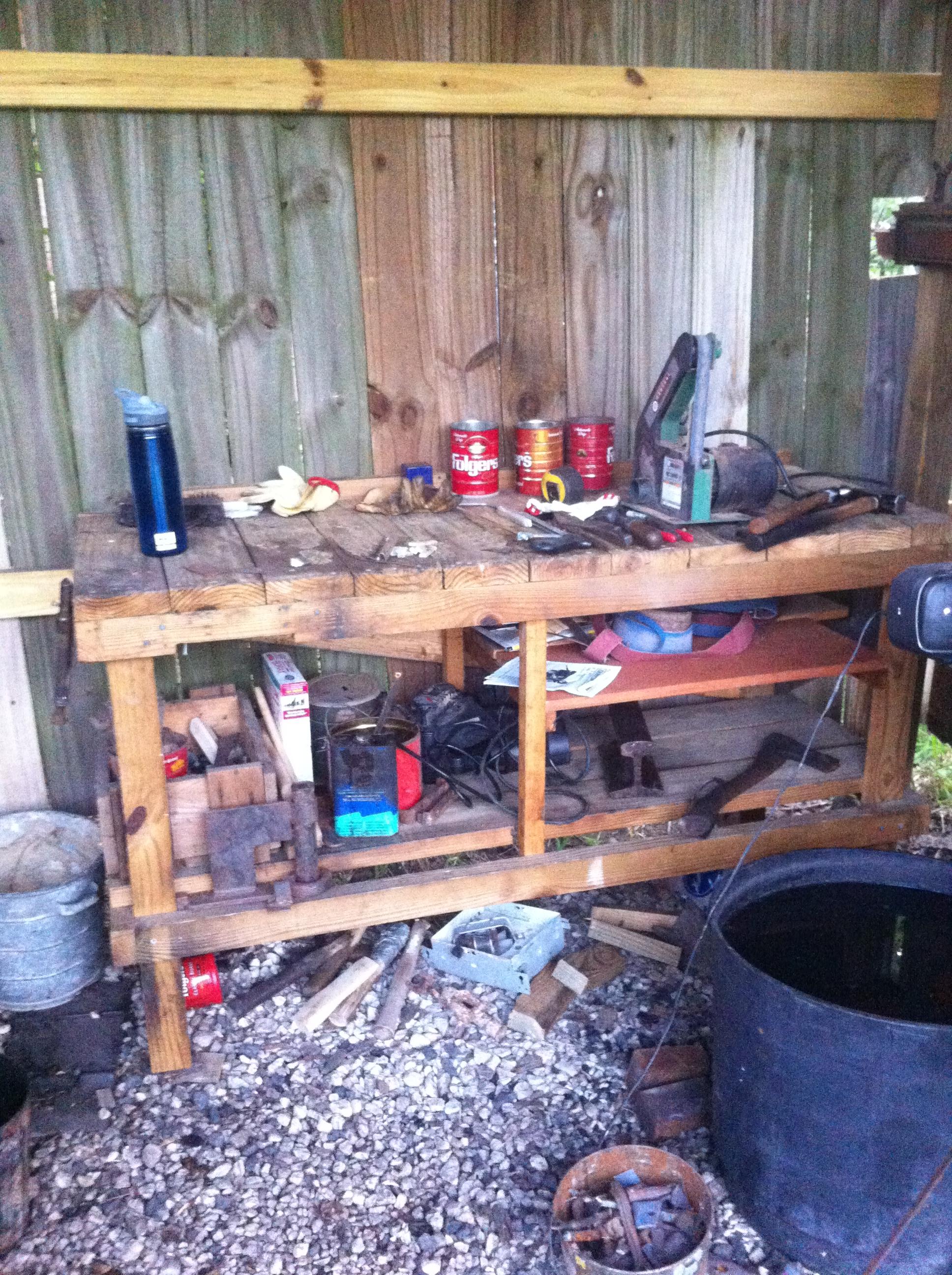

Bought a work bench off craigslist for $25, which isn't bad, cant make one cheaper than that after all the time and lumber cost unless it was reclaimed wood maybe. Got that put in the shop, It makes a huge difference! also cleaned the shop!

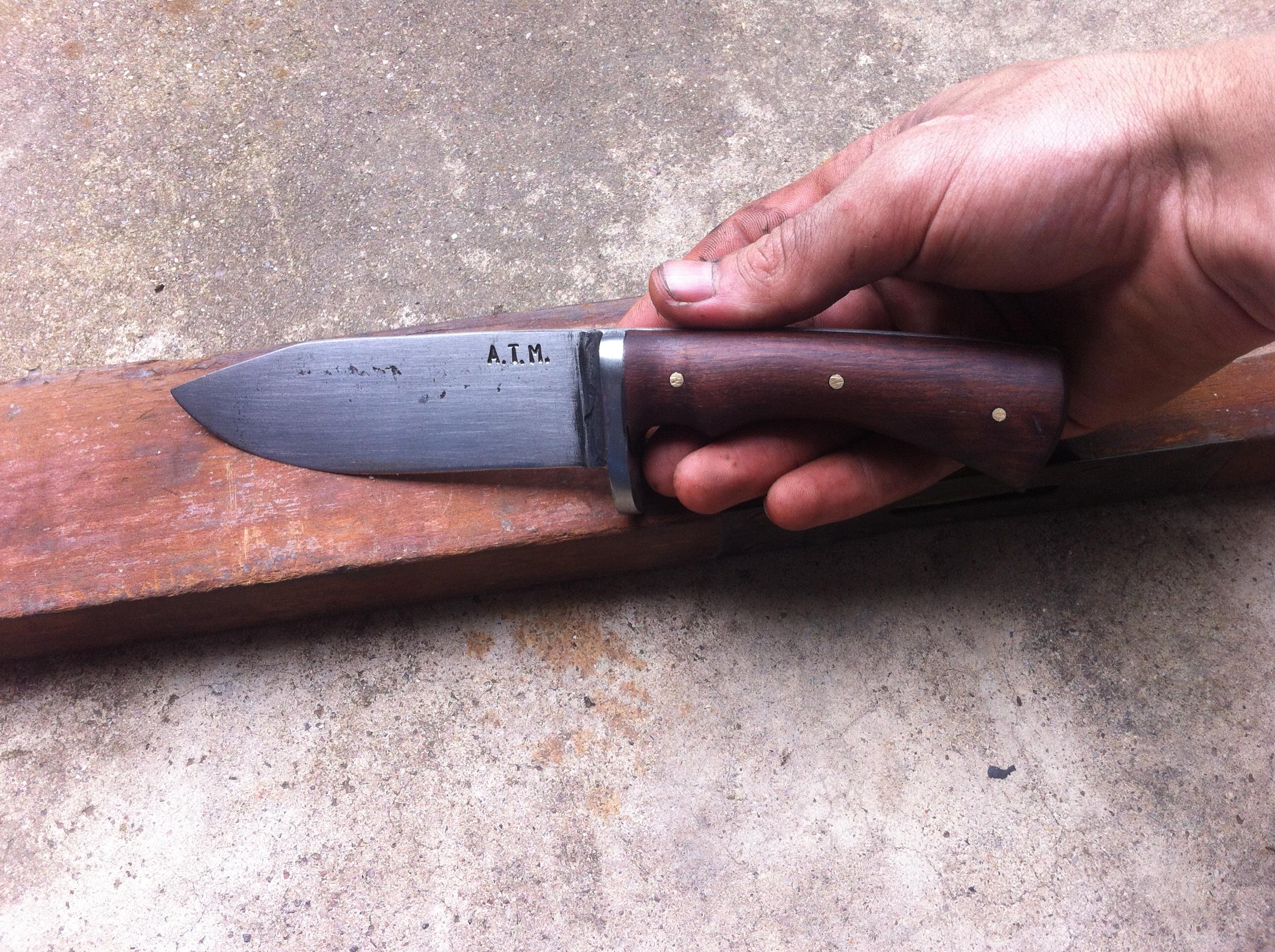

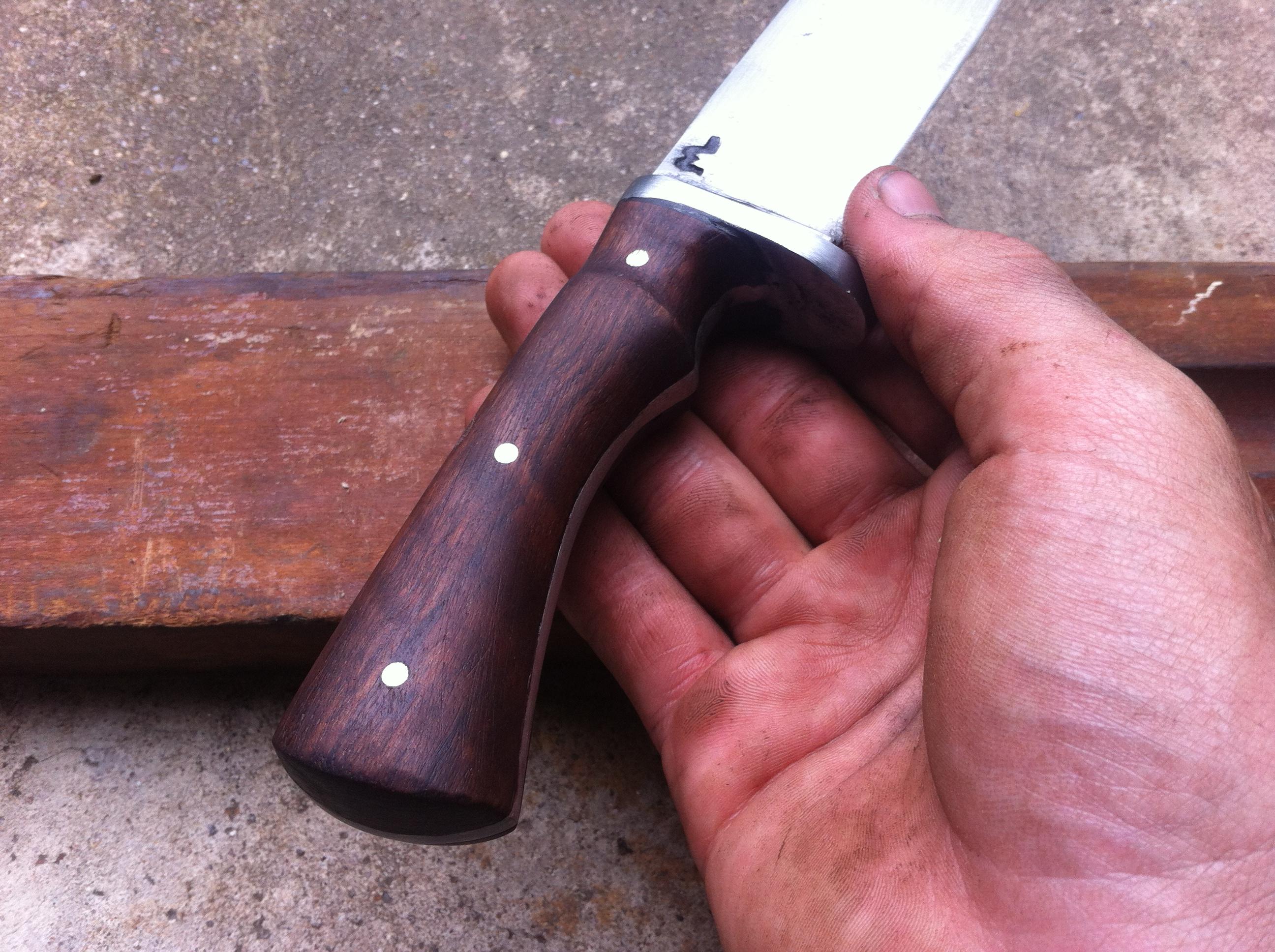

Made my dad a skinning knife for fathers day, and also I included some pictures a knife for a kid at the camp. the "A.T.M." is his initials. First time doing a guard like that.

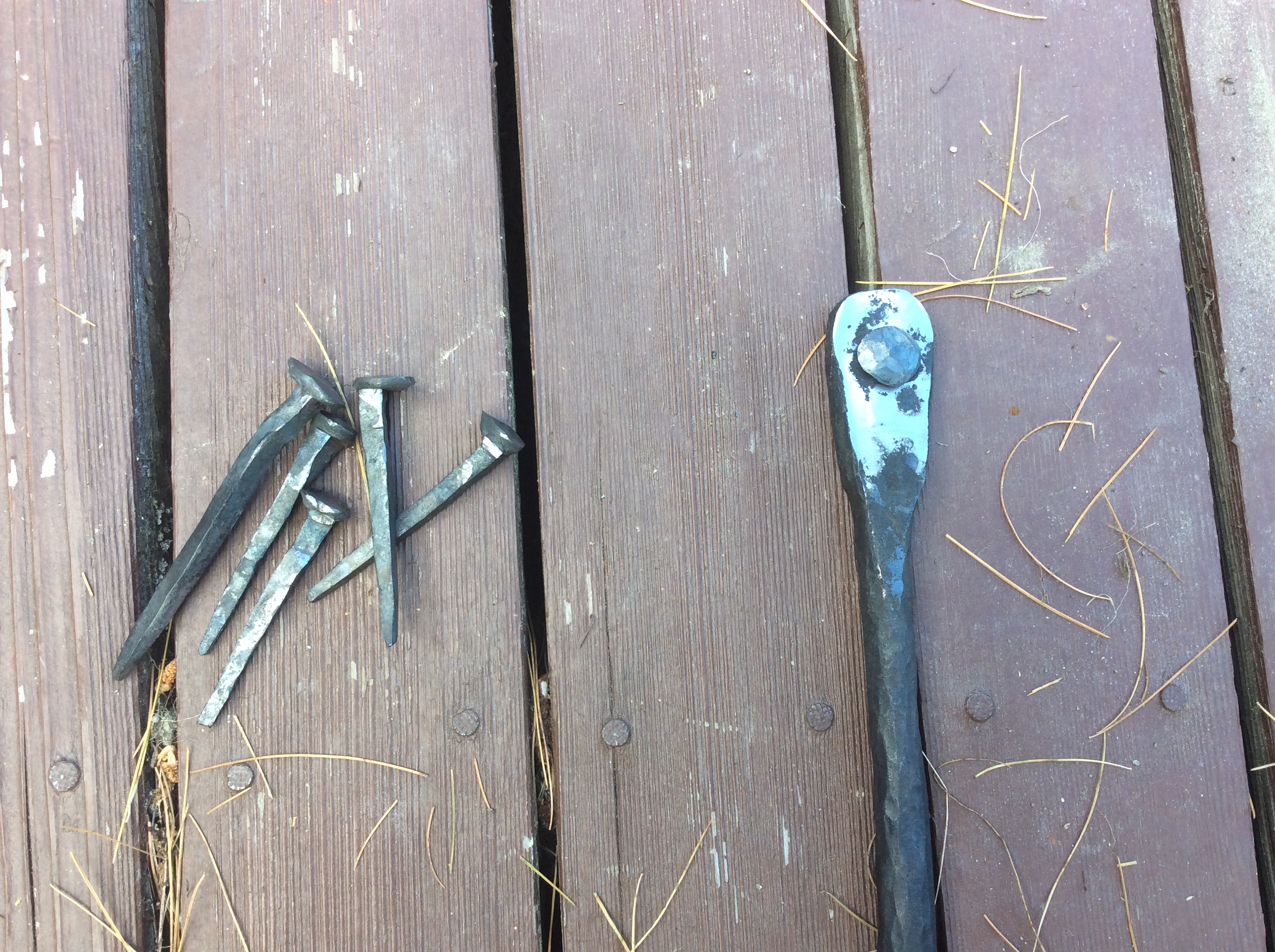

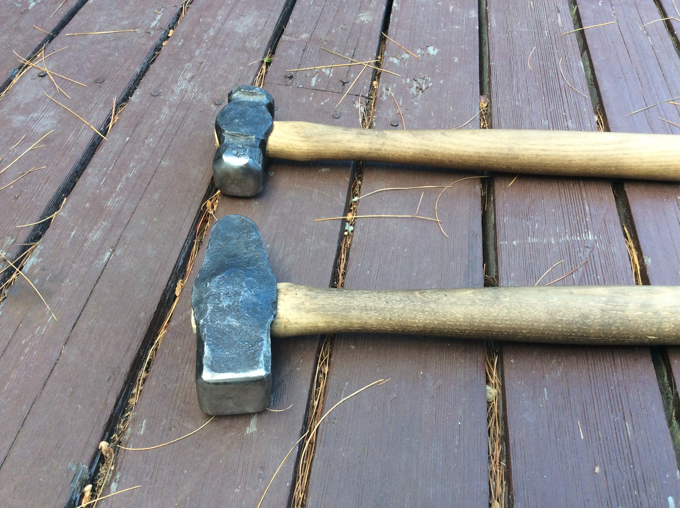

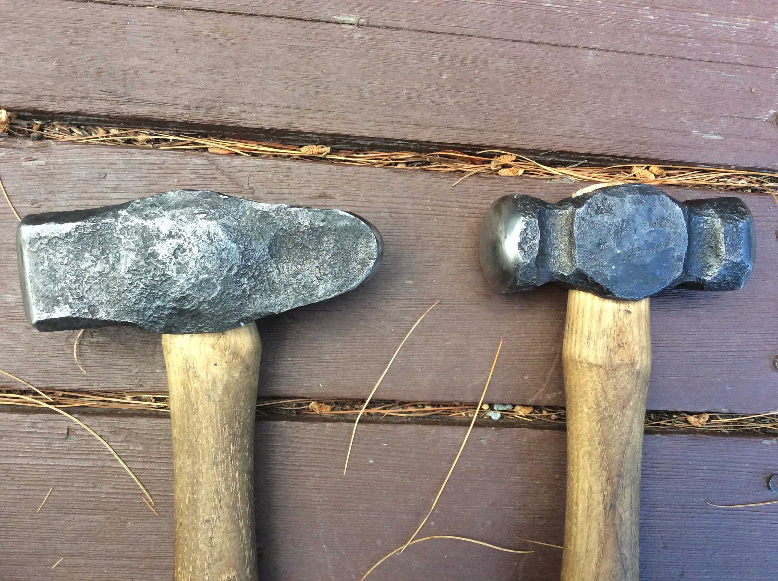

This is what I've done that past 3 days. I made my first and second hammer's, ones a 2.5 pound cross pein made out of 1045. The second one is a 1.5 rounding hammer also made out of 1045. Yesterday I made a nail header and made my first nails. Today I went and checked out a place in Mexico Maine called Rare Wood USA LLC (THIS PLACE IS AWESOME they have over 170 kinds of awesome wood). to buy exotic wood for handles.  IMG_4665.thumb.JPG.937b50030a57b8fdc8091d8024419a98.JPGIMG_4666.thumb.JPG.104fa825071e96e2e8b64fbbd7414f35.JPGIMG_4668.thumb.JPG.1dfc0ac62520287acae24a20427f01fc.JPGIMG_4669.thumb.JPG.1438811ecd9f7b7c351b51855c4c8ede.JPGIMG_4671.thumb.JPG.8a2b4b2fa271da23e7ed8ace0a65c4b9.JPGThe wood that I bought (from the top Right down) is Redheart x3 some type of rosewood x3, cocobolo, tulipwood? Wenge x3, amar ebony x2 and tulipwood? On second thought it may be amar ebony x4 and the two on the bottom many be rosewood
Hi, nice work on the hammers! Also those wood samples are beautiful - the redheart is exceptional, it's a pity we don't have those around here.

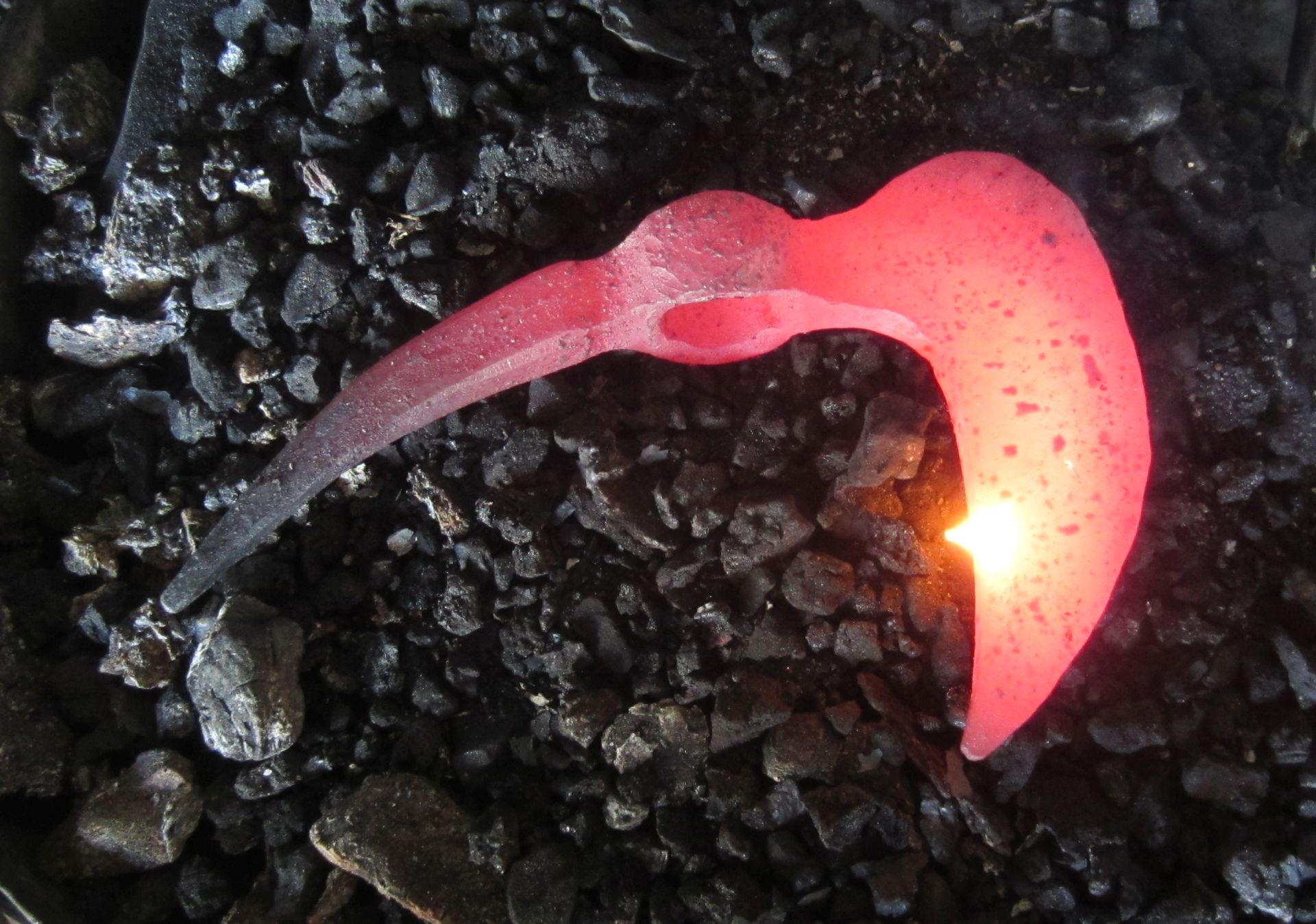

I tried to confirm Mark's theory a bit, so made two crowbill type weapons.  Also messed up the heat treat of the bearded axe second time (!) and reshaped a scrapyard axe head. Craft fair in the weekend so better take hurry :)
Dylan Sawicki, one thing I will recommend is at the last heats on the hammers, to forge them down to a lower temperature, that way they look cleaner. attached is a picture of a friend of mine hammers. All he makes is tools and hammers, and so he has gotten really good, and of course your first isn't going to be your best, and for a first that's actually not bad at all. If you have a flatter than I would have gone over the face and cheek and peen on the cross pein to make it completely flush and smooth. Now, the picture is of a 9lb sledge.

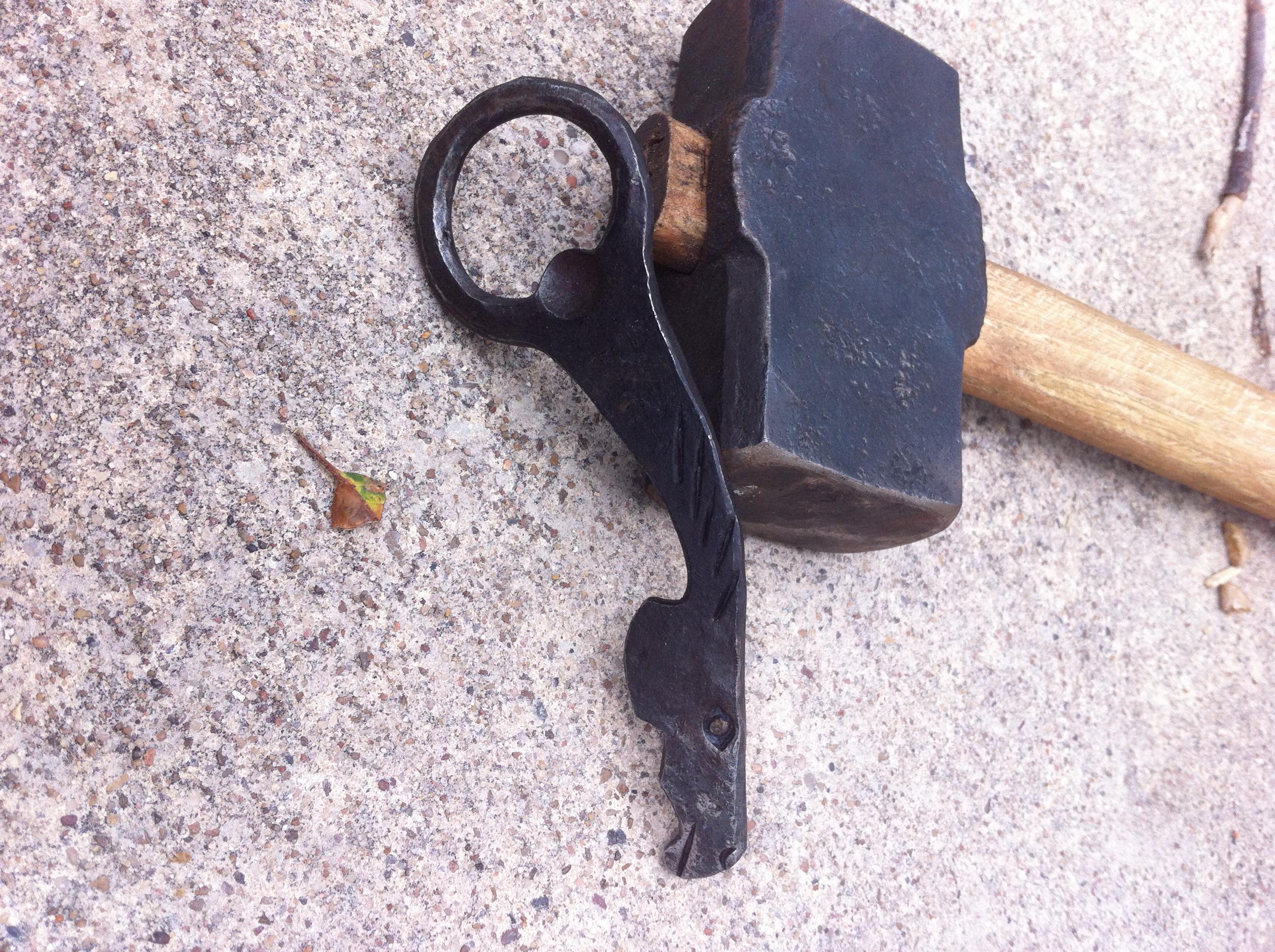

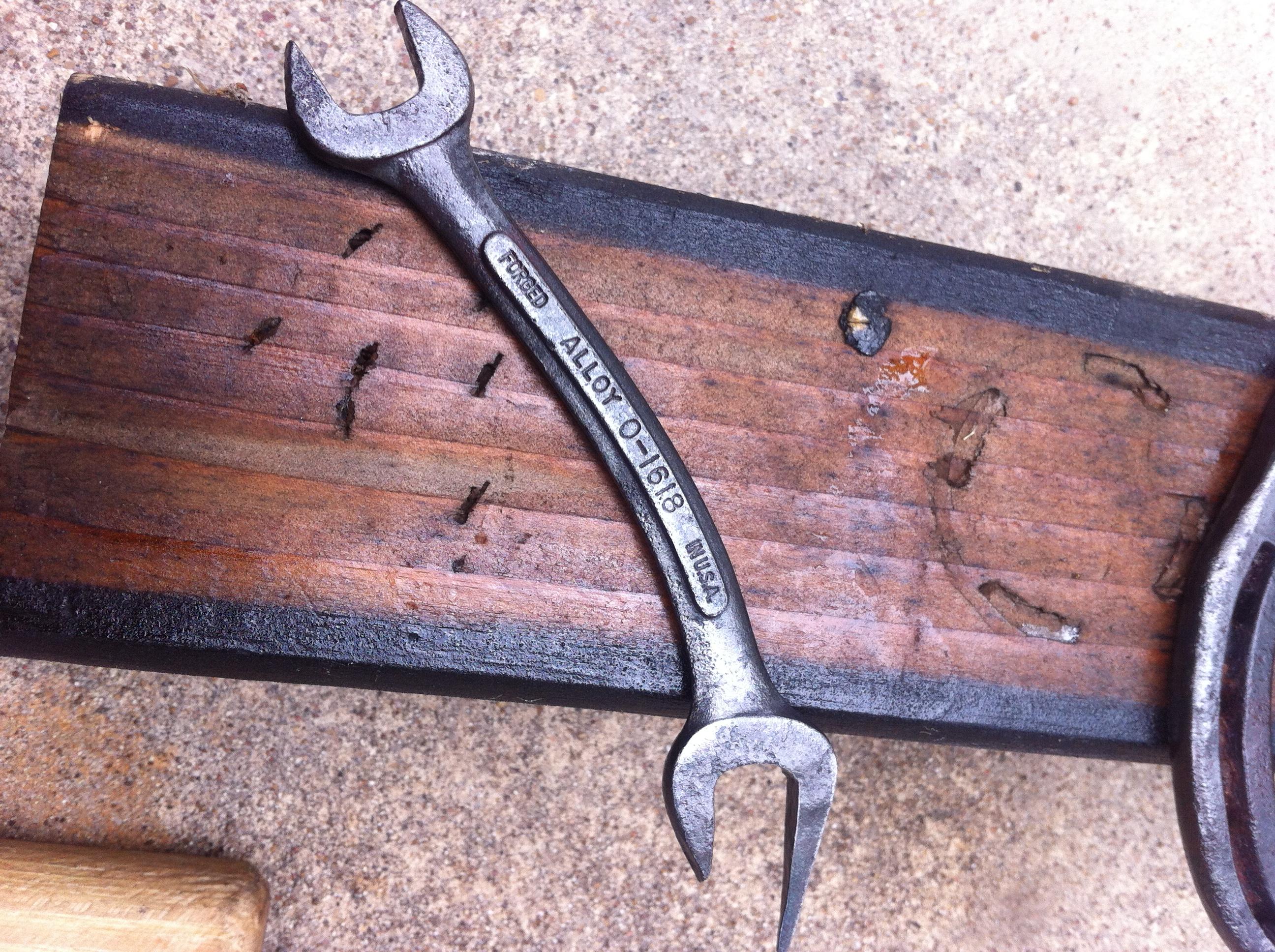

some recent work. I did my first "daswulf" style bottle opener out of a wrench, and I must say that it is the easiest and simplest bottle opener I have ever made.
