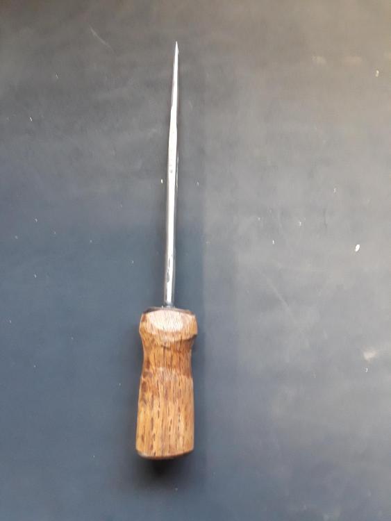

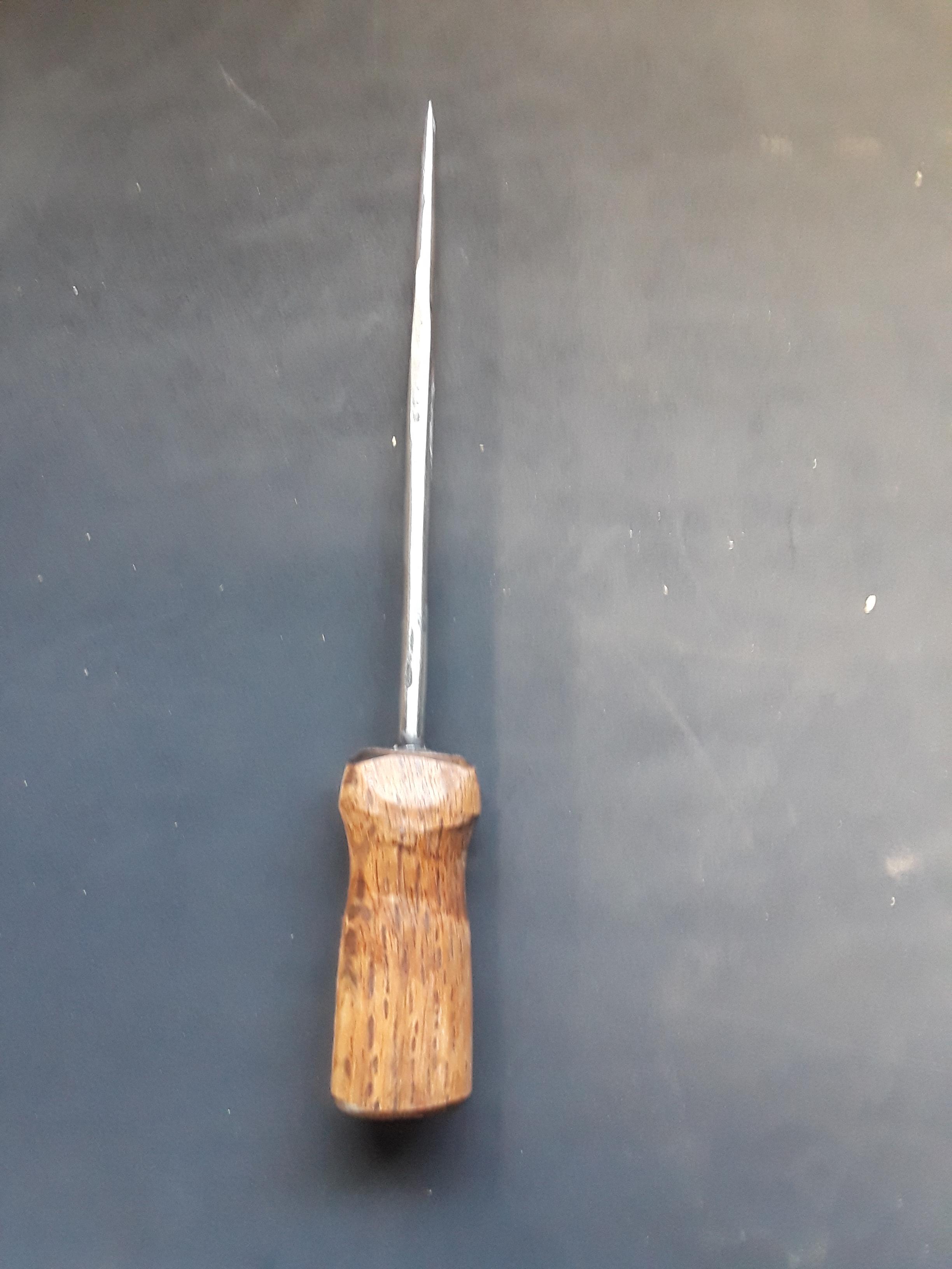

The old lady will not drink the water in the house, nor will she make ice with it. The closect place she can buy ice at they seem to let it melt somewhat so instead of cubes you get a bag shaped block. I have gotten tired of hearing he gripe about it, beat it on the floor, the wall, the fridge, get a hammer, or what not. So today she gets a new ice pick. No biggie, a piece of 1/4" garage door spring. Drew out a piece about 8" long or so. Then used a piece of an old hammer handle that was made of hickory. Sanded it down smooth and put a couple coats of tongue oil on him.
Hardened up pretty nice. Yes the little angle is supposed to be on the end of the handle so it fits a little better in the palm. The tip is straight but the light from the filing makes it look crooked.
I did it the same as i have done my chisels. Hardened about the first 2" - 2 1/2" then let the color run to "peacock".
I know ice can be punishing and i figure it is kind of like hammering a chisel so  wanted the middle a little softer. I did not want it to hard as my luck, a chunk will fly into her eye and i will never hear the end of that. Heck i still hear about the time i stabbed her in the hand in a bar one night. You would think they would let things go...

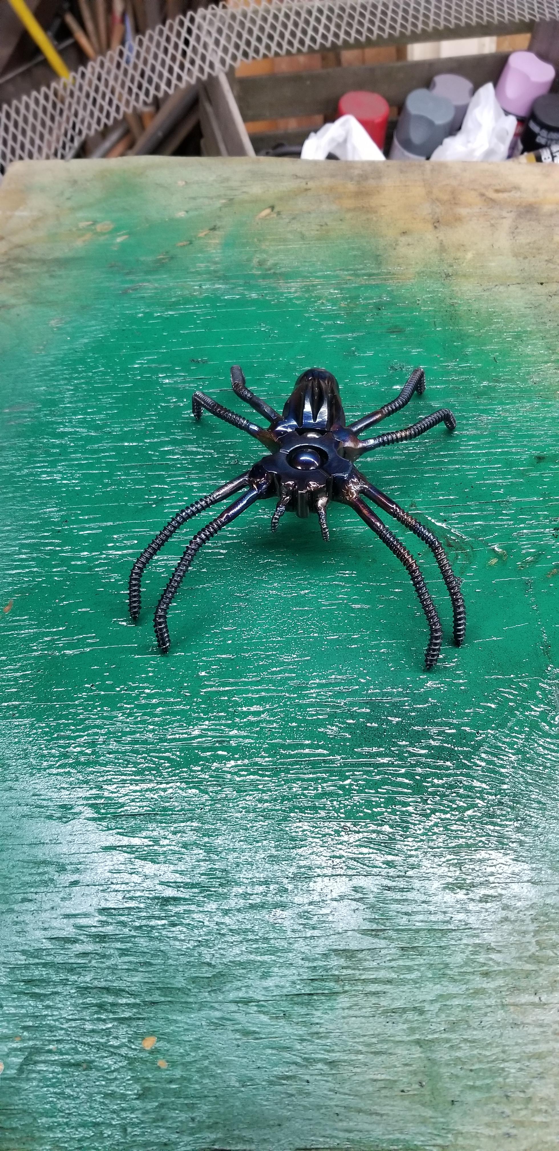

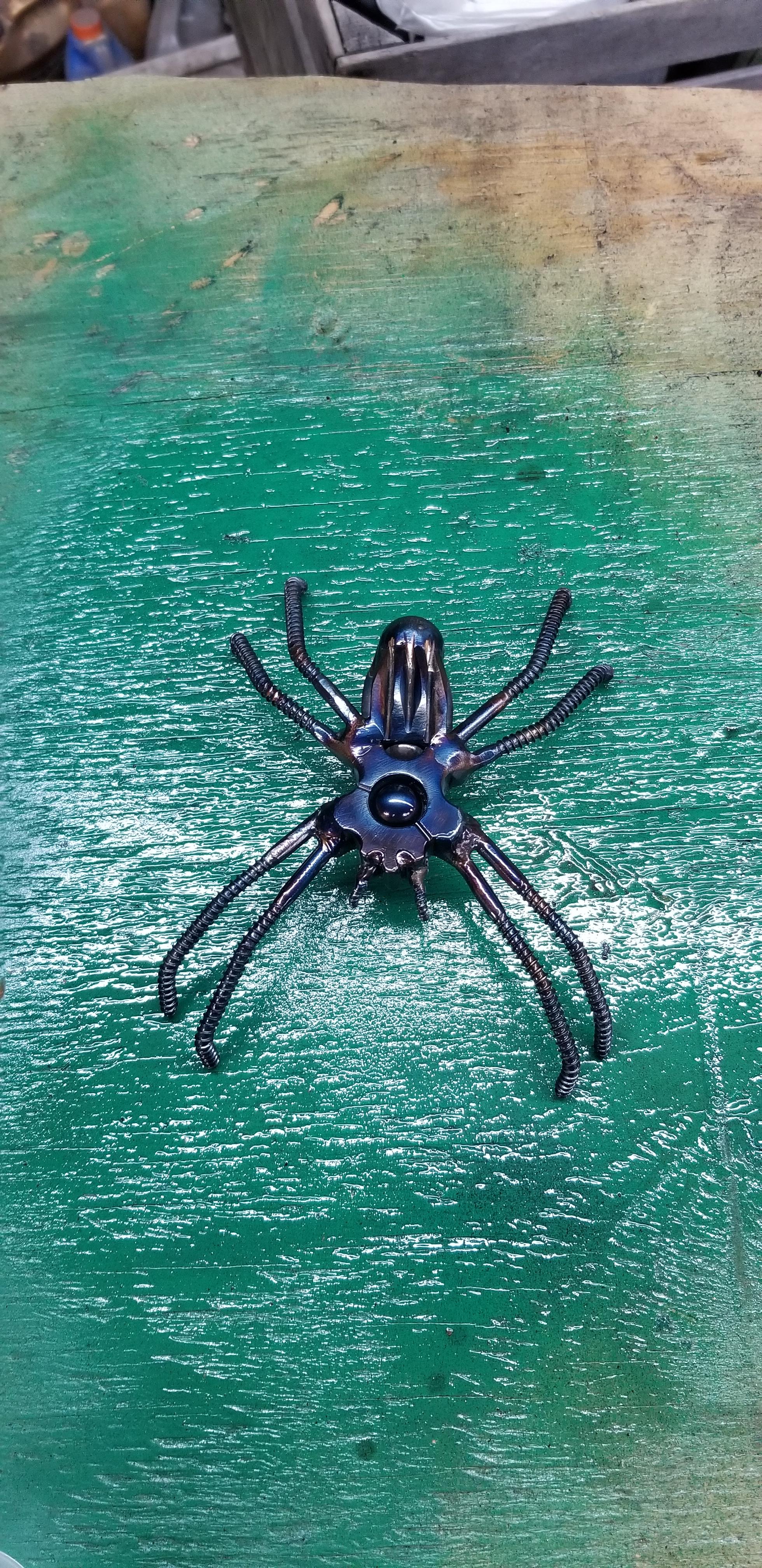

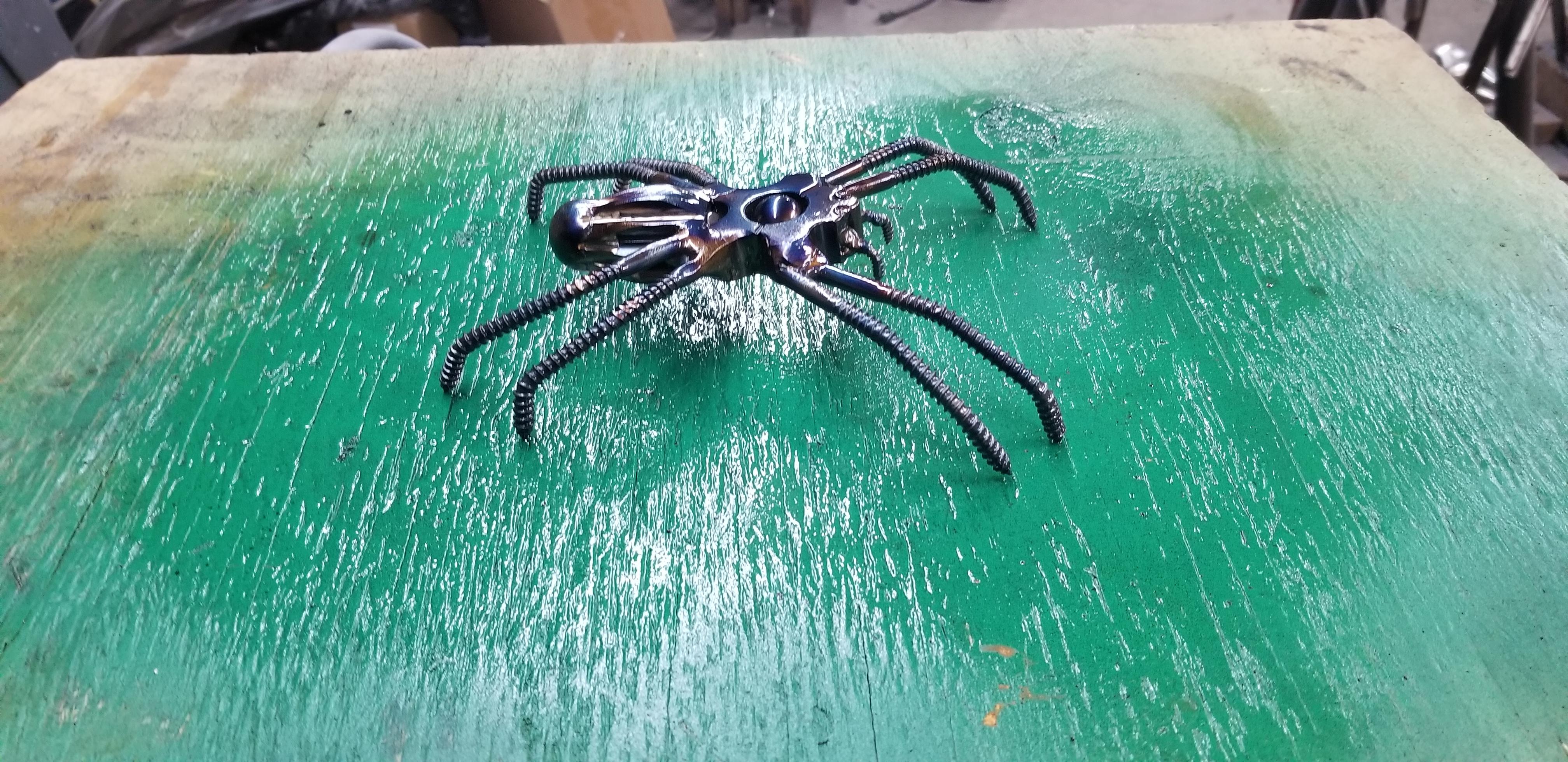

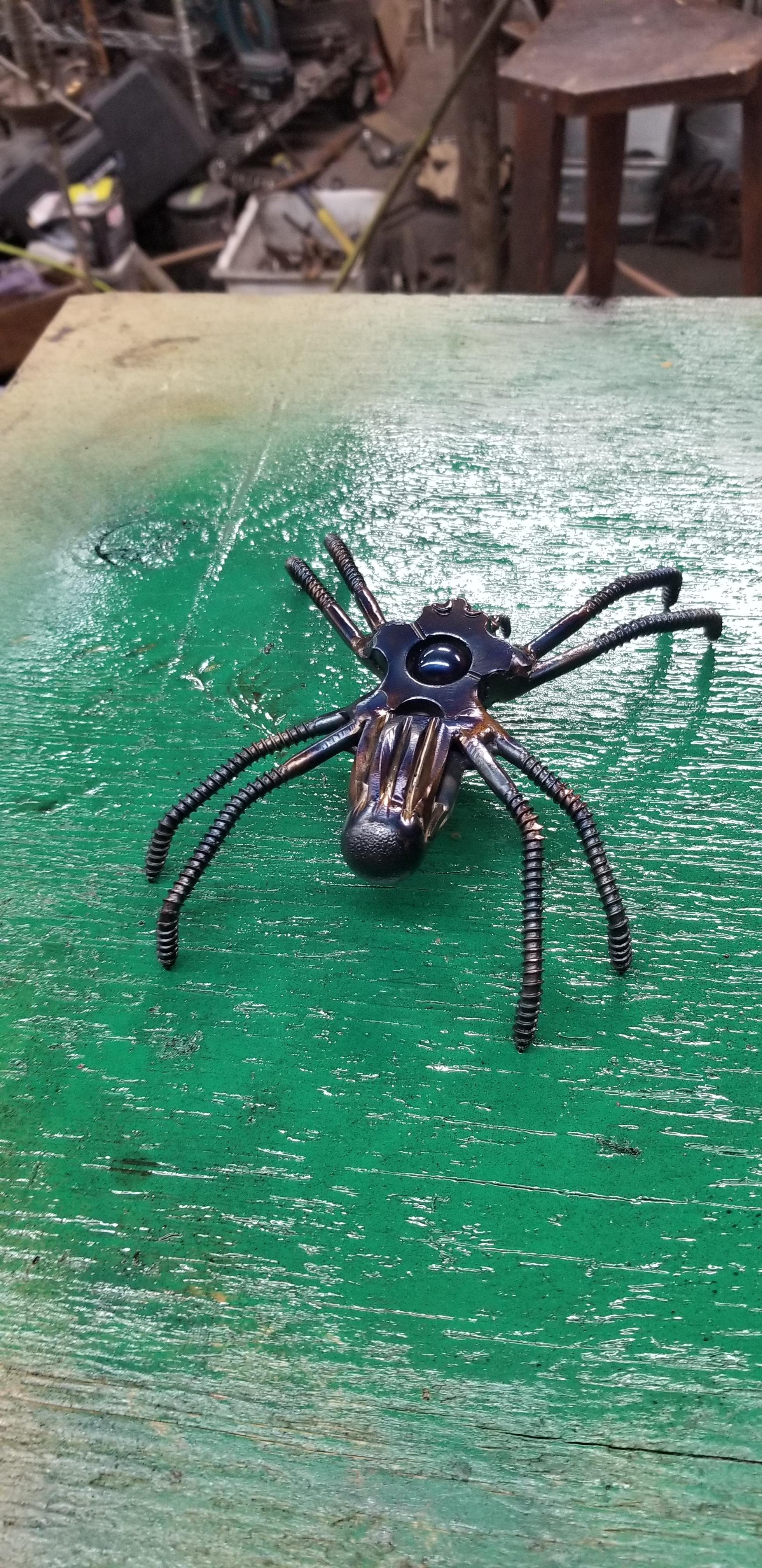

Finished a spider. More spiders and styles to come.

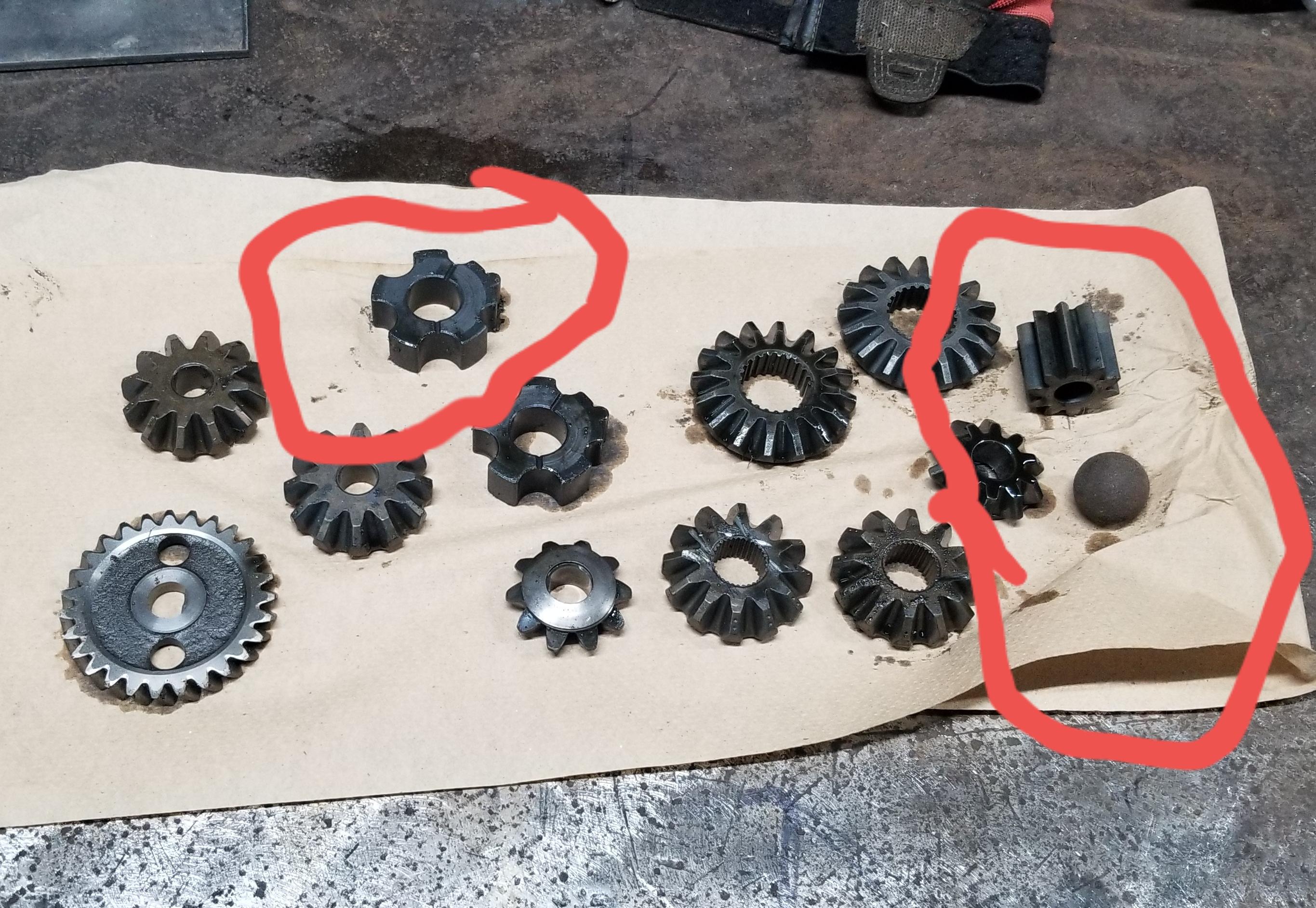

I like the way you paired the legs on that spider, Das.  The abdomen looks like the back end of a ball hammer but I can't figure what the body is. Nice job anyway. I'm still plugging away at the crocodile - a bit more each day. Like a giant jigsaw puzzle.
Great spider Das!

Thanks Aus, Ted. I was going for a sort of bananna spider look.
The pieces are circled in this picture. I'm not exactly sure what the body piece is. My buddy disassembles some lawn tractors and other things and brings me some bits here and there.
