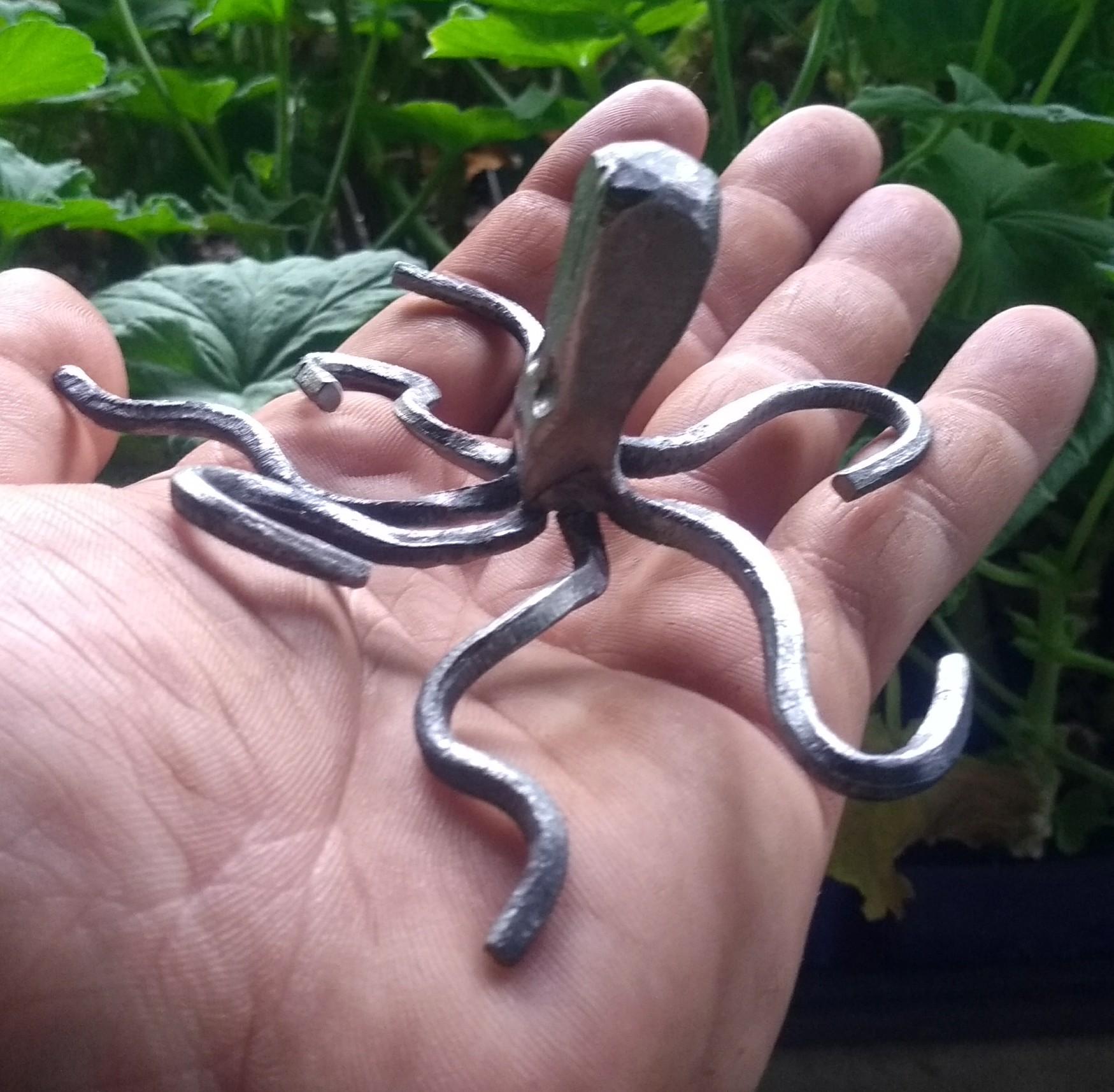

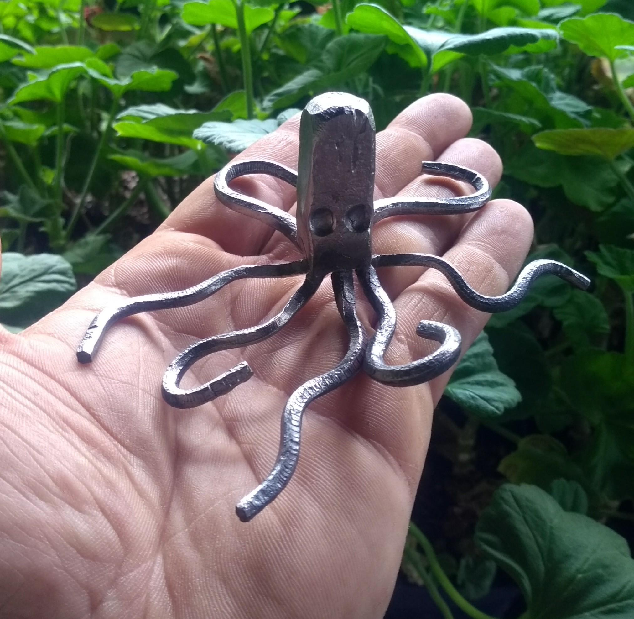

Shabumi Posted March 28, 2019 Share Posted March 28, 2019 Das, that looks great. I'm sure once you start getting your name out there people will be lining up for your work. BillyBones, nice work on the beanpoles, I'm going to have to steal that idea for the garden. I had a scrap end off of a 1/2 inch square bar so I tried an octopus. Broke one of the legs off while bending them. Learned alot of what to do, and alot of what not to do. Quote Link to comment Share on other sites More sharing options...
Chelonian Posted March 28, 2019 Share Posted March 28, 2019 Nice looking Septapus! Quote Link to comment Share on other sites More sharing options...
Daswulf Posted March 28, 2019 Share Posted March 28, 2019 Great Idea shabumi. Nicely done even for losing a tentacle. Thats a great use for ends. Could also try a squid like that. Quote Link to comment Share on other sites More sharing options...
Mudman Posted March 29, 2019 Share Posted March 29, 2019 I dig it shabumi! Quote Link to comment Share on other sites More sharing options...
Shabumi Posted March 29, 2019 Share Posted March 29, 2019 Thanks everyone. It was about 5 inches when I started. I cut a # from one end half way through with a hacksaw to get 9 legs, broke the middle one off to get 8. Somethings I would've done different is I'd shape the head before I cut the legs. It didn't work trying to upset it without being able to get a solid hit. I'd also hot cut the middle leg to get kind of a beak. And I won't work the legs so cold that they break. A squid is a great idea, there's plenty of material to peen into a mantle. I thought it would make a good spider too Quote Link to comment Share on other sites More sharing options...

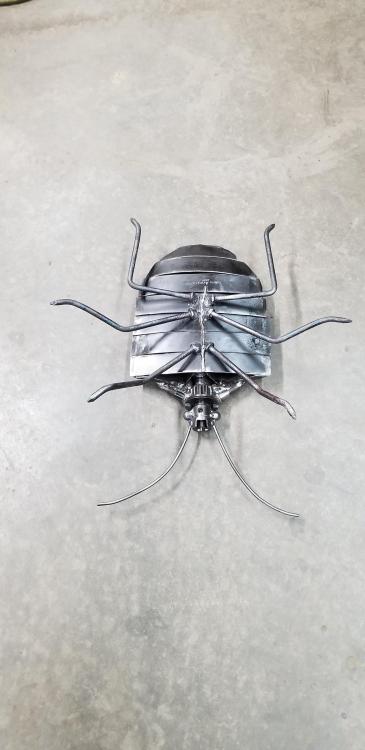

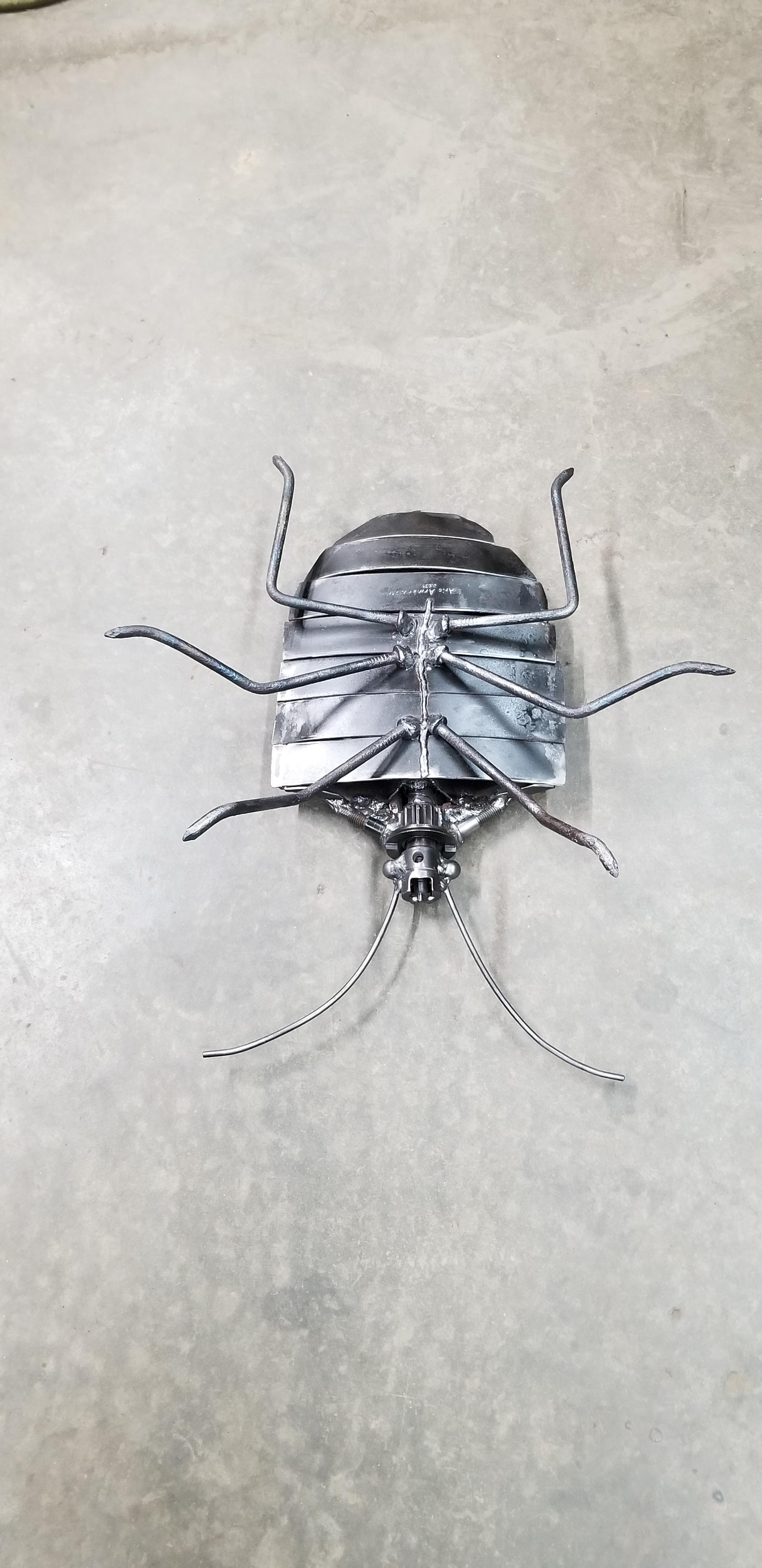

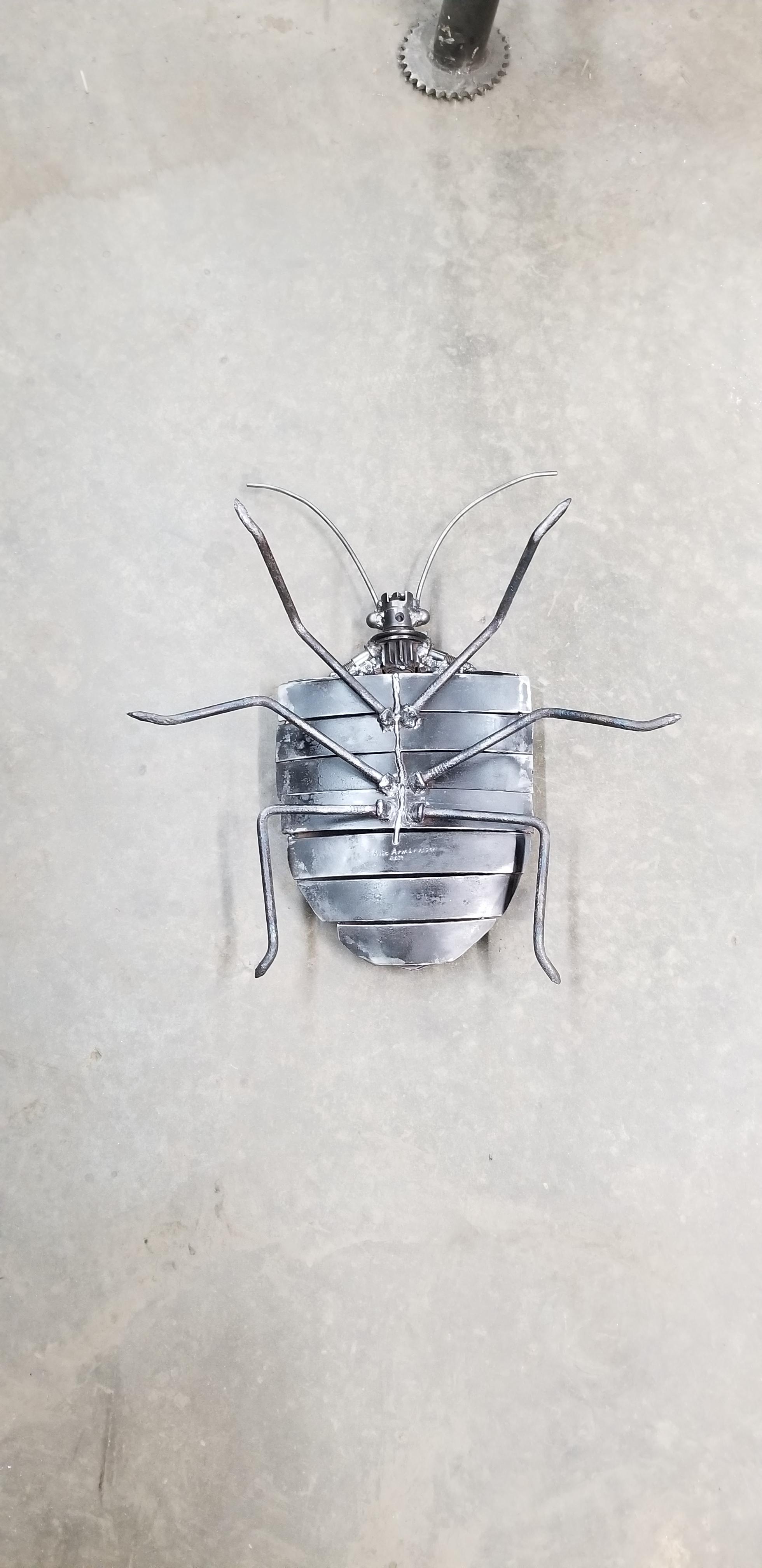

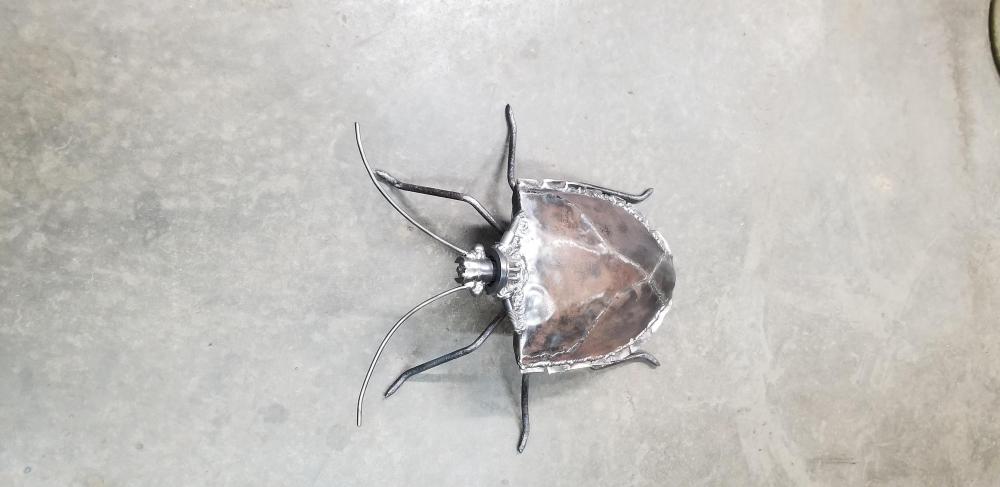

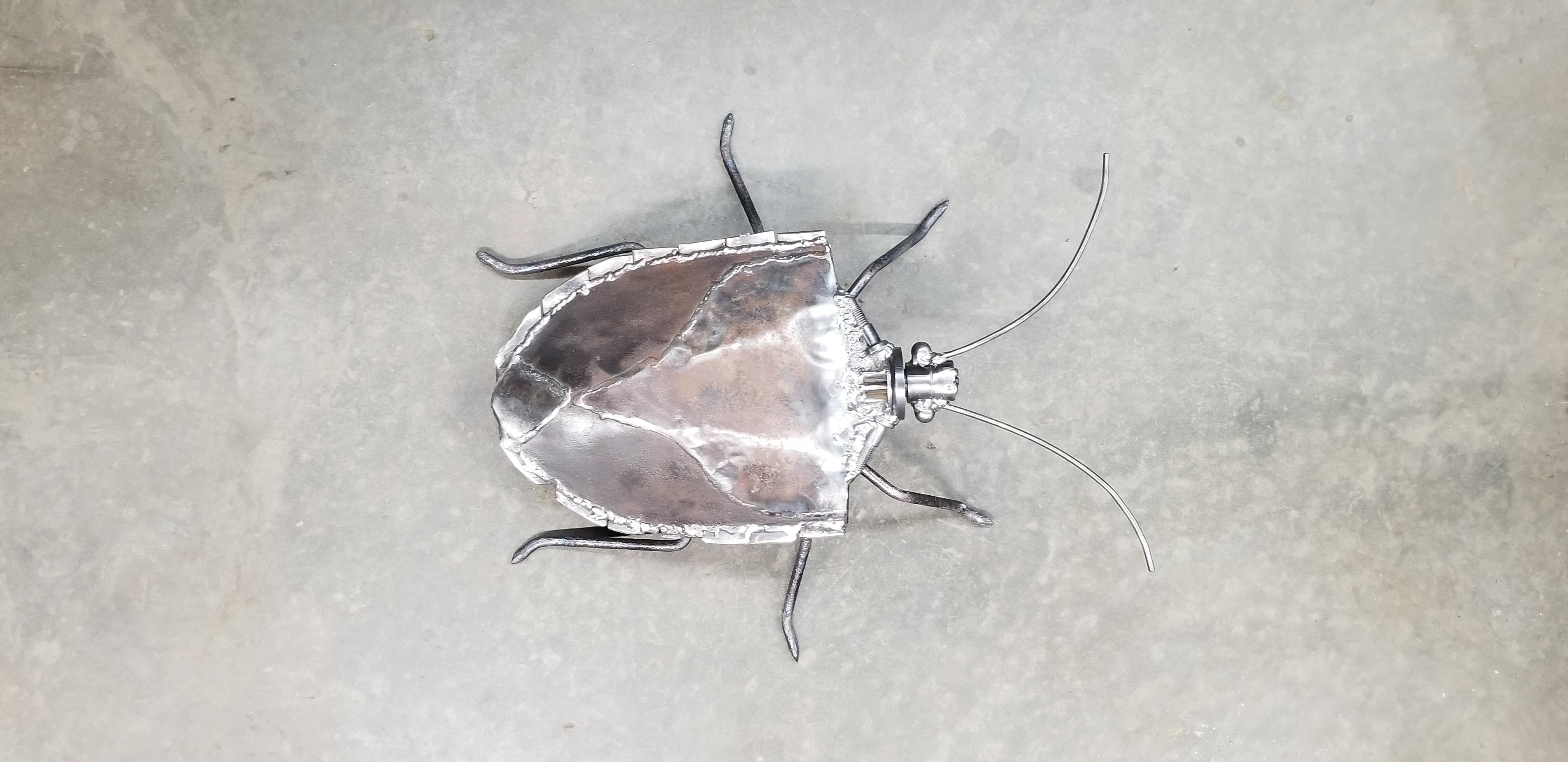

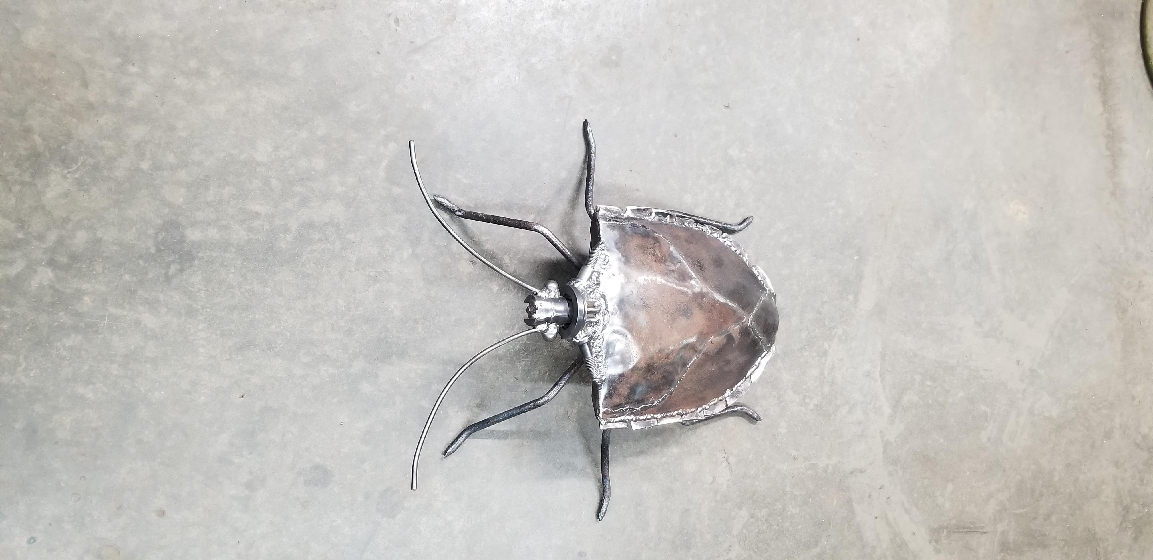

Daswulf Posted March 29, 2019 Share Posted March 29, 2019 Keep playing with the ideas. Its inspirational for sure. Finally finished a stinkbug I started atleast 2 years ago. For size refference the back is a spade shovel head. Still needs clearcoated which will darken it up a bit. Quote Link to comment Share on other sites More sharing options...
Mudman Posted March 29, 2019 Share Posted March 29, 2019 Daswulf, that's one of my favorites from you so far. Nice work! Quote Link to comment Share on other sites More sharing options...

ausfire Posted March 29, 2019 Share Posted March 29, 2019 Yep, stink bugs are aptly named . Horrible things. Das, your sculpture looks real and has perfect proportions. Even the underside is a true representation. Love it. Quote Link to comment Share on other sites More sharing options...

Frosty Posted March 29, 2019 Share Posted March 29, 2019 That's another excellent sculpture Das! The pics don't show the scale very well, I never would've guessed it's made from a spade. Perfect garden art, it clicks on two fronts. I haven't smelled a stink bug since moving to Alaska but I remember the smelly things AND I've spent enough time with a shovel or spade in my hands to have my fill of that action too. I suppose you've already thought of it but it'd be really easy to hide a motion sensor and aerosol can of smellyness in it. Yes? The possibilities are just too tempting. Thank you I might have to kill an old spade! Frosty The Lucky. Quote Link to comment Share on other sites More sharing options...
Anachronist58 Posted March 29, 2019 Share Posted March 29, 2019 Woof, I have been a staunch fan of your work, but frankly, this one just STINKS! Quote Link to comment Share on other sites More sharing options...
Daswulf Posted March 29, 2019 Share Posted March 29, 2019 Haha, Frosty, yes, Elizabeth was in the shop with me and we made mention of the idea. I've got a load of spade shovel heads. Guess it's cheaper to buy a new one than to rehandle them. Lol Robert. I agree. Quote Link to comment Share on other sites More sharing options...
Anachronist58 Posted March 29, 2019 Share Posted March 29, 2019 Actually, another triumph. The Mrs. and I zoomed in and pored over the details. Snaazzyy.... Quote Link to comment Share on other sites More sharing options...
Daswulf Posted March 29, 2019 Share Posted March 29, 2019 Thank you Robert. I had actually forgotten that a friend of mine at work had wanted this when I finished it. He wants to mount it on the wall so I'll be drilling countersunk screw holes in the feet. Quote Link to comment Share on other sites More sharing options...

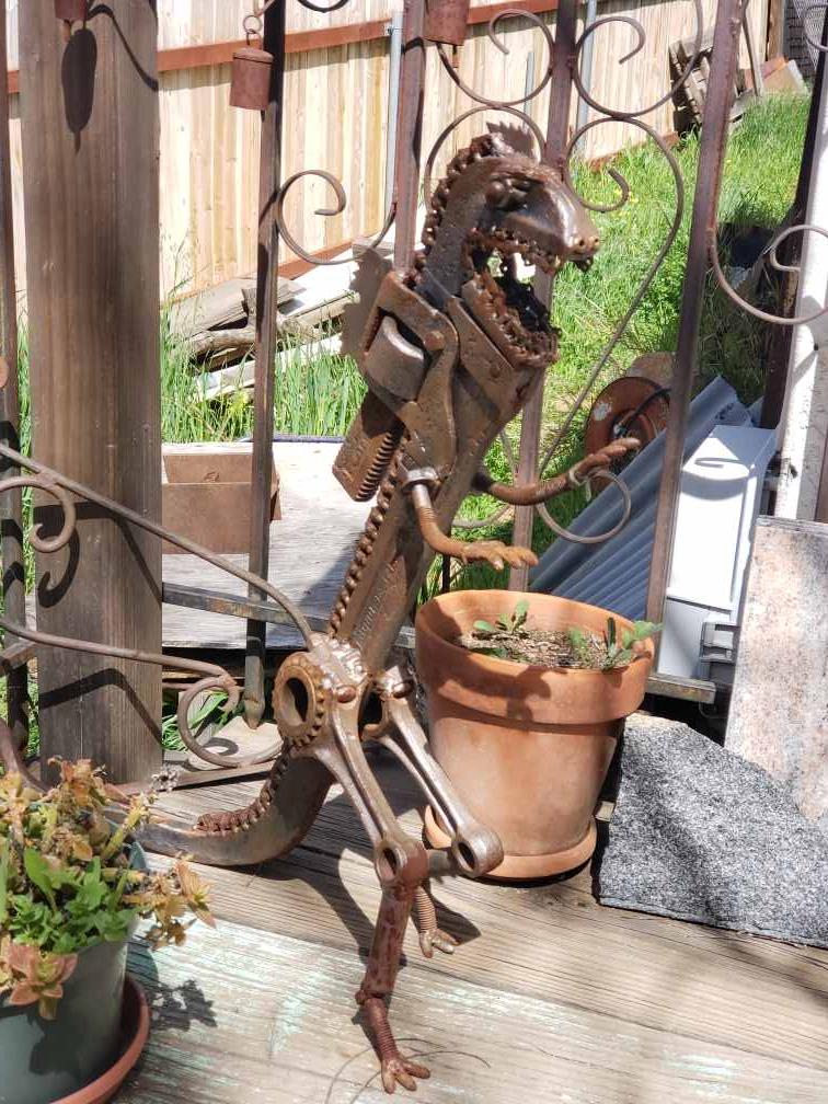

Anachronist58 Posted March 29, 2019 Share Posted March 29, 2019 Speaking of fantastic work, Trimontosaurus Wrench has weathered well but in need of a reseal. I want to keep the rust, as it compliments the piece. Warm BLO? Quote Link to comment Share on other sites More sharing options...
Daswulf Posted March 29, 2019 Share Posted March 29, 2019 He's getting a nice color to him. yes BLO would work. It will probably darken up a bit. He hasn't bit the mail delivery person yet has he? I'm Still trying to find a clearcoat that holds up well outside. My next attempt will be flattened automotive clearcoat because of the UV resistance. Quote Link to comment Share on other sites More sharing options...

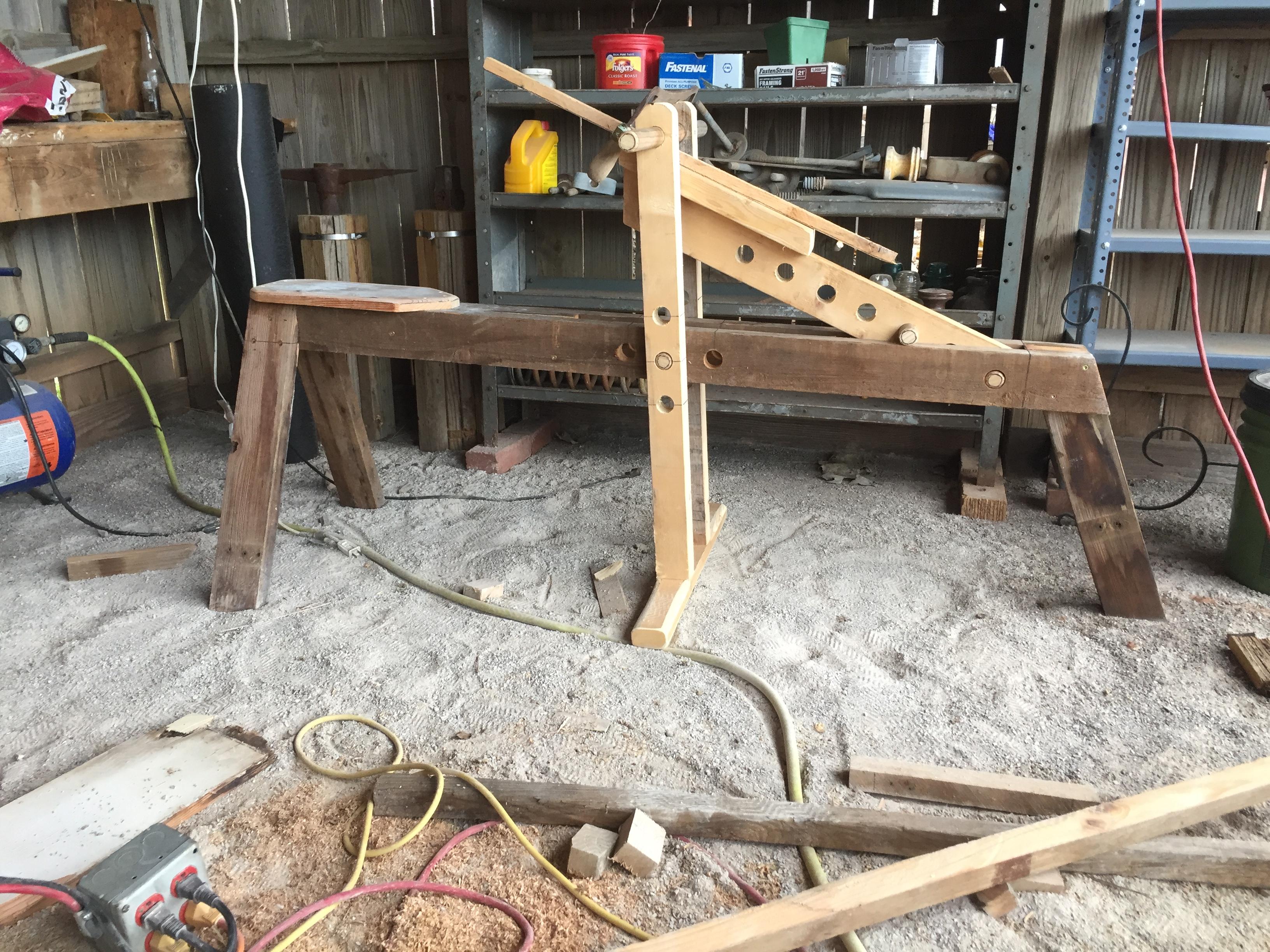

Charles R. Stevens Posted March 30, 2019 Share Posted March 30, 2019 Built a shaving horse. Quote Link to comment Share on other sites More sharing options...

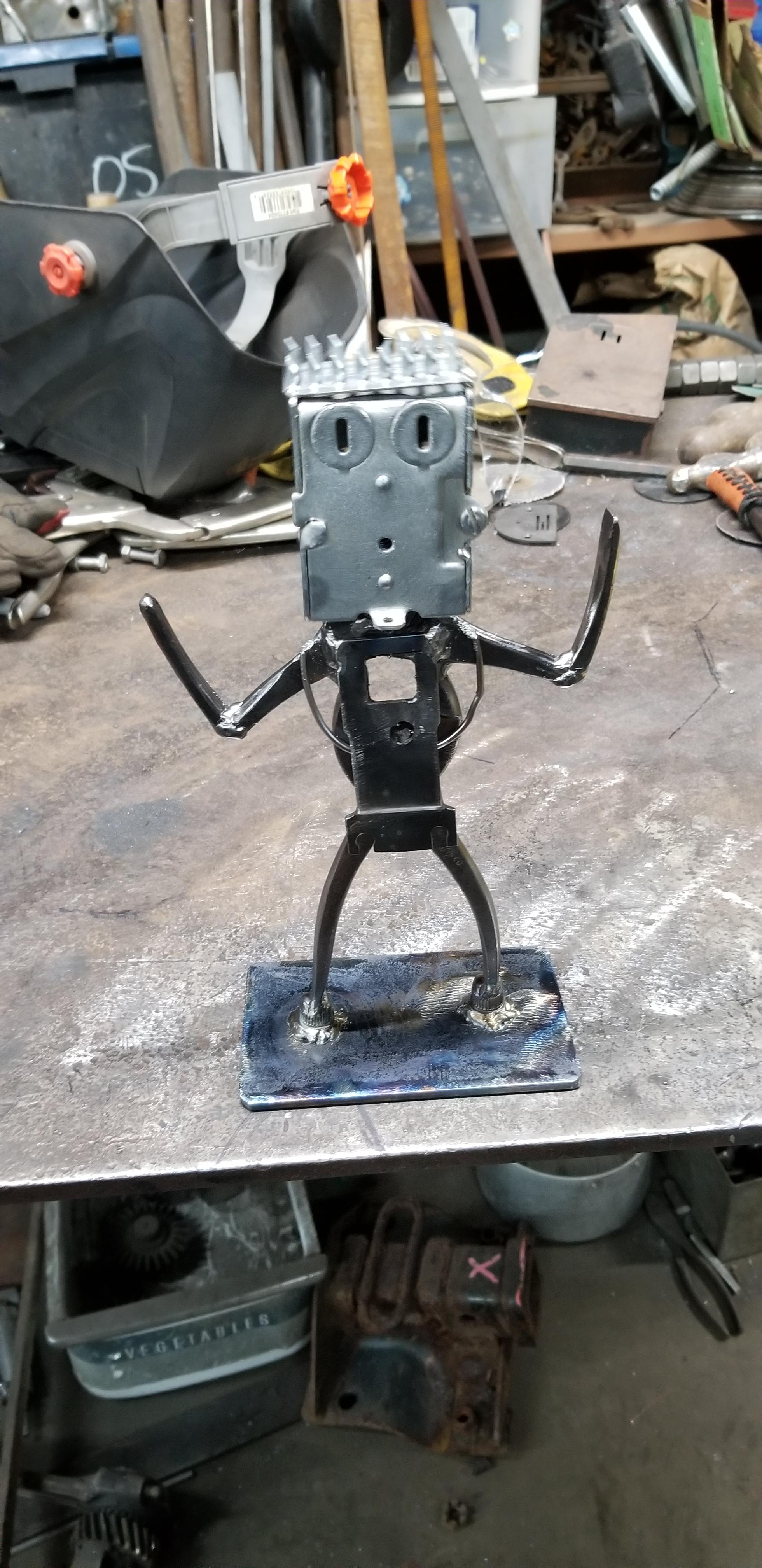

Daswulf Posted March 30, 2019 Share Posted March 30, 2019 Nice work Charles. Had this electrical box hanging out that had "what I saw to be" a face to it. Figured out a body and a spring to the neck, and I have a bobblehead. Quote Link to comment Share on other sites More sharing options...
