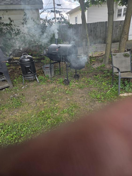

That's the same basic set up as our Webber, do you hot smoke near the "fire" box and cold smoke at a distance on the grill?  I control the smoking temp by it's proximity to the fire box opening and how far it's open. BOY that sounds more complicated than it is.

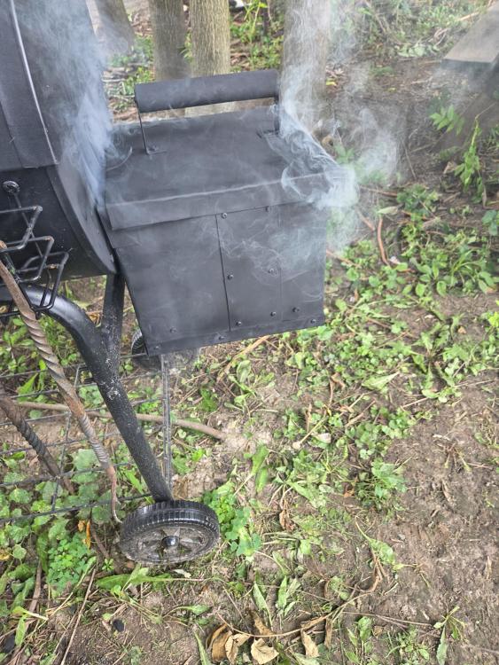

I built a wall of firebrick that redirects the gases from the firebox up and over the grill, making the heat more indirect and more consistent throughout the grill section.
Yep, cold smoke away, hot smoke close. I actually do not do much cold smoking though. I have done some jerky like that but that is about it. Never done cheese or fish at all.

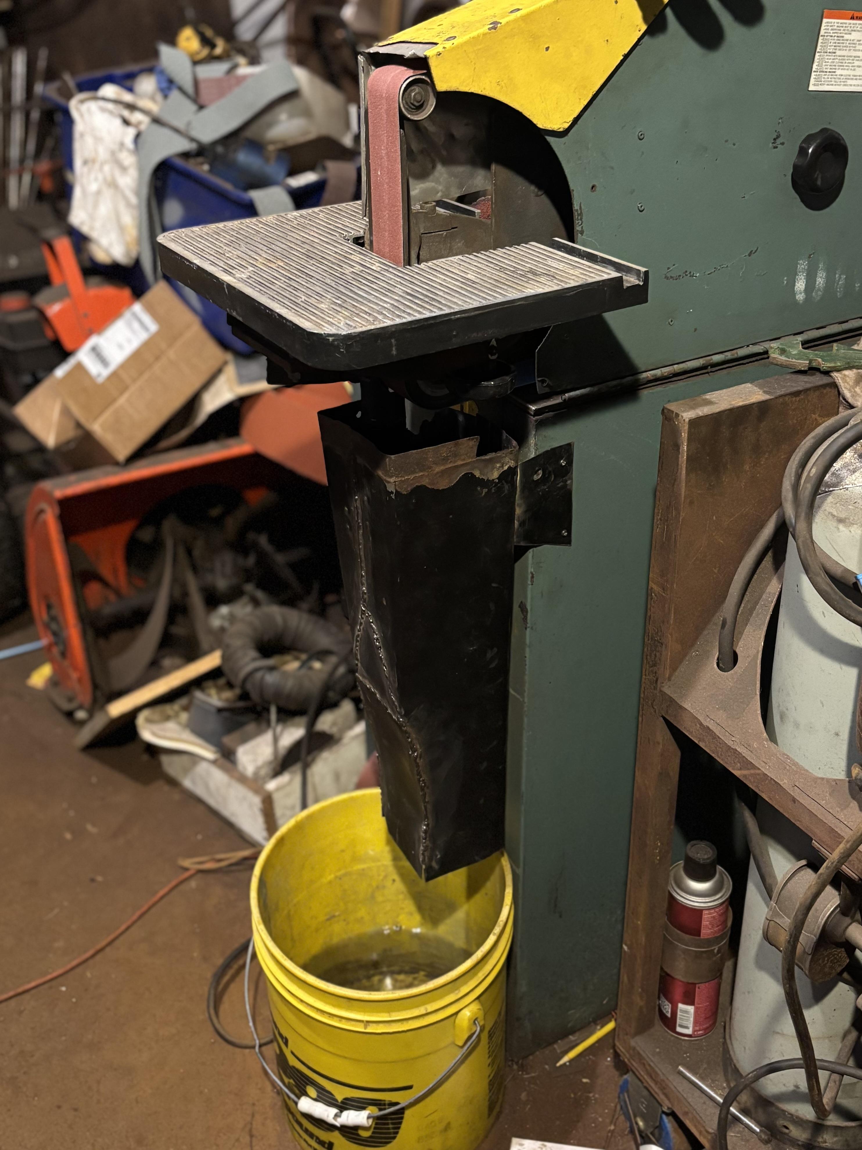

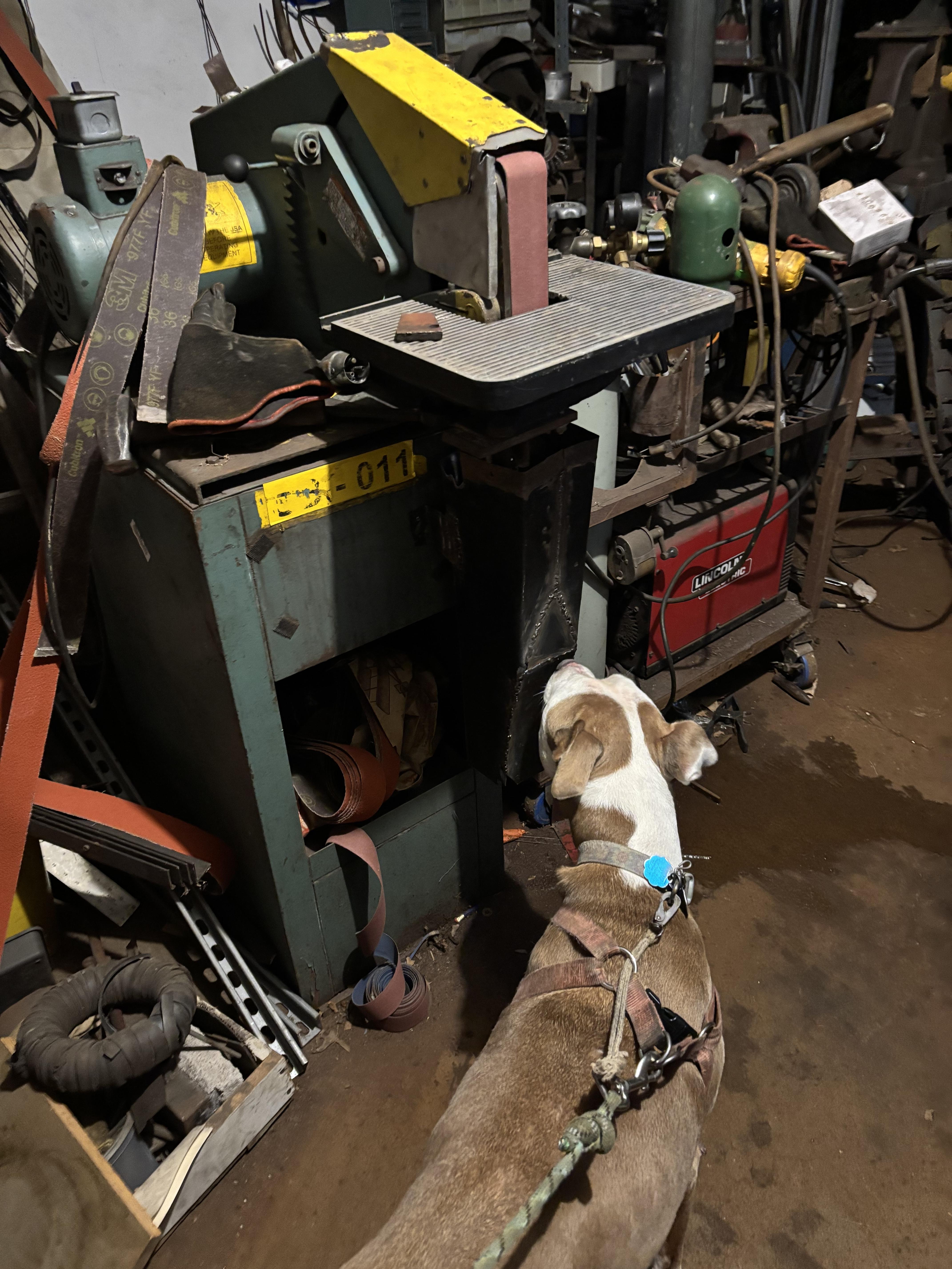

Continued practicing MIG welding on 18 gauge sheet. Proving somewhat trickier than yesterday’s beginner’s luck, but at least — unlike when I first started welding — I know enough to identify the problems and find how to fix them.

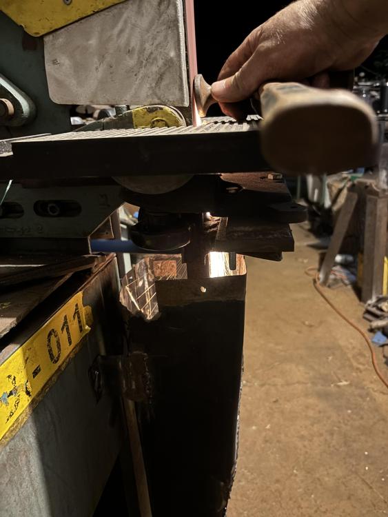

That said, rather than just running a bunch of seams on random scrap, I used the opportunity to weld up a spark chute for the square wheel grinder, which worked quite well.
Dressing an auto body hammer face:
Lola performing quality inspection:
It turns out the bucket I was using has some leaks in the bottom, but I should be able to get those patched up pretty easily.
Welding 18 ga. is what mig was made for. I held my type earlier but the first bead needed either more current or lower wire speed. You want good "wetting" at the edges of the bead, it shouldn't look like it's sitting ON the steel. Don't be afraid to weave, you always need to manipulate the puddle and bead.
You'll pick it up quickly and wonder what you did without it in no time.
Noted — many thanks!
You're welcome, it's my genuine pleasure.
One more tip while I'm at it. When welding corners try to make a bit of overhang on one sheet about the thickness of the sheet and weld the outside of the corner. The bit of extra sheet allows you to melt it into the other sheet making a nice bead without overheating and burning holes.
It seems intuitively better to weld the inside of corners like this however it takes more wire, heat and time to fill so heat can't dissipate as quickly, and you burn holes. It's different if the stock is 1/8" and thicker.

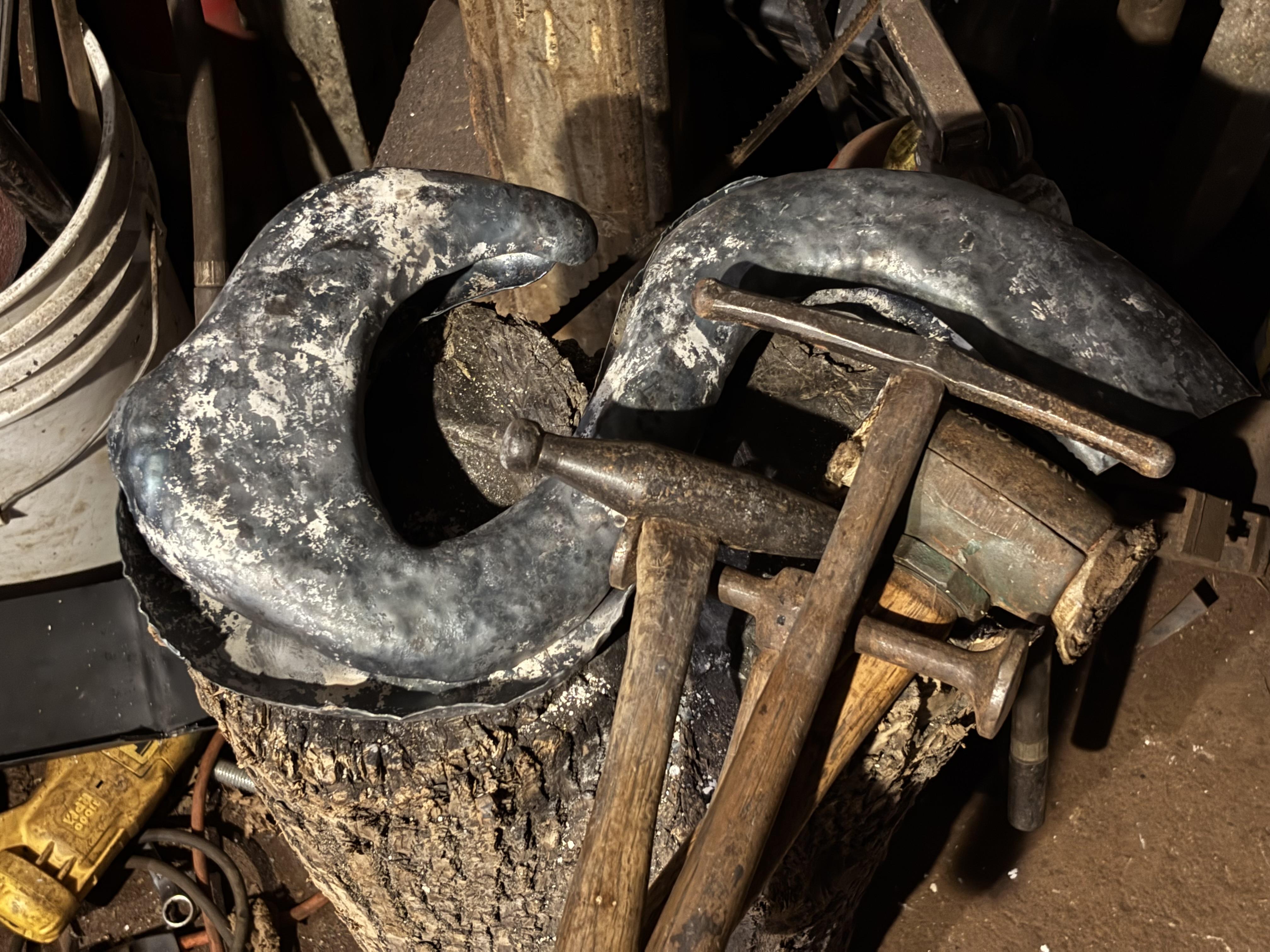

More work on the flamingo.

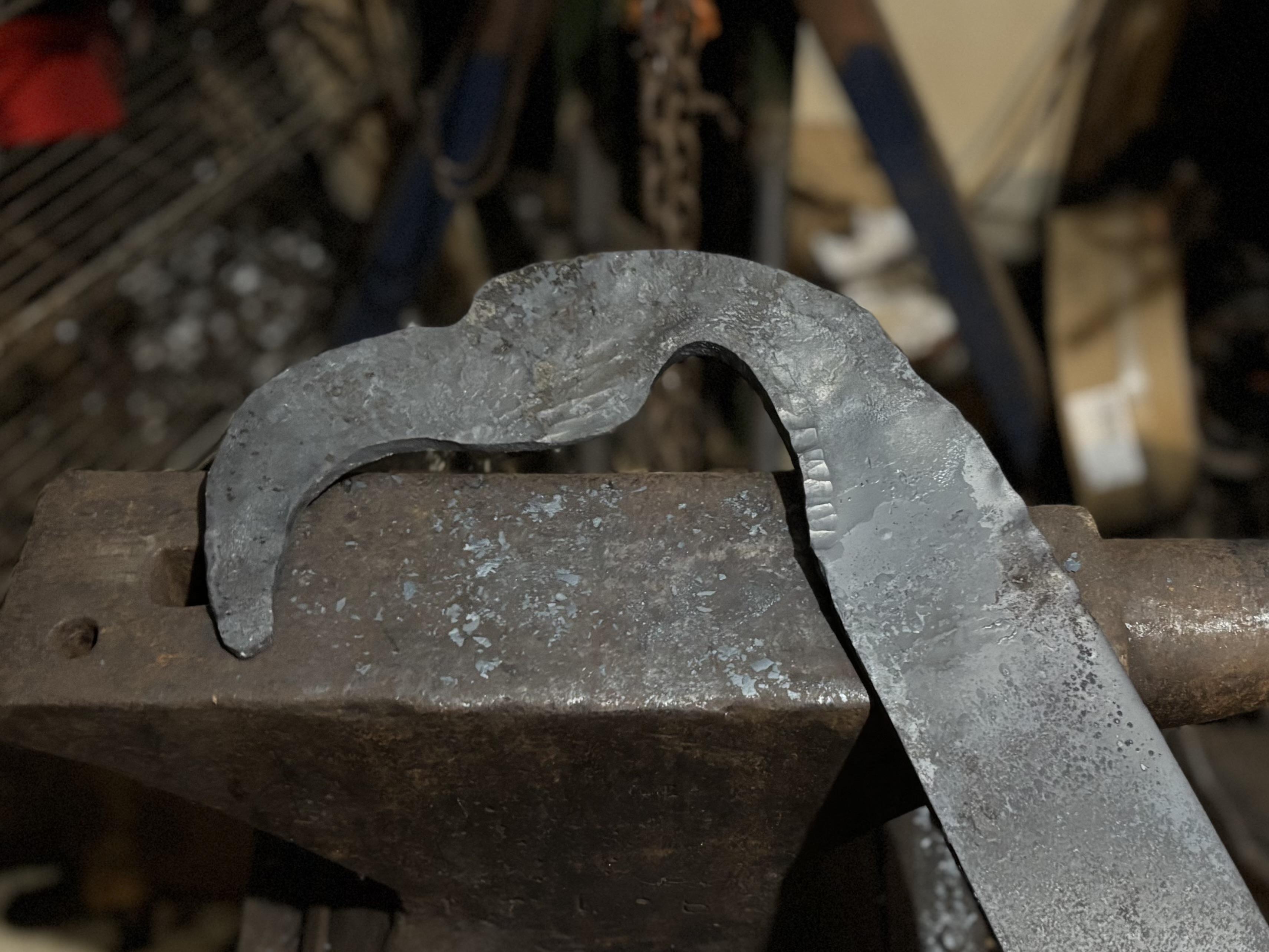

And Eureka! I think I might get a photo to upload. This is the horseshoe I was talking about that may be wrought iron

Chellie, IMO you should spark test your horse shoe to see if it is WI.  Just touch it to a grinding wheel and look at the spark stream.  IIRC WI has kind of an orange color and the spark form straight lines, no secondary or tertiary bursts like little fireworks.  Check Google and Youtube for examples.  If it is WI work it at yellow heat.

Hello George! Yes that was my thought was just to spark test it or break it... which I would rather not break it. If it's wrought, I want to make maybe a little something special out of it. A friend in Alabama is sending me some draft horse shoes with copper nails in them. It sounds as if they may be aluminum though. She's a barefoot farrier and she's not sure about these, but it's what it sounds like in her description to me. I still like the artist blacksmith twist but my current thoughts are nail making and hinges. We are building a pole barn and I want to add some blacksmitherly touches to it. Tommie is good. He's excited because I told him to buy a saw mill :D
I've got to say, that is A LOT of hammering!  Looking good!
I can't remember if I mentioned here, but I scrapped the idea of a solid head and neck for the flamingo, replacing it with a hollow form made from the same sheet metal as the body (salvaged from the stand of the cannibalized bandsaw). It would be quite a feat, though, to hammer that bar stock out to 18 gauge, especially since I don't have a power hammer!
