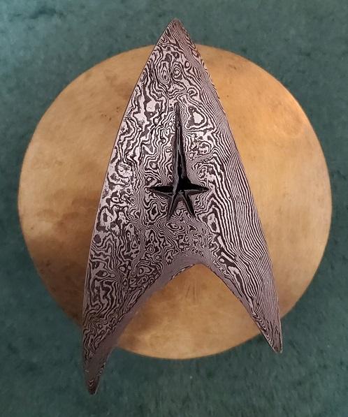

Here's what the final product looks like:
Have a good week all!
Cool.
Wonder how long it stays like this on a dog collar
6 hours ago, gewoon ik said:
Cool.
Hahaha...Well, I use GunKote on pretty much all my damascus pieces with the exception of kitchen knives so it should look good for a while.
However, this is just a hook going on the wall and the leash goes on this, not the other way around.;)

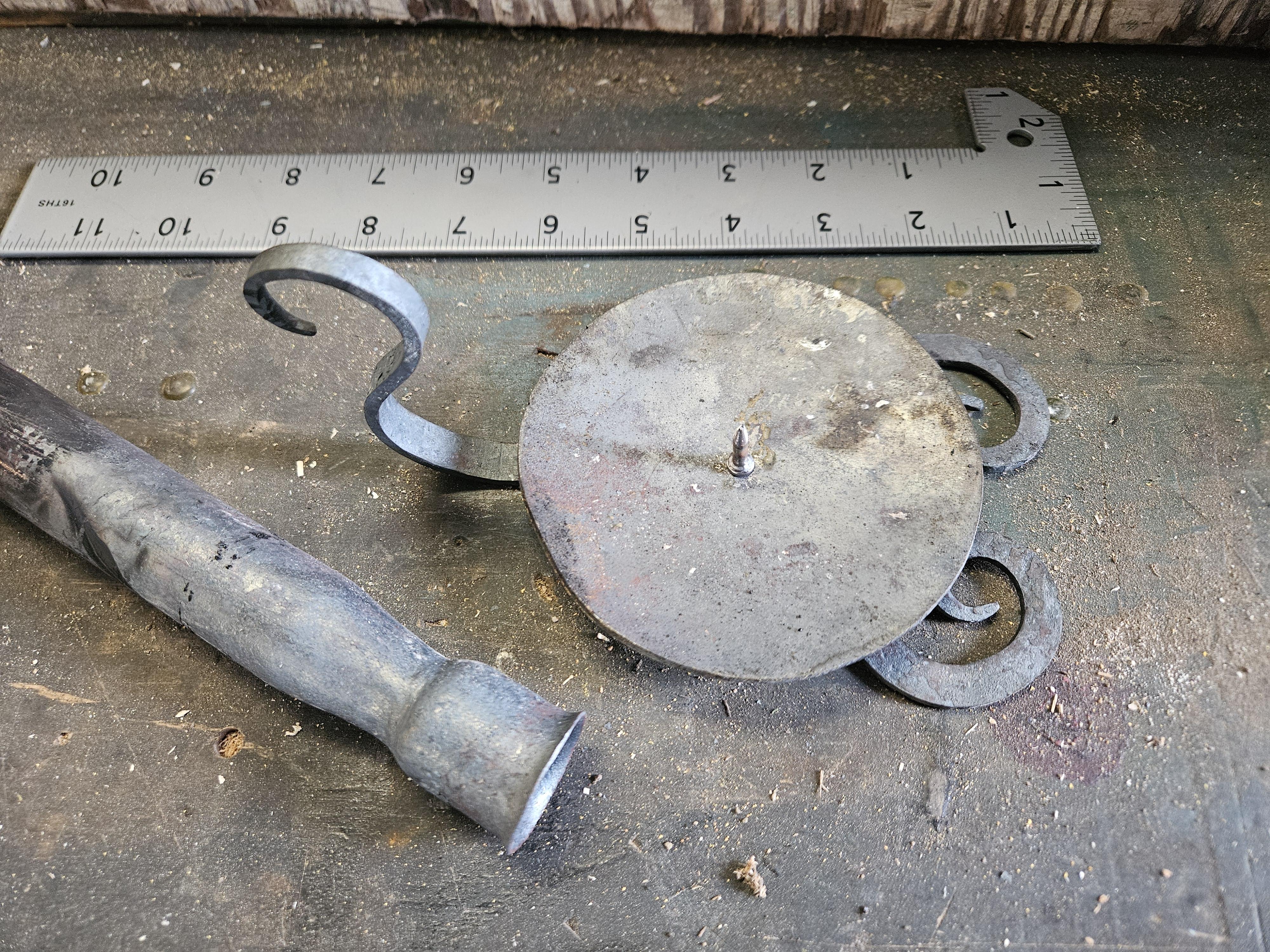

Made a candle holder for a customer request. Worked on necking down pipe, i could do something with it but it seems to be way to time consuming to be practical or profitable.

Necking pipe calls for either a spring tool or butcher with fullering dies, then it foes pretty quickly even by hand.

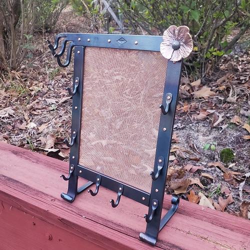

I didn't make these in the shop today; these were Christmas gifts. I am proud of how they turned out so I wanted to share with the group.
My wife wanted some sort of display/holder for jewelry for Christmas. I used 16x16 copper wire mesh as the screen. The flower is made from some 1/8" copper plate I salvaged from a scrap industrial switchgear. I mulled over how to attach the screen for a while. I ended up using pennies as large washers on the back side to distribute the strain on the mesh. I did not punch holes in the mesh, rather I used a tapered rod to open up the mesh to accommodate the rivets so the wire wouldn't unravel.
The trivet was for my Mother-in-Law. I took a slice of 8" Schedule 40 pipe, cut it into thirds, flipped the pieces around and inserted small pieces of bar to act as feet.
Everybody seemed pretty happy with their gifts, so I'll call it a win.

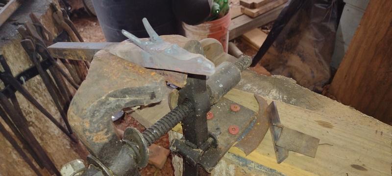

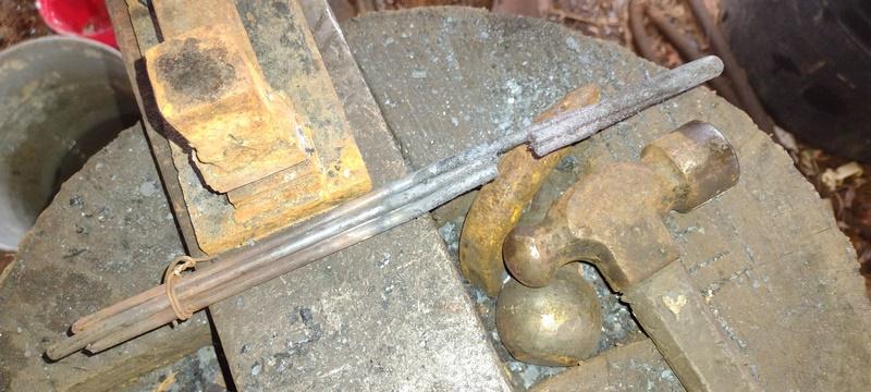

Got a little forge time in today. And during a welding process I got distracted for a second. three of the four pieces went away.
I cut it off, and welded together what remains. But I wanted a longer piece. Oh, and I need more baling wire. Did a little more to the dragon as well.
I may start over on the dragon, I'd like his forehead to be more pronounced.
Mothman,  That jewelry rack is the bees knees!
Love the jewelry racks Mothman, those are going to equal years worth of brownie points!
Blue, It's been so many years since I forged a dragon's head I'd have to go look at one to remember how I did it. BUT I remember a couple tricks.
Determine how long you want the snout and just break the upper edges to the eyes. Just ease the edges for the nostrils and mouth. Do you have an eye punch? I made one by welding a short piece of angle iron perpendicular to a piece of thickish steel, maybe 1/2" for the base. So long as it isn't sheet steel it'll be fine. Select a sacrificial center punch and holding it in the angle iron "Guide" put a healthy punch mark in the base. Drop a BB in the punch mark and grind the point off the center punch till it's SLIGHTLY larger around than the BB.
Heat the end of the punch to mid-high orange hold it into the angle iron guide and give it a stout smack with a moderately heavy hammer. Oil quench it while it's still red and see what kind of eye it punches in a practice coupon. Rinse and repeat the above till you get one you like. Yes?
Now heat the dragon's (or wizard, or?) head, drive a center punch it straight into the nose of the dragon. (don't make me have to SAY one for each nostril) Unless of course you're making a uni-nostril dragon. Use a chisel to slit the mouth, no need to open it up, just a snarly looking line looks well.
Now the eyes. The top of the snout has a bridge and sort of curve represented by the break you forged into the edges, yes? Where it stops will be the forehead and you do this by driving the eye punch into each facet. It will spread the steal, raising the brows and causing the space between them to sharpen into a bit of a ridge in the brow.
It's faster and easier to make than reading or writing the description, Honest.;)

Really like the jewelry stand, but LOVE the simple design on the trivet.  I might have to do a version (probably with upset square... well, 120 degree... corners) and turn it into an advanced smithing workshop...

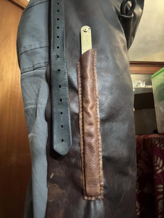

Added a pocket on my apron for my new folding ruler.

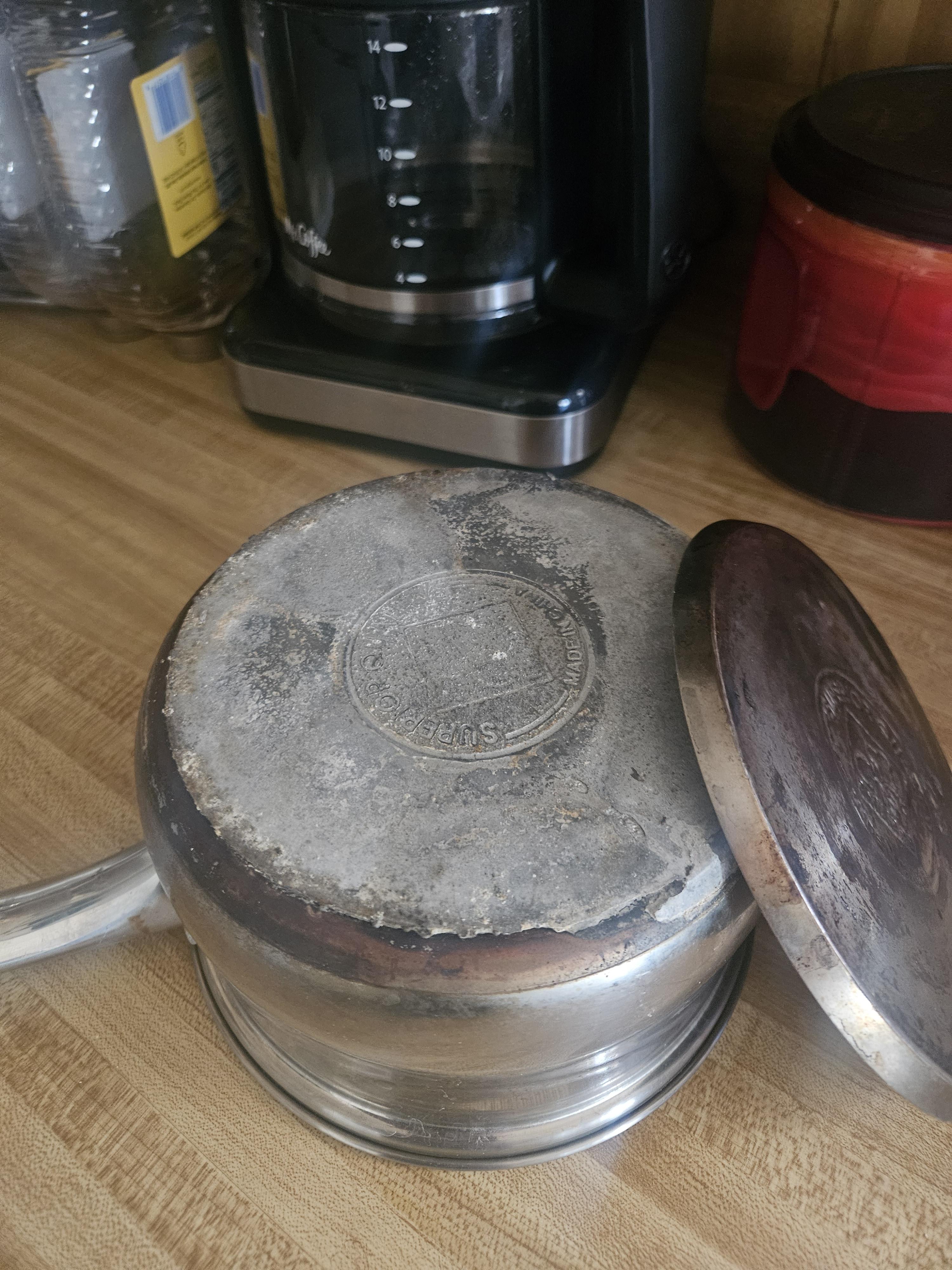

Today the wife was doing dishes and told me one of our pans needed tossed. Not sure where this one came from and i am sure in is just a cheap pan but i like it very much. The bottom fell off.
So, i was wondering does anyone know what kind of solder this is? Can it be salvaged? And how would i do it? I am thinking maybe clean it up, a little flux and heat both the pan and the bottom until the solder runs. Like i said it is provably a cheap pan but i like it alot, if i can not do it no big loss though. Maybe just fun to experiment...
I got curious and went down this rabbit hole once, not initially about fixing them, wanted to know how they attached the two metals. The different metal bottoms are either for better heat transfer (not steel on aluminum, that would make it worse), acting as a heat sink to even heat out, aesthetics, or so that aluminum can be heated more easily on an induction stove.
The bottoms are press fitted on, sometimes with perforations, then they're either brazed, or friction welded. But...coefficients of expansion being different, sometimes it fails and the bottom pops off. I'm guessing that friction welding is gonna be prohibitively difficult at home, so the way to go would be clean the heck out of the aluminum oxides, then braze it.
Obviously, you can't use brass or brass powder for that, since the melting temperature of brass is something like 600 degrees hotter than aluminum. I've heard of soldering aluminum to aluminum, but you have to clean and tin the aluminum first, and even then, the melting temp of anything but some silver solders is going to be not much higher than cooking temps so you'd be risking failure, and you're going to have a crazy amount of finish work to clean up the pan afterwards, and again, that kind of silver solder would be approaching the aluminum melty point.
If none of the above works, I'd be tempted to try JB weld?  Don't they claim it works on exhaust manifolds?
I think you're out of luck. The problem with any non-factory repair is that you're going to have either air pockets that create cold spots and will serve as nucleation sites for the next failure or an adhesive that is going to interfere with the heat transfer. I think your best bet if you want to keep using the pot is to ditch the disc, clean off the bottom of the pot, and remember whenever you use it that the thin metal isn't going to behave as well as the original pot did.
4 hours ago, LeeJustice said:
Is that Aluminum?
The pan is stainless. Guess i should have included that bit of info.
Thanks for the replies. I was figuring it to be a lost cause anyhow. Gives me an excuse to buy more cast iron. I may try sometime though just to try and see what happens. I am in no rush so i will put it on the back burner for a while. (pun intended)
Stainless to steel silver solders well and you can use enough for a solid join. You need to know what you're working with metal wise and heating the thin section without warping it can be tricky. I believe they're soldered in an oven at the factory. Probably have to use a large torch with a soft, even bushy flame
It'd be fun to play with but I wouldn't expect success.
