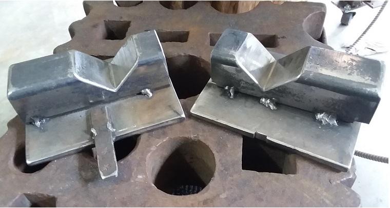

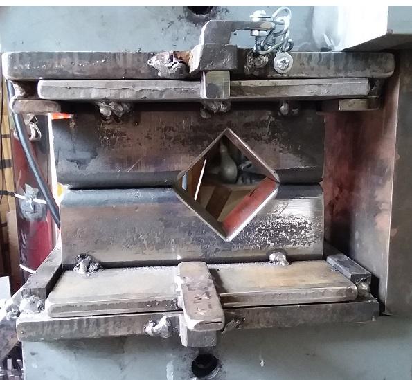

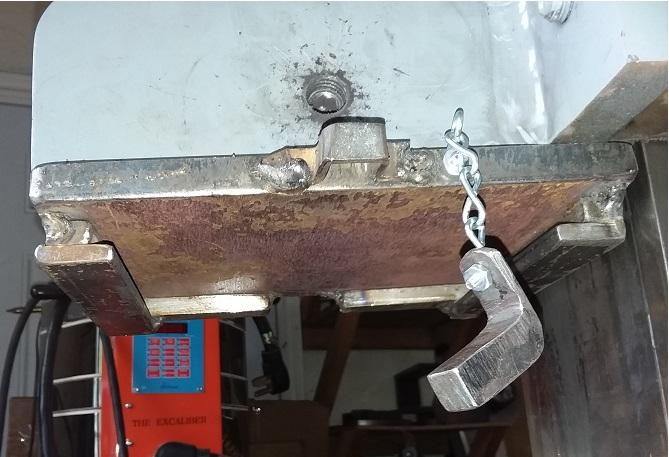

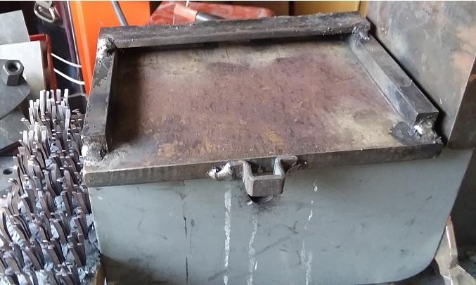

19 hours ago, MeltedSocks said:
I need to rethink my die holding system.  I copied it from Coal Iron Works (their 9 ton model), but changing dies takes too long to me.
Here are some pics of the system I came up with, maybe it'll give some ideas:20201018_163421.jpg.bbc38fb085f66add3187ae0f50beec2c.jpg20201018_163441.jpg.68ef700b134ad8251f4f8781aaa7dd83.jpg20201018_163407.jpg.2f1515a11f9ea98251abd5a2e71890a5.jpg20201018_164115.jpg.1d6803a1721a08c2082bc79611e00a01.jpg
PS - In case it's not clear, there's a 1/4" square tab under the bottom handle that registers into the holder on the bottom die.

Thanks, billyO!
My crossmember on the bottom is 2" wide, but the upper is only 1" wide, so I'd have to devise a setup that isn't quite as deep as yours.  I already had to redo my flat dies because of a moment arm that was too long.

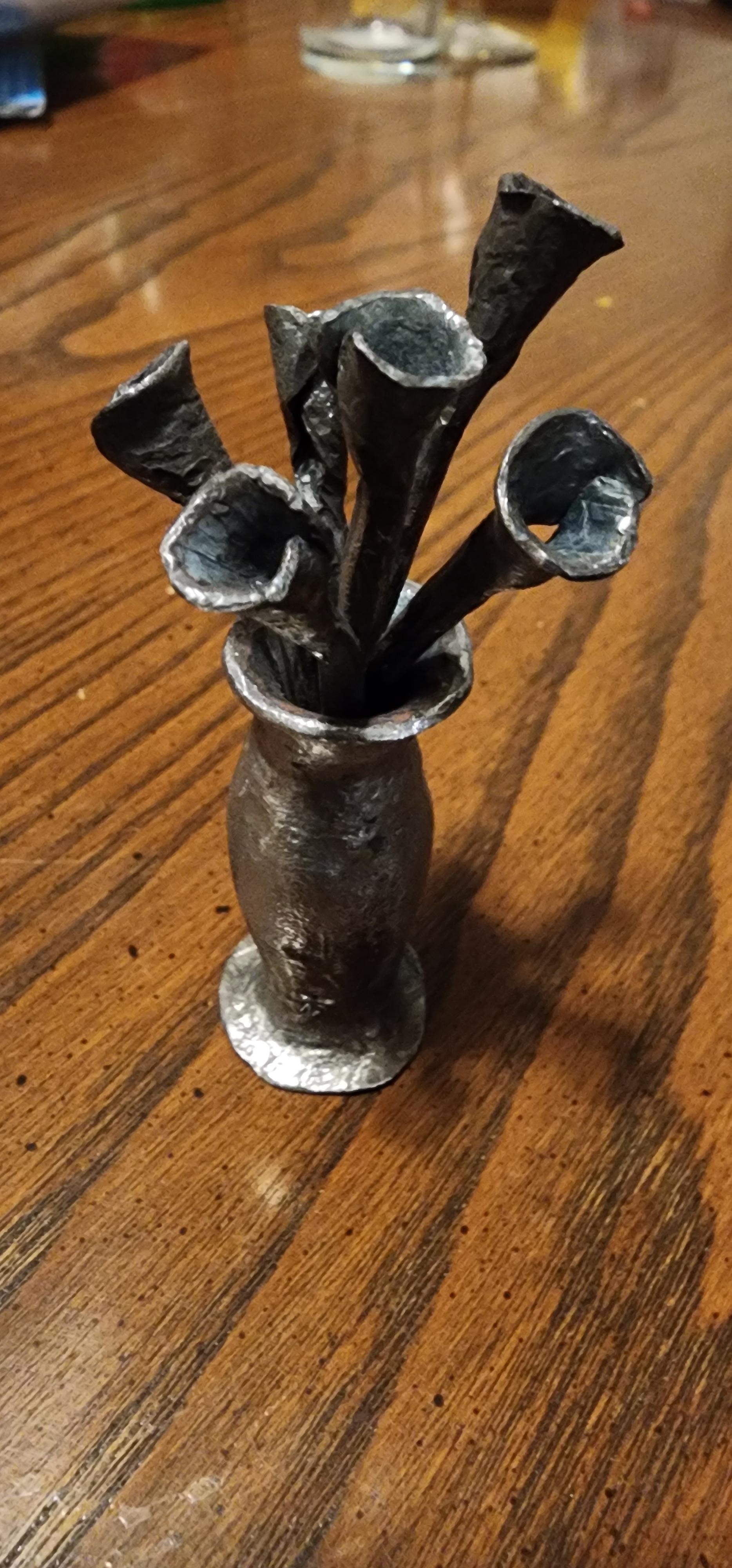

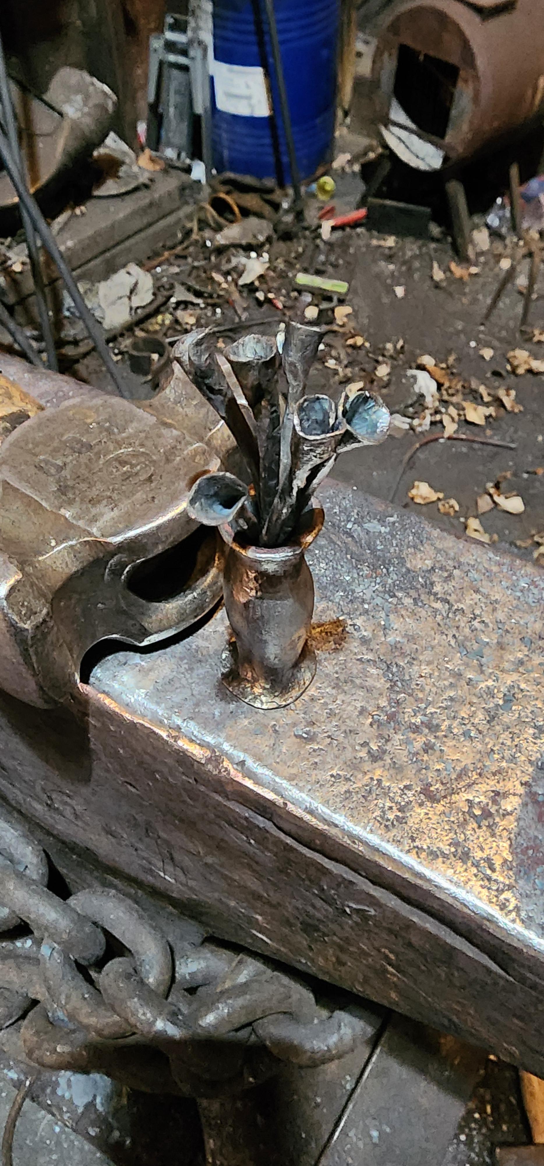

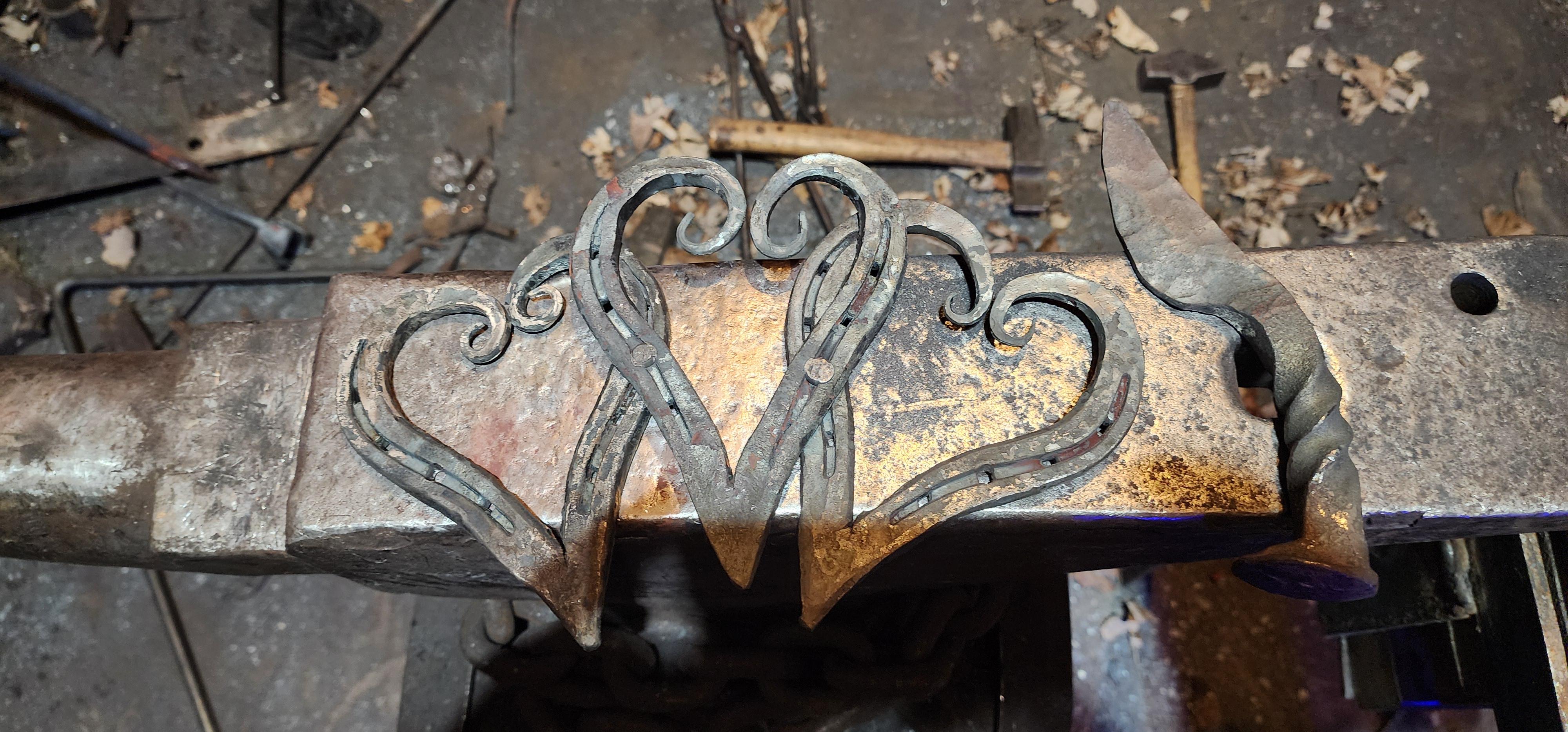

So Saturday is the UMBA Winter conference and the trade item theme was flowers.   Tonight I revisited my farrier nail flower I tried last year, making a small boquet and the case from a 1 inch piece of pipe.

Nice flower and . . . Case?:huh:
Spell check or a miskey strikes again eh? Thank you for the morning typo straight line and smile.

I have no faith in AI, they can't even manage to not change words I type.  It should be vase.
