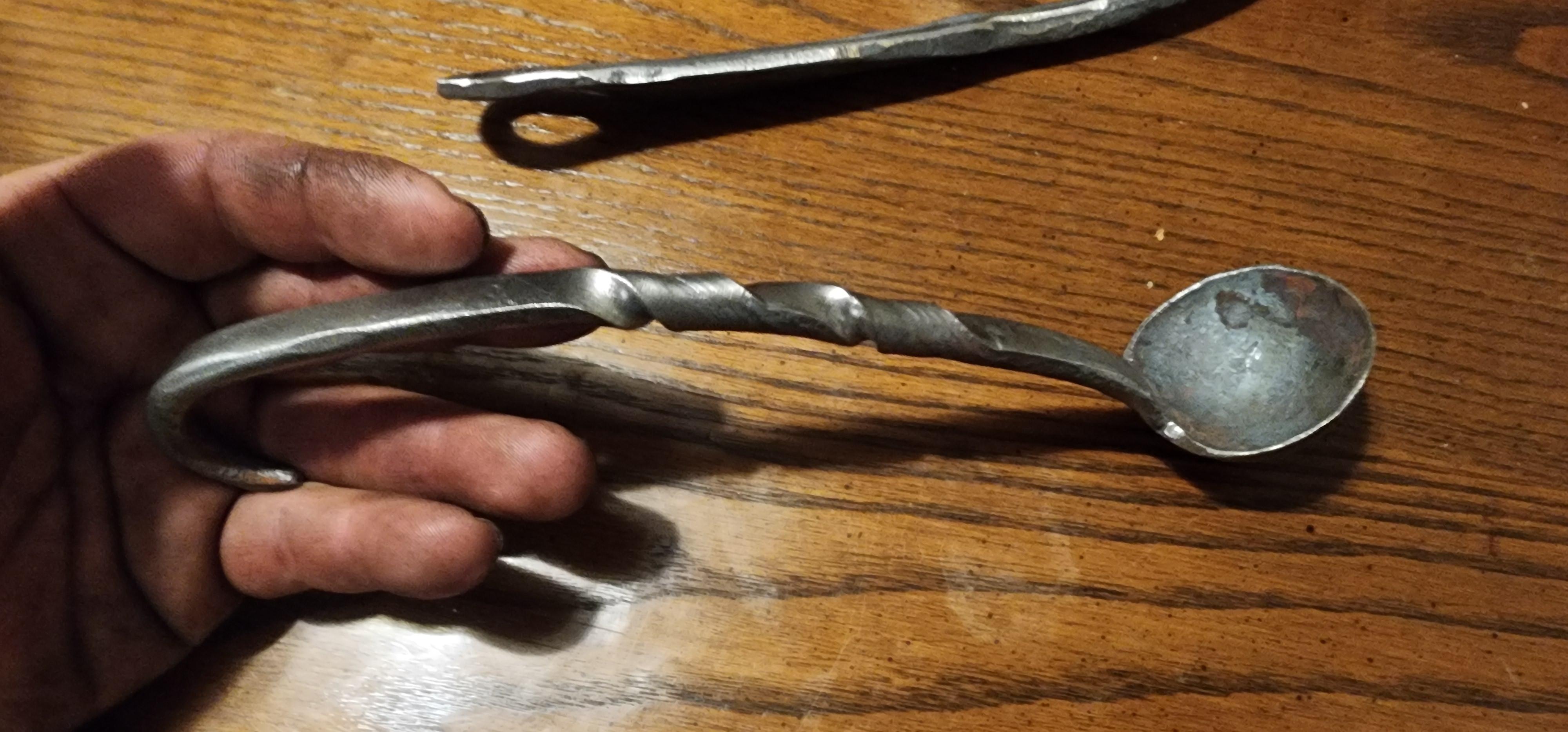

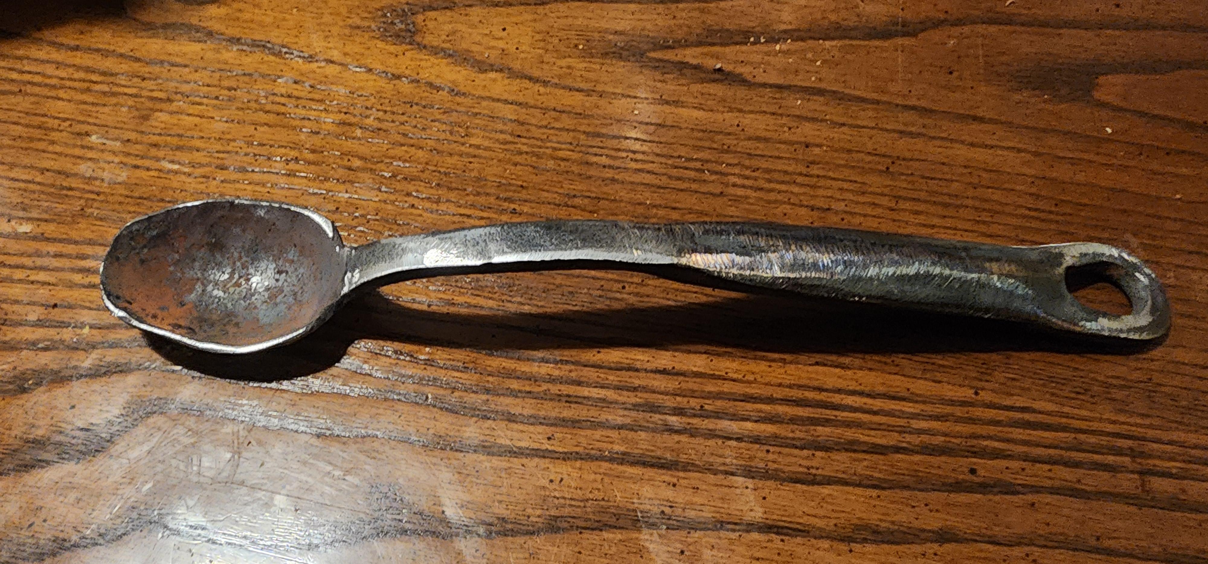

Last night I decided I needed more practice making spoons.   Forgot what I used to start but it was 1/8 inch thick.  In the past I had tried to use round stock and would occasionally break the head off.  I'm pretty happy with how this approach is working now.

Very nice, Chad. I particularly like the twisted handle.
One suggestion: the grinder marks aren't the best finish; I would suggest heating the finished spoon up to a bright red (so that you get a bit of scale formation), wire brush it until it cools to black, let it cool until about the temperature of a very hot cup of coffee, rub it over with some pure beeswax, and then buff with a soft cloth until completely cooled. That will even out some of the grinding marks, make all of the steel the same color, and give it a nontoxic, food-safe finish. If you wanted to, you could also drawfile the ground areas, which will remove those marks and look much more pleasing to the eye. This last step is optional, but worth the investment of your time.

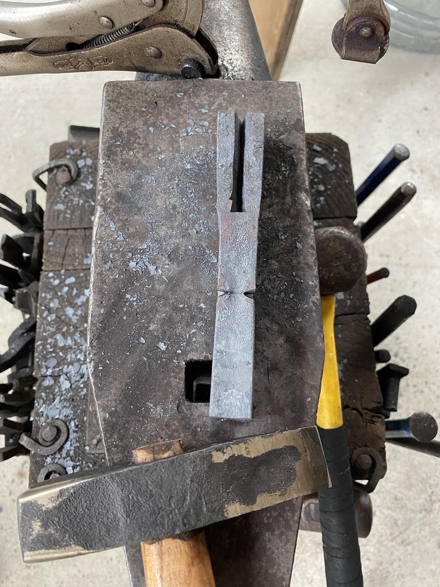

Today, I made that aunt a little split cross.  Her birthday is in February.  I haven't had my smithy set up for a couple of years because I let my wife have the poolside structure for her succulents.  I put my smitty in storage until I got my new one finished.  Two years later, I'm basically having to start over with the basics and relearn all those techniques that are covered in cobwebs.

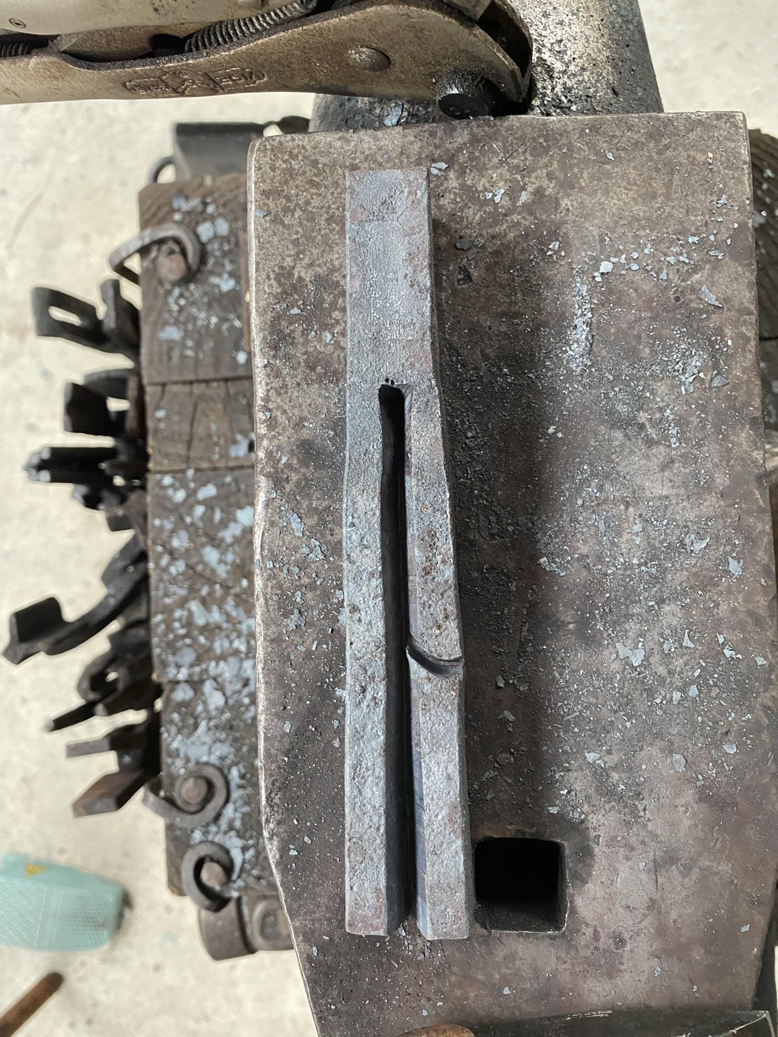

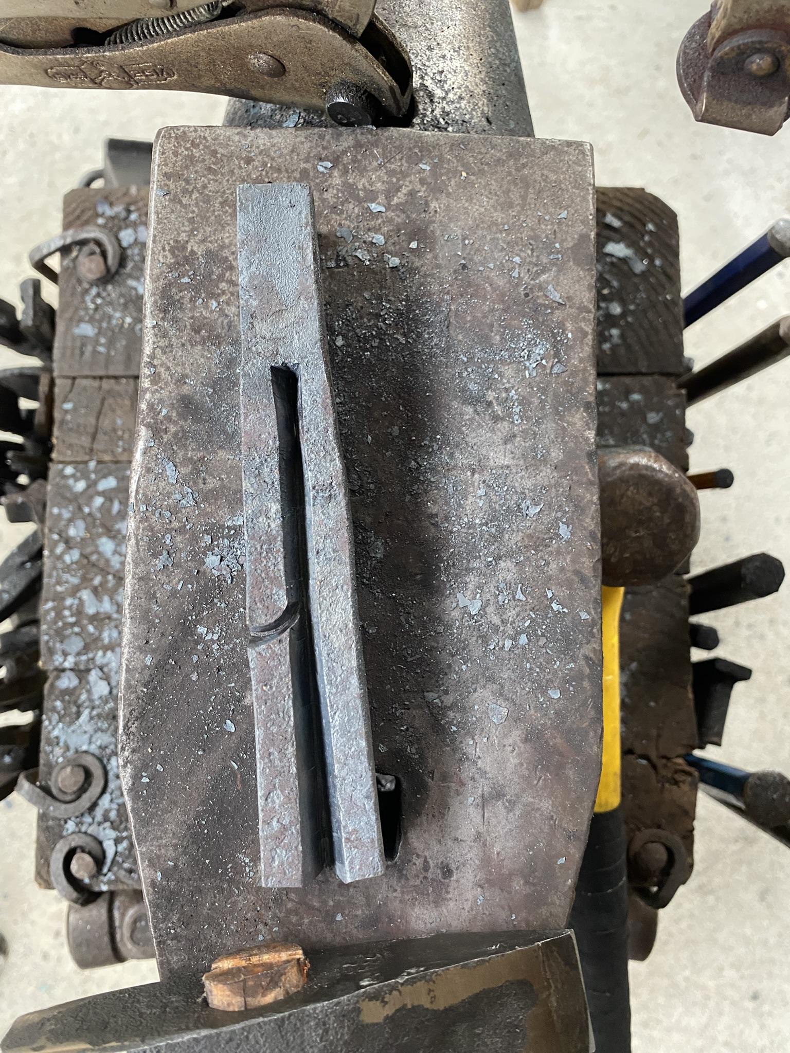

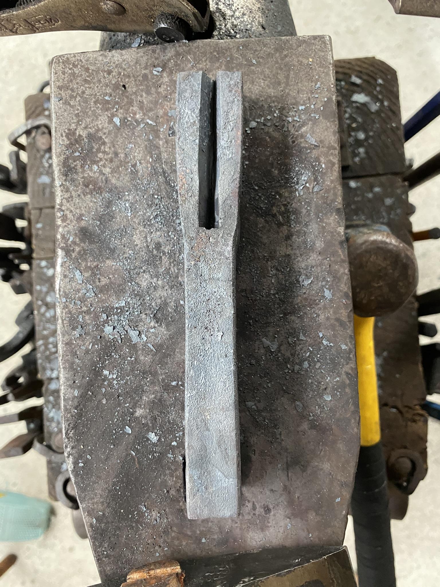

I quickly ramped up to 3/4" square stock.  It's looking good. Symmetrical. Almost through.

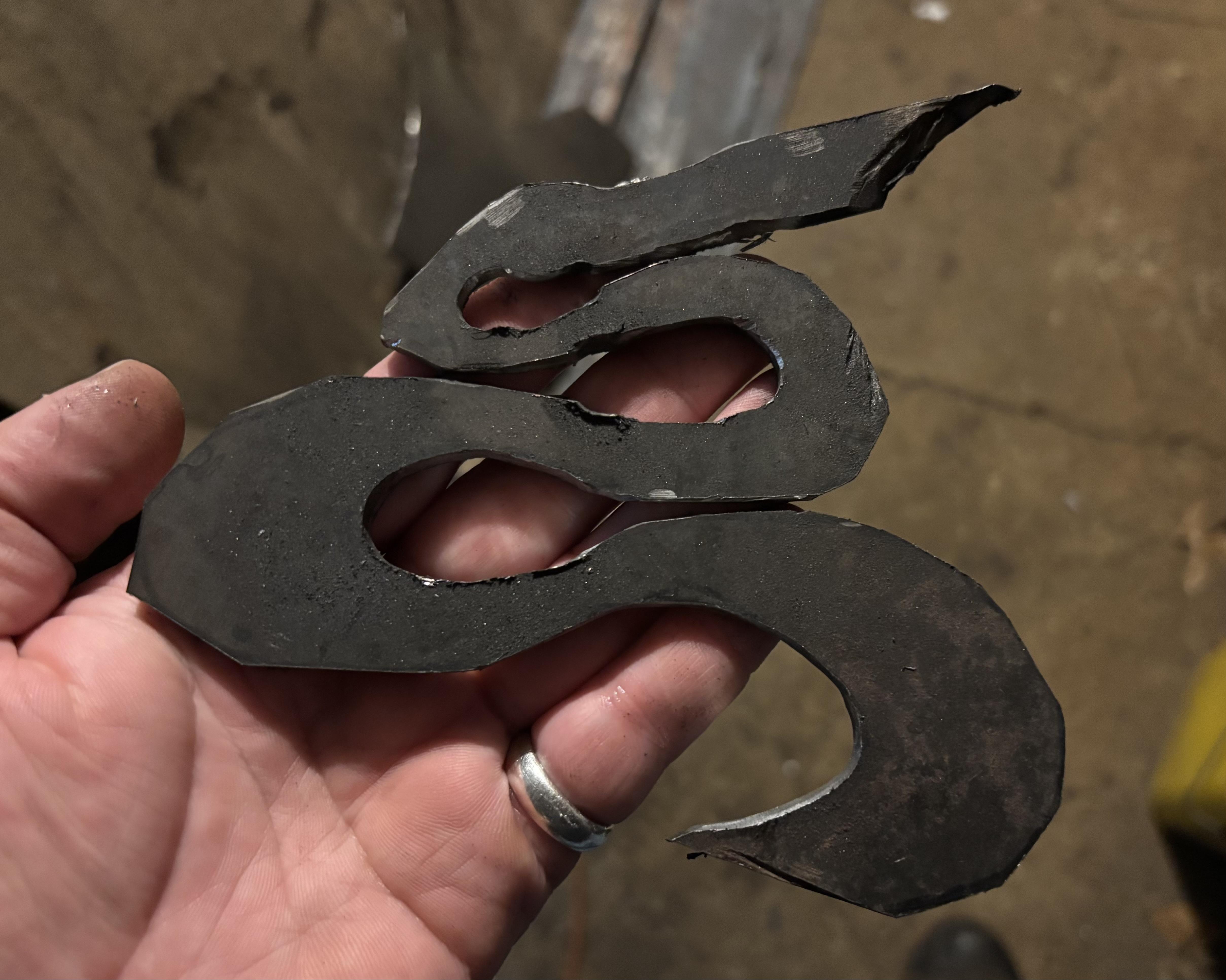

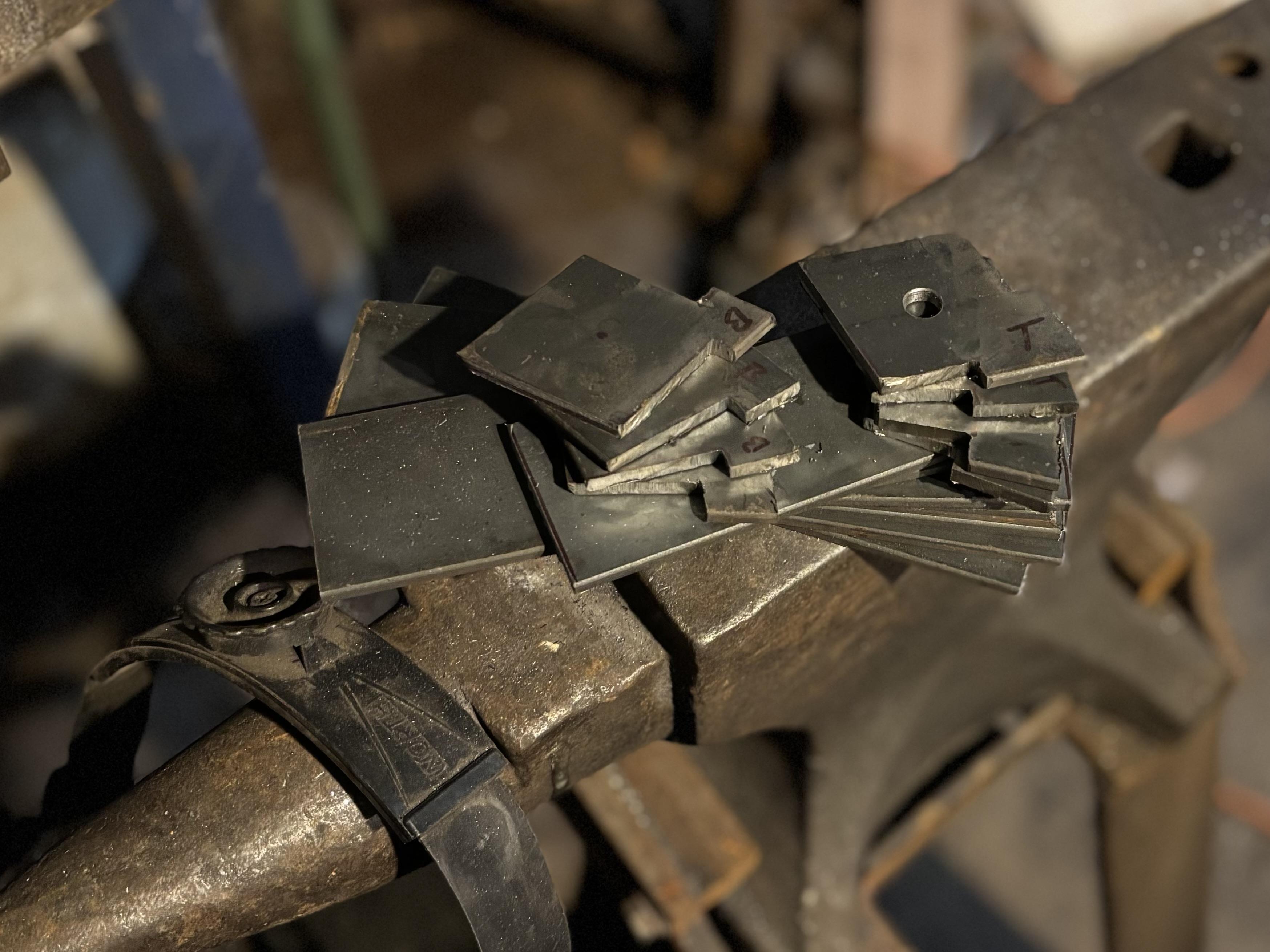

Getting back to the shop, I cut out some pieces for a couple of in-process projects.
John, I really like the lower cutout, suggests Chinese brush painting to me. Nice! Will be interested to see what the pile 'o cutouts (above) become...

Larry, the lower cutout is actually going to be stretched vertically, as I didn’t have a piece of stock wide enough to cut out the design in its intended dimensions. (This also reduces waste, which is a good thing.)
 The other pieces are going to become spacers and mounting brackets in some table legs. More to come…

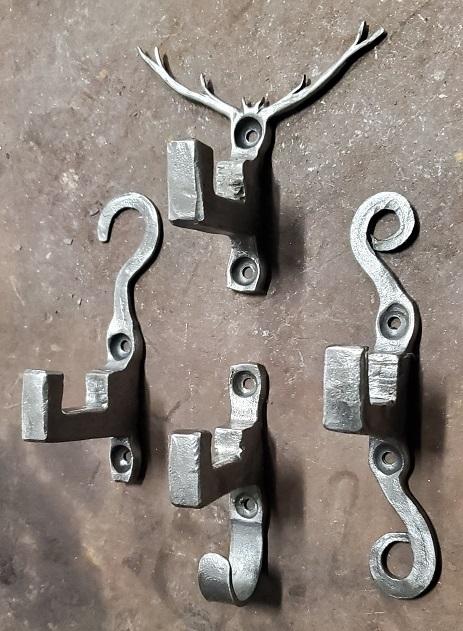

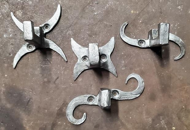

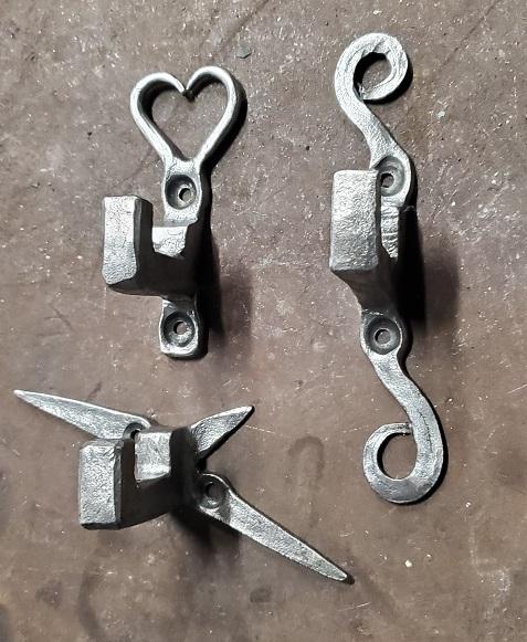

Hello all.  This week I was able to finally finish the 12 hooks for Phoebe.  She wanted 3 of the double hooks in the last pic.
20250131_172344sm.jpg.610c10916aaf77a7cc8869a24220de3a.jpg20250131_172501sm.jpg.a17ae446c447df885c400dd1685c9c7a.jpg20250131_172550sm.jpg.f5d9f2c5e27313471e2bd3dcc4deaeda.jpg
Thanks for looking and have a good weekend all!
Nice hooks!

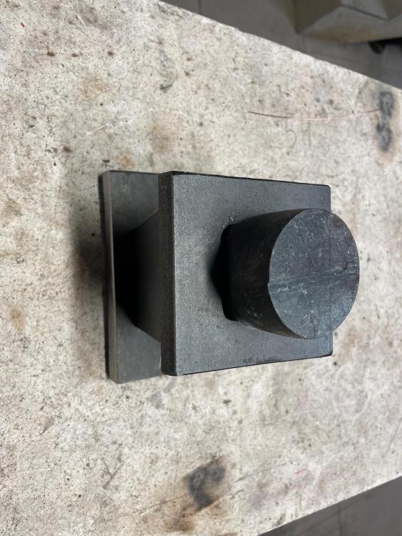

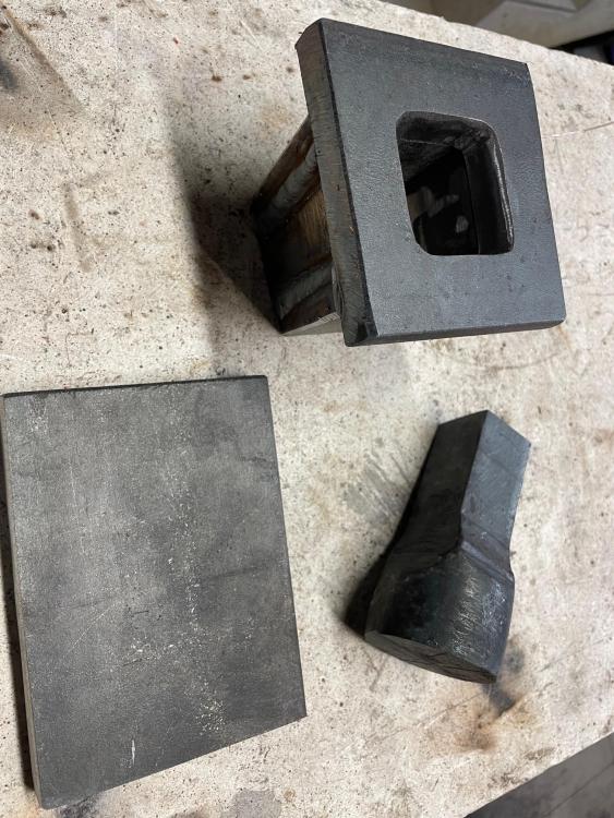

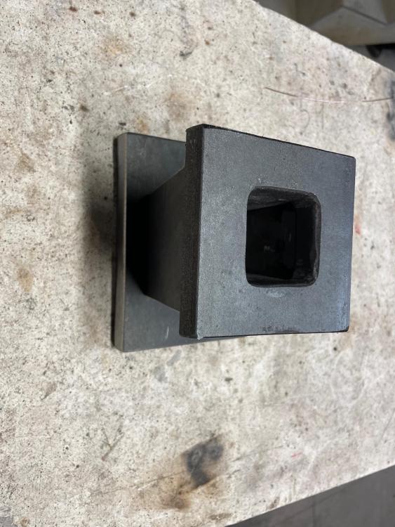

In my shop, a bit improvised, I'm not sure if it will work. It's a matrix for a hydaulic press to make a flatter hammer.

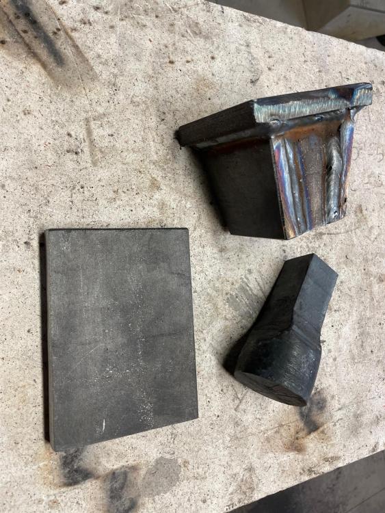

After spending a good part of yesterday and today chiseling this thing apart, I saw a marked increase in my right arm's muscle mass. :D

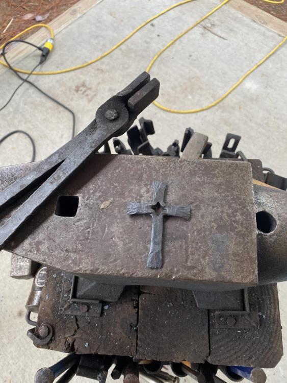

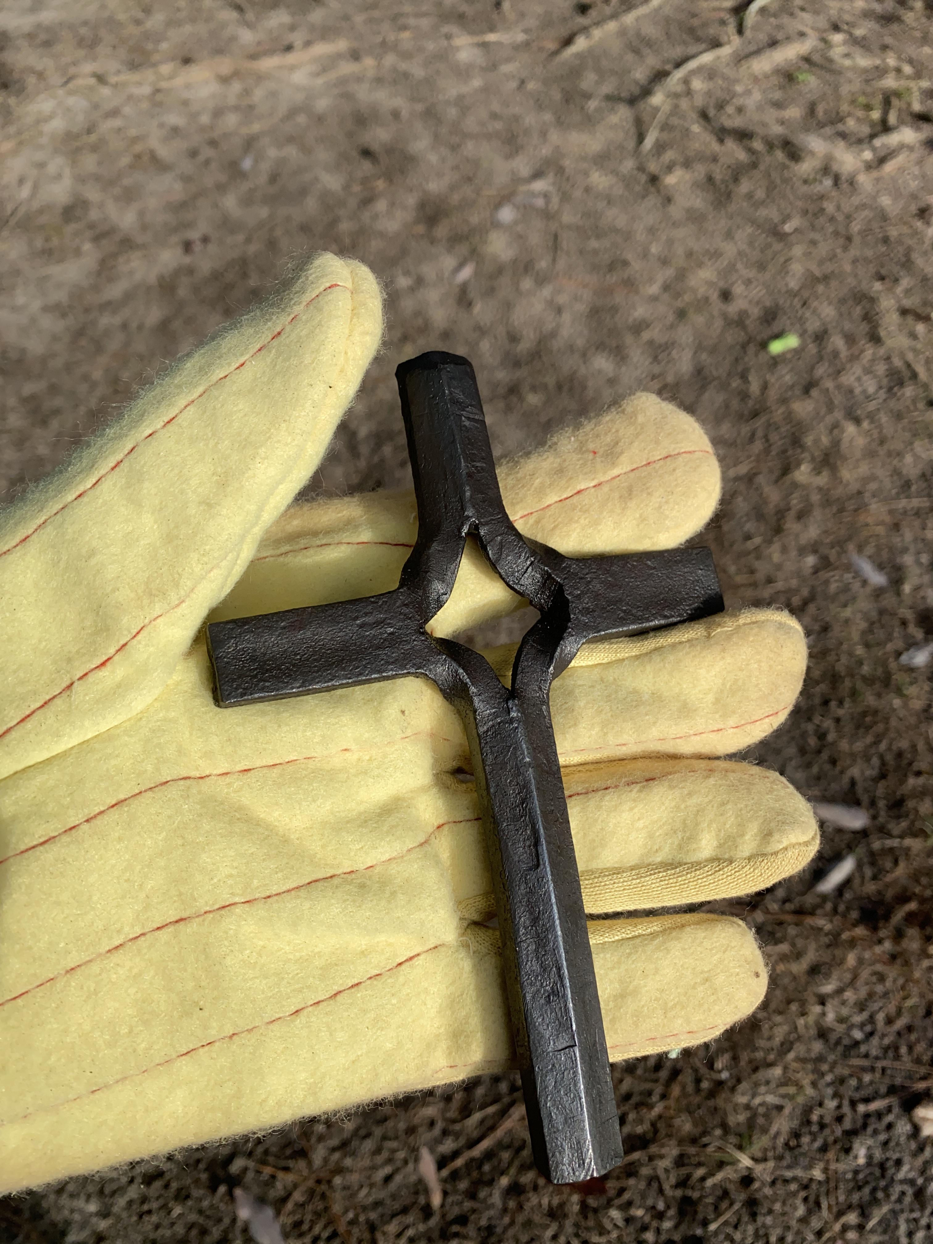

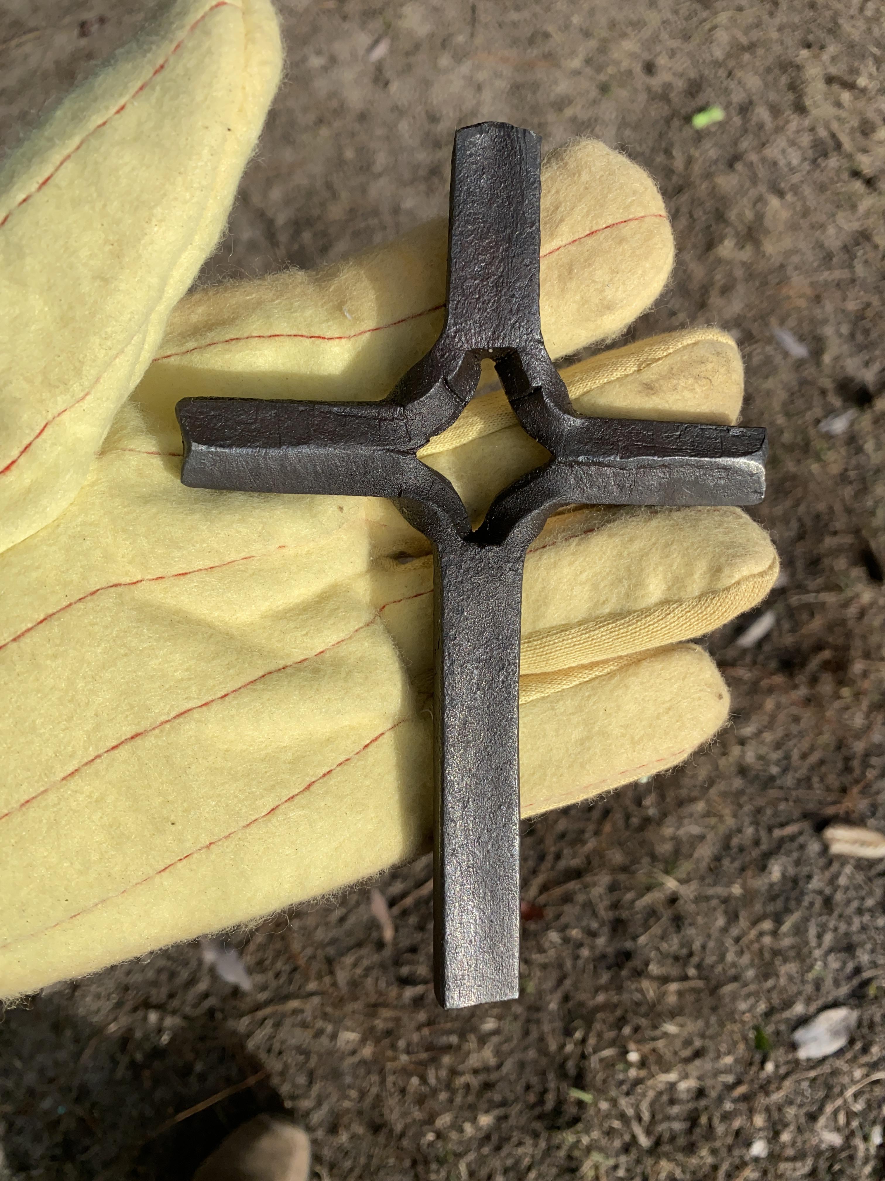

This split-cross made from 3/4" square stock turned out good enough to make my aunt happy.  If I ever make another one, I won't use my handled-hammer-chisel-splitter thingy (name please?) near the ends of the cuts.  I'd use a narrow chisel to finish it so that the lines are curvy.
If you're asking about a top tool you strike with a hammer like a flatter but with a chisel bit, it would be a "Top Cut" sometimes called a hot or cold cut. I prefer top, HOT cut or top Cold cut but that's just me.
I've been on a low key quest for some years now trying to get folks to use the same blacksmithing terms, (Jargon) so we don't spend so much time describing what we mean.
Good Morning,
I happen to have a couple barns of VW parts. The front torsion bars for the Beetle and the Vans are multiple flat blades that come in at least 3 widths. I find a piece of torsion bar (about 3/4" wide), ground sharp like a chisel, works the best for opening up the 'Crosses'. It doesn't leave any marks and a longer piece gives enough leverage. Yes, it then requires a little 'Loving' with a Hammer and the edge of the Anvil, before it becomes a Flatty on the Anvil face. The way 'you' do it, is always still correct. The Torsion Bars make the 'Best' scrapers, lots of support, Takes a Lickin', comes back Kickin'.
Neil
Thanks! Top cut.  Agree with the need for using proper terminology.
So like a tall hardy hot cut?  Mine wasn't tall enough to use on the long section, so I put it in my leg vice and used the top cut to open it. It was a PITA for sure.
